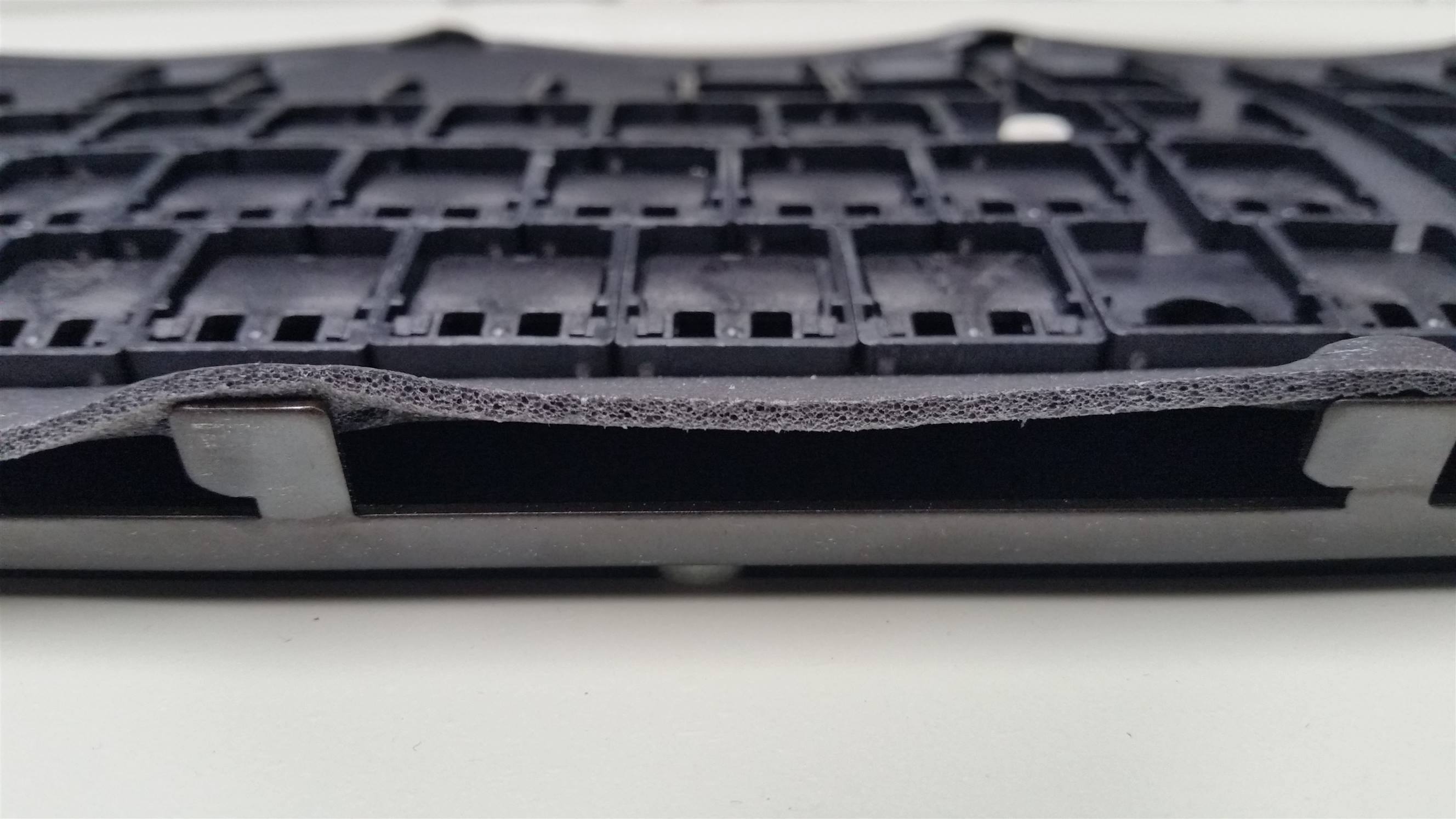

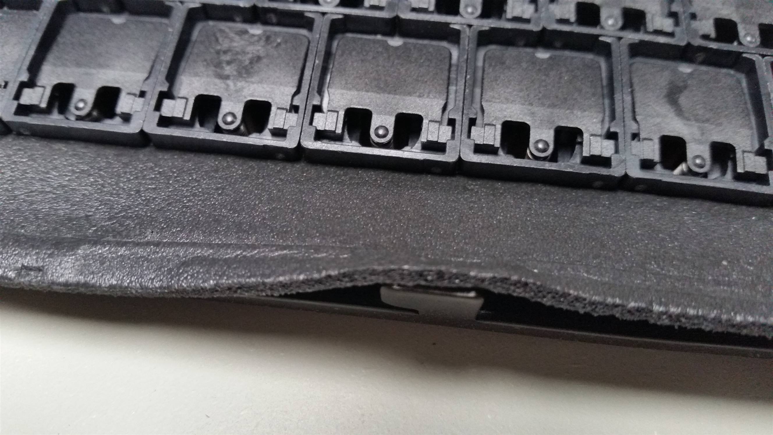

In my F77 (inner assembly built in 1990), IBM appears to have used 2 mm foam that has held up well (I checked in a few places with my caliper). Attached are some photos of the foam.
I'm not sure of the type of this foam or its durometer. Any ideas?
The 2 mm foam has compressed to ~1.15 mm in the center row, ~0.42 mm in the top row, and ~0.82 mm in the bottom row. The F77 barrels have almost no wiggle.

That looks exactly like the foam in my Model F XT. I just assumed someone had already replaced it, since it looked virtually new.
My two Model F ATs both had white foam that had degraded badly. I guess we see evidence of IBM pinching pennies even back then. On the gripping hand, I had the fun of refurbishing the Mod F ATs. Now they're _my_ Model F ATs!
