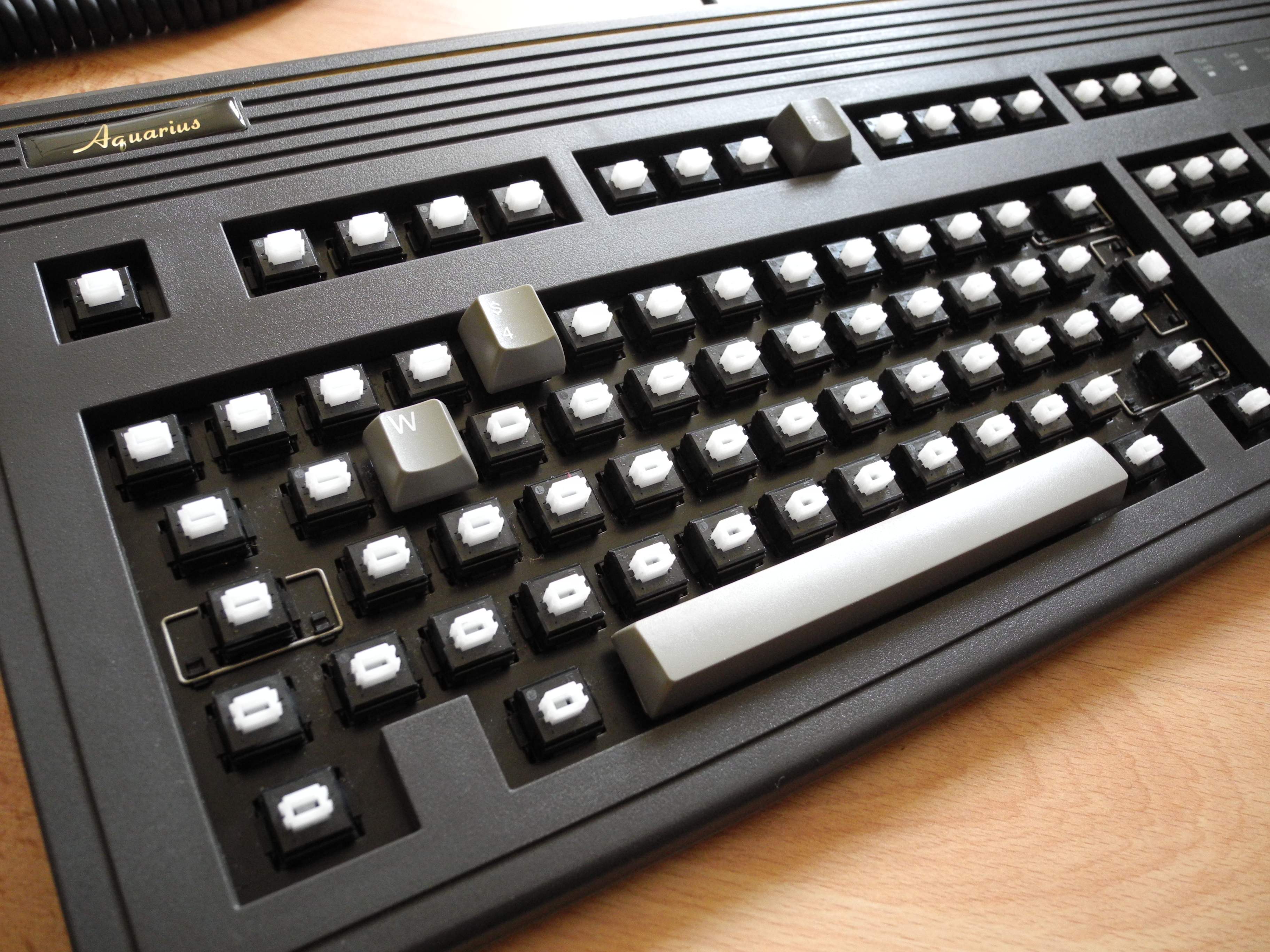

Nuum
27 Jan 2015, 17:08
Wrong! Here's a stabilized 1.75u Caps Lock:
DSCN3191 Klein.jpg (895.81 KiB) Viewed 6572 times

Very fancy, Nuum! How does it feel without the stabiliser clipped into the cap? Somehow the rest of us put up with 1.75u just fine!
It's actually a mighty 2.75u Shift key that I'm using, stab-free, on my little Monterey:
Not a single stab in place on that whole keyboard! The vertical Return key (which is what Daniel calls a semi Big Ass Enter as I recall) is more noticeable to me as I hit it on the low side, as if it's a little ANSI, like I do ISO Return keys in general.
So long as you design a stab-free layout with your own typing preferences in mind, I'm sure it can work just excellently. The key is to put the centre of the caps, and therefore the switches, just where your fingers expect. It's worth it for itty-bitty space bars!

It doesn't feel different without the stabilizer in place, at least not different from the 1.5u keys. I don't know why they put a stabilizer there, especially on such a seldom used key. Next: Find a keyboard with a stabilized 1.5u keycap.
