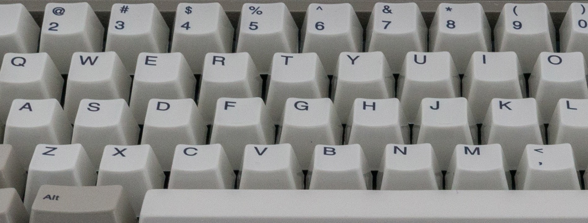

Ellipse
14 Feb 2016, 19:21
hKing you can order an original, used Model M key set on the project web site if you are concerned about key cap quality, or an original, used Model F XT key set if you want the absolute highest quality keys. I can have these keys installed on your F77/F62 keyboard at no extra charge. I have ISO style Enter original keys as well as original ANSI keys. They have been cleaned and will look good on your new keyboard.
Here is the new key set I ordered last month from Unicomp (pls disregard colors as they are not accurate):
Uni keys.jpg (382.78 KiB) Viewed 9285 times
