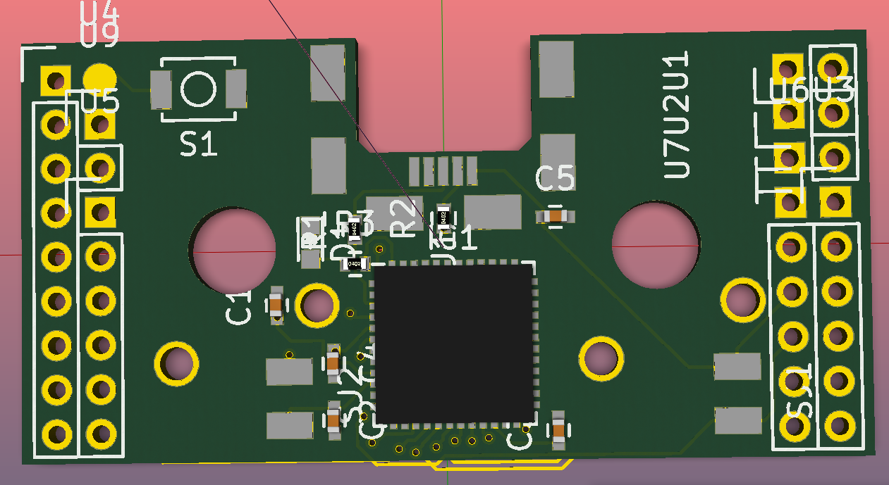

Hi all, I've been following this thread closely and I wonder if something like this could be useful?
I did not route it beyond checking that it's probably doable with some component position fine-tuning, as routing this would take some time
. I used 2mm pin headers and a mid-mounted USB connector, the same that is used in a number of Samsung phones. It fits neatly under a 2u space and can be directly mounted to two switches. Alternatively it could be fixed with some screws through the same holes. Some consideration should be taken as to how the mounted switches should be connected if a hand wired design is used.
I'm a bit late to the party, but hopefully this can give out some inspiration, or laughs
edit: just noticed that I have the smd components on the wrong side

This is an interesting concept. What are the exact dimension of this board? You would also need to consider other switch orientations (namely upside down
I don't think it is necessary, but if it doesn't hurt... I'm not against it

wouldn't printing on 2 sides be more expensive? I would also add "https://elf.io" and the board revision. "Elf 1.0 - https://elf.io" (all people involved will be credited on the website of course)
Apart from that the only thing that worries me a little is 38.1mm width
