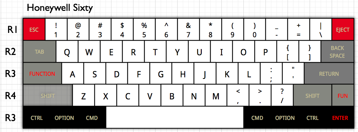

05 Nov 2013, 12:05
Individual row 4 unusually sized SHIFT keys sounds great to me. I'll get them in addition to row 3. Which looks like this on Round 4 SPH alongside row profiled alphas:
It's fine when you use it. The bigger problem is the incorrectly sized keys:
That custom keyboard is one of my targets for Round 5. This is my plan, with rows marked:
Honeywell Sixty issues.png (97.17 KiB) Viewed 8314 times
Note the ghostly left SHIFT: that's one of the missing sizes 7bit's talking about. 2.25u is only available in row 3. The red labelled keys are ones I'm still hunting for. A FUNCTION or LAYER labelled CAPS LOCK, a 1.25u ENTER or COMPOSE and a row 4 single unit FUN key.
Belfong
05 Nov 2013, 12:17
7bit wrote: Image
To me, it does not look odd to have row 3 modifiers in the 2 bottom rows, your kilometrage may vary.
Thanks for putting this in FAQ. This graphic creates a huge clarity for me. I suppose the TKL white/grey is the same as above except that I should ignore the Numpad columns, right?
05 Nov 2013, 12:37
Right!
Tab and Backspace \| etc in row 2 are important for the look, but bottom row mods and Shift keys don't good odd row 3.
I think I will add TAB, BACK SPACE and \| row 2 replacements for Round 4 spahericals.
05 Nov 2013, 12:49
Muirium wrote:...
FUNCTION was already in the HONEY/MODEXTRA175 kit. Added the stepped version.
ENTER added to HONEY/MODEXTRA125.
I will update the graphics later.
Depending on the poll result, I will change the FUNCTION kits.
