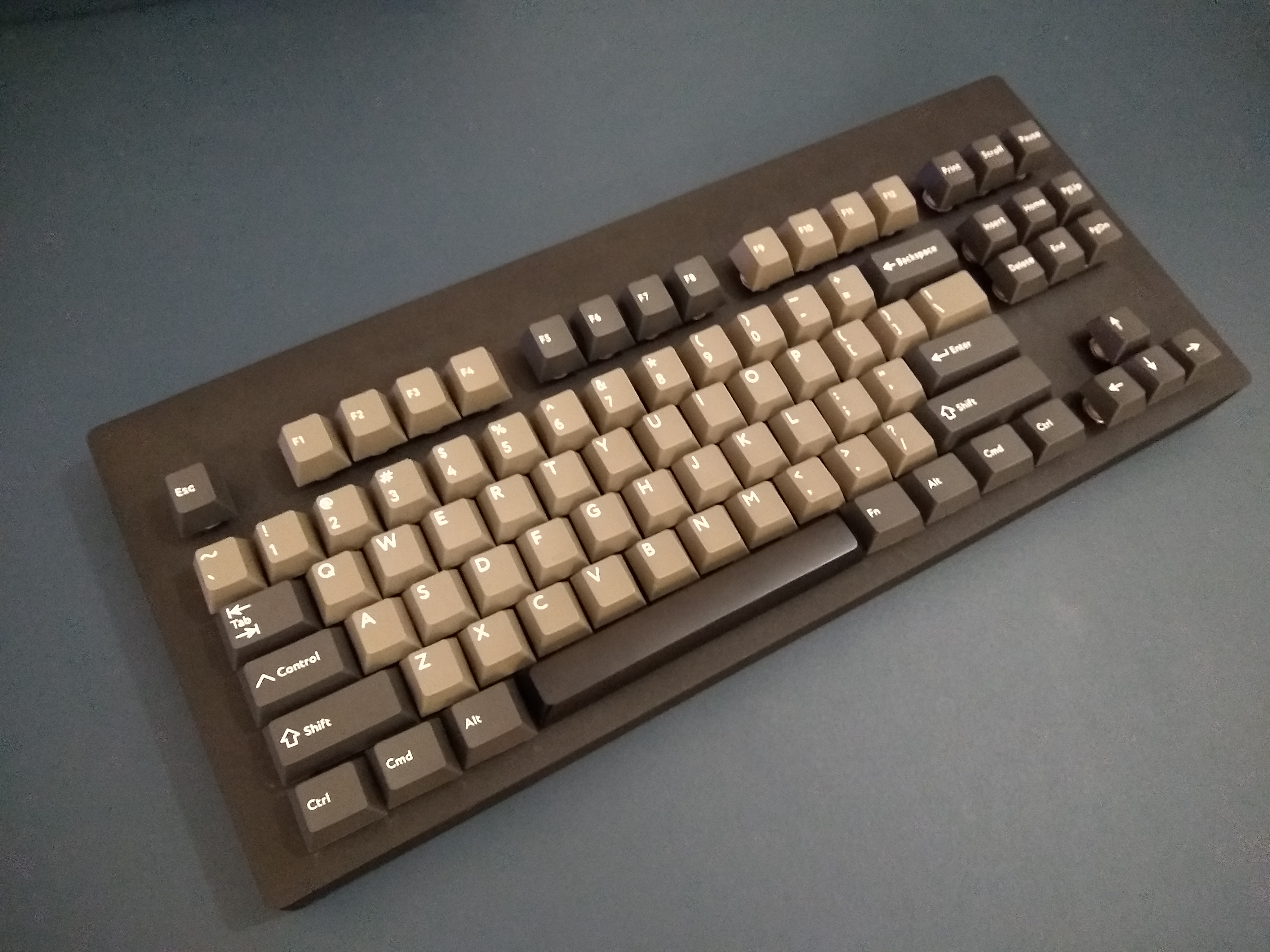

All the keys seemed to work fine on my round 1 BSSK apart from the odd-feeling spacebar. I opened it up to play and soon needed to refit 4 key modules as the fly plates fell off. I did finally get the knack of refitting the fly plates by watching your setup video. The follow-ups you posted with better explanations of fly plate fitting would have helped a lot!
I'm now playing with PBTFans Dolch keycaps. Will report on further progress when I've got the spacebar done and looked into feet.

clickclack wrote: 11 Apr 2023, 20:15 All the keys seemed to work fine on my round 1 BSSK apart from the odd-feeling spacebar. I opened it up to play and soon needed to refit 4 key modules as the fly plates fell off. I did finally get the knack of refitting the fly plates by watching your setup video. The follow-ups you posted with better explanations of fly plate fitting would have helped a lot!
I always liked the Dolch colors. Very nice config.

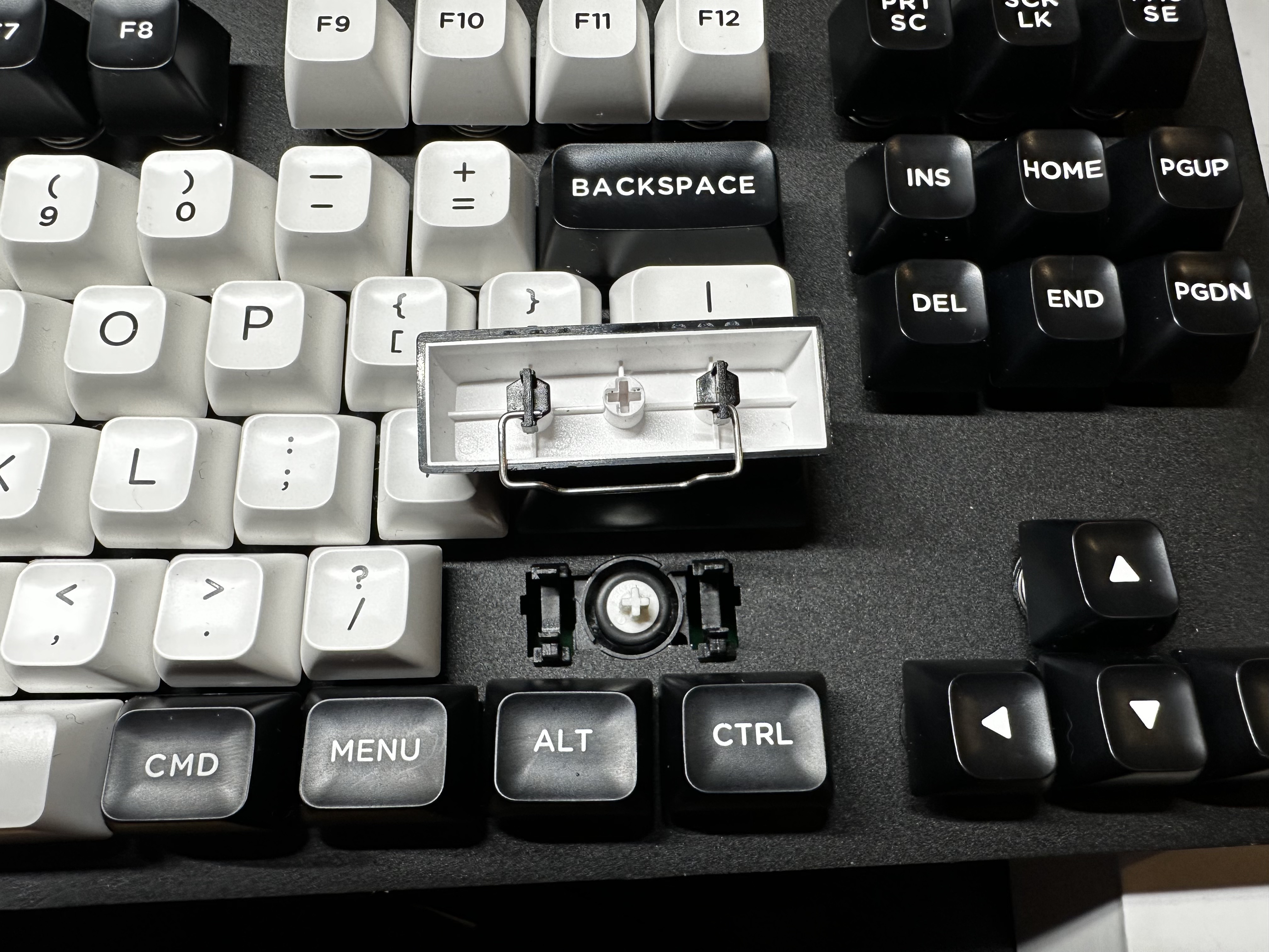

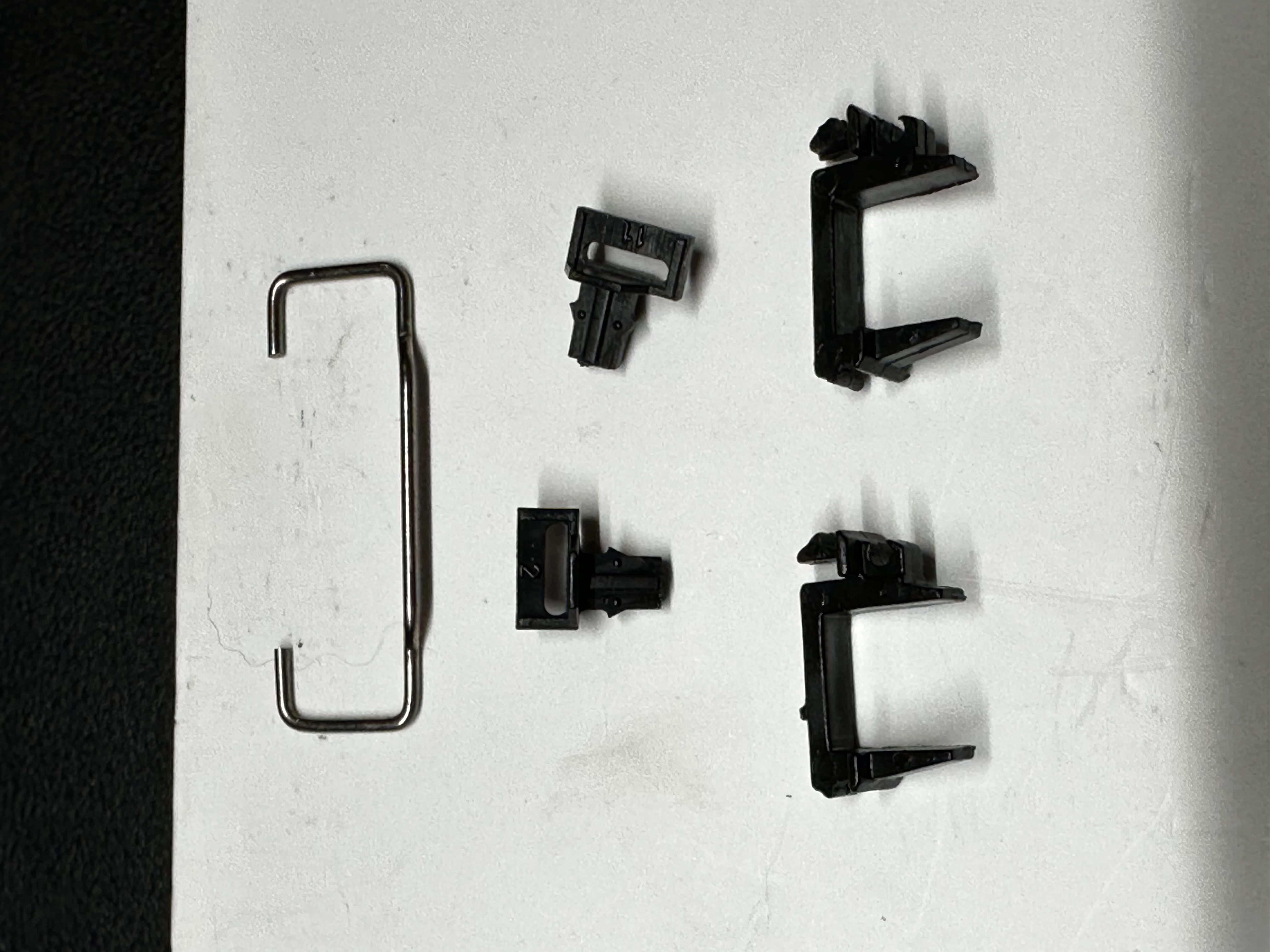

Just wanted to share that I found out that the Costar stabilizers work perfectly with the larger keys (>= 1.75U) and I have added them to the respective keys with great success. There is no modification required and fit just right in the cutouts of the top switch plate. The top hook of the costar stab set just has to be added to the larger key and the wire added to these hooks.
The Costar set consits of these parts (available e.g. from Amazon):
The result with stabilizer looks like this:
A quick video of how this actually looks and sounds:
Anyway, I think the extra stab is a great addition.

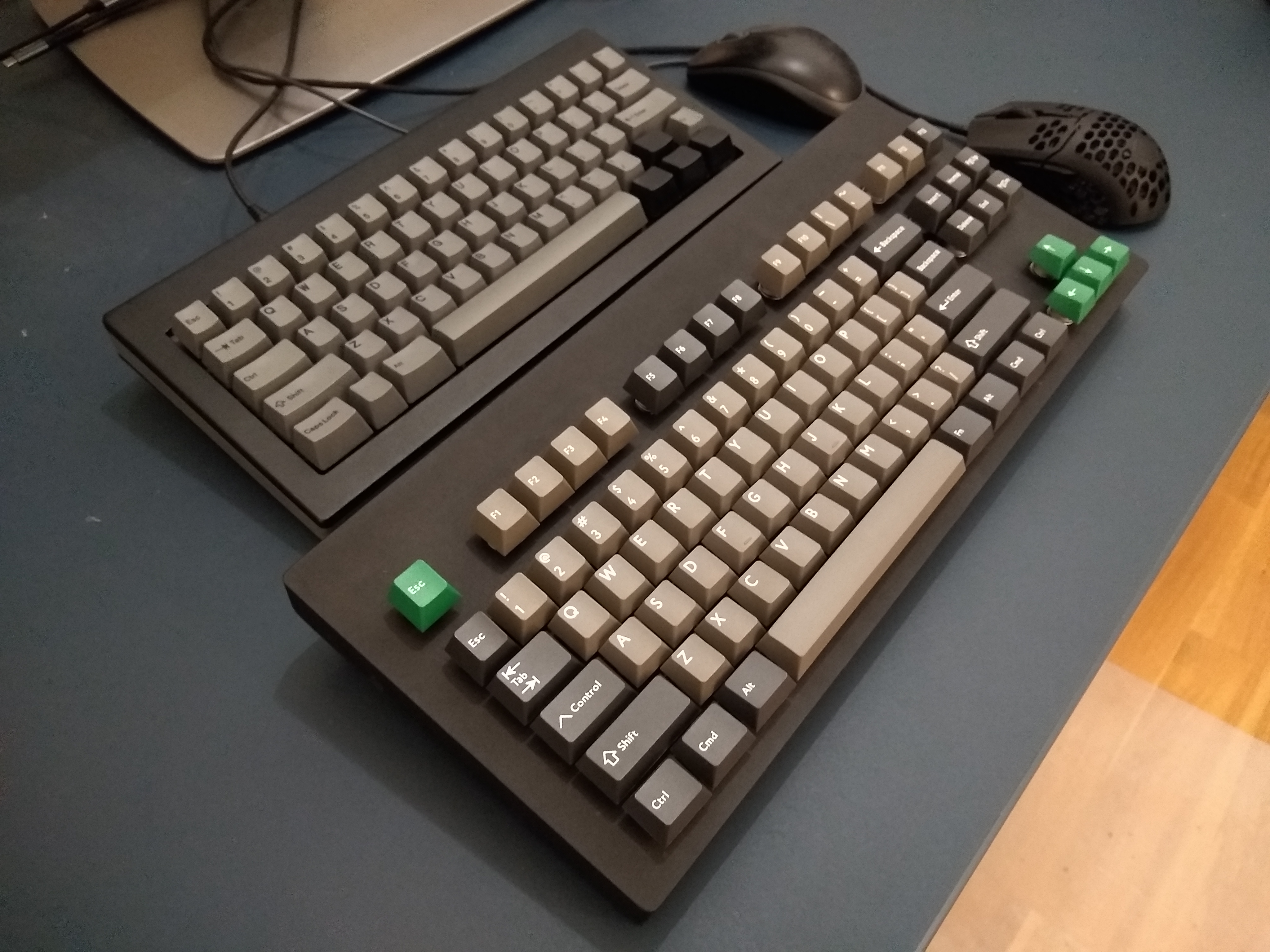

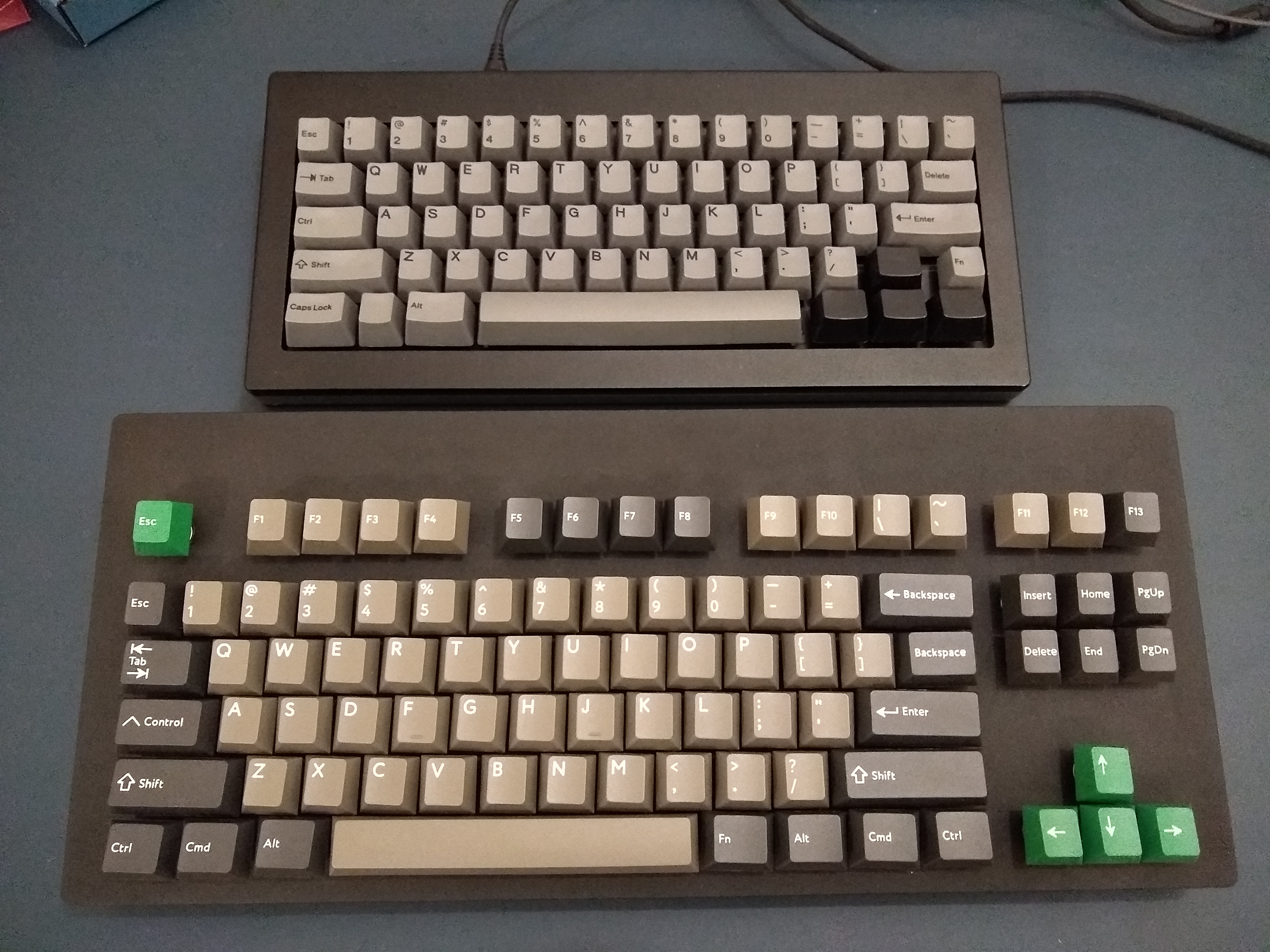

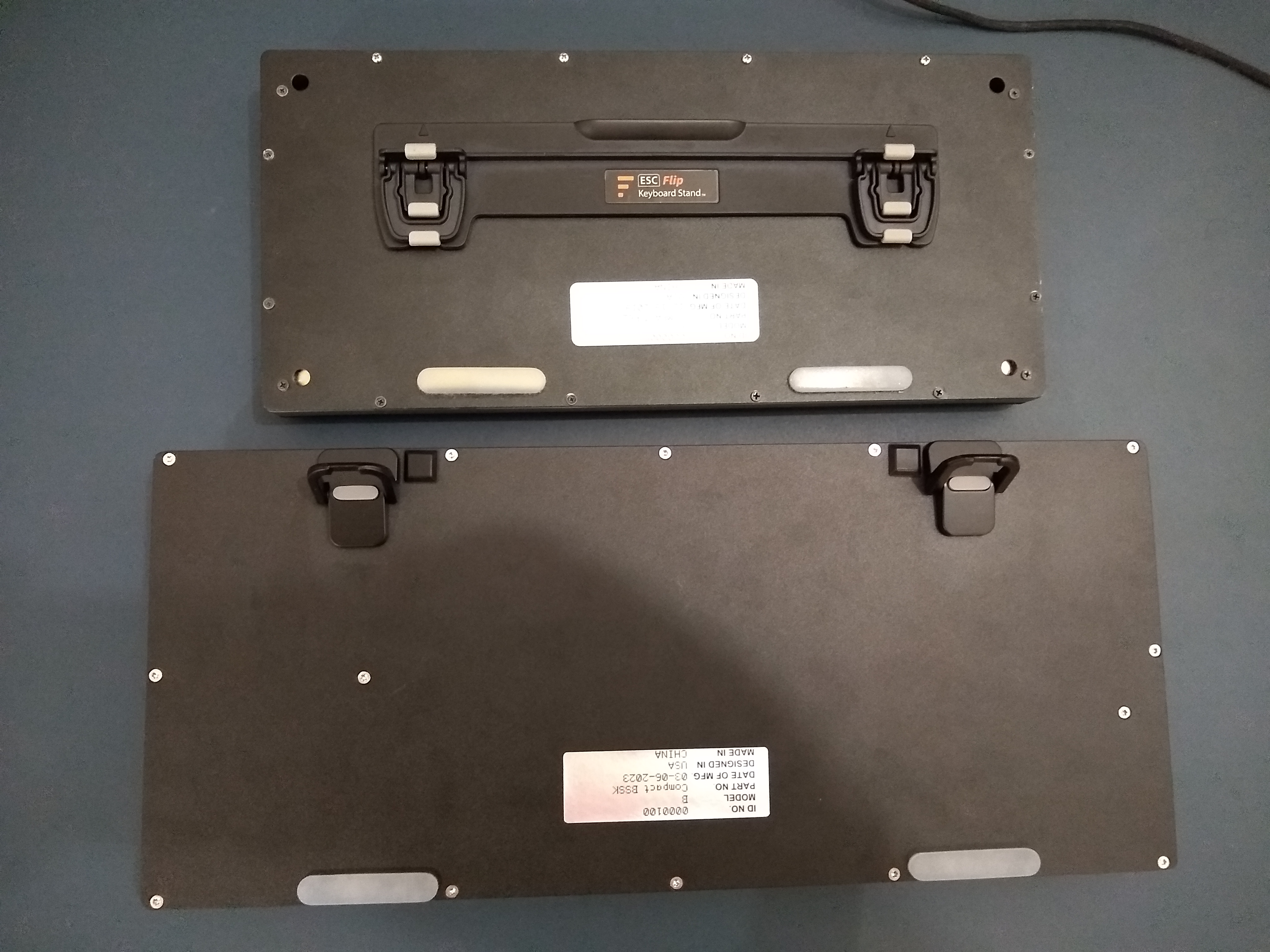

I've played some more and fitted some feet. My spacebar issues were solved by pulling the spacebar up off the stabiliser stems by 0.5 mm or so allowing the bottom of the spacebar to rest at the same level as the surrounding keys. Next time I open the case I'll consider slipping a couple of washers in to mark the space (if possible). Most of the keys are noticeably twisted a little. Something correctable by nudging the switch bodies, I hope.
Some pics with a bit of rearrangement. F62 for comparison.

darkcruix wrote: 12 Apr 2023, 19:09 Just wanted to share that I found out that the Costar stabilizers work perfectly with the larger keys (>= 1.75U) and I have added them to the respective keys with great success. There is no modification required and fit just right in the cutouts of the top switch plate. The top hook of the costar stab set just has to be added to the larger key and the wire added to these hooks.
Nice discovery - did you try costar stabs with the space bar?
darkcruix
13 Apr 2023, 11:40
daedalus wrote: 13 Apr 2023, 00:12 ...
As the space bar is already perfectly stabilized, I didn't do anything there, but I don't see any reason, why it shouldn't work in the same way. The cutouts are the same and the length of the standard stab wires are fitting the cutouts also.
I can only say after the second day of heavy use, I am glad I made those changes. Don't get me wrong, the larger keys aren't super wobbly when not stabilized, but when you hit them at the very edge, you can feel that they give in a bit and this gets resolved by the costar stab.

Super discovery darkcruix. I like my keys firm, so this is a good simple way to ensure that.

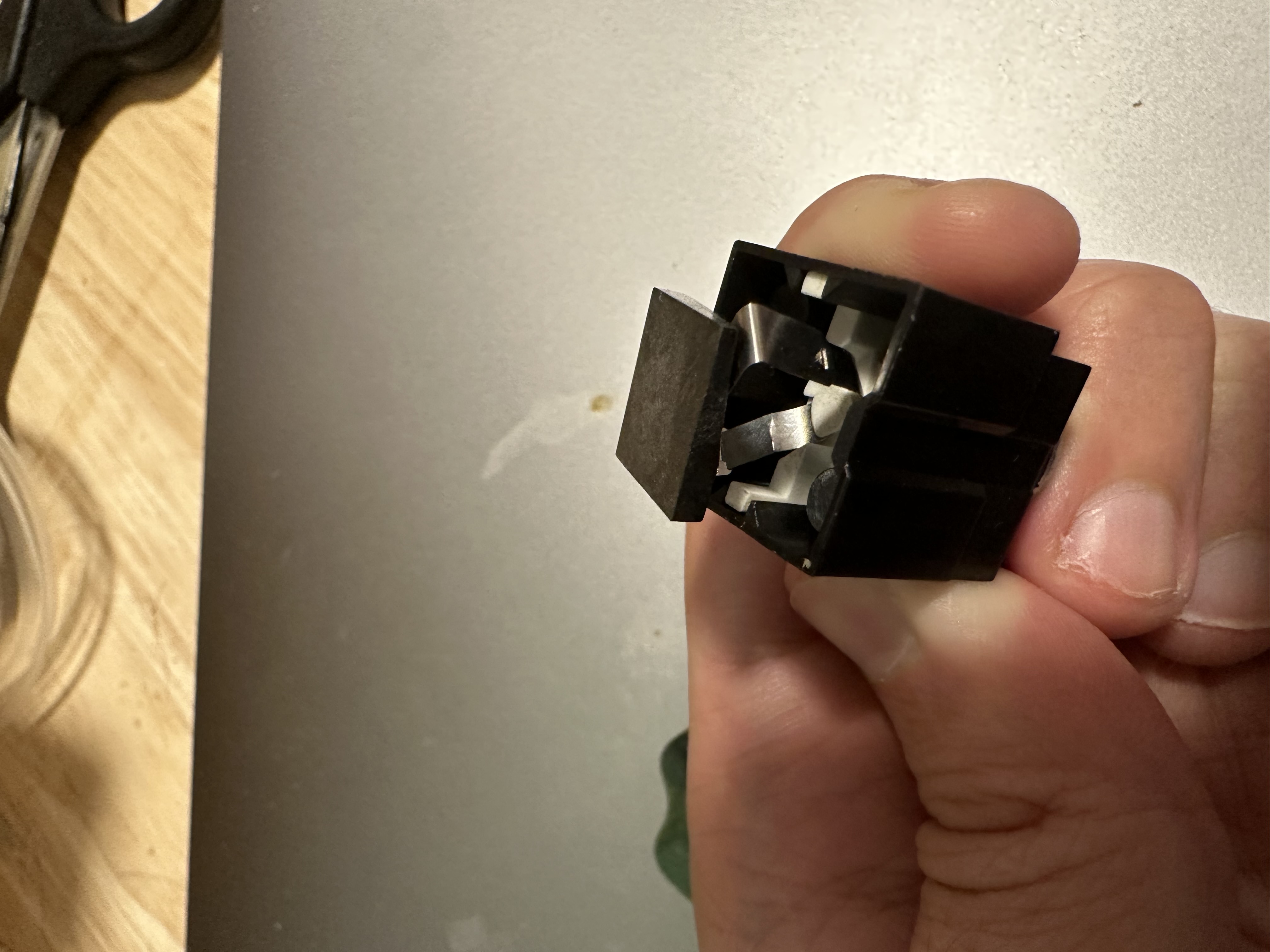

I'm wondering if anyone has the same issue as me. Two beam spring round 1 modules has failed in the same way so far in a span of a few weeks. The keys over time get stuck because the fly plate at the bottom gets creased.
I only have mine since 3 full days, so I can't give any factual feedback on that issue, but I am keeping an eye out. I plan to do a little review after another week or two of using it as my daily driver. So far, it was 100% reliable out of the box and I only added the stabializers.

szechun this is one of the QC issues mentioned in the setup video in the manual, and one area of improvement that Round 2 will have. With the mini first aid kits included with each keyboard, I expected that 4 modules would need replacement within the first few weeks and if more are unrepairable then the limited warranty would likely apply and I would send replacement part B's.
The folding is an assembly error that may show itself if a module is not clicking well during the initial testing (if they folded the metal part too much during assembly). Often if the module clicks but clicks weakly, or is too slow to return after being pressed, the part B (the white inner plastic part and its included metal part) may need replacement if it cannot be repaired with the technique in the video. In the setup video in the manual, I showed an example of this exact situation where the metal was accidentally folded and showed how to fix it with tweezers, which works much of the time but not all of the time (other times replacement would be better).
I noticed some creased modules and let the factory know to avoid too much folding, so it will not occur for the Round 2 production (one of the QC advantages of Round 2 is less setup work, as noted earlier). I have not noticed modules developing a crease where there was no crease before.
If anyone runs into this issue the white part may need replacement if it cannot be fixed by tweezers; a fold does not necessarily indicate a part that is more likely to break however. I ordered several thousand extra beam barrel part B's and other parts to be safe. This is one example of the Round 1 boards requiring more setup time in the initial weeks compared to the Round 2 boards, but these issues are usually covered under the limited warranty so no one is left with a nonworking board.

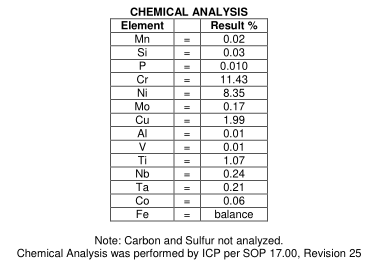

There was some discussion last year about getting the right "exotic" material for the very thin metal part for beam barrel. Thanks to the material analysis posted by the interesting Silo beam switch project that is no longer underway (its goal was to offer significantly miniaturized MX-style switch modules with characteristics matching the beam spring switches), I have been able to find the material, which may have been updated slightly in modern times regarding the presence or absence of some of the trace elements.
It seems like IBM may have used the relatively new S45500 for the original material - aka "Custom 455," trademarked in 1969 and first introduced to commerce in February 1965, right around the time that IBM started development work on the beam spring keyboard. The material is still considered exotic today and not easy to find. Details of the material history: https://trademarks.justia.com/723/26/cu ... 26498.html
This will hopefully be another improvement for the Round 2 keyboards. "It possesses a yield strength which is nearly 3 times the strength of grade 304 stainless steel" according to https://www.azom.com/article.aspx?ArticleID=6853 so the Round 2 boards may have a longer potential MTBF, although this is likely to be a distinction without a difference given the metallurgical improvements over the past 50 years far outweighing the imperfections of the available materials IBM had to work with in 1970: maybe the MTBF is sufficiently high for both boards that it would not be the first point of failure, but we'll have to wait years I guess to see the real-world usage. Round 1 boards used a premium variation of the standard SUS 304 stainless steel (there are too many variations of how this material is prepared and cooled after heating so it could be considered many materials under an SUS 304 umbrella).
Chemistry Typical per datasheet, reordered to sync with the Silo presentation below https://d2ykdomew87jzd.cloudfront.net/d ... S45500.pdf
Manganese: 0.50 max
Silicon: 0.50 max
Phosphorus: 0.040 max
Chromium: 11.00-12.50
Nickel: 7.50-9.50
Molybdenum: 0.50 max
Copper: 1.50-2.50
Titanium: 0.080-1.40
Columbium + Tantalum: 0.10-0.50
Carbon: 0.05 max
Sulfur: 0.030 max
Iron: Balance
Beam switch metallurgical analysis as published by the Silo team:
ibm beam spring metal material analysis silo switch 8217f9a515042d2c5889a93ec790bd3d_original.png
ibm beam spring metal material analysis silo switch 8217f9a515042d2c5889a93ec790bd3d_original.png (21.67 KiB) Viewed 195521 times

Following darkcruix's example, I have installed some Costar plate mounted stabilizers on my R1 beamspring keyboard. They were easy to install, and help mitigate the wobble/instability of the 2u+ keys. I also installed it on the spacebar, which does not obviate the need for the separate return spring, but at least makes it easier to replace the keycap without opening the keyboard.
Would strongly recommend using this setup, and I also rescind my earlier suggestions that the stabilizer cutout holes be removed from the R2 keyboards :)
