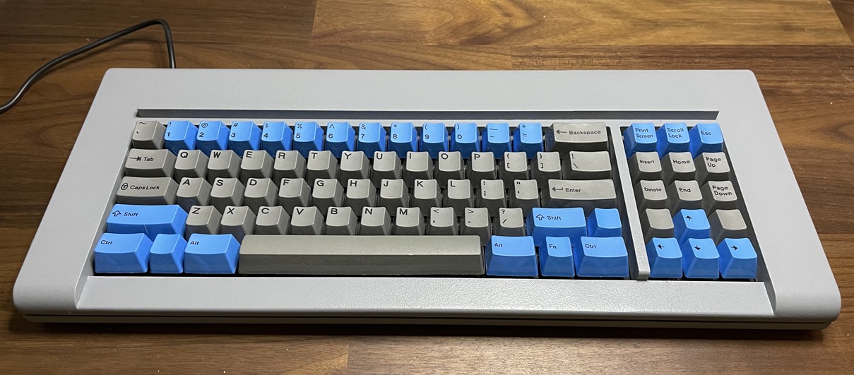

I am sharing (with permission) another nice color combination that someone sent me, with the plan to install the custom 12 Key Industrial SSK set when it is ready (the factory is still wrapping up the remaining custom keys and sets and should wrap things up by year end - the approval process has taken longer than expected for these sets but I'd rather see adequately-aligned sets before rapid sublimation can start - every offered key set style has its alignment and content checked to make sure it is good, before the remaining sets can be sublimated).

Ellipse wrote: 22 Nov 2021, 18:10
What is the case color on that one? I can't tell from the white balance if it's beige or industrial grey?
I've ordered industrial grey but have been starting to like the beige more and more!
