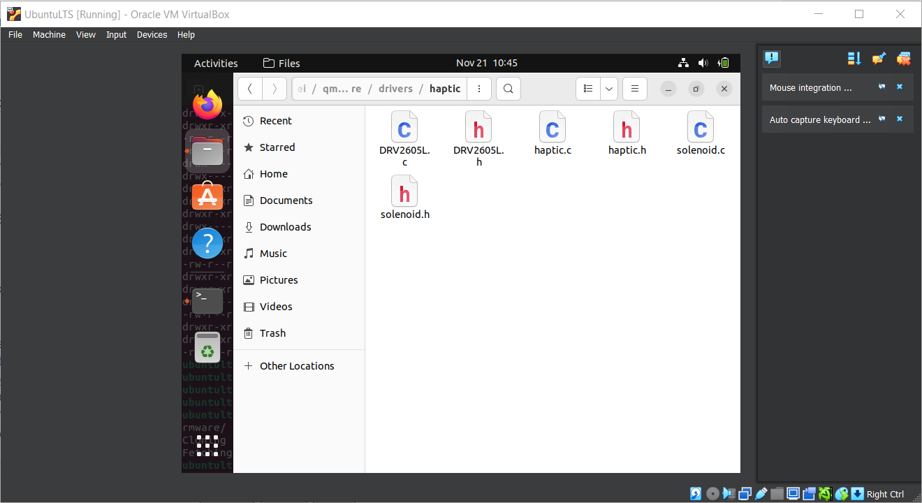

I have been following the manual's instructions, on section "Firmware - Via/Vial, QMK, xwhatsit", under "For those flashing firmware for first time on a computer", below Step 31 "New procedure from scratch Ubuntu install".
I set up a VirtualBox UbuntuLTS instance, updated the system and installed qmk, cloned the qmk_firmware_andrei repo, and copied qmk_firmware_andrei/qmk_firmware/keyboards/xwhatsit/ folder to qmk_firmware/keyboards/ folder.
I cannot find a haptic.c file within the qmk_firmware/keyboards/xwhatsit/ folder and subdirectories, and qmk_firmware/keyboards/xwhatsit/brand_new_model_f/f77/wcass/ folder.
Instead I found a haptic.c file in qmk_firmware_andrei/qmk_firmware/drivers/haptic/, screenshot attached.
Should I be copying over that directory and its contents to qmk_firmware/drivers/haptic? The latter does not have haptic.c and haptic.h files, only the other 4 .c and .h files.

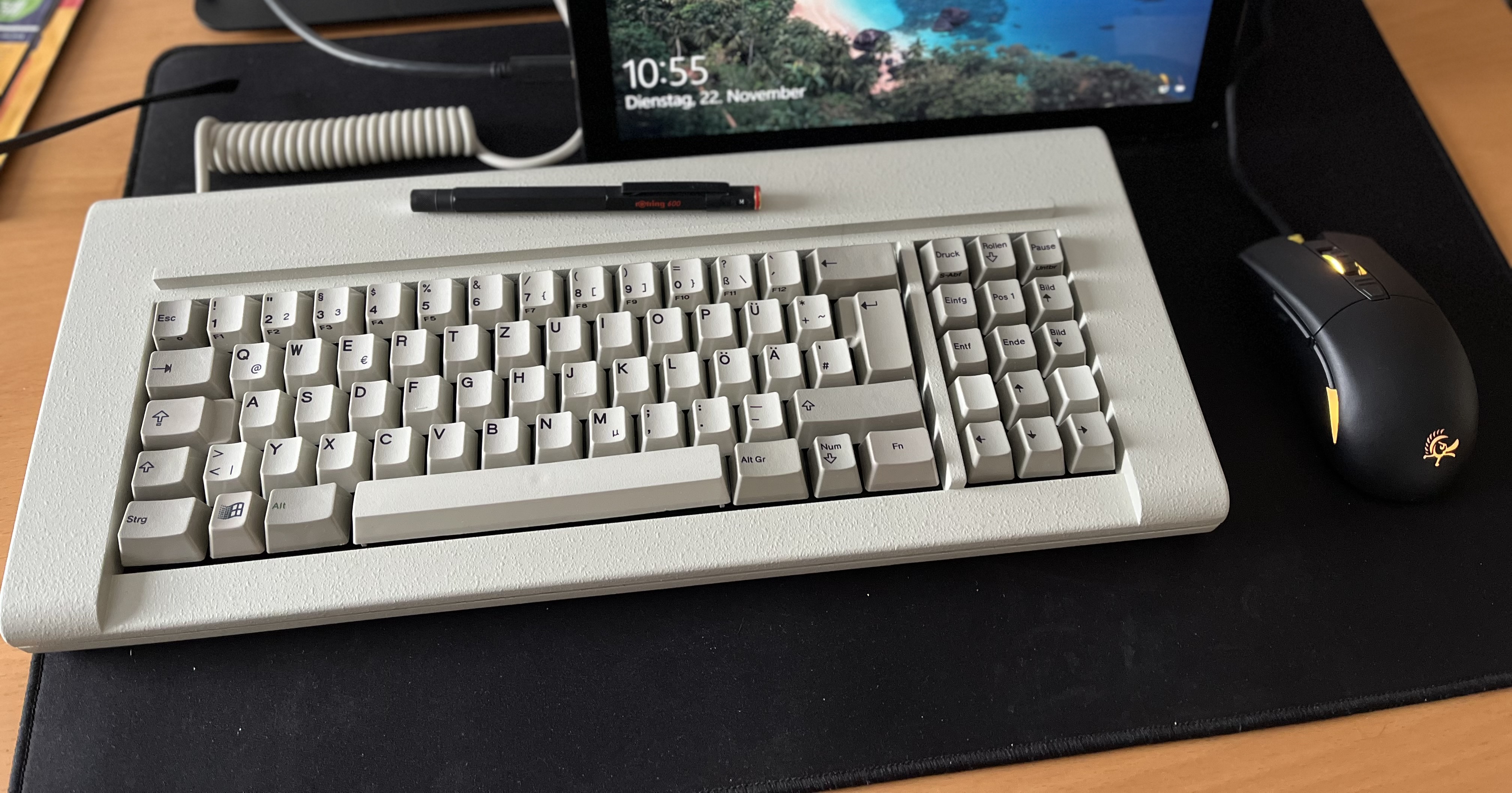

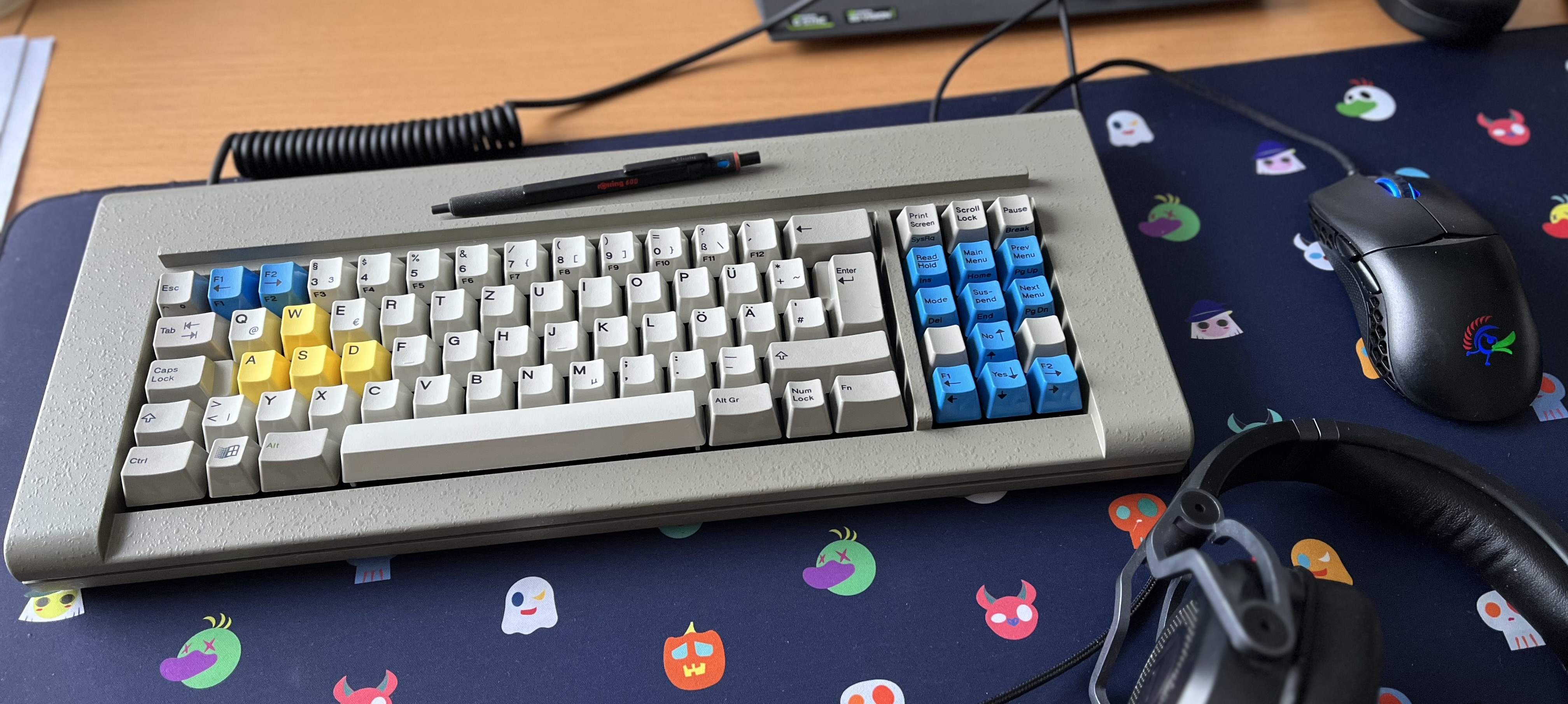

Here are two F77 classic case style keyboards from the same person, with a customized German layout including the Industrial SSK 12 key set, German front print F1-F12, and keys from Unicomp: 1.5 Fn centered, Windows, and yellow WASD. Posting with permission.
customized German (2).jpg (1.49 MiB) Viewed 26802 times
customized German (1).jpg (1.76 MiB) Viewed 26802 times

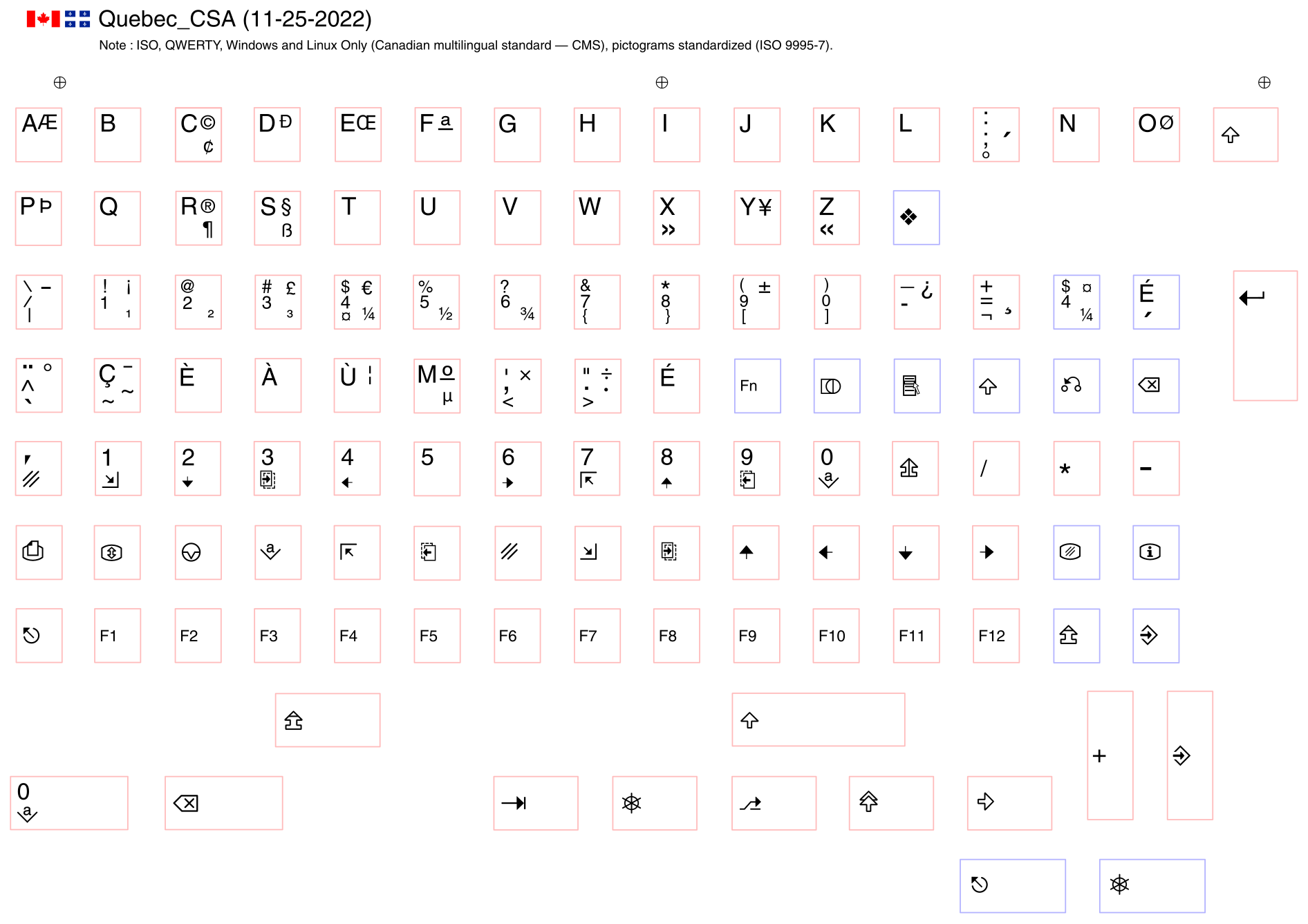

We have a new draft key set submitted today - Quebec CSA!
Please email or message me if interested in ordering this set. I will be ordering several copies from the factory.
If you have any feedback, please let me know in the next few days so I can update the file if needed before it goes to the factory.
Here are some notes that I was sent:
- This layout works only on Windows and Linux, Apple has developed its own CSA keyboard, called Canadian French ― CSA but it’s not exactly the same keyboard layout. Apple respect only partially this standard (the ligature œ is located with q for example). If you are interested I can send you another template using this layout. For now, I am interested in the Windows/Linux version.
- 4¤ and É are drawn twice because the Linux version is different and doesn’t use the € sign.
- I am interested in the F77 industrial grey with the Numpad #3 (with an arrow inside a diamond for the Enter key used in the Numpad).
- I am also a VIM user and I would like if possible a second Caps Lock key with the proper Esc pictogram, not ESC or Esc but an arrow inside a circle, it’s there in my template.
Ideas (relocate ESC key):
1) Home Row (where caps lock is, then relocate caps lock between
ctrl and alt)
2) Between ctrl and alt
Other points :
In the newest version, the ligature Œ must be printed (E key).
Also, the pictograms must be used instead of english or french labels,
same thing over the numpad.
The triangle replace the decimal separator (numpad).
- Return and Enter are pretty similar but are not exactly the same.
Enter (arrow inside a diamond) go with the numpad). Return (just the arrow pointing left) to with the alphanumeric keys.
- The pictogram "centering" with the 5 key (numpad) is now obsolete and can be skipped.

herald
26 Nov 2022, 10:53
Ellipse wrote: 26 Nov 2022, 03:15 - I am also a VIM user and I would like if possible a second Caps Lock key with the proper Esc pictogram, not ESC or Esc but an arrow inside a circle, it’s there in my template.
ctrl and alt)
If you want to be true to the roots of vi, you would place Esc at the Tab position where it was originally developed! The question then is where to relocate the Tab key. Personally I ended up having it above Enter in ANSI layout. If you have have an ISO Enter, you could bind it to Fn+Enter. Or just leave it at its original position invoked by holding Fn.

Bionicman wrote: 21 Nov 2022, 19:56 Instead I found a haptic.c file in qmk_firmware_andrei/qmk_firmware/drivers/haptic/, screenshot attached.
I edited `qmk_firmware/quantum/haptic.c`. Although I got build errors, so too much has likely changed for this patch to still work. If only we knew which version/commit this patch was intended for - can be found out by comparing commit timestamps with the forum post here. I did that and you can run `git checkout 0e5d67145a649480fd49a72712997feb6303a471` in the qmk_firmware directory after running `qmk setup` to rollback the code.
I followed the same instructions with this checkout and it worked! Finally thanks to https://docs.qmk.fm/#/feature_key_overrides I have my lisp parens keys.
If you do not need newer QMK features, it would be safer and easier to just use QMK 0.0.30 as adviced here, under *Building the firmware locally on the command line*: https://docs.google.com/document/d/17Fq ... Og80w/edit
Edit: I see you just wanted to get your solenoid working for modifiers. I'd say try following the instructions again using the checkout.

Just a few things about this new layout (Quebec CSA) :
This layout was developed by a civil servant working for the government of Quebec in the late 80s (Alain Labonté). Unfortunately, he died recently, last summer. The goal was to modernize the traditional Canadian French layout made by IBM by limiting as much as possible the use of dead keys in french. The first version was standardized by the CSA Group in 1988, named Canadian French (Legacy) today if you use Windows http://kbdlayout.info/KBDFC/. In 1992, a second version was introduced (CAN / CSA Z243.200-92) http://kbdlayout.info/KBDCAN/ . This version is based widely on the previous version but adds a second group (Group 2), allowing you to type more characters (up to 5 characters per key). These characters can be activated if you press Ctrl-Right or Ctrl-Right-Shift. This layout is known as "Canadian multilingual standard (CMS)" on Windows. If you are Canadian you probably know this layout because it’s installed by default. Even if you remove this layout it’s reinstalled every time you accept a major update on Windows. This keyboard is QWERTY and was made primarily for typing in English and French but it can also type many other languages (up to 14 in this template sent previously by Ellipse). The government of Quebec in their call for tender specifies a higher standard called "Standard du gouvernement du Québec sur les ressources informationnelles" (SGQRI-001) (relatively well respected in this template!). This standard must include at least the most used characters in french, including «, », æ, œ and the characters used in Spanish (¡, ¿ ~, etc.). The label must also be written in french or preferably with these pictograms standardized. These pictograms are preferred because they are neutral. The last thing, the legends must be visible and last at least 3 years https://www.tresor.gouv.qc.ca/fileadmin ... qri001.pdf.
Another interesting thing, this layout is also standardized without the Ù. You can remap this key into a second shift key (1u) or another function key. You can also convert an ANSI keyboard with this layout (with a bigger À and the proper horizontal Return / Left-Shift), mostly used and available in North America http://3.bp.blogspot.com/_f1jwplw5jZ8/S ... C00084.JPG. The Ù can be replaced by a dead key (AltGr + ^ + u/U) and this character is used only in one word in french (où – where). It was made to be easy to use for English speakers, used by the US English layout.
If you want to use an old model F from the early 80s without the Ctrl-Right you must use the Canadian French (Legacy) layout (CSA 1988) which is pretty close but I have never seen this layout printed in my life :p. The Apple version (Canadian French ― CSA) https://forums.ubports.com/assets/uploa ... board.jpeg is somewhere between both. In this layout, the characters in your Group 1 respect the standard from 1992 but you don’t have a proper Group 2 like the old CSA 1988. I thought about this issue and the answer could be something like on Linux. On Linux if you use Gnome and you want to use this layout (CSA 1992), you must install 2 layouts: Canadian multilingual standard Part 1 and Canadian multilingual standard Part 2, then remap your ctrl-right and link both together. If someone creates a Canadian French ― CSA Part 2 on Apple activated from command or ctrl-right then you have something fully compatible with this template. Unfortunately, I had an Apple back in the early 2010s but my motherboard is broken and I can't test this idea. Even if I repair this computer the latest macOS is not supported.

So I did some searching through the thread and it seems that haptic.c used to be in drivers/haptic/ which was moved to quantum/ in later QMK versions, where defining HAPTIC_EXCLUSION_KEYS might have no effect. I found this pull request (https://github.com/qmk/qmk_firmware/pull/12386) which adds documentation (https://github.com/qmk/qmk_firmware/blo ... -exclusion) mentioning "`#define NO_HAPTIC_MOD` in config.h". If you open `keyboards/xwhatsit/brand_new_model_f/f77/wcass/config.h` you will see `#define NO_HAPTIC_MOD` on line 291. Commenting this out should result in the solenoid firing for mods.
To summarise: `#define HAPTIC_EXCLUSION_KEYS` in haptic.c has no effect any longer. This is now the default in config.h, called `#define NO_HAPTIC_MOD`, the removal of which should enable the solenoid for mods.

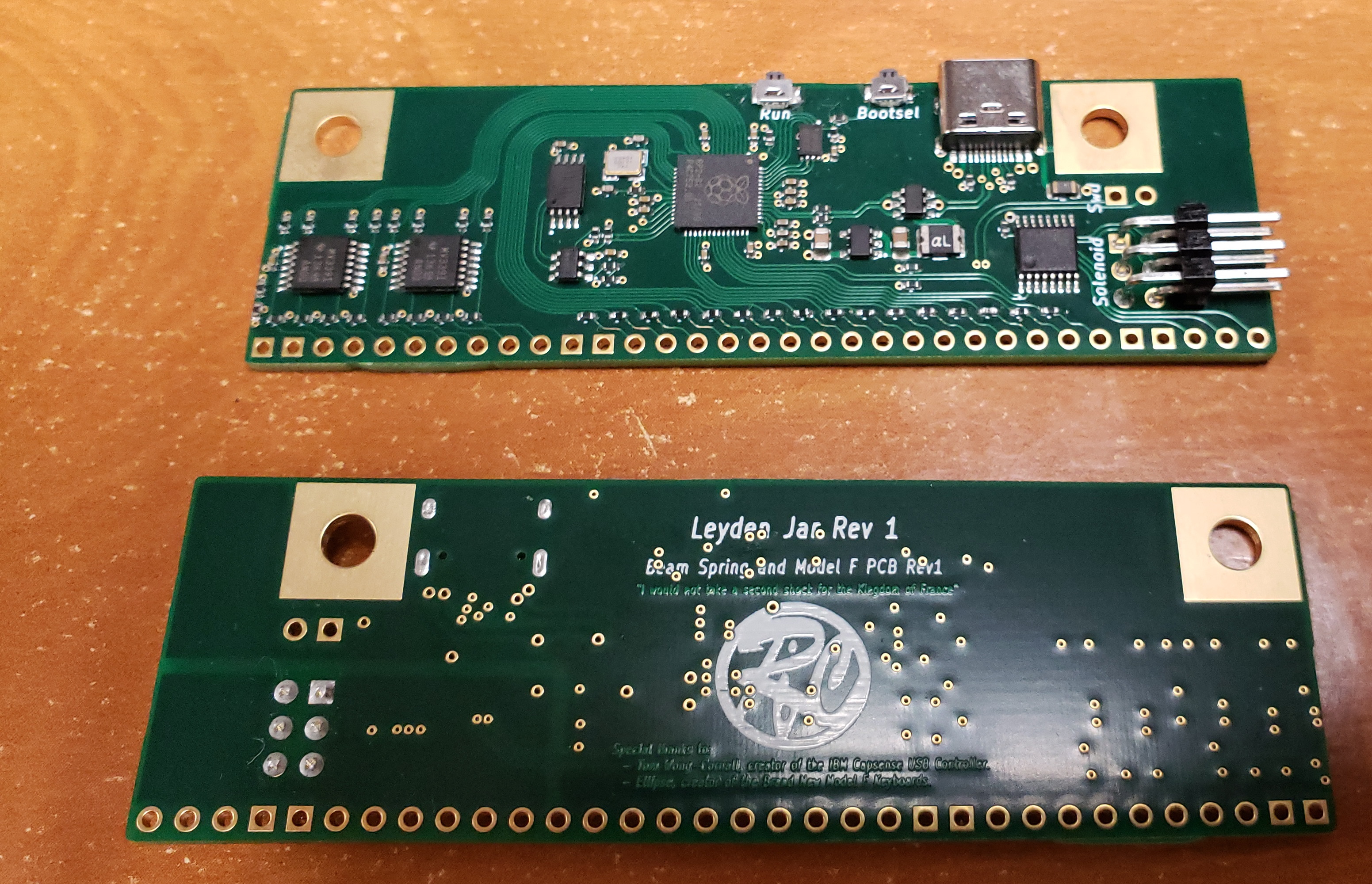

Rico's new RP2040-based controller samples arrived today!

Rico
01 Dec 2022, 19:29
Hello sedevidi
Could you elaborate a bit on the current status of this promising project, please?
Please let me give a quick status of this project.
This is the first revision of Leyden Jar PCB, a RP2040 based controller aimed to work with Brand New F77/F62 boards and in the future Brand New Beamspring keyboards as well.
Early QMK firmware is VIA/VIAL compatible with solenoid support.
It already works nicely on my own F77 board, now need to see if it works well on other people keyboards and on other board variants (F62 and Beamspring).
If PCB is proven to work well the project will be open sourced and made available to the community :)

Any comments with the Quebec CSA layout shown earlier? It has been submitted to the factory for the first run of a few sets.
