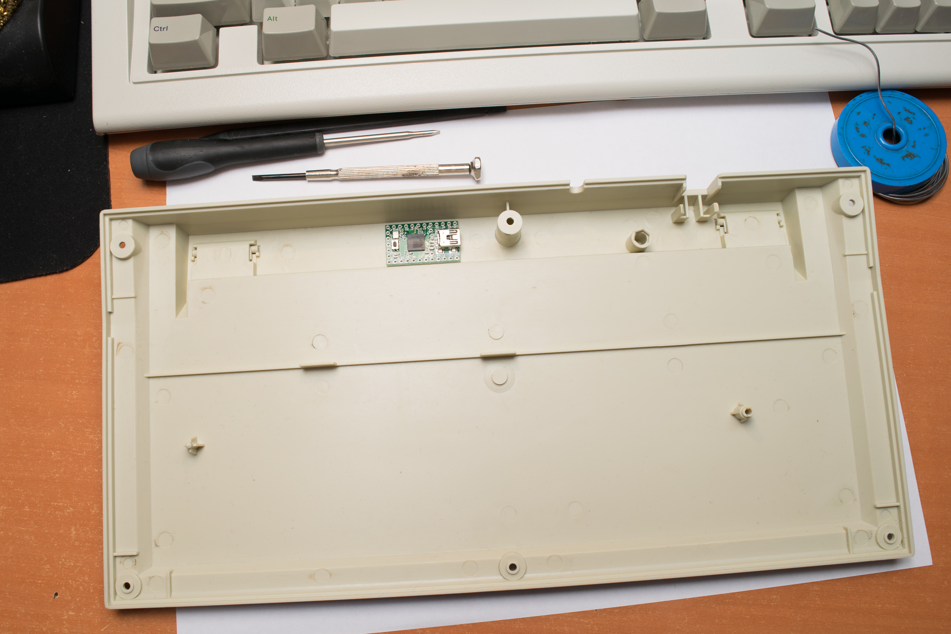

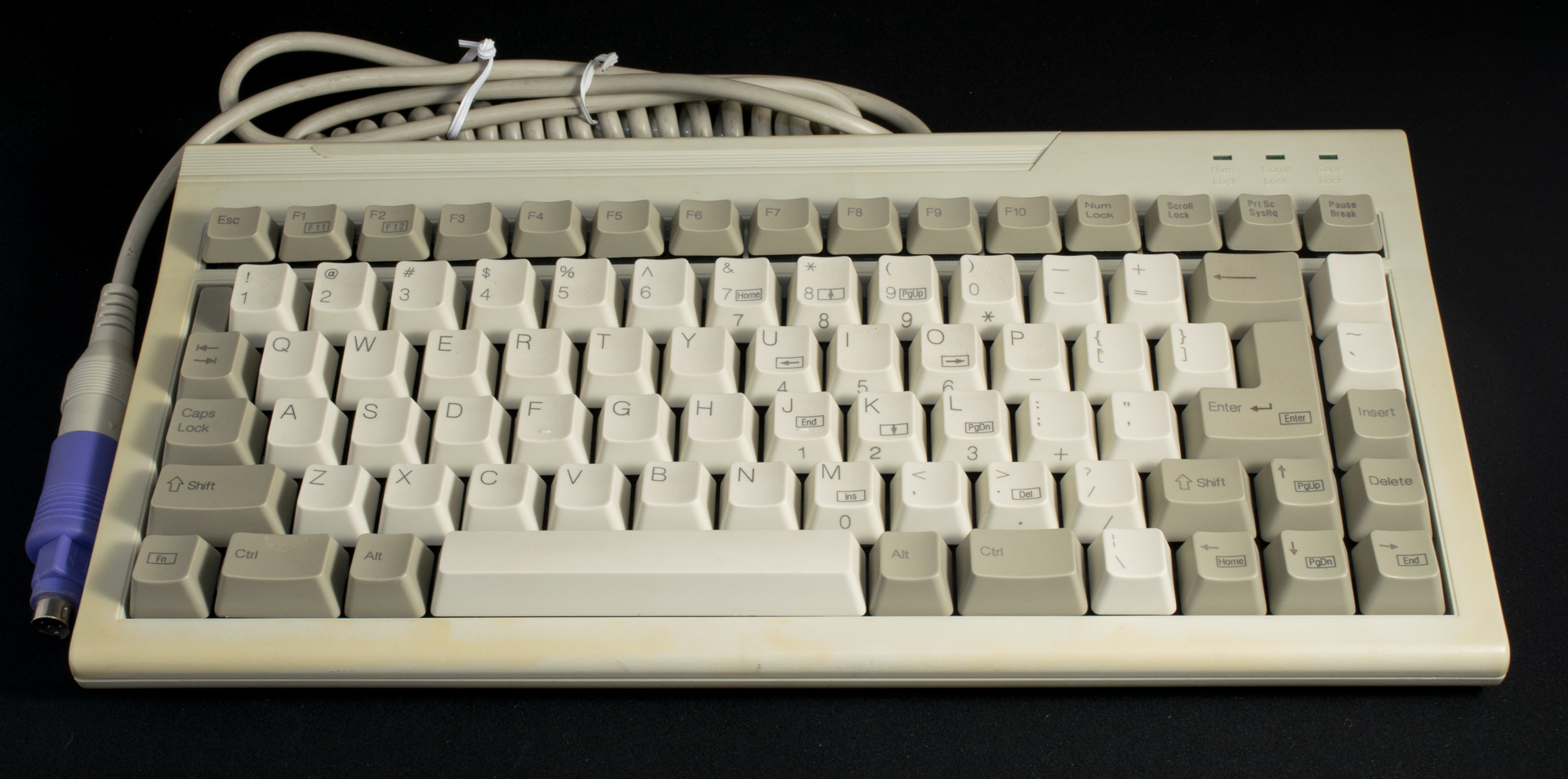

A few weeks ago I received a nice package from Daniel Beardsmore (more info here).
A Monterey K110 and a few goodies!

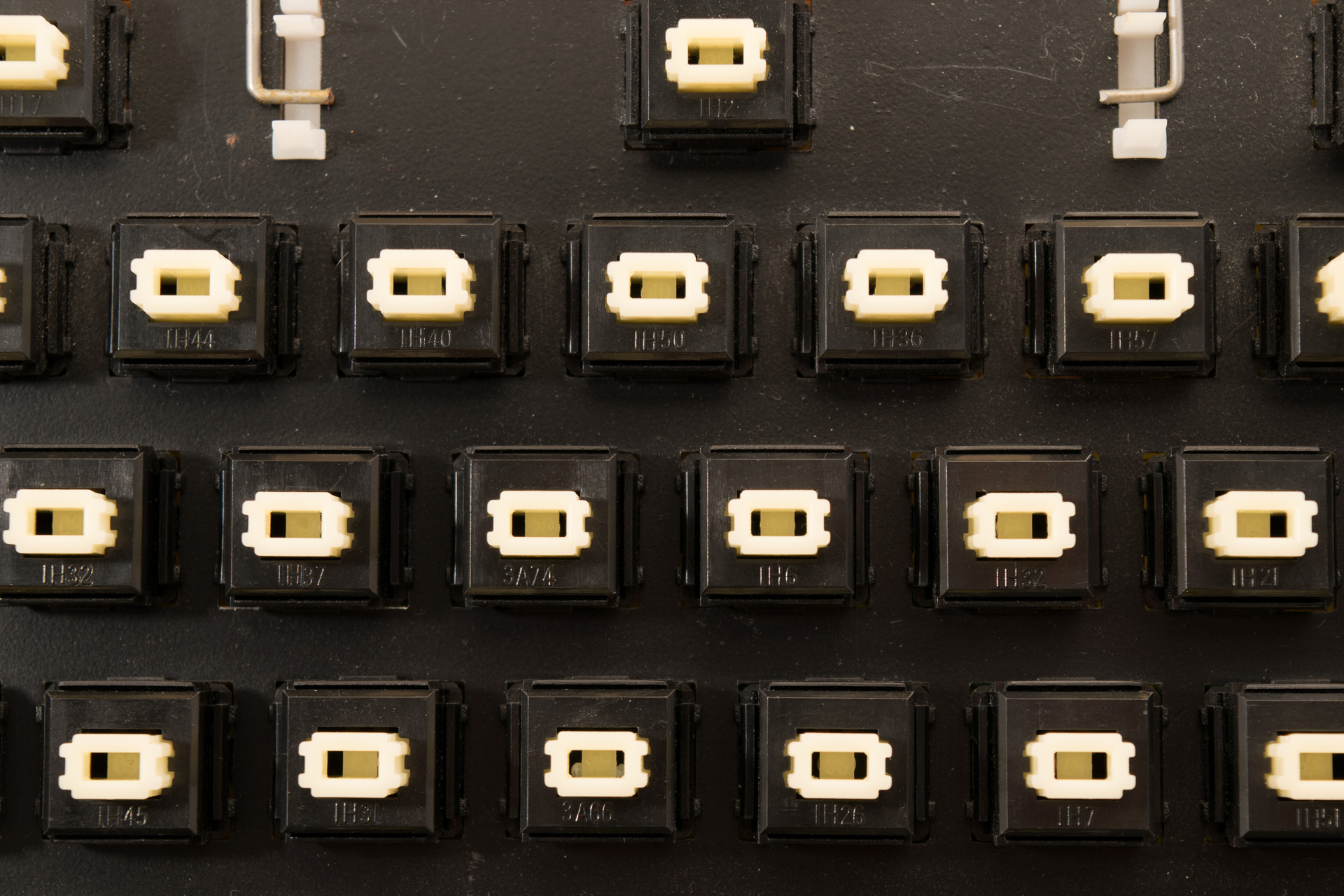

Fast forward to bare board..many switches

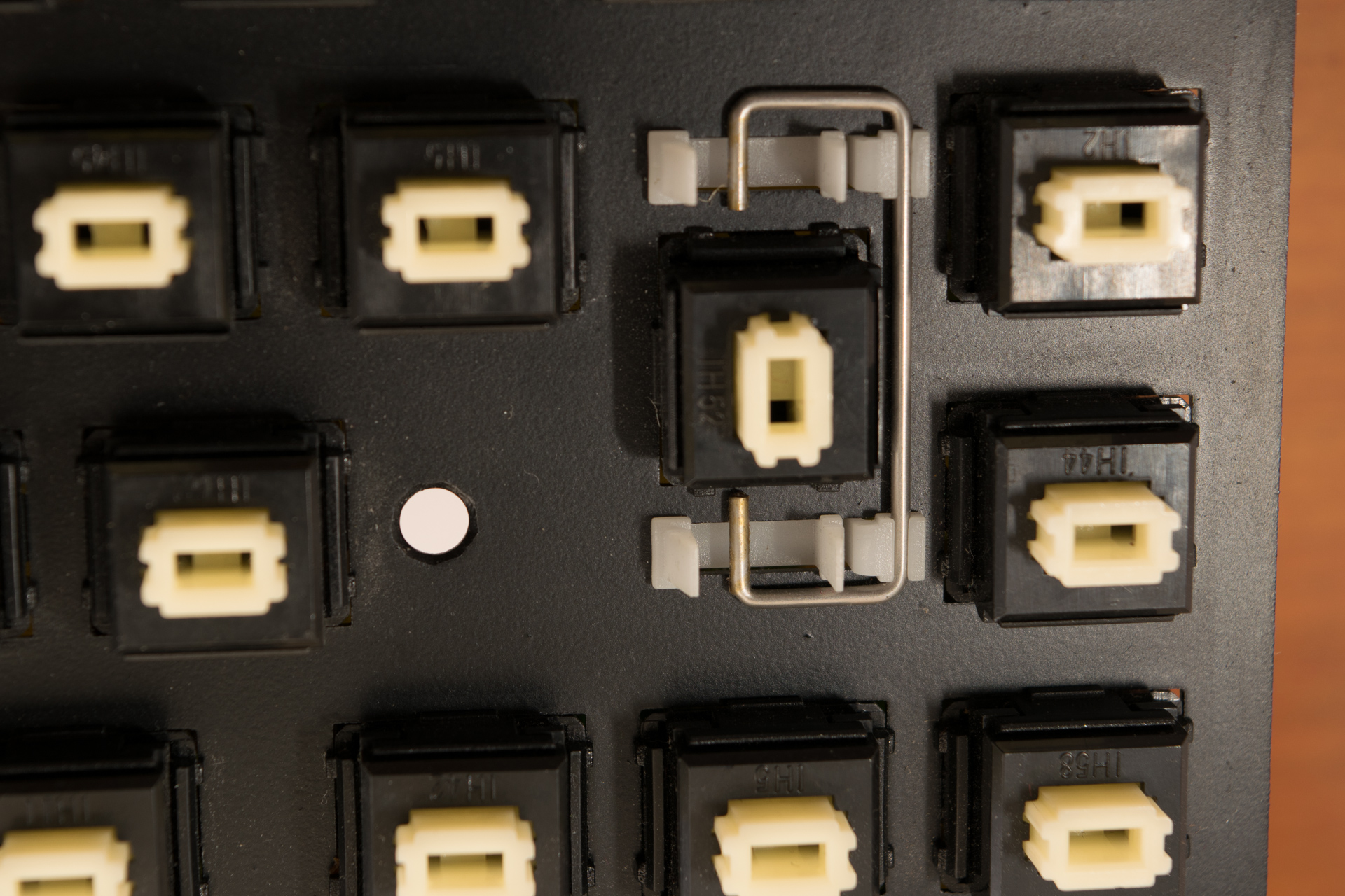

Note the Costar-style stabs
More switches!

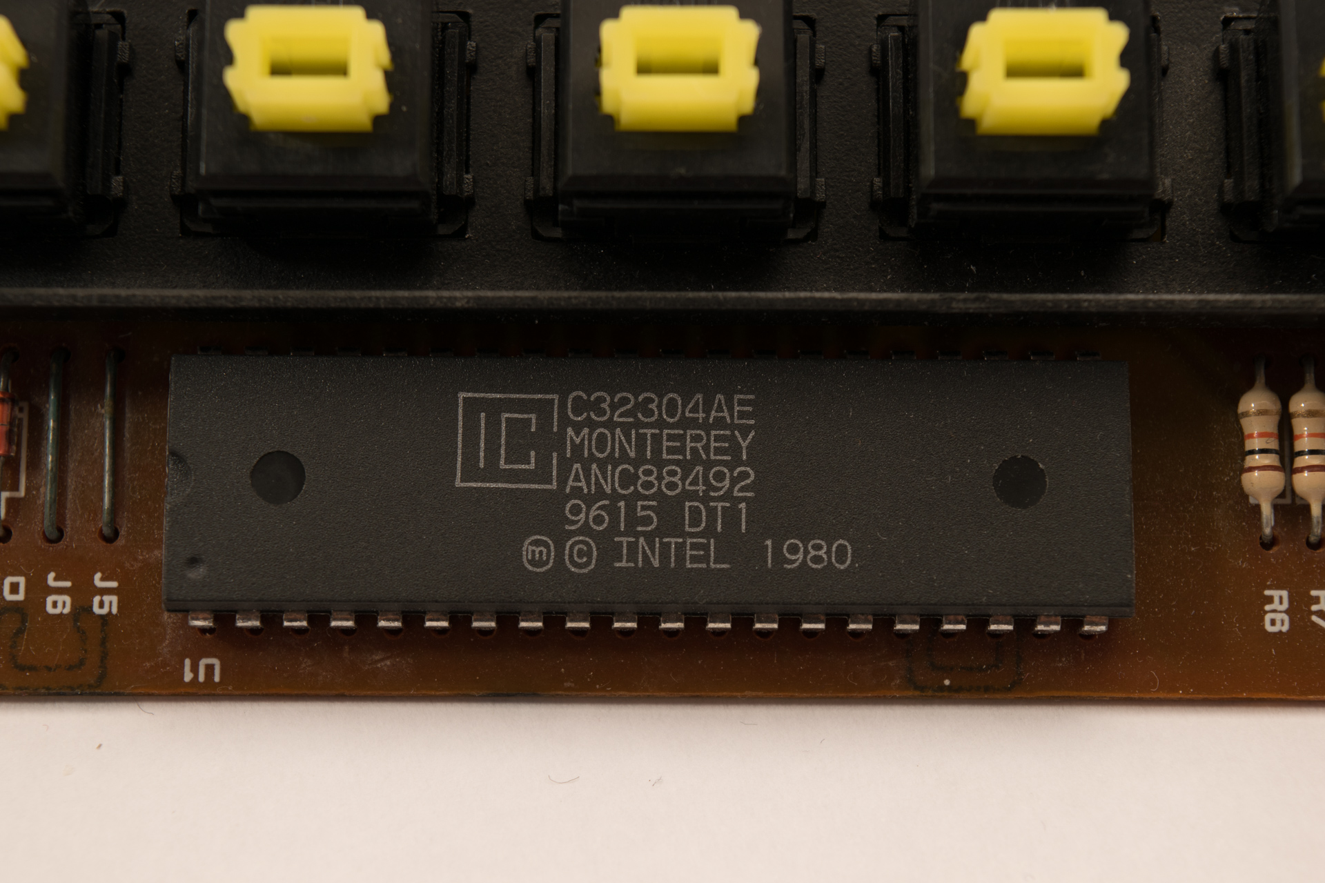

The controller

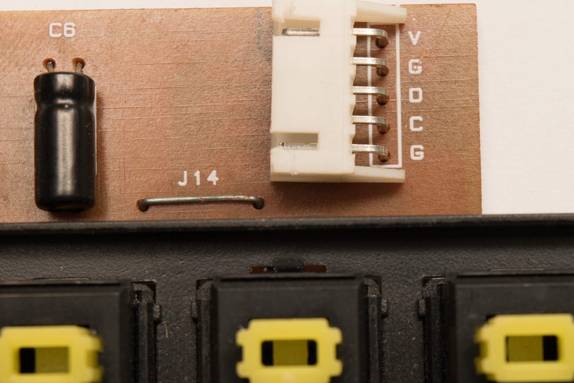

Clearly labeled connectors are a favorite!

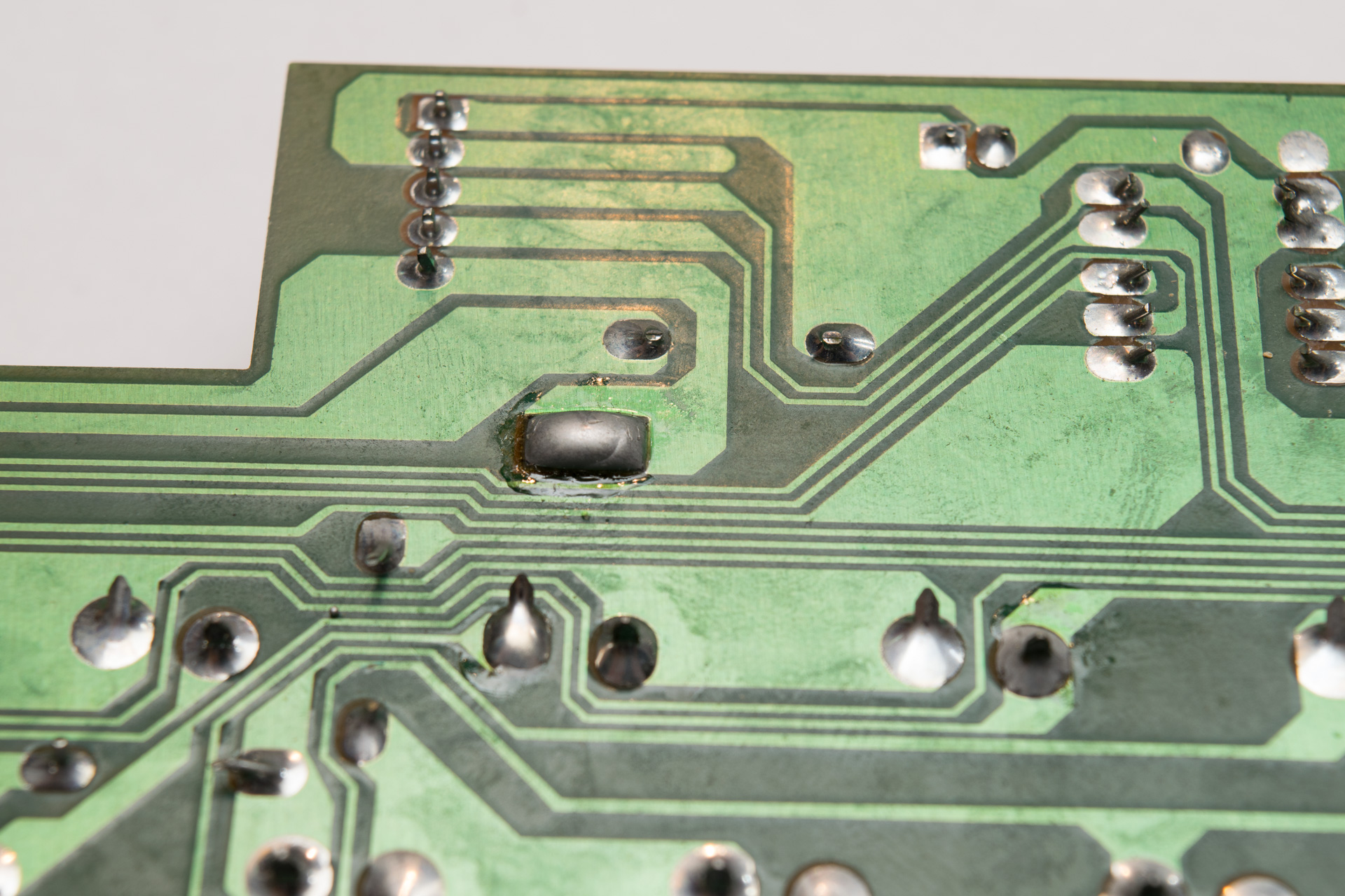

Grounding the plate with a solder blob...not so much..
Solder blob.jpg (679.26 KiB) Viewed 1794 times
other side.jpg (672.18 KiB) Viewed 1794 times

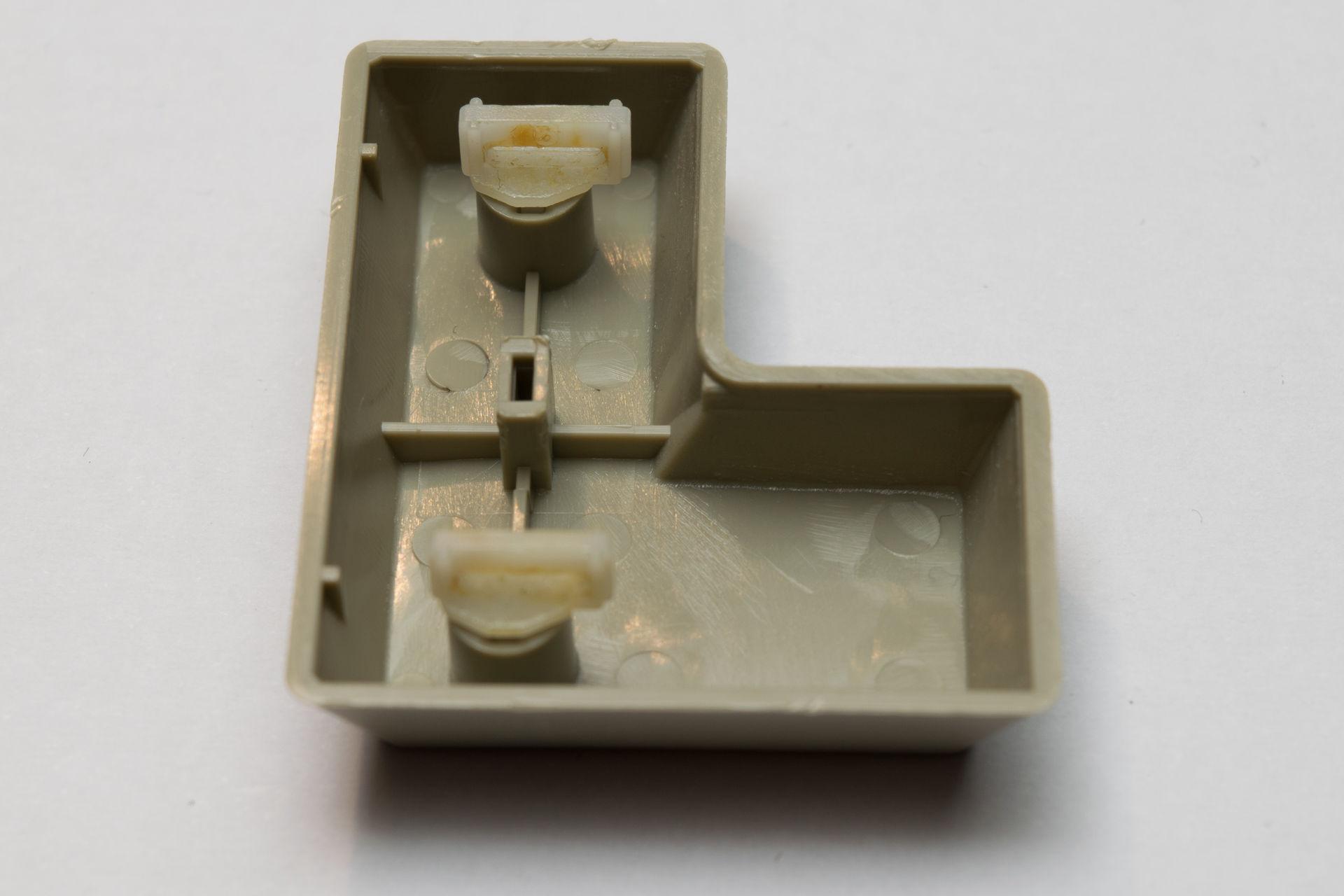

Small-ass Enter stab arrangement
Funky 20-year-old grease!

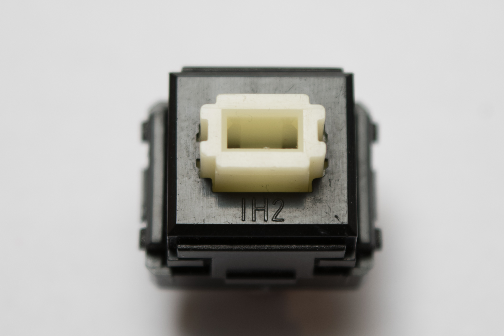

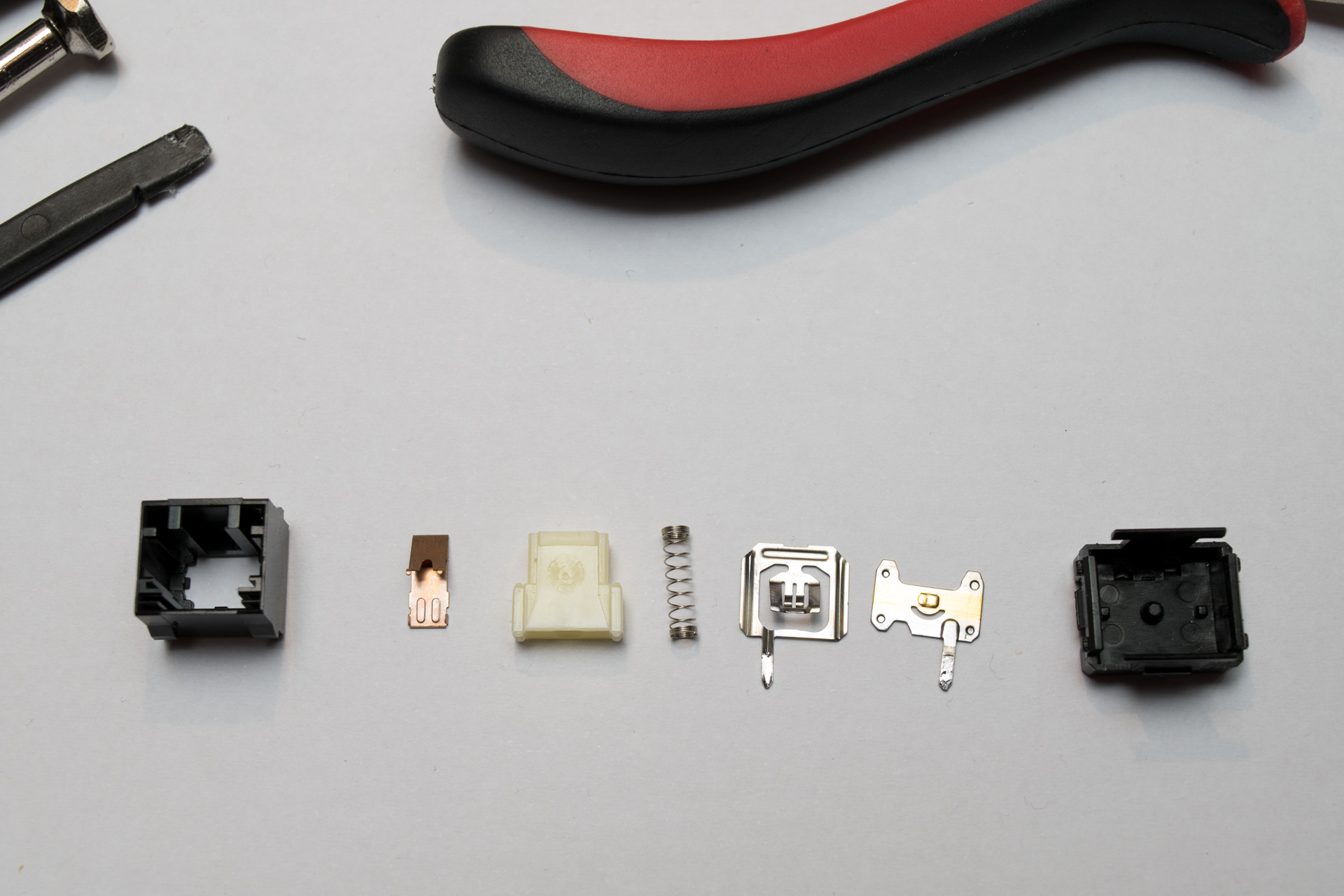

Bottom of Hua-Jie switch
Top with numbering, varies across the board

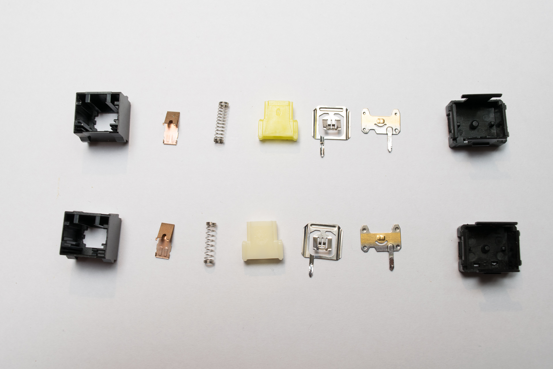

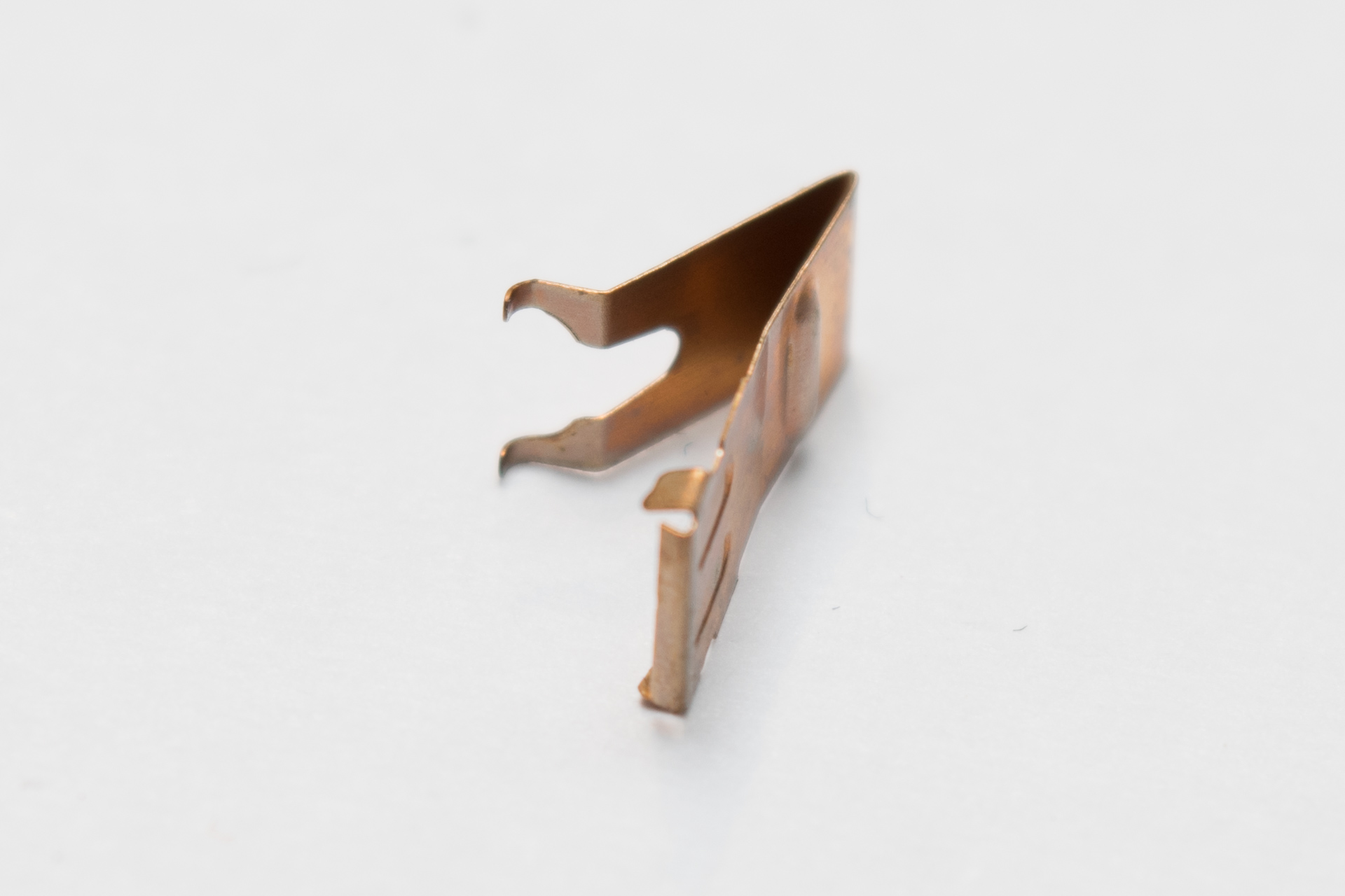

Internals
The click leaf. Very "snappy" and satisfying click. Remove it and you've got a smooooth linear switch!

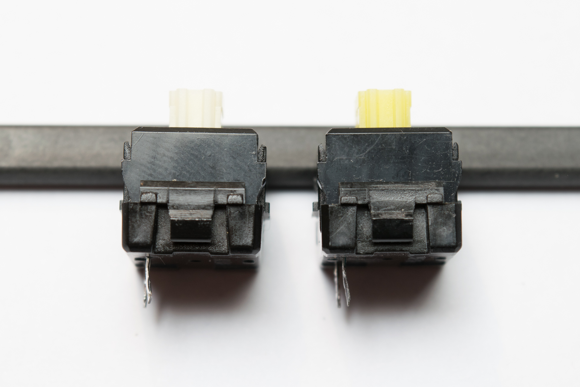

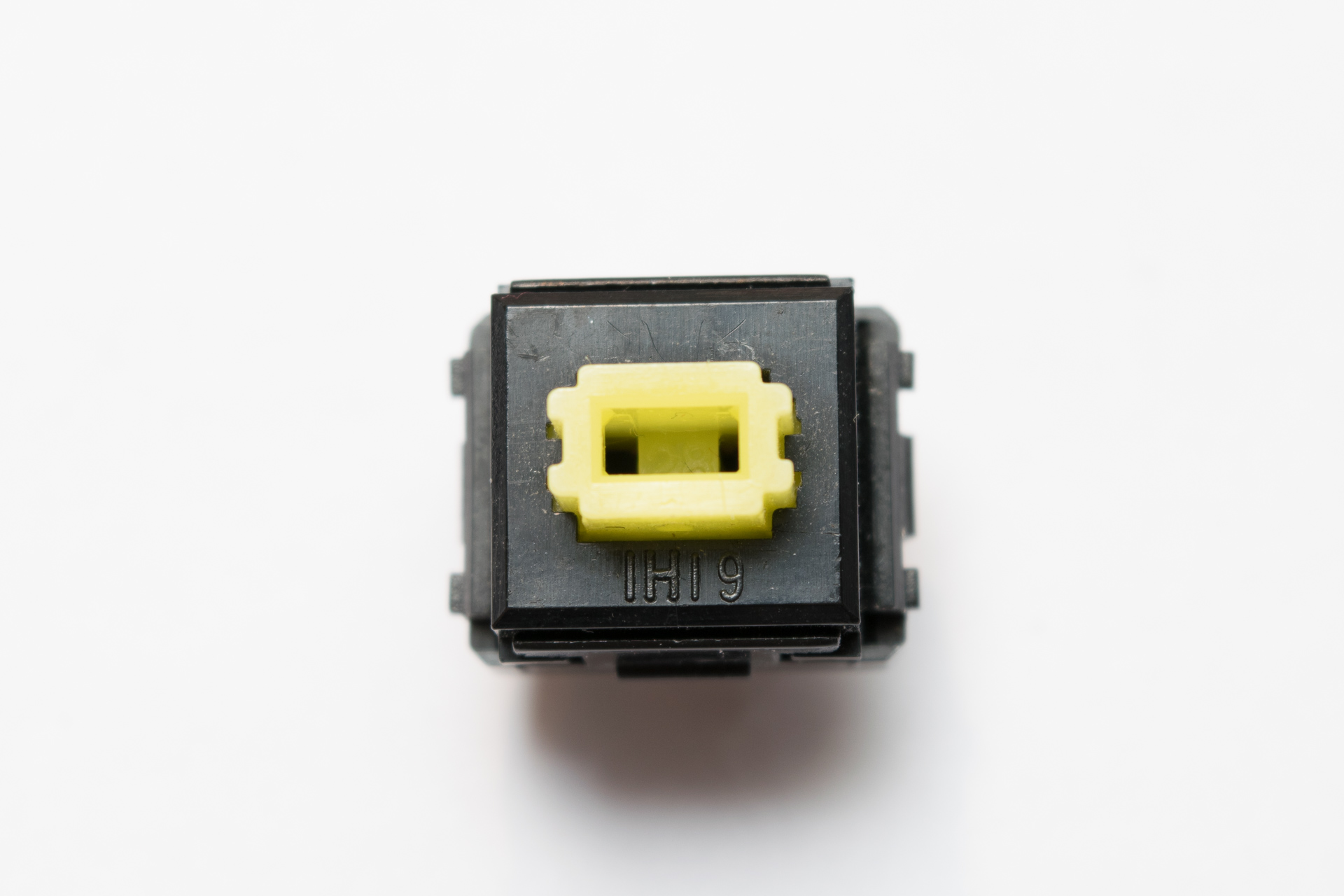

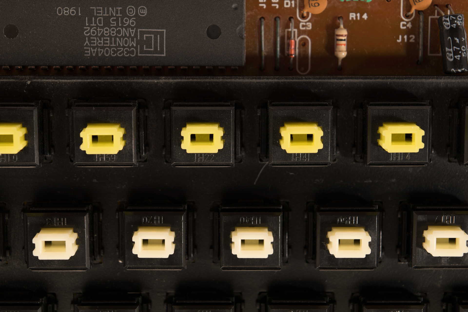

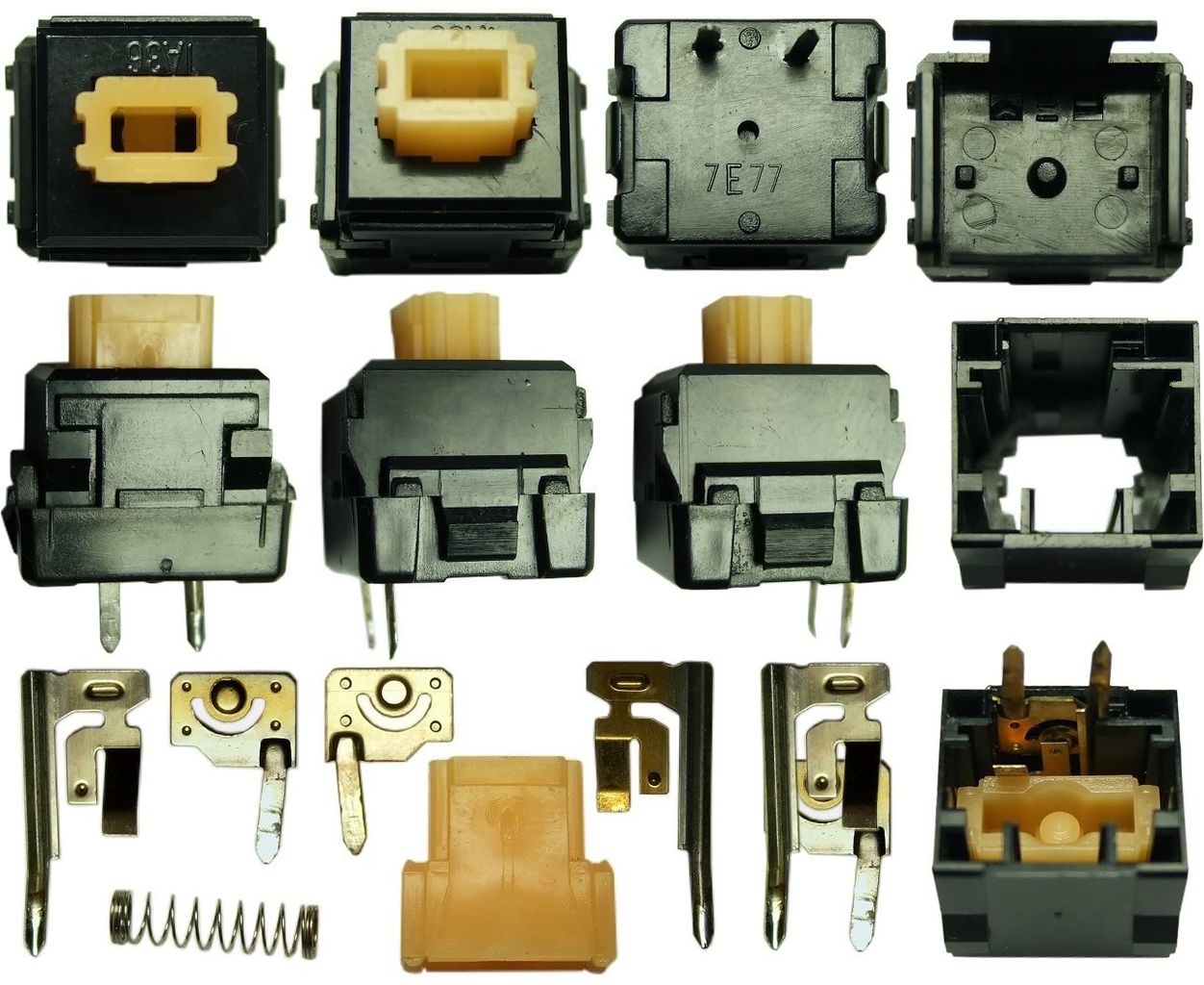

One of the yellow switches (from the F-row).
It has a shorter travel but feels the same. How did they do it?

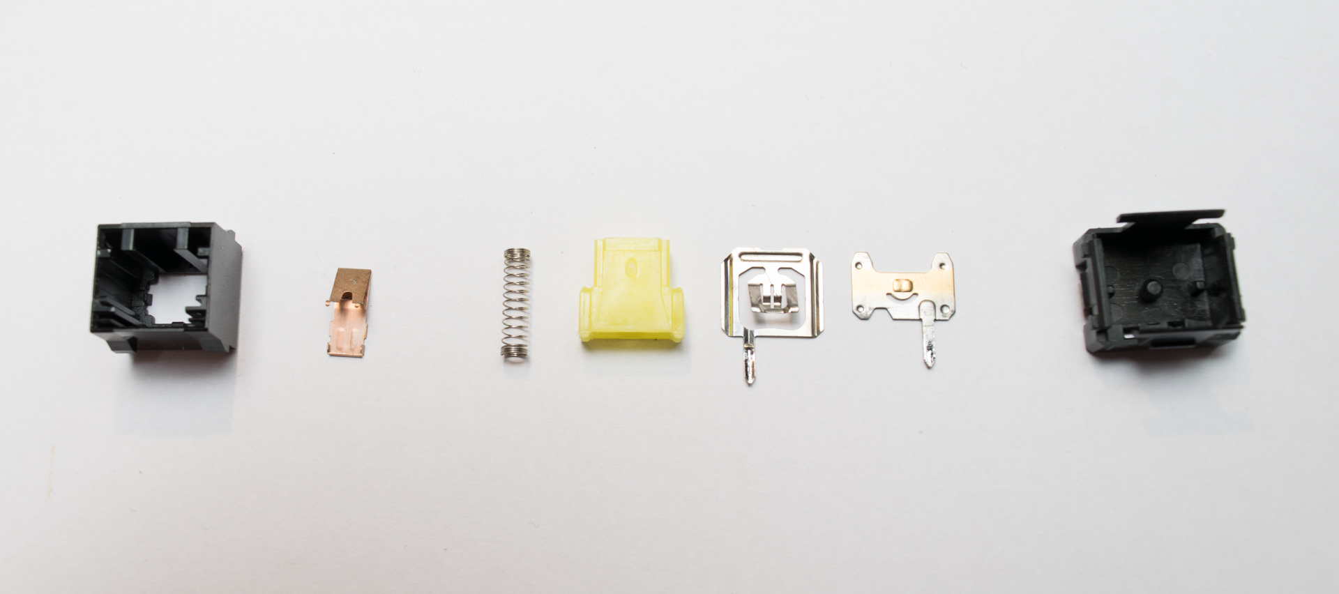

Internals:
Externally they are the same.
Internals pretty much the same. Only the slider colour (obviously) and the spring are different.

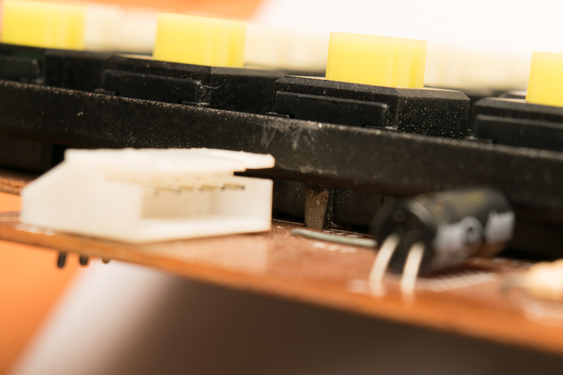

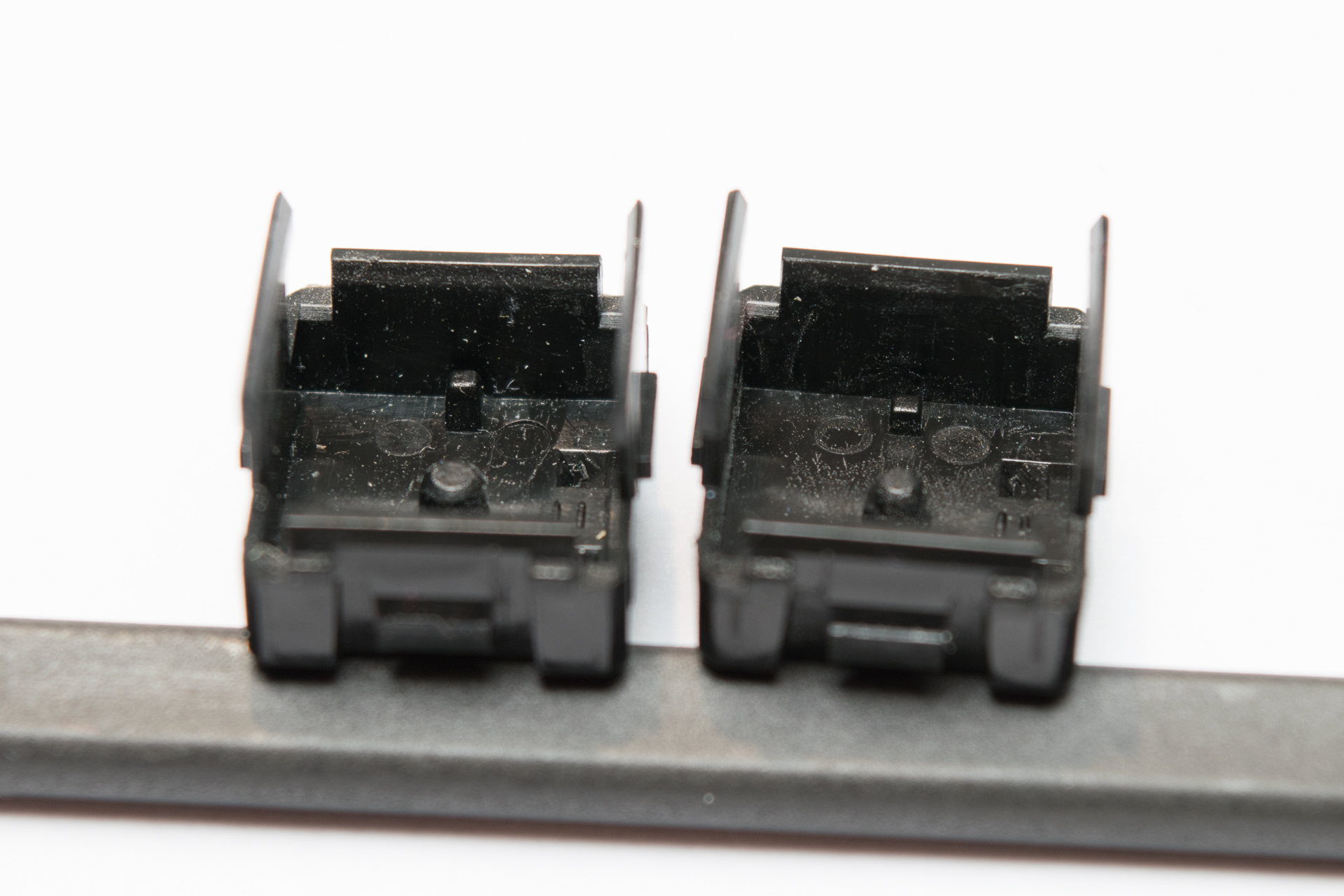

Here is where the magic happens!
Longer posts to move the bottom-out further up!
And the last pic...
Are you pondering what I am pondering???

01 Mar 2015, 01:57

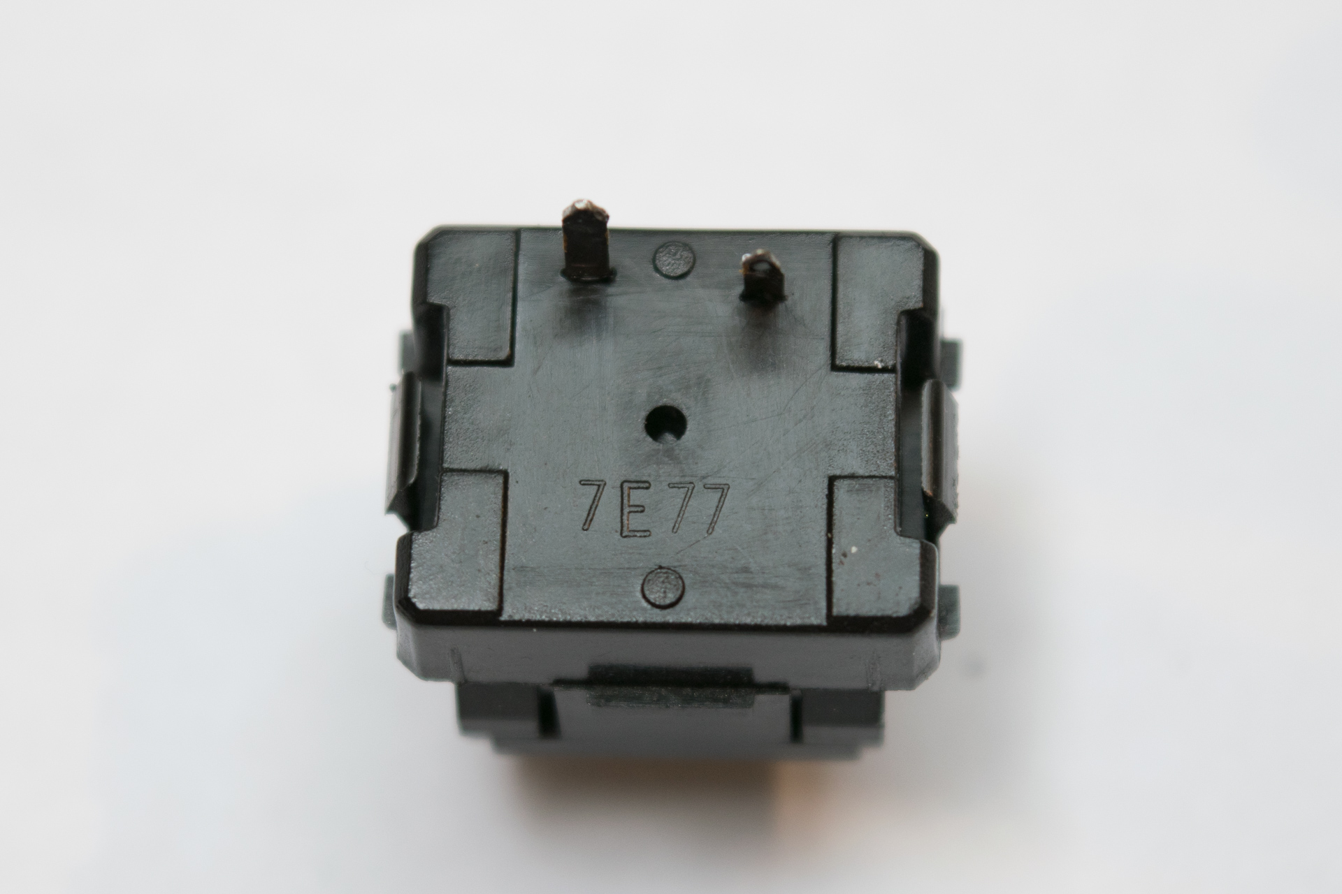

Interesting — that's the exact same lower shell mould as alps.tw's T8 switch:
Alps.tw Type T8.jpg (177.6 KiB) Viewed 1768 times
I don't understand the principle behind their numbering system, but 7E77 is combination number 15,677 in sequence (ignoring lame maths errors, or 4,877 if you take the letter part to stop at H which is about as high as I've seen it go), yet two randomly-selected switches from two different switch models (AK-CN2 and AK-D5¹) both share the same mould! It's also not the first time that I've seen the same mould number twice. I've wondered previously about just how many moulds they actually did have, considering the amount of combinations possible in their schema.
