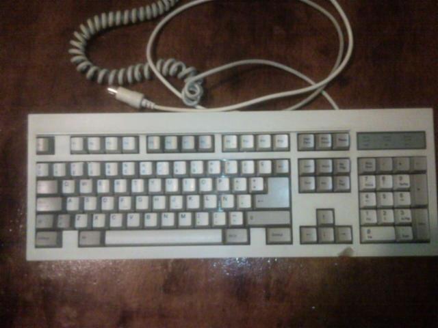

Could you guys help me with this stuff?
Thanks in advanced
First One, big ass enter key

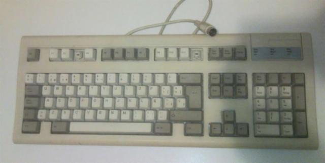

z3ta
19 Mar 2015, 13:14
Second One

The first is made by Monterey and should come with Monterrey domes, i have a similar one myself laying around.
The second one is harder to identify but i think i can spot some white alps switches on it or maybe NMB domes.
Its kinda hard to tell from the blurry picture

The 1st one - probably Chicony KB-5192? Is it clicky?
The second one is either Alps-mount sliders over rubber domes or APC Clicker (Tai Hao semi-mechanical).

stratokaster wrote: The 1st one - probably Chicony KB-5192? Is it clicky?
Auch, guess i was dead wrong then. :?

First one appears to be an [wiki]NTC KB-6251[/wiki] with a random model number affixed. It's nothing like a Chicony KB-5192.
Second one looks familiar — I can't place the switch from the photo though. Got a larger photo and/or photo of the label on the back?

Hi, The second one is a KeyTronic LT-5000, Rubber dome.
