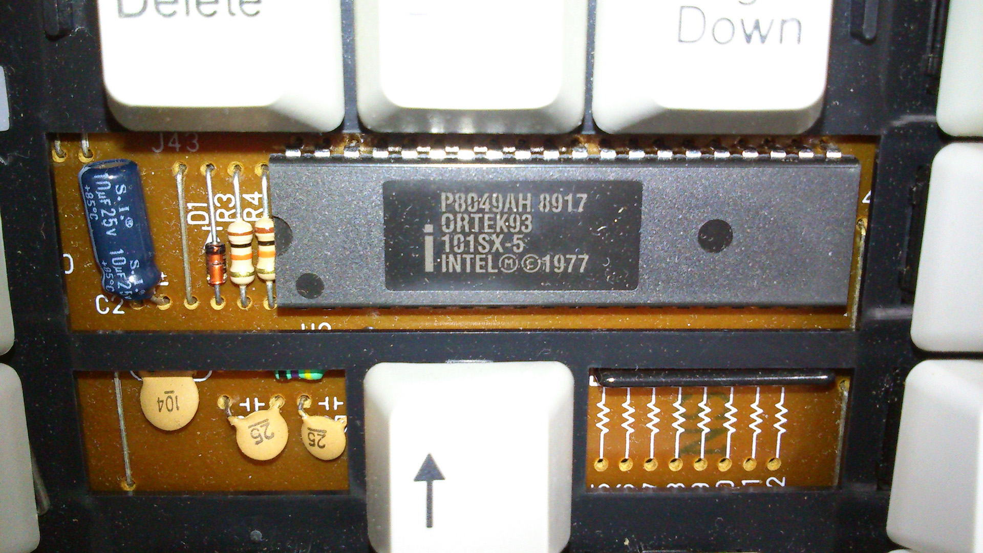

CMI MO-1101C (MCK 101FX):

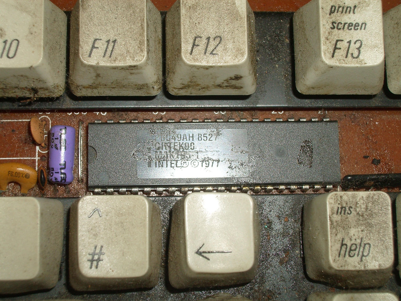

[wiki]ETC Power Glide 105[/wiki]:
ETC Power Glide 105 -- controller IC.jpg (329.21 KiB) Viewed 2776 times

CMI MO-1101C: 8917 ORTEK93 — alps.tw Type T8, ditto to both
ETC Power Glide 105: 8527 ORTEK90 — scrawly Alps SKCM White: Minguo year 85 is 1996
Taking the two-digit years to be Gregorian years, the dates of 1989 for the first two are plausible, but I doubt that a scrawly white Alps keyboard would be using chips from 1985! They don't appear to be Minguo years either, considering the lack of Windows keys on the first two and that pine white Alps in 1996 seems pretty unlikely.

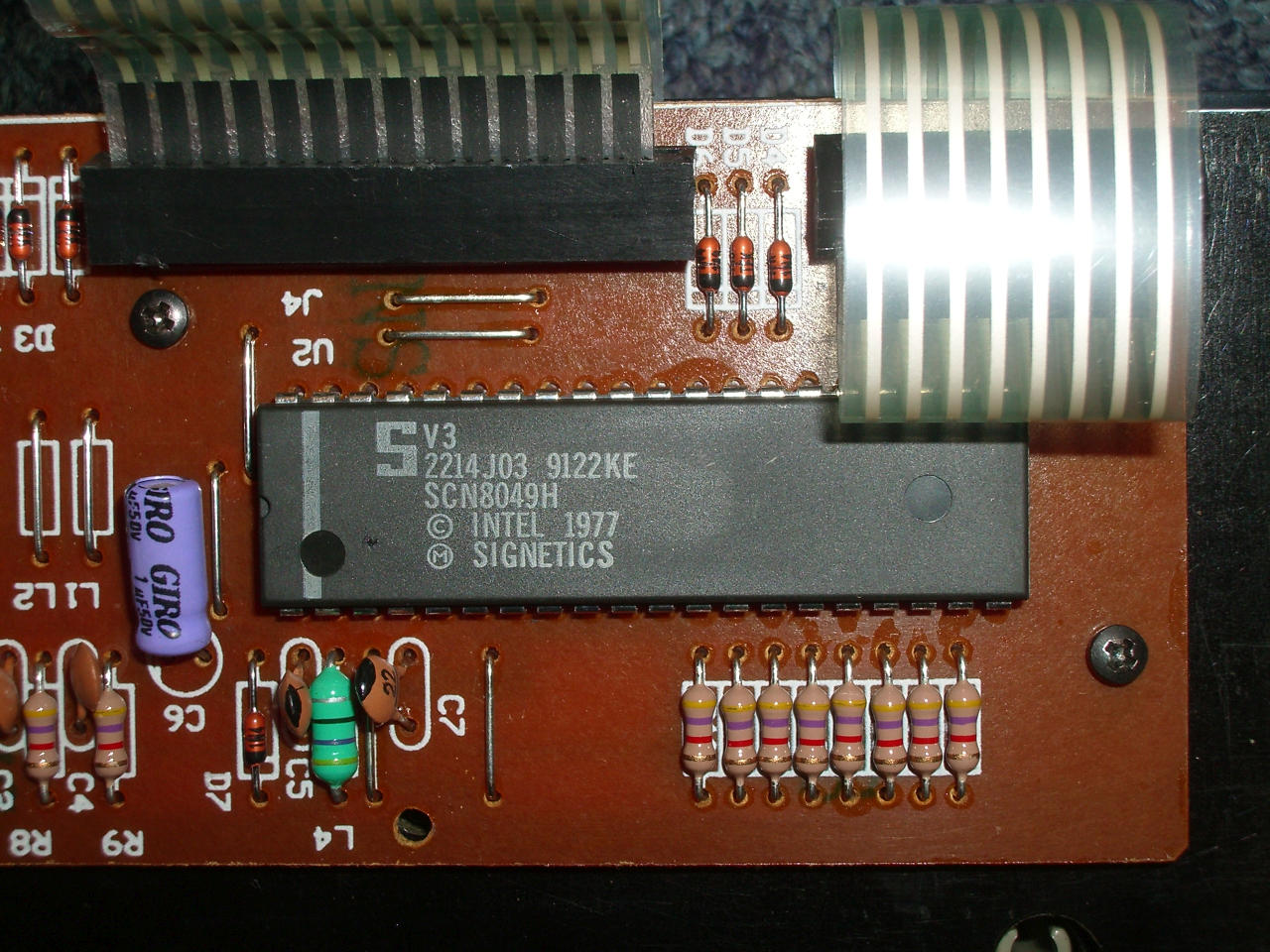

20 Mar 2015, 21:48
Here's something even more bizarre:
Oriental Tech OK-100M controller.jpg (276.83 KiB) Viewed 2644 times

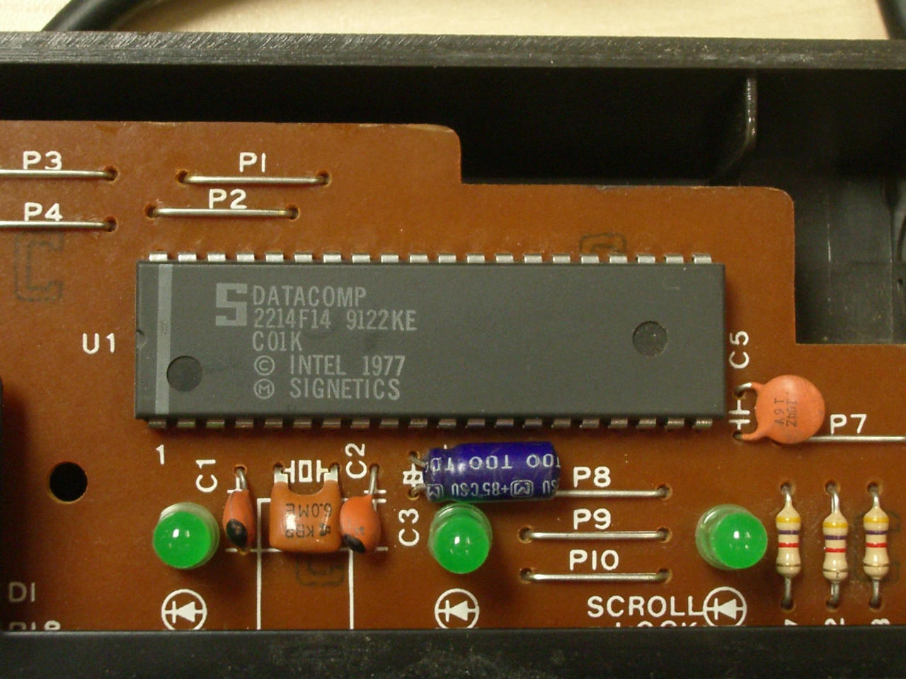

Datacomp DFK192 controller.jpg (207.52 KiB) Viewed 2678 times
The first picture is the controller from my Oriental Tech OK-100M. The second is from my Datacomp DFK192.
Both are Signetics chips and both appear to have a date code of 9122.
The thing is, the OK-100M is from 1991 or 1992 (the membrane says 1991 on it, and the box has a 1992 auction lot sticker), and the DFK192 is from 1991 (date stamp moulded into the case). There's another chip on the DFK192 PCB that had a 1990 date code.
Strangely enough, both keyboards came from Ascaii …
[Edit: Argh … first photo was also the DFK192 — got mixed up, as I couldn't get one single miserable wretched good photo of that PCB]

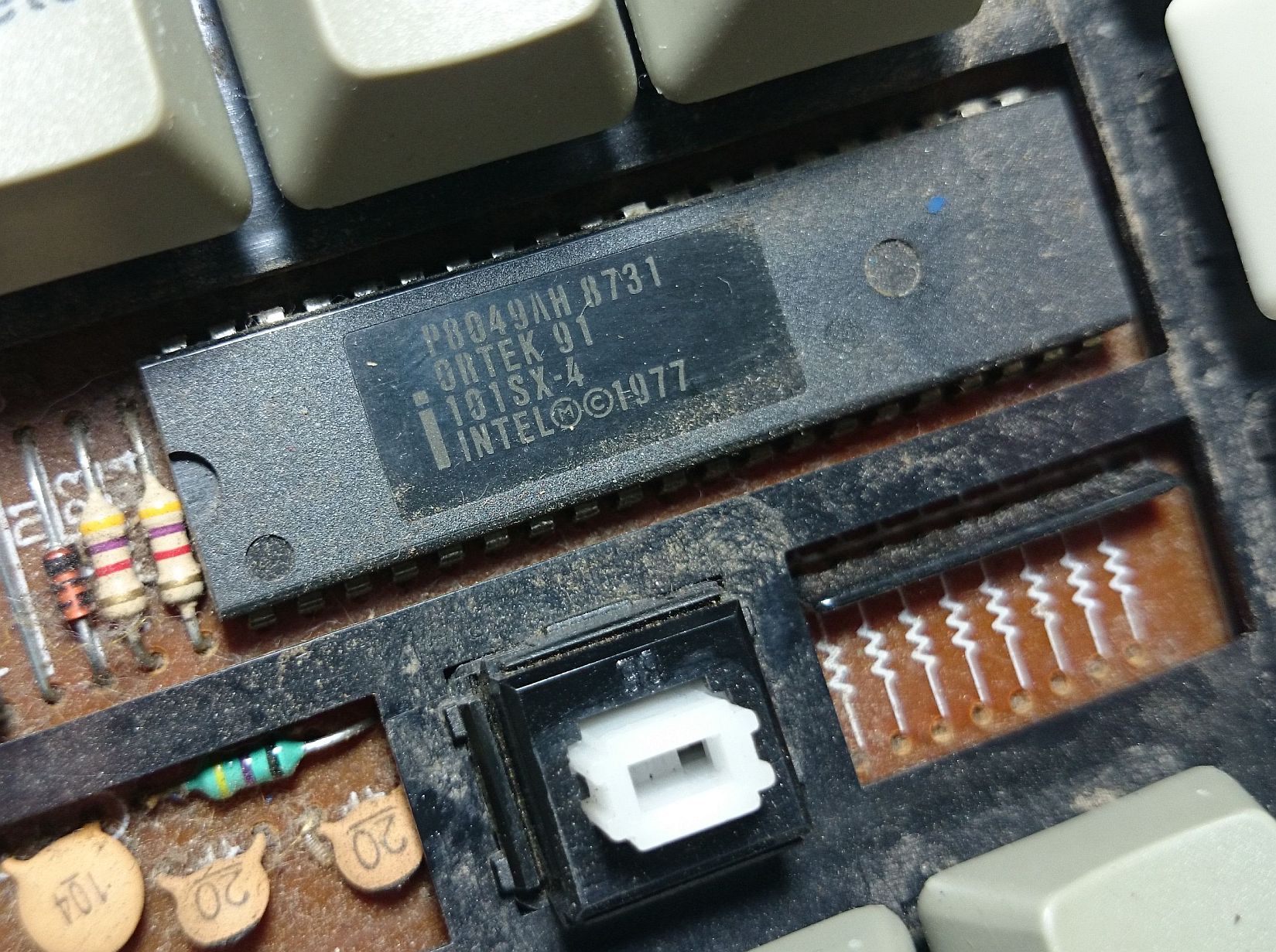

21 Mar 2015, 02:06

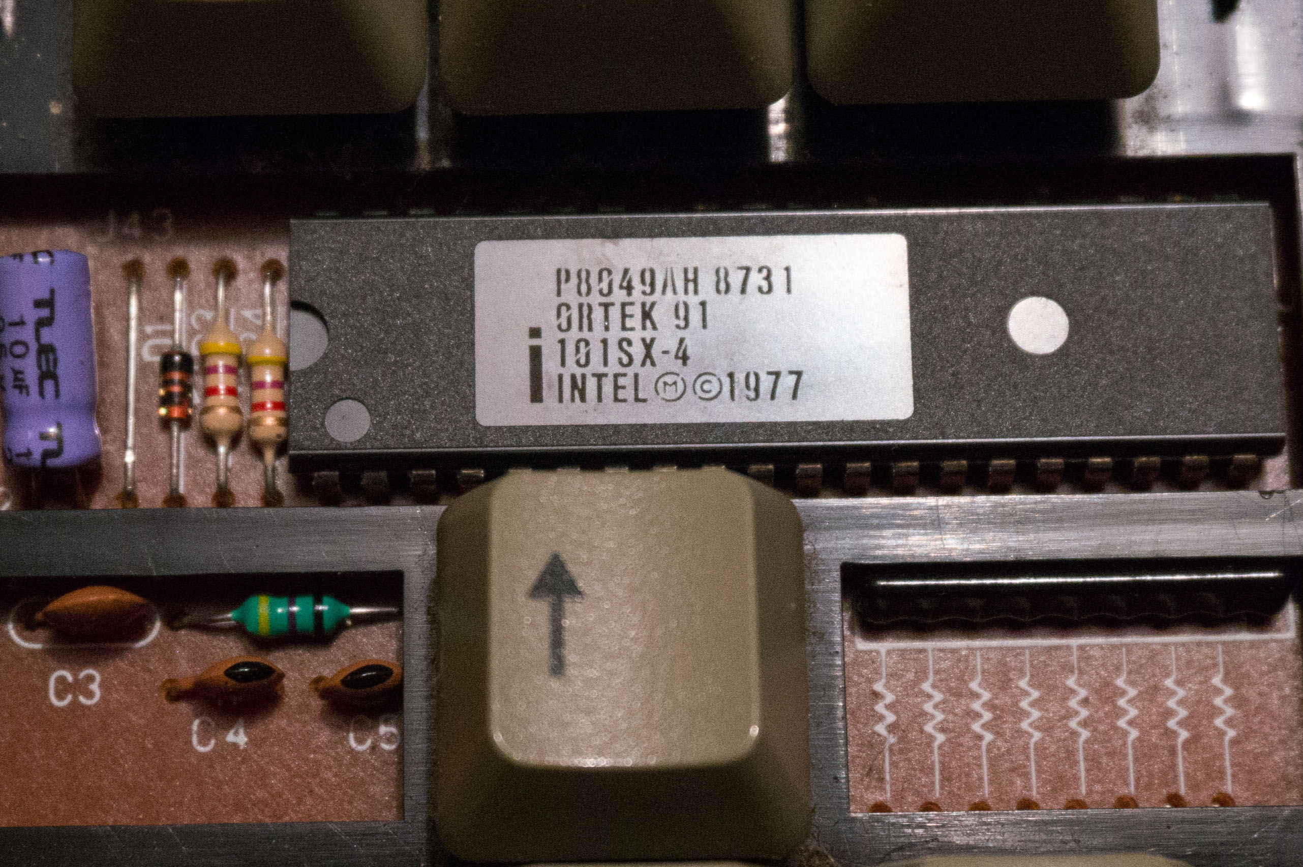

Here's another one that falls between the examples in the first post. No idea if it helps you or not:
21 Mar 2015, 02:44
I think my brain is far more fried today than I realised. I can't get Macs working and I've uploaded two photos of the same chip.
002: I'd like to know what that switch is.
The top-right code may remain a mystery. In some cases they're not valid dates, and a 1895 date for white Alps is nonsense. My take on the "ORTEK90" etc was that it was the year that the chip was designed (the ROM code, now that I've learnt that keyboards really do run off actual microcontrollers instead of custom circuitry) which would leave the chips with no date code of any kind. However, it appears that I just have to assume that they're the years of manufacture on the basis that there's nothing else in an Ortek keyboard to use as date evidence anywhere.

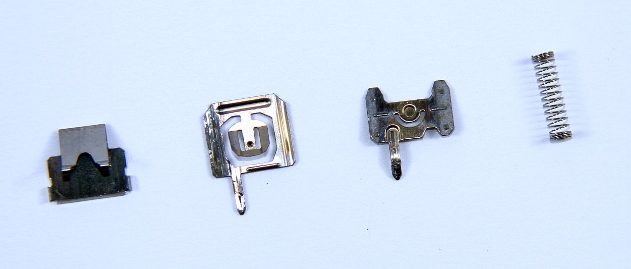

Here's a crappy pic of the internals of the switch from my board:
21 Mar 2015, 23:46
OK, thanks. OA2.

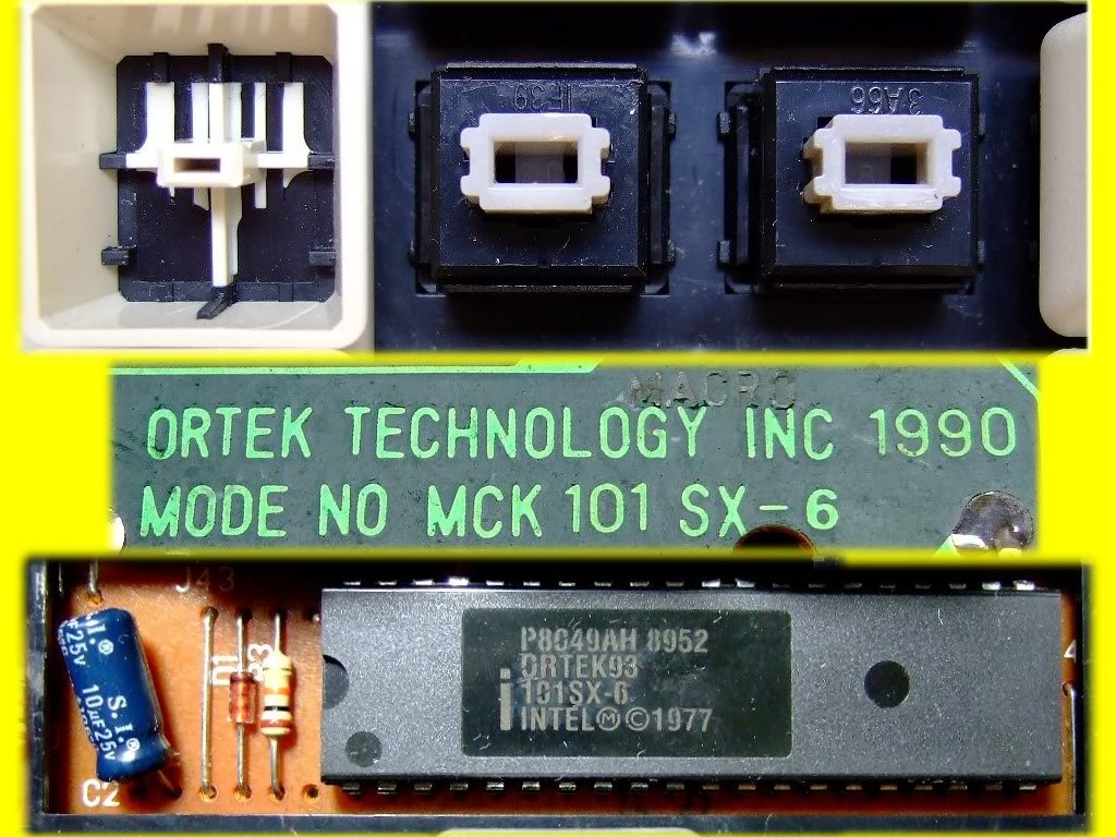

Here's the 8049 in my MCK-101FX:
This keyboard was actually purchased in 1991. The back of the PCB says 1990 and "Mode No" [sic] MCK 101 SX-B. Hope this helps.
