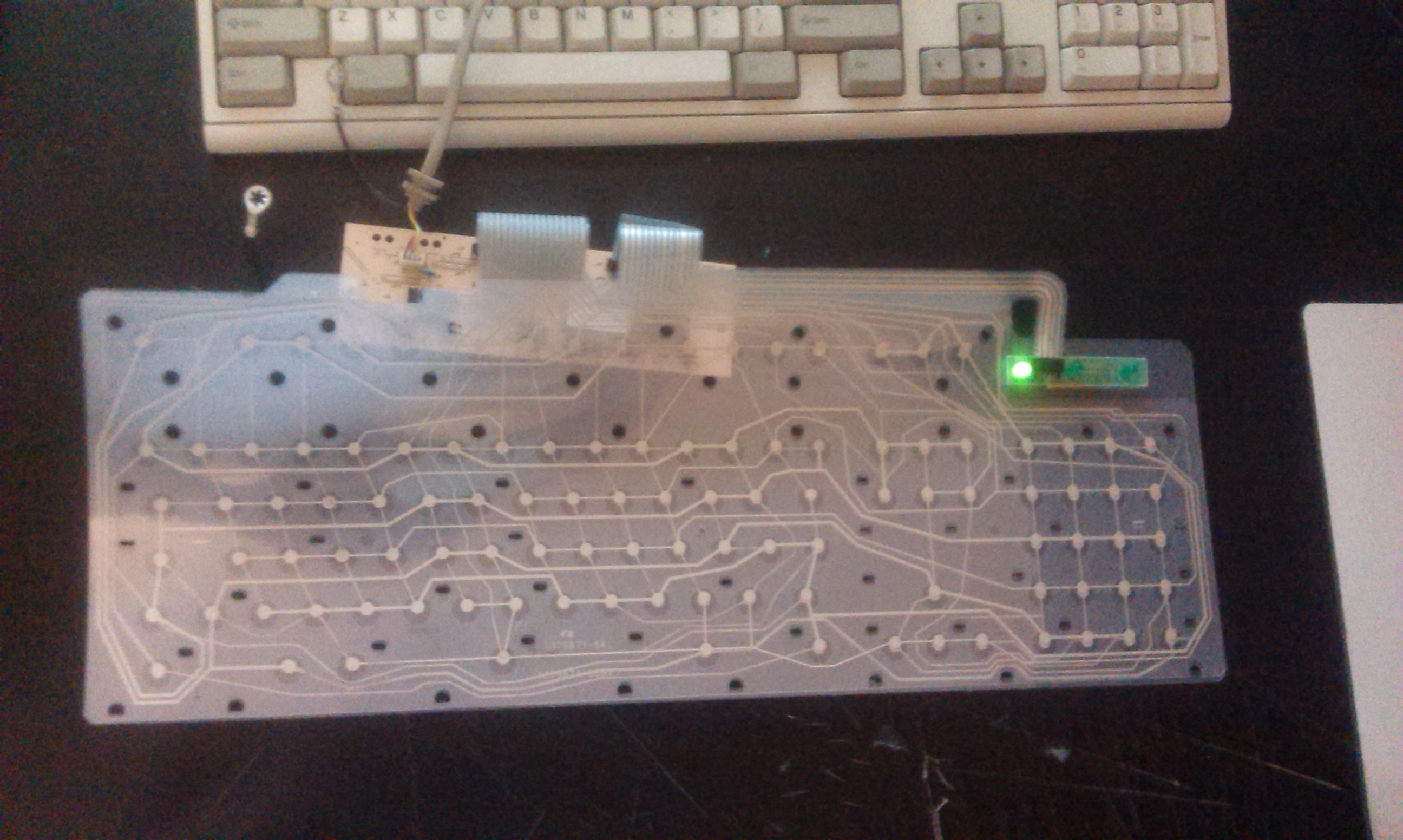

I took it apart and cleaned it. The membrane is broken.
Before cleaning, keys D, B, N and Space didn't work. Now only B and N don't.
Here's some multimeter-less testing:

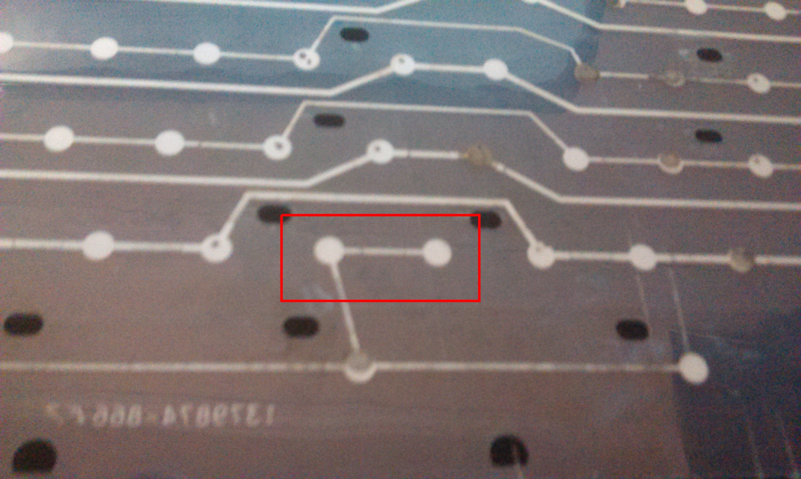

As B and N don't work, I'm guessing the membrane is broken here:
Hopefully the conductive ink does the trick.
Touch_It
30 Mar 2015, 18:16
my 1 experience with conductive ink worked well. Someone gave me the tip of using a paper clip to apply it so it wouldn't get too thick. Worked pretty well.

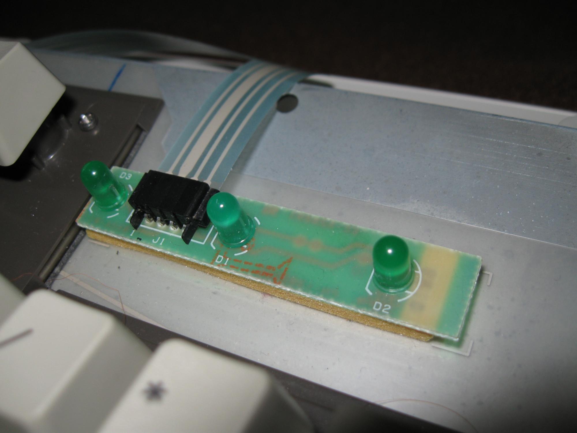

How do you remove and put back in place those LED lights in the membrane?
LLRnR
\m/
30 Mar 2015, 23:24
eldorange wrote: How do you remove and put back in place those LED lights in the membrane?
Take a look at this picture.
The LEDs are placed on a small circuit board with a layer of foam underneath. On the membrane, there are guidelines in the corners of the area where the LED board should go (see the white guidelines in the picture). You would want to remove the LED board, I suppose, if you plan to replace one of the LEDs or if you want to move the whole LED board to a spare membrane. You would of course have to unplug the ribbon from the connector (J1) first. Other Model Ms (like my 1390130) have a more standard cable (not a ribbon, but using yellow wires instead). I never had to do this myself, but I guess you'd just have to carefully detach the foam from the membrane and carefully glue it back in place afterwards. The placement of the LED board does not overlap an actual circuit on the membrane, so it should be fairly easy.
