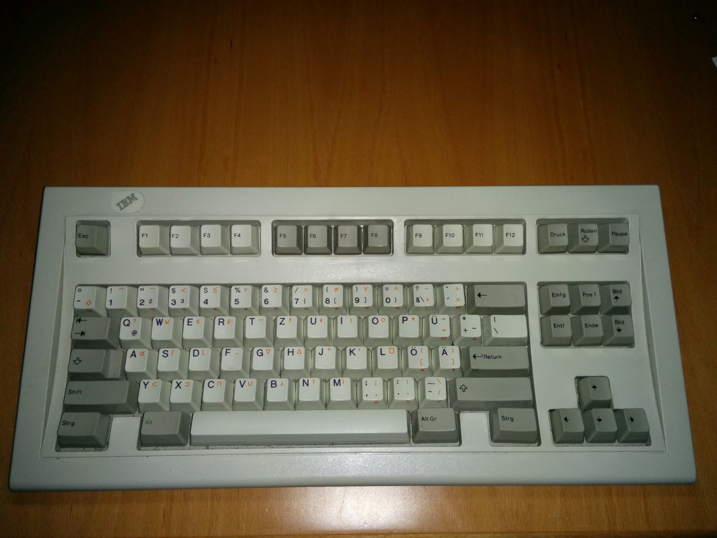

Because it loosely fits in here, I'll also post the DE-ANSI layout for Windows I built for my SSK. I hope that's OK.
It's a normal DE layout, with just 3 additional AltGr combinations to make up for the missing ISO '<>|' key on an ANSI board:
AltGr + Comma yields '<' (less than)
AltGr + Dot yields '>' (greater than)
AltGr + # yields '|' (pipe)
You can use it if you're using a DE keycap set on an ANSI keyboard, like on this SSK (ignore the APL legends):
IMG_20140903_211943 (Large).jpg (243.01 KiB) Viewed 5032 times
# and ' are still on the ANSI \| key above Enter, I didn't change that because \ and | are elsewhere in the German layout, and I just don't have a 1.5u #' key cap. If the last sentence sounded crytic, put a DE key set on your ANSI board and you'll know what I mean before you even install the layout... ;)
After unpacking the ZIP file, you can either start setup.exe to install the layout (if you trust me, but why should you?), or load the de-ansi.klc file into MSKLC to modify and compile your own version. In both cases, you'll have to activate the layout in the Windows Control Center after installation.
