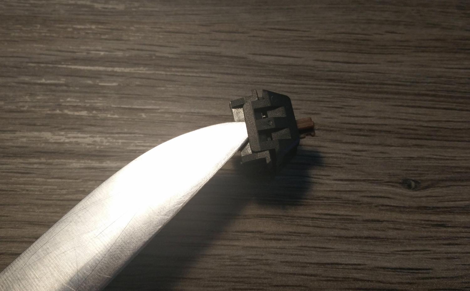

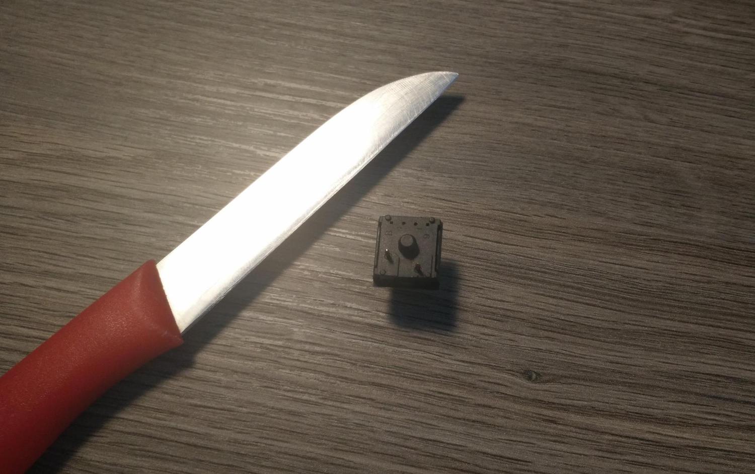

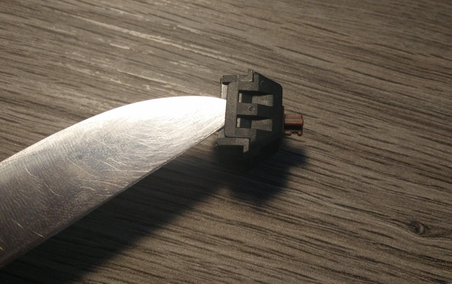

I've used a knife (read: thin sheet of metal/plastic) to open up some Kailh switches. Stick it between the top housing clip and the bottom of the switch and try to lever the clip up using the knife blade. I only did this to a handful of switches, don't how it is for a complete keyboard.
Knife and switch
Knife and switch
Put knife blade between clip and switch bottom
Lever up the clip
Lever up the clip
