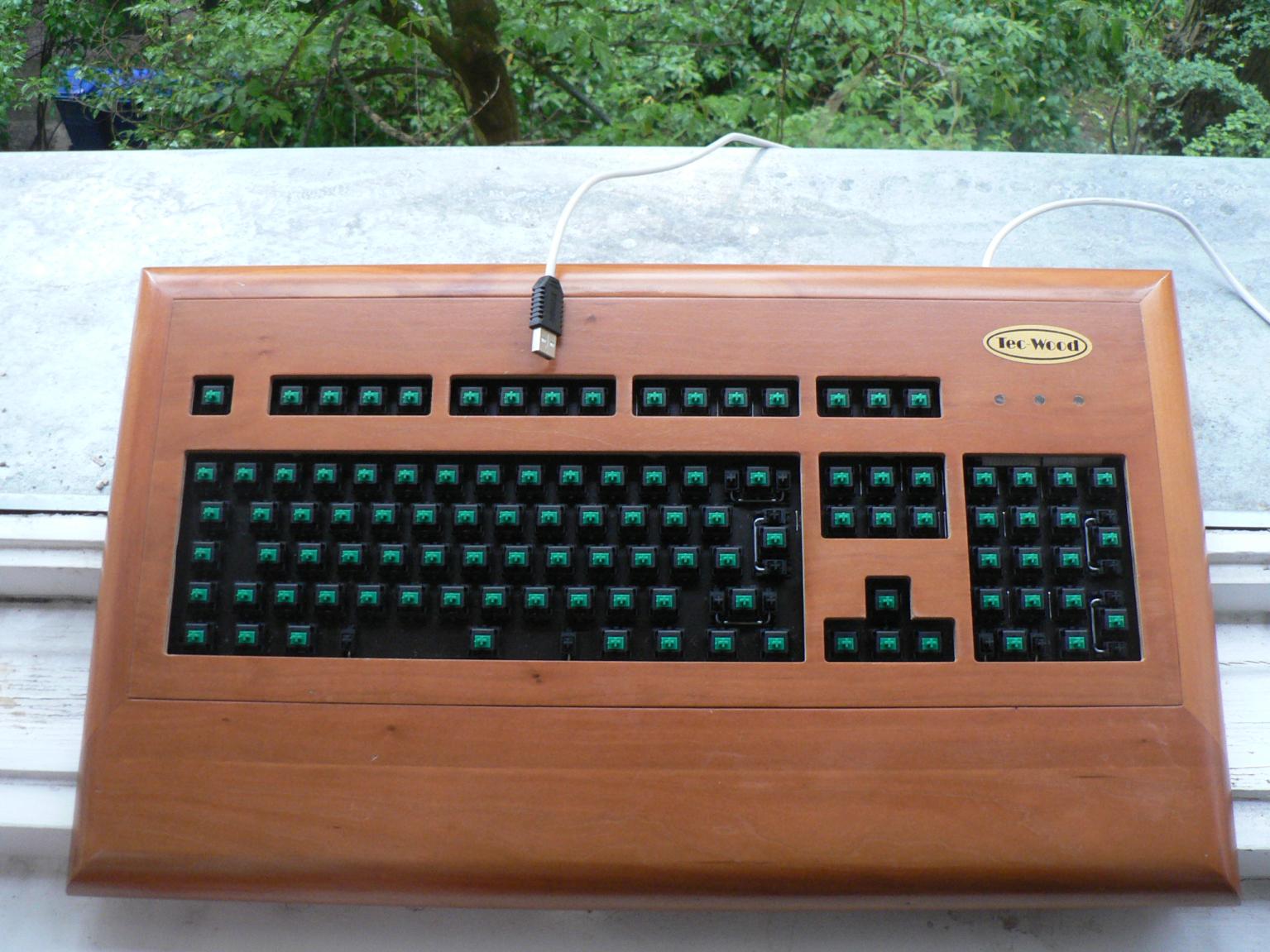

opened up 115 MX Green switches
fitted said g80-3000 LRNDE with greens

I cut a hole into the bottom shell to change the position of the cable passthrough to match the drilled hole in the wooden casing. I had to saw a cable channel into the back of the wood case, since I couldnt use the drilled hole, due to the USB cable having an attached plastic nib to keep it from pulling out.

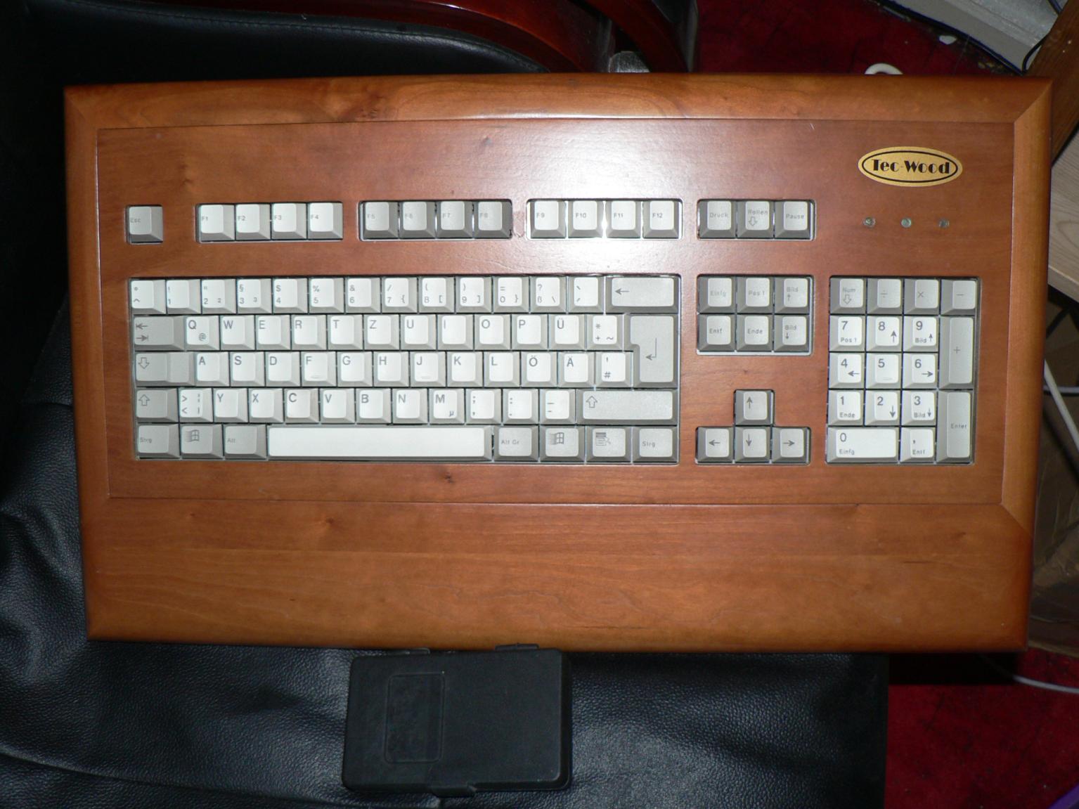

Mod complete: Wooden Case including wristwrest for g80

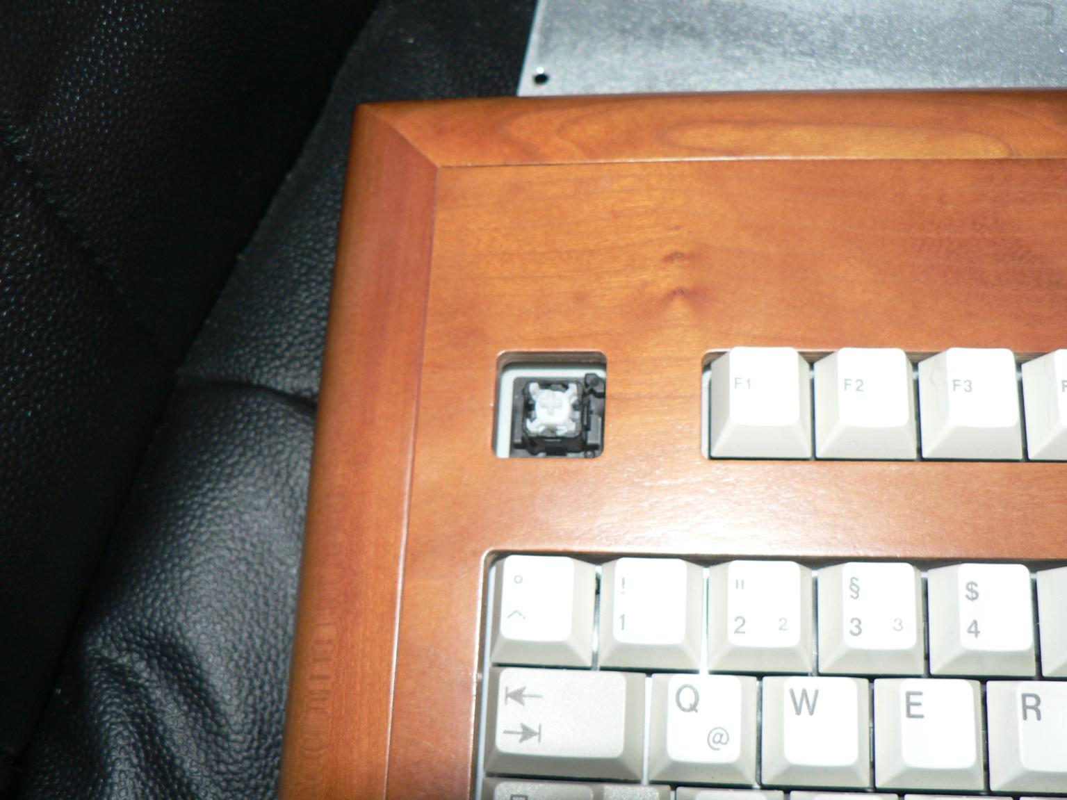

- oh lookie a neat keyboard! I wonder what switches it uses?
- before.jpg (174.26 KiB) Viewed 5503 times
- yuck! MY
- before_switch.jpg (145.22 KiB) Viewed 5503 times
- much better =D
- Final.jpg (196.07 KiB) Viewed 5503 times

I think it is a fantastic mod
I only tried one Green switch in the Spacebar of the Filco that I got from Sixty. I actually like it since it feel something between blues and blacks at least for me.
The only thing I don't like at all is the size of the wood case, for me too big.

Both things Im planning on actually. Currently have a set old thick old cherry DS alpha keys on it.
The "sticker" is actually a thing metal plate glued to the wood, im still trying to figure out how to remoce it without scratching the case.
