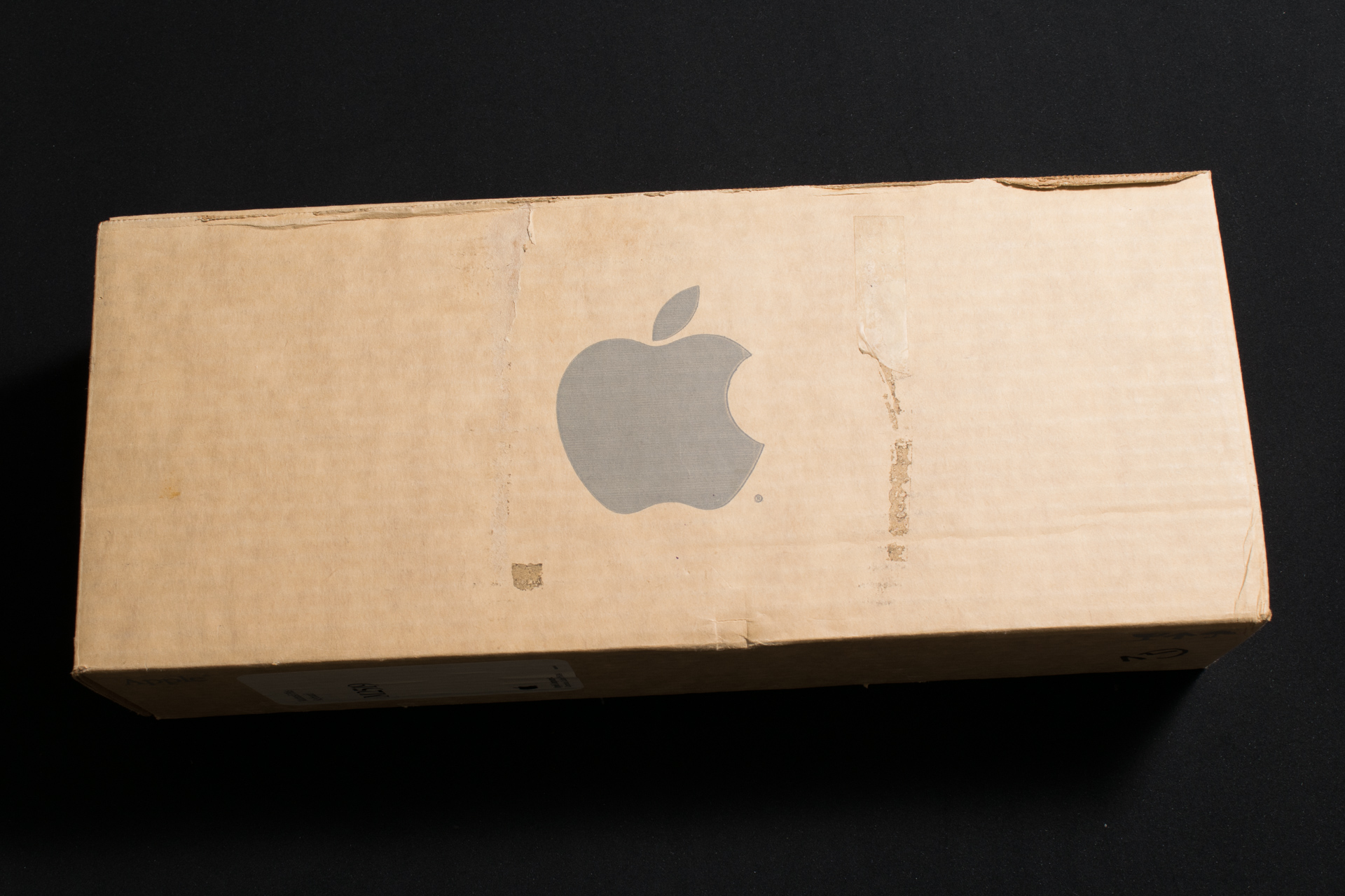

A few months back I got an M0110 through Ebay, which the seller described as NIB.
The photos made it clear it was not NIB, as the box was from another keyboard (M2519), but it appeared an very good condition.
So I bought it. And it arrived safe and well-packed!
The box

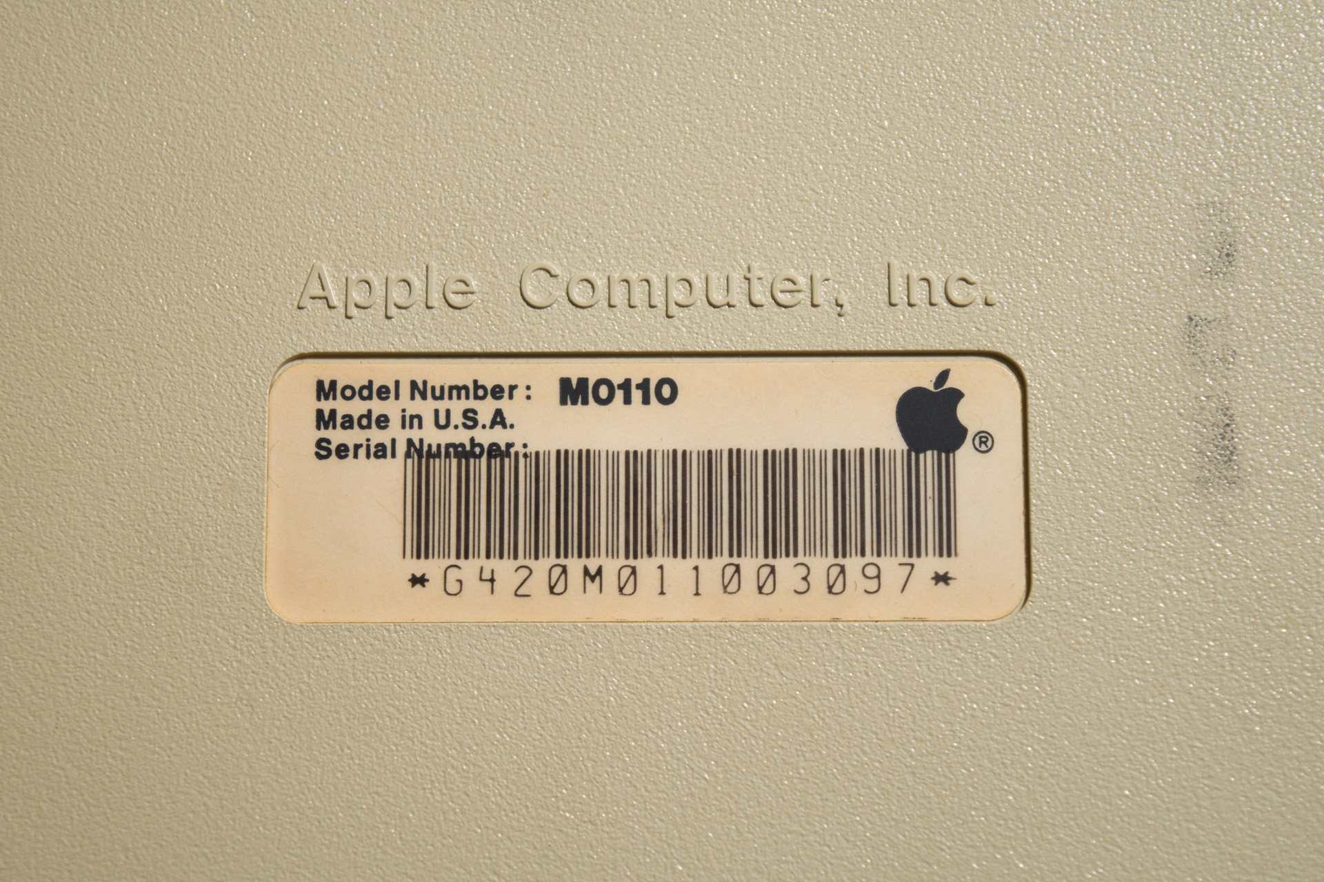

The label

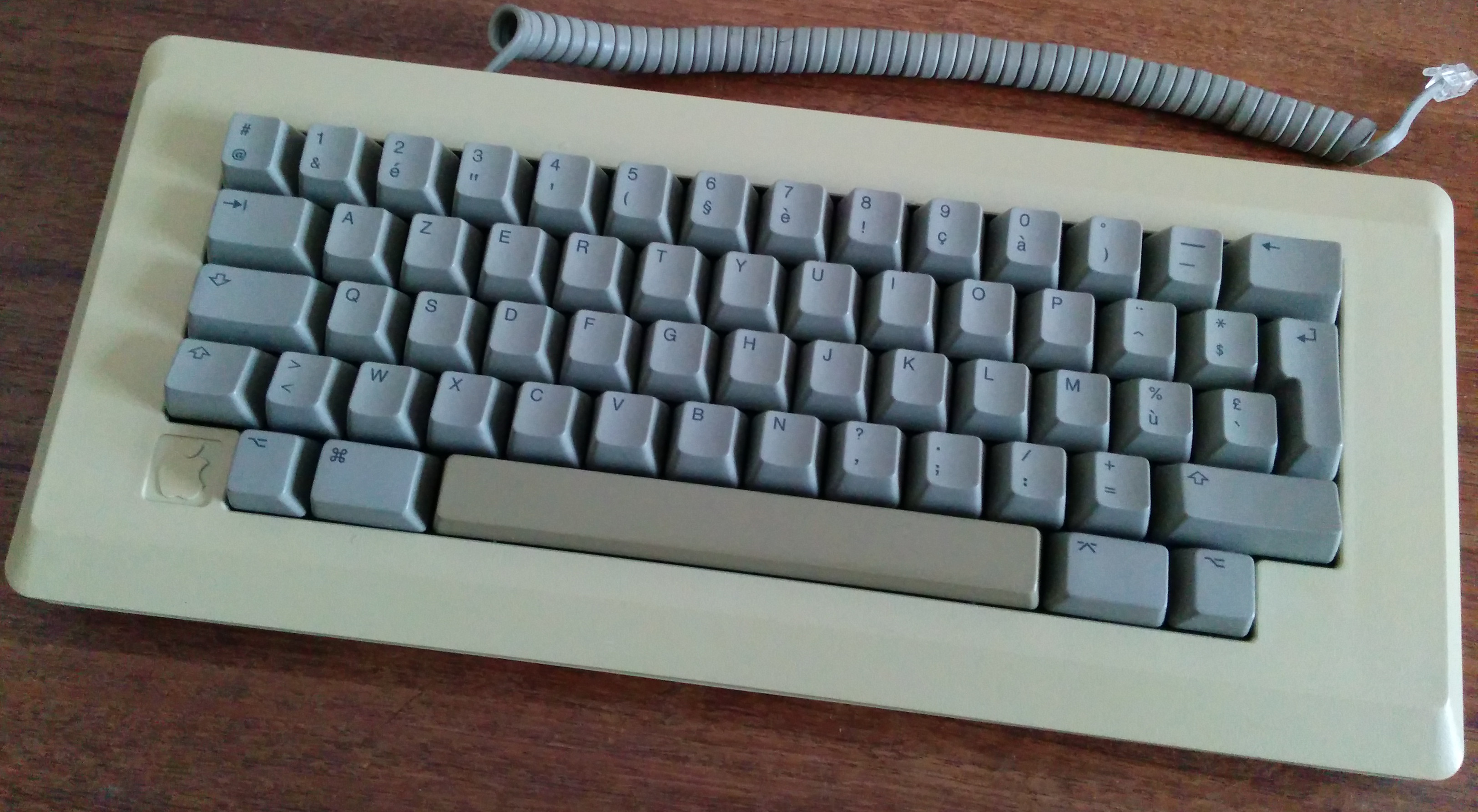

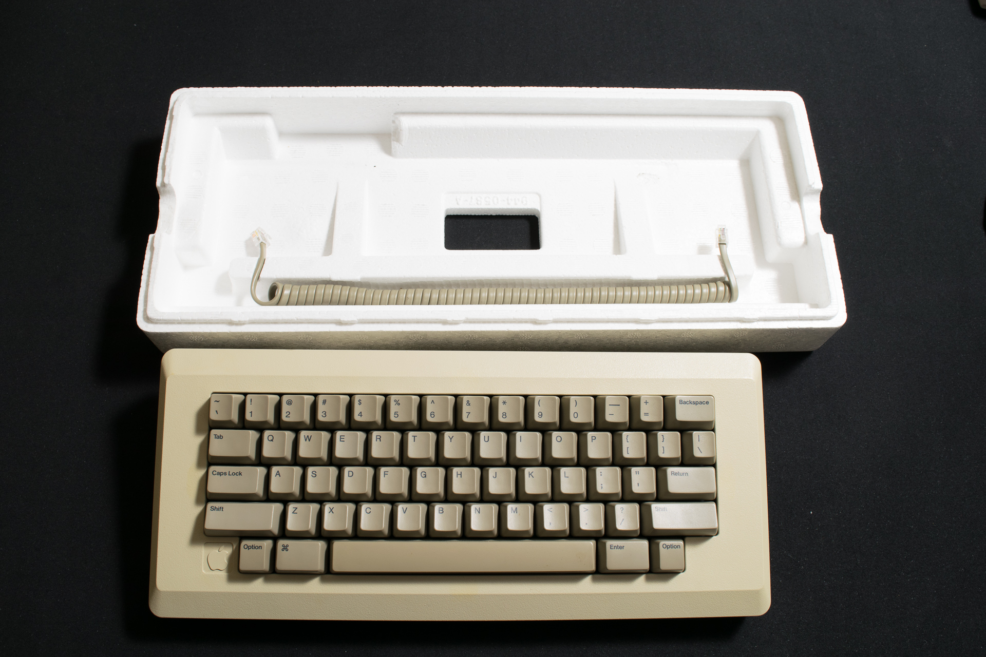

Out of the box, with cable, very little yellowing (I think)

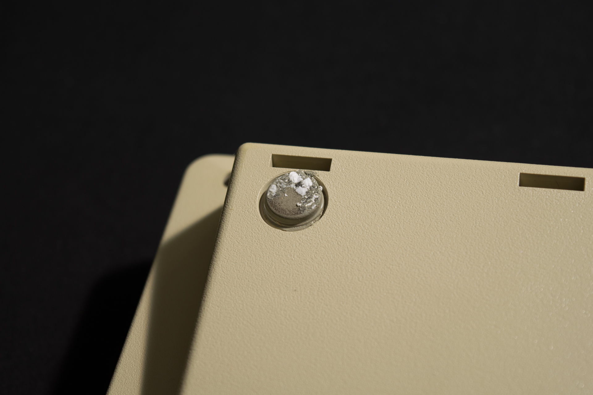

The rubber feet have turned into gooey feet, so off they will go!

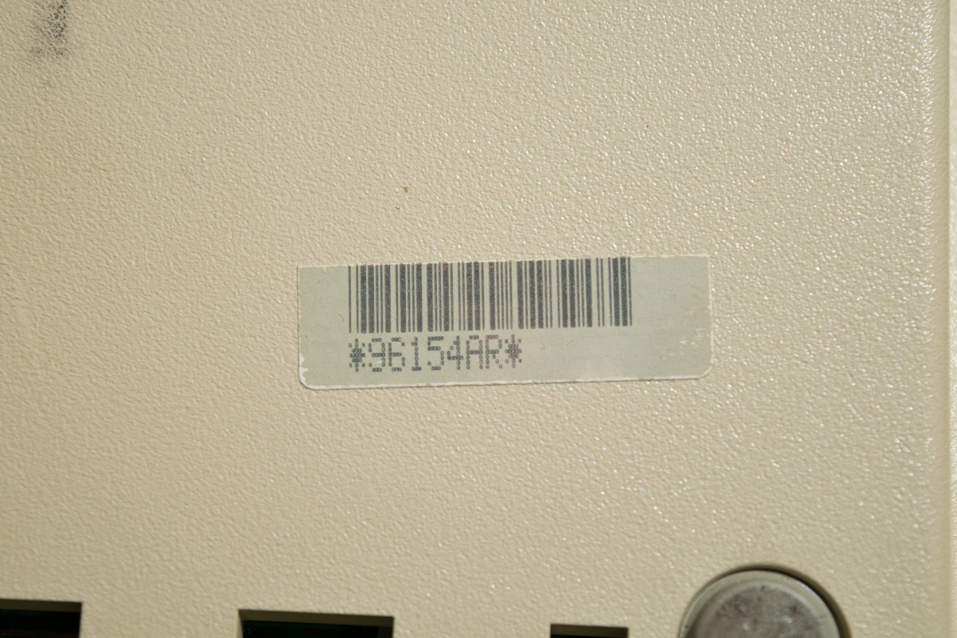

The label
An extra sticker (does anyone know what it is?)

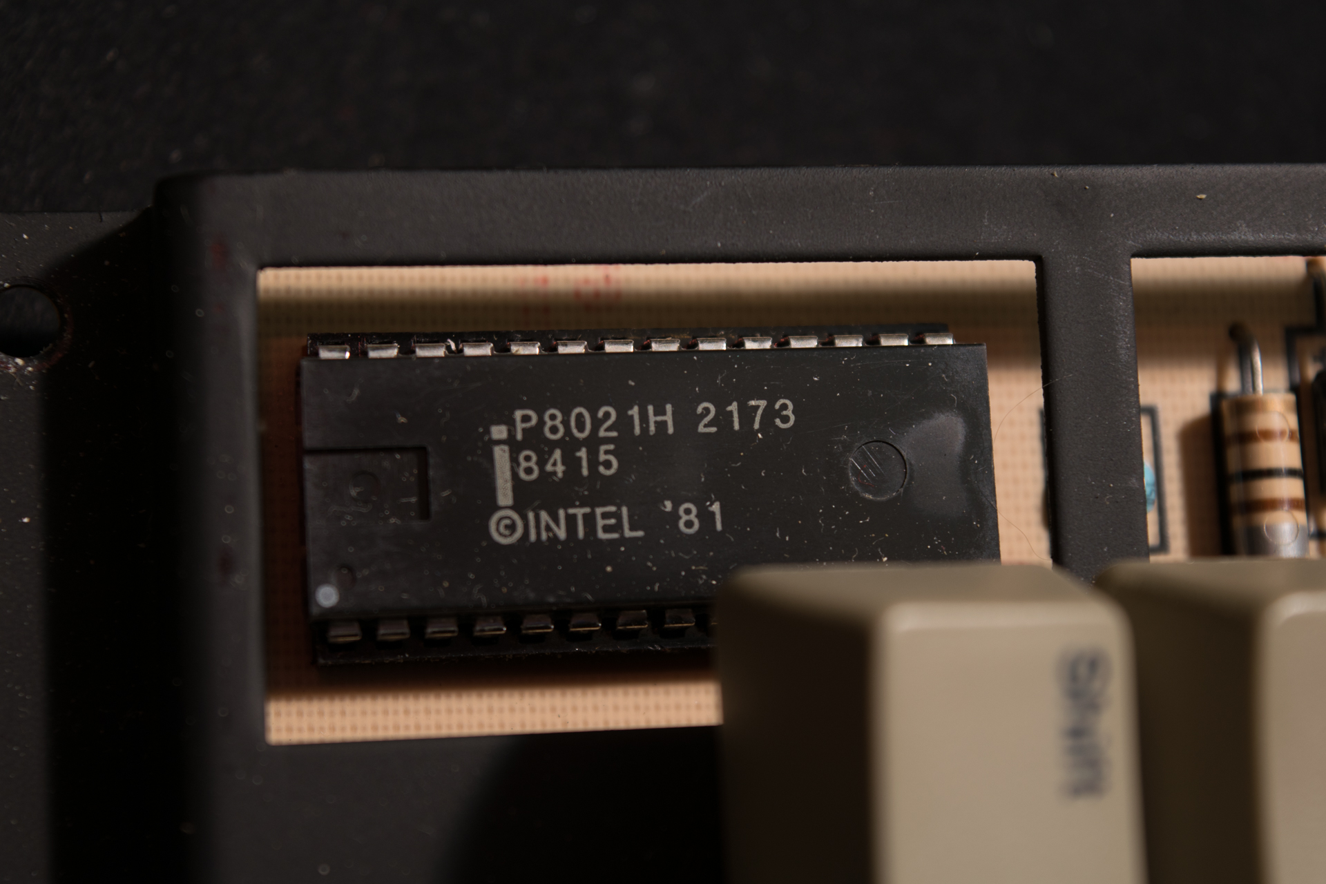

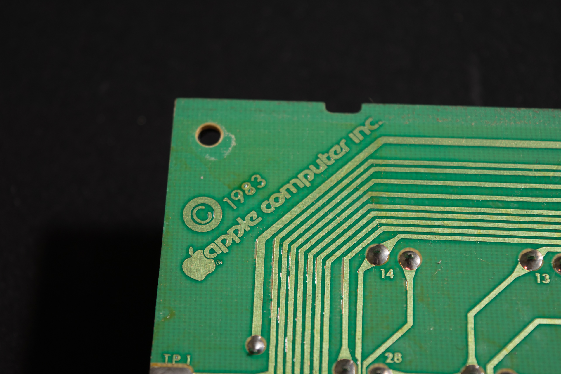

Controller (15th week of 1984, making it the oldest keyboard I own, 2 years younger than me!)
PCB detail, I love the attention to the details!

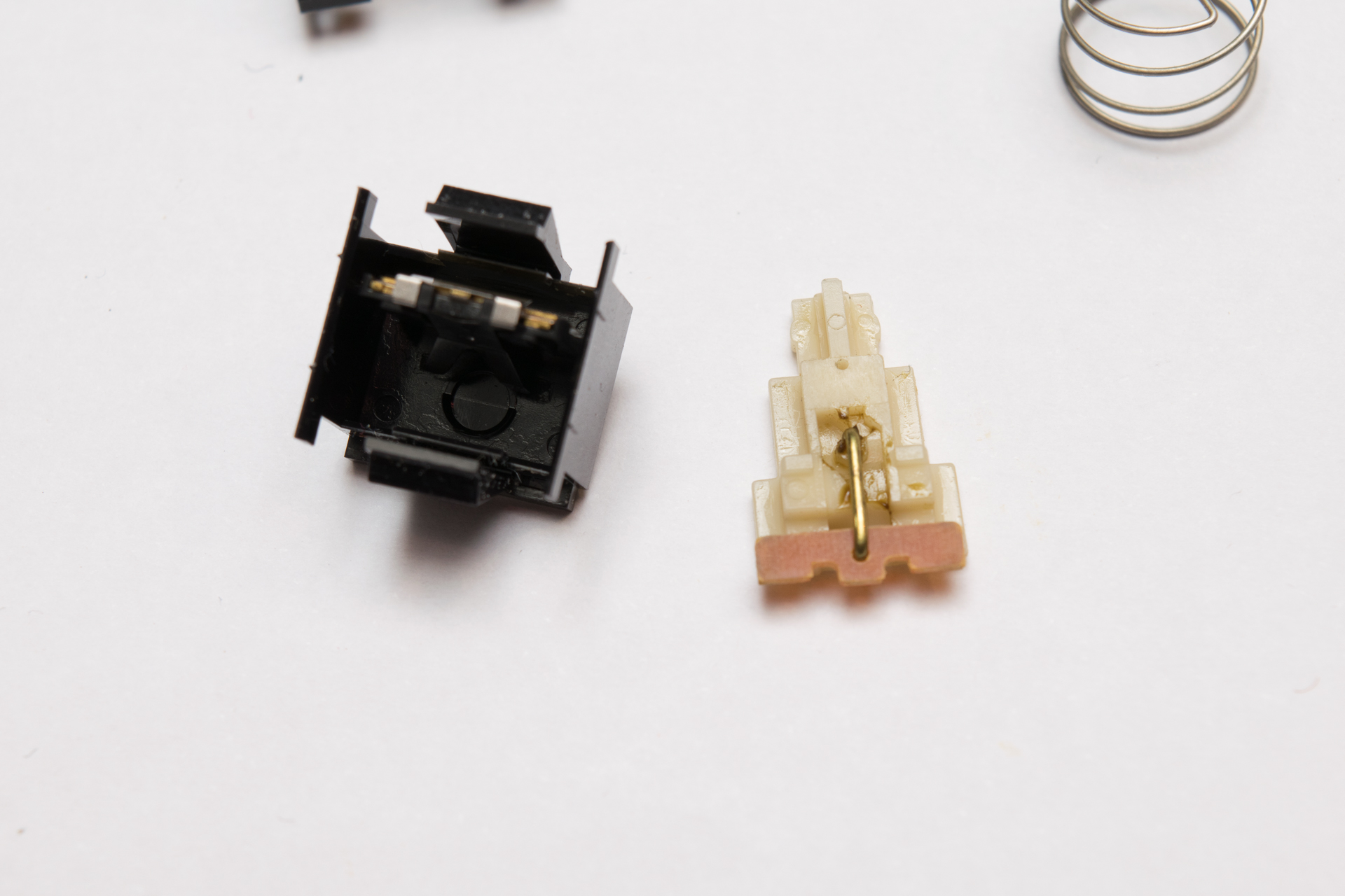

The two kinds of switches (Alps SKCC Tall and Lock)

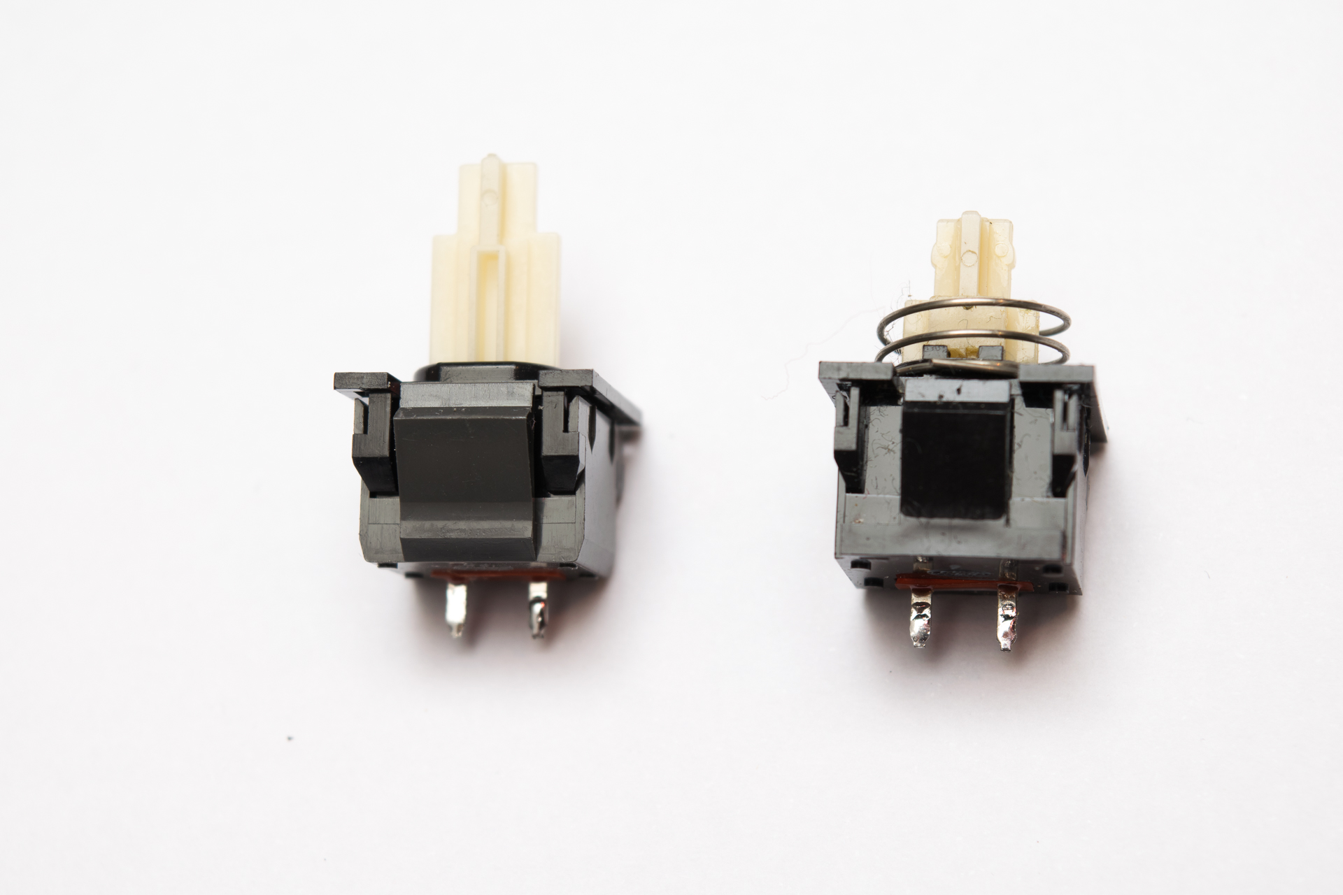

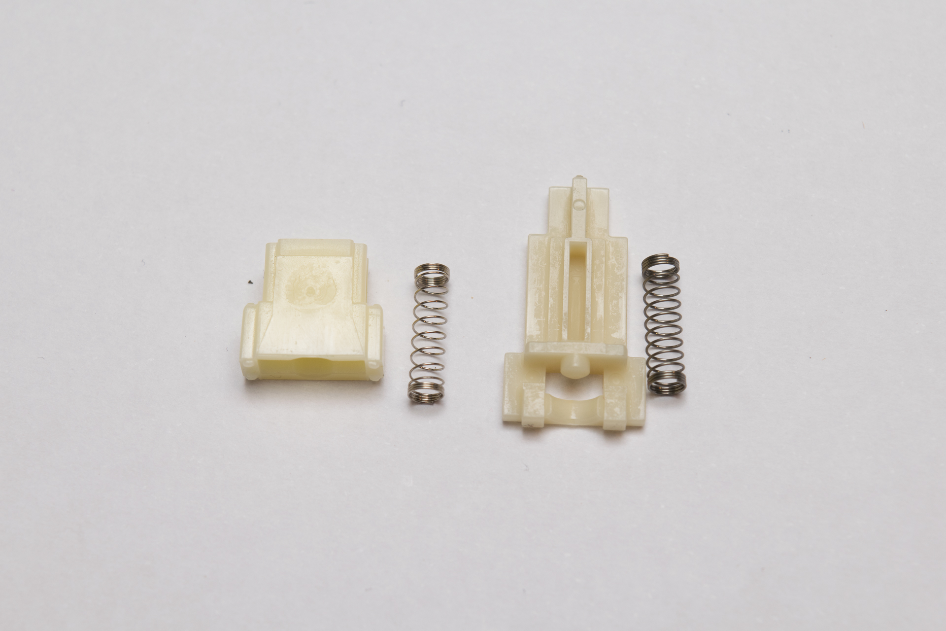

Slider and spring next to the equivalent from Hua-Jie AK-CN2 Alps clones
The sliders are buttery smooth, and the spring compatibility means we can easily customize the weight.
The slider of the Lock switch.

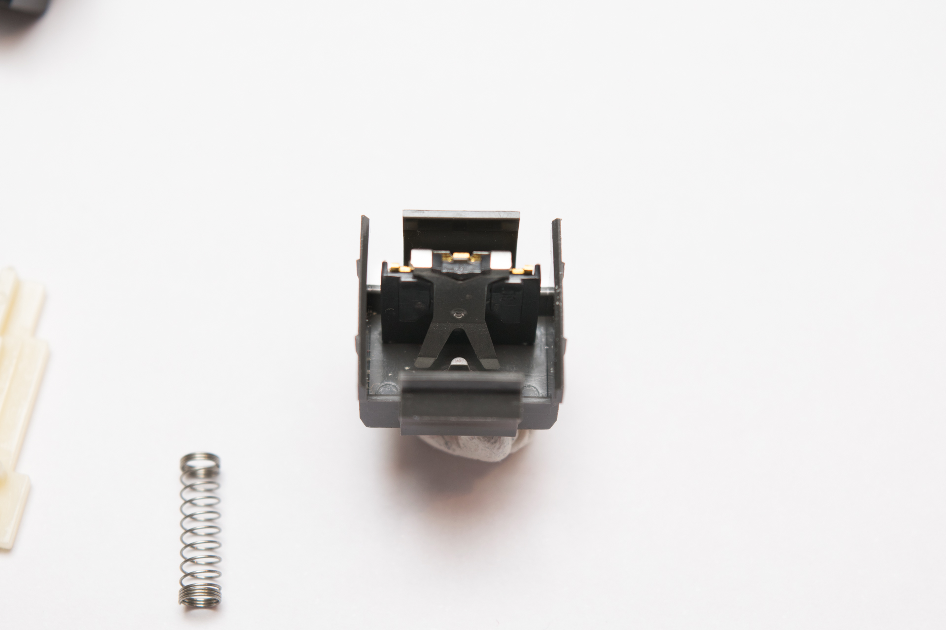

After reading lowpoly's and other's guides, I was reluctant to hack up my Caps Lock.
Closer inspection confirms my initial thoughts. Removing the brown piece and the wire makes the switch linear NON-locking.
No cap surgery necessary, no extra switch needed!
