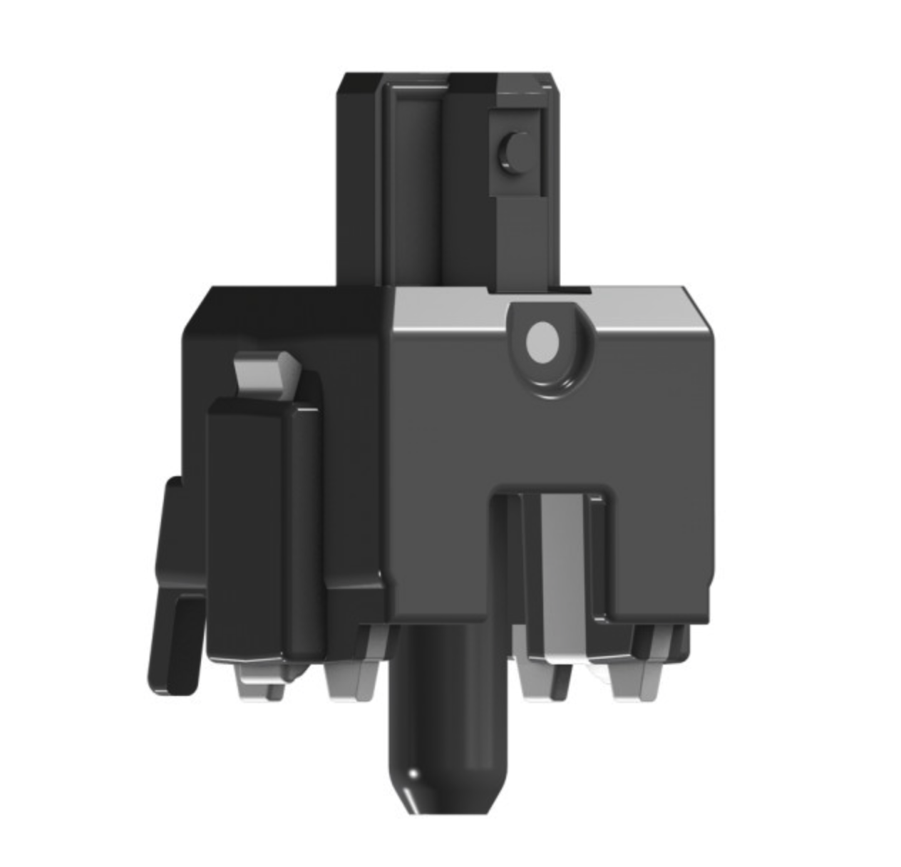

Direct link to detailed rendering.
However, article fail in that it claims that "click" is the sound on topping up or bottoming down. I suppose that flaw was in the press release from Corsair.
05 Aug 2015, 20:59
Thanks for that! Here's the interesting bit:
Screen Shot 2015-08-05 at 7.57.23 pm.png (218.21 KiB) Viewed 12906 times
Looks like they are damping in the equivalent spot to good old Alps. It'll be a squeeze!

So, who's got some spare MX switches lying about? I want to hear how hard it is to make and install such tiny dampers. And I especially want to know if Cherry altered the slider shape to accommodate them.
Could be a chance these dampers are an addition to normal switches, rather than a full different slider. Anyone know?
Khers
06 Aug 2015, 14:52
From the render above I take it that it is indeed a new slider design based on the fact that the entire innards of the slider seem to be made out of the grey material that is supposedly the damper with a black shell.
06 Aug 2015, 14:55
Oh right. I didn't realise that colour meant anything. My eyes are fixed on the little damper on the left, at the top of the slider rail. Topping out is the damping that I care about.
That said, a bit more mass in the slider (especially spongy, non-sound transmitting) ought to help on both strokes. But a damper right at the contact point between slider and top shell makes all the difference to me, on Alps and Topre.
