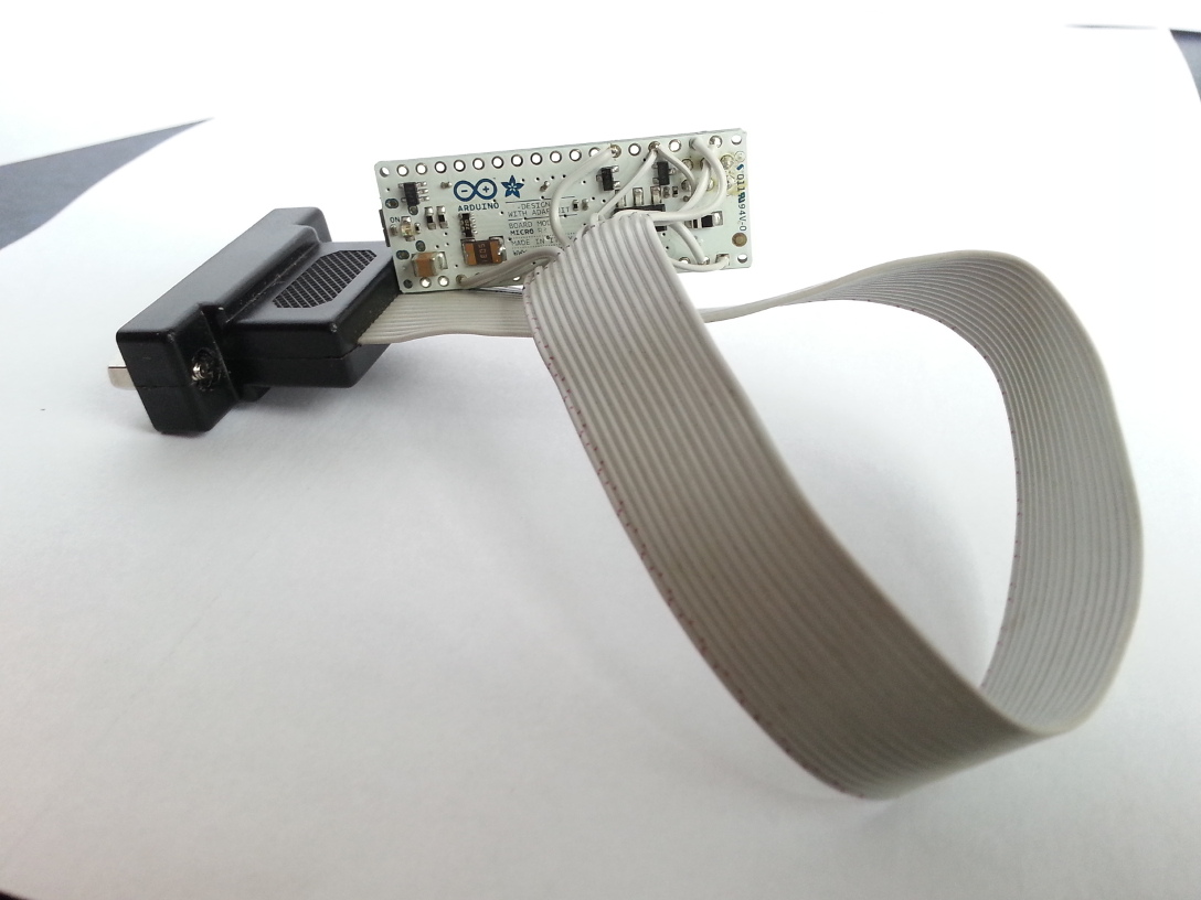

Connect the Arduino to the IBM Bigfoot DB15 cable. The second column "Pin" is the IBM pin numbering on the Logic Board. The 5291 Maintenance Library manual shows that the IBM numbering convention is different to IDC convention, so be aware!
| DB15 Pin | Pin | Duty           | Atmel |
|        1 |  20 | GND            |       |
|        2 |  18 | GND            |       |
|        3 |  12 | GND            |       |
|        4 |  13 | +5V            |       |
|        5 |  17 | Count  1       |   PB0 |
|        6 |   1 | Count  2       |   PB1 |
|        7 |   3 | Count  4       |   PB2 |
|        8 |   4 | Count  8       |   PB3 |
|        9 |   8 | Count 16       |   PB4 |
|       10 |   9 | Count 32       |   PB5 |
|       11 |  10 | Count 64       |   PB6 |
|       12 |  19 | Matrix Strobe  |   PD1 |
|       13 |  11 | +Key Depressed |   PD0 |
|       14 |  14 | Frame Ground   |       |
|          |   2 | Not Used       |       |
|          |   5 | Not Used       |       |
|          |   6 | Not Used       |       |
|          |   7 | Not Used       |       |
|          |  15 | Not Used       |       |
|          |  16 | Not Used       |       |
I used a DB15 socket salvaged from an ancient PC ISA sound card, which had a DB15 joystick port. The pin numbers on that are also rearranged, so I needed to expand the table above:
| Ribbon | DB15 Pin | Duty           | Atmel pin | Arduino micro pin |
|      1 |        1 | GND            |           |                   |
|      2 |        9 | Count 16       |  28 PB4   | J5-13 IO8         |
|      3 |        2 | GND            |           |                   |
|      4 |       10 | Count 32       |  29 PB5   | J5-14 IO9         |
|      5 |        3 | GND            | PAD GND   | J6-04 GND         |
|      6 |       11 | Count 64       |  30 PB6   | J5-15 IO10        |
|      7 |        4 | +5V            |  34 +5V   | J6-06 +5V         |
|      8 |       12 | Matrix Strobe  |  19 PD1   | J5-07 D2/SDA      |
|      9 |        5 | Count  1       |   8 PB0   | J5-02 RXLED/SS    |
|     10 |       13 | +Key Depressed |  18 PD0   | J5-08 D3/SCL      |
|     11 |        6 | Count  2       |   9 PB1   | J6-01 SCK         |
|     12 |       14 | Frame Ground   |           |                   |
|     13 |        7 | Count  4       |  10 PB2   | J5-01 MOSI        |
|     14 |       15 | Not Used       |           |                   |
|     15 |        8 | Count  8       |  11 PB3   | J6-02 MISO        |
The complete picture of connections to the Arduino:

The result:
I have a collection of photos showing the internals of the Bigfoot. These were taken while cleaning, and reassembly photos show how I reinserted the space bar with the help of dental floss and a spanner. Photos will follow soon that will reveal how that odd combination worked.
Soarer explains that the IBM Bigfoot contains only a demultiplexer and a cap-sense chip, and no microcontroller. There's no need to rip any of the original electronics out to be replaced by the Arduino/Teensey, just connect to the original DB15 and cable, or plug directly into the 20-pin IDC connector on the Keyboard Logic Card (as it is called in the 5291 Maintenance Library manual for the IBM terminal).
I found another discussion about adapting the Xwhatsit Grand Unified IBM Capsense USB Controller to be used on the IBM Bigfoot. It seems that the lack of microcontroller was not noticed there. In effect, the Xwhatsit controller hardware also has a demultiplexer, and uses the ATMEL analogue comparator inputs to detect keypresses. The IBM Bigfoot provides this, and potentially the Xwhatsit ATMEL controller software code could be used after minor edits. I may try that to replace Soarer's Controller software.
