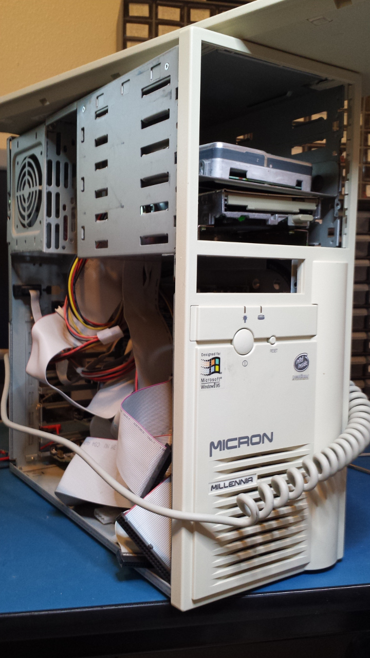

I refused to believe that all three boards were bad but behaved the same way when plugged in to a PS/2 port (although technically, yes, they could have been). So I dug out an old P1-233 1998-era box with an AT connector - that worked.

What does the P1-233 look like?

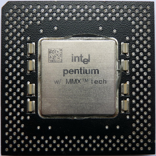

Whats a P1-233 1998-era box? You mean a computer with a Pentuim 1? So you're having trouble with your mainboard? The first Pentium processor is from 1993 I believe.

Yes, it was an old computer that I'd kept around (was using as a Linux firewall), and hadn't been fired up in years. Out of curiosity I wanted to see if plugging the keyboards directly into its AT connector would work, and it did.

Redmaus wrote: What does the P1-233 look like?
Sporting no case, a 3.5" floppy, and a massive 2.6GB hard drive! Sorry, it's not for sale. :lol:

Looks ancient! o.o

Actually it has a wee bit of fairly uninteresting history. It was purchased by my brother brand new in 1996(?) or close to it; it was originally a 150MHz Pentium 1. Skip ahead a few years and it ends up with a dead motherboard. I refused to let my brother toss it out, so I ended up transplanting a P1-233 mobo into it so it could be assimilated into my Linux cluster. Years later after that was all dismantled, I used it for interfacing to various electronics projects (I remember using avrdude on it in 2006 to program an ATmega8). Ultimately the pipeline of newer machines pushing old ones out relegated it to disuse, but I couldn't throw it out because of the sentimental attachment. This is how hoarding begins.
