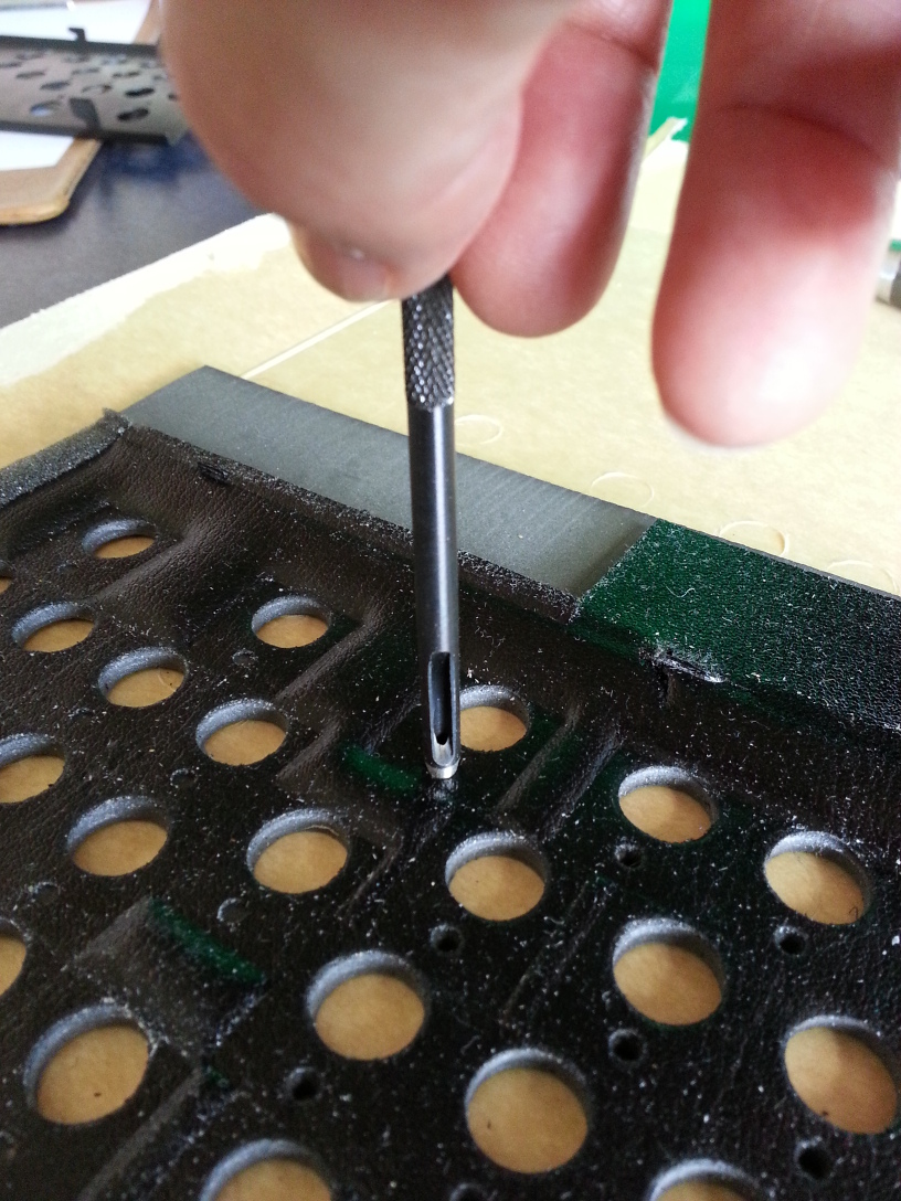

I bought a pair of hole punches, 12mm and two millimetre diameter, and far more foam than I really needed, and set to work. I honed the hole punches to a much keener edge, so that they cut the foam with a gentle twist of the punch. No need for hammering.

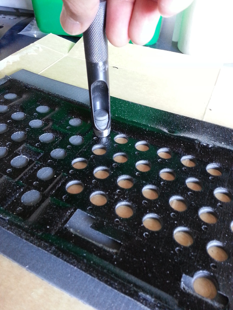

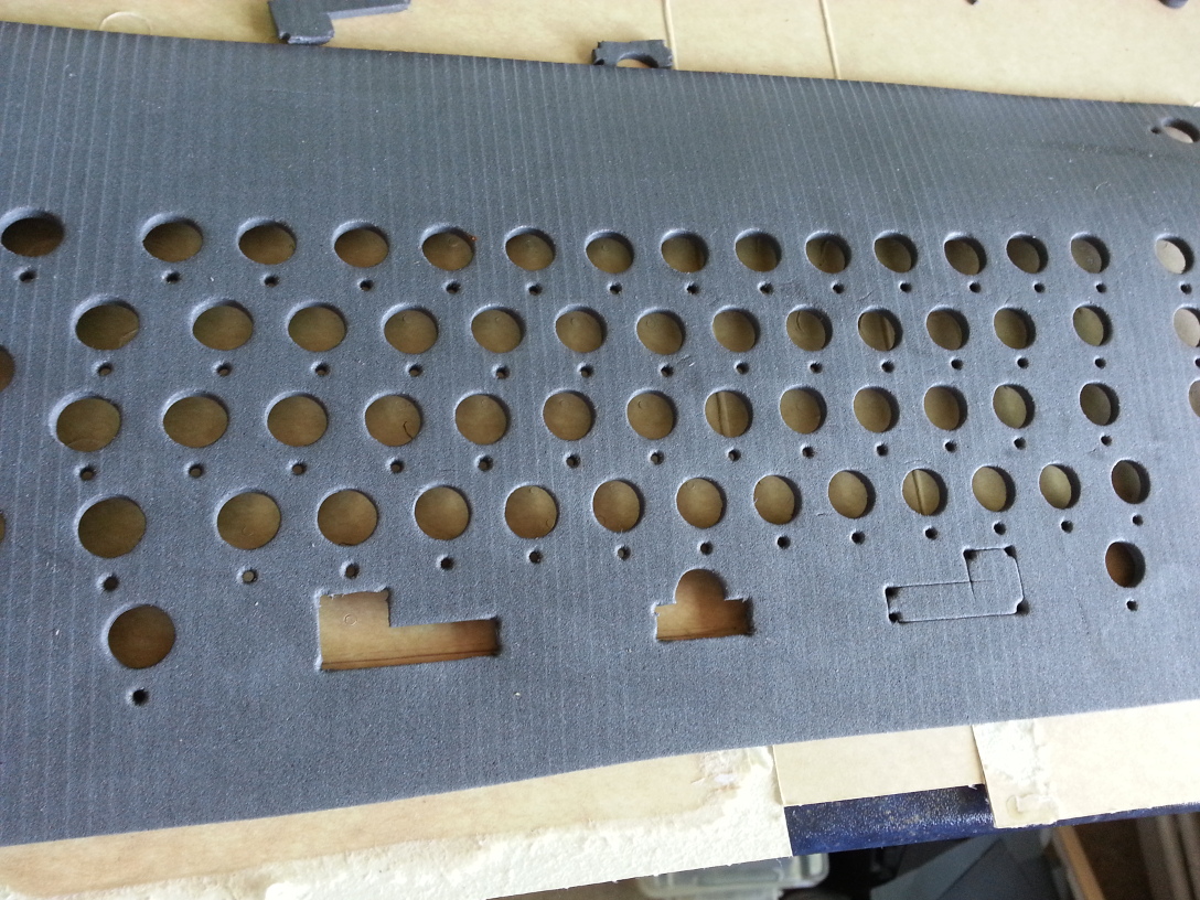

Using the original sheet of foam as a template, the holes are cut with a gentle twist of the hole punch tool.
Cutting the 12 mm (1/4 inch) holes
Cutting the 2mm (1/16 inch) holes
The corners of rectangular shapes are first punched through with the 2mm tool.
Holes for the space-bar assembly

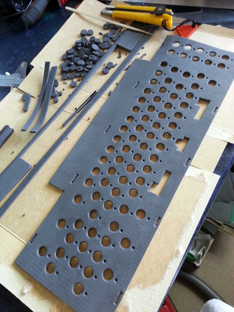

All cuts complete. The slits along the top and bottom allow the fastening tabs on the front iron plate to pass through to the rear iron plate.
Finished cutting
Finished cutting

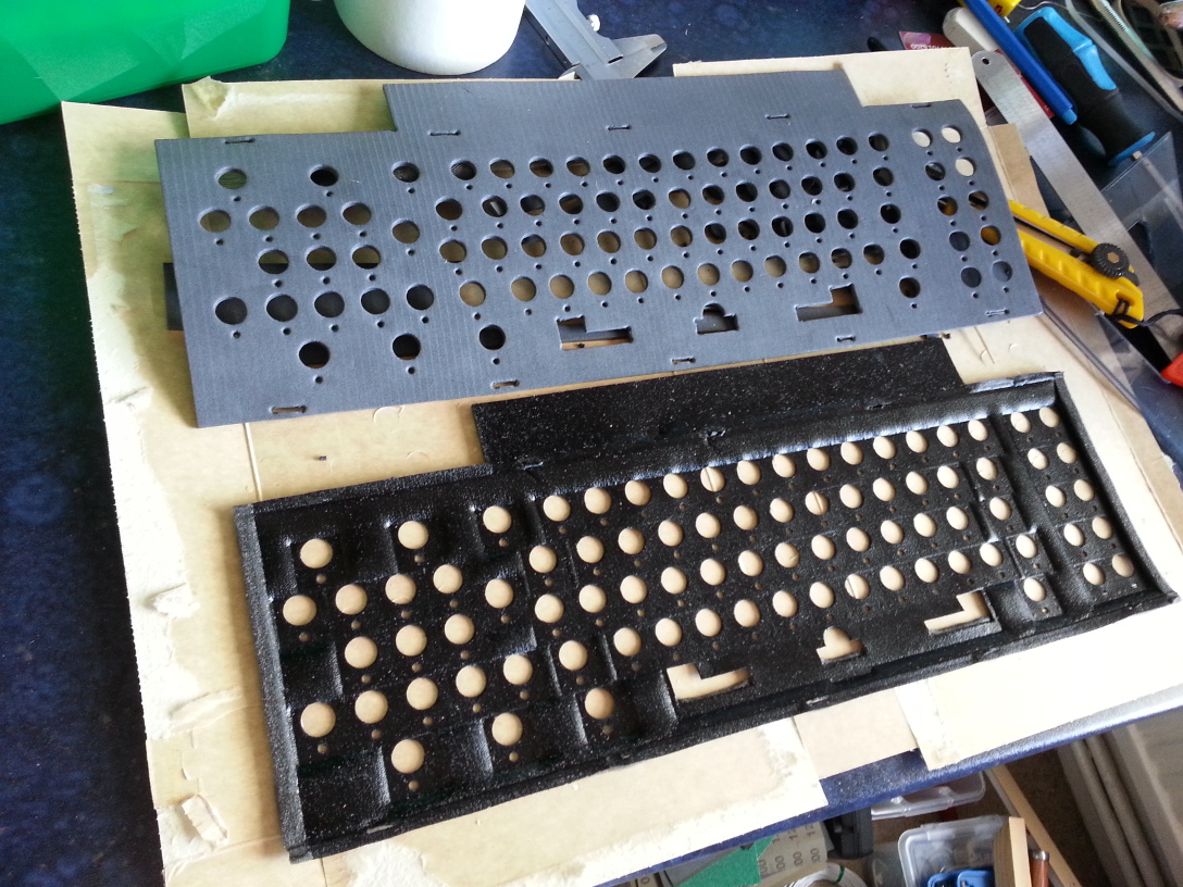

The original and the new foam, side by side.
Side by side with the original foam

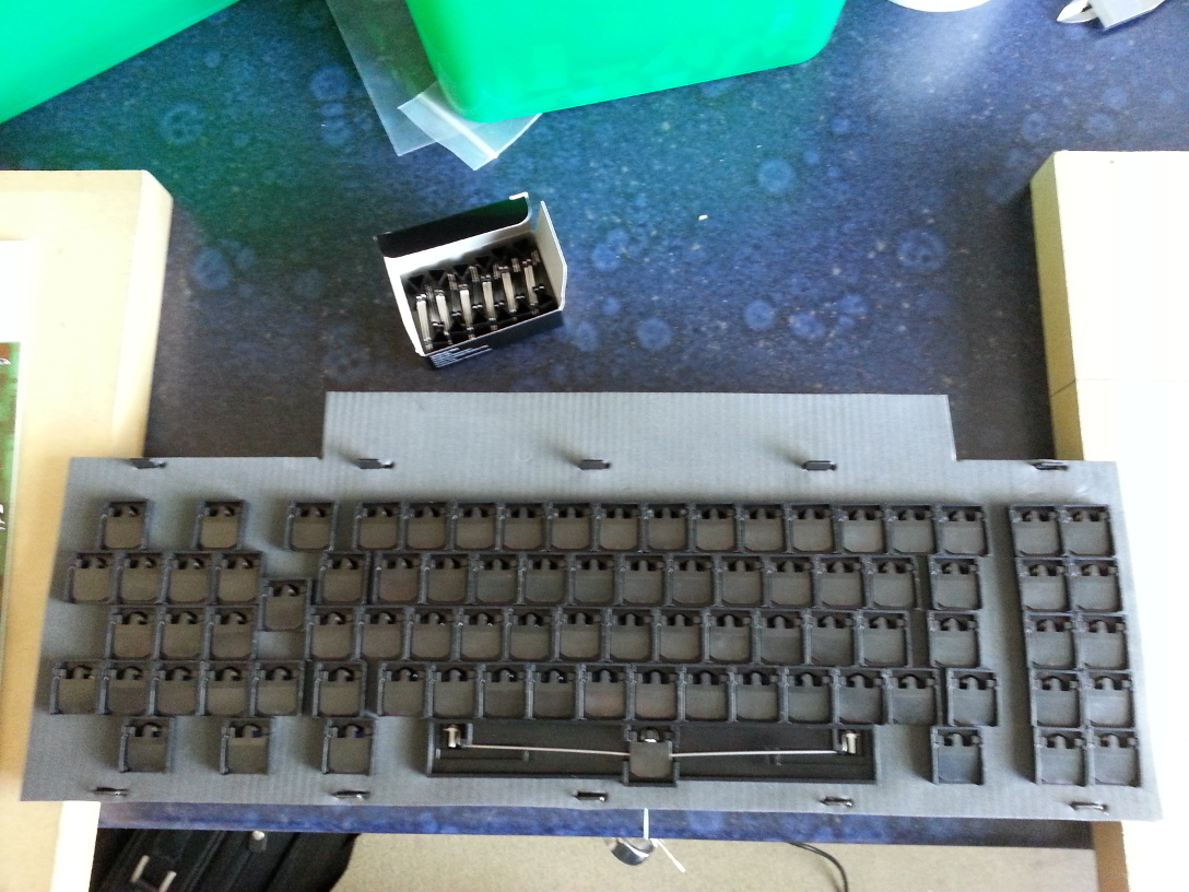

Inserting the barrels. The fit was appropriately snug.
Assembly
Assembly

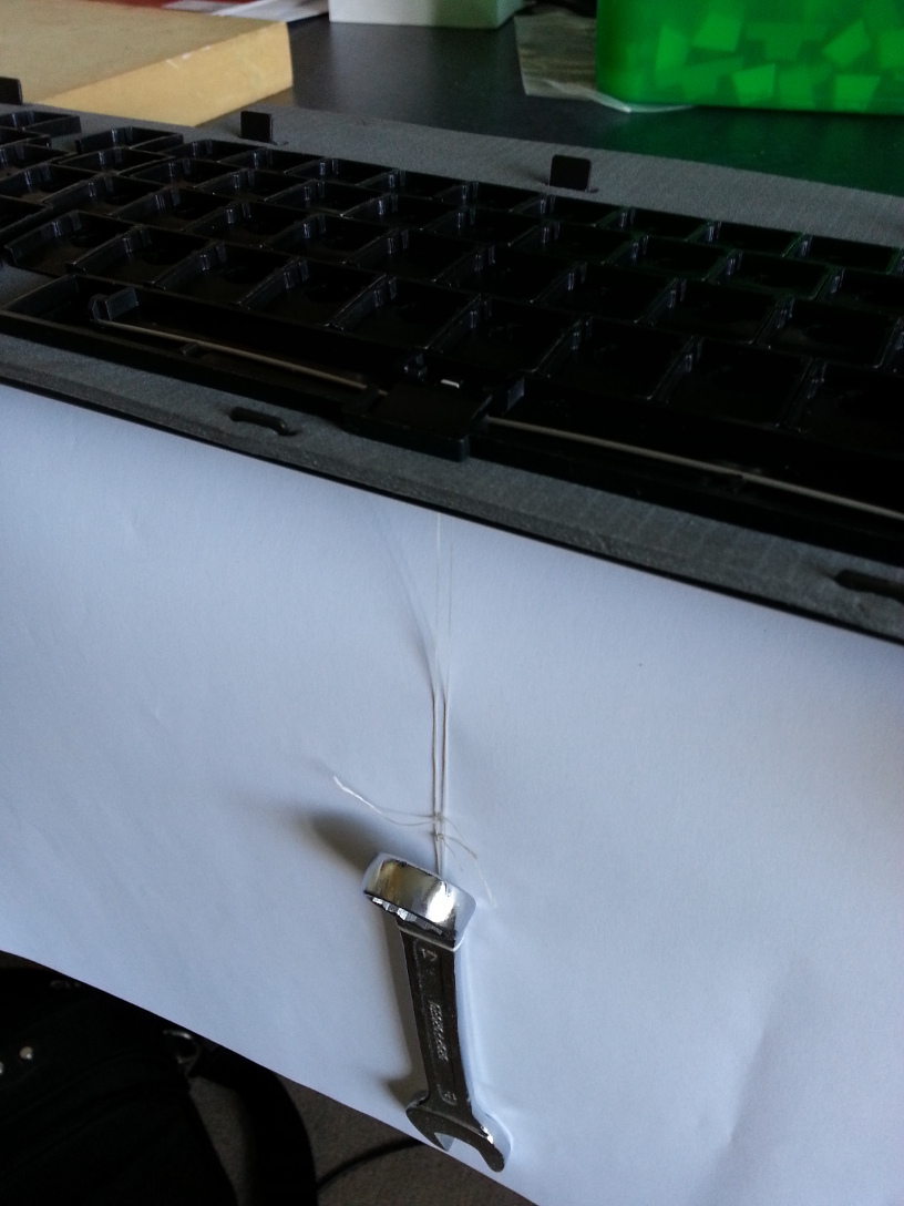

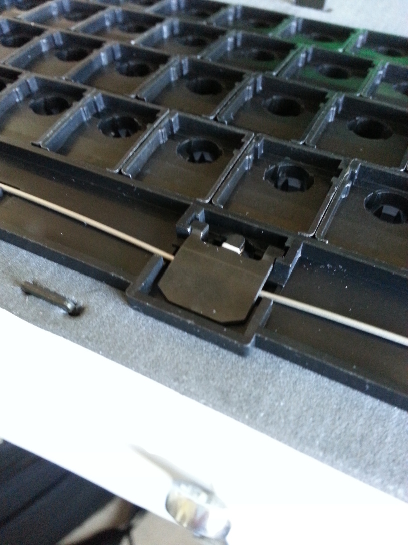

The space-bar is tricky, the flipper has to be held down in place because the space-bar must be hooked up to the stabiliser wire from inside. It's not possible to hook up the stabiliser wire from the outside, after attaching the front and back iron plates together. With the space-bar in position, the spring is compressed with a loop of floss attached to a suitably heavy spanner.
Holding the flipper for the space-bar in place during assembly.
Detail of the floss holding the flipper in place
