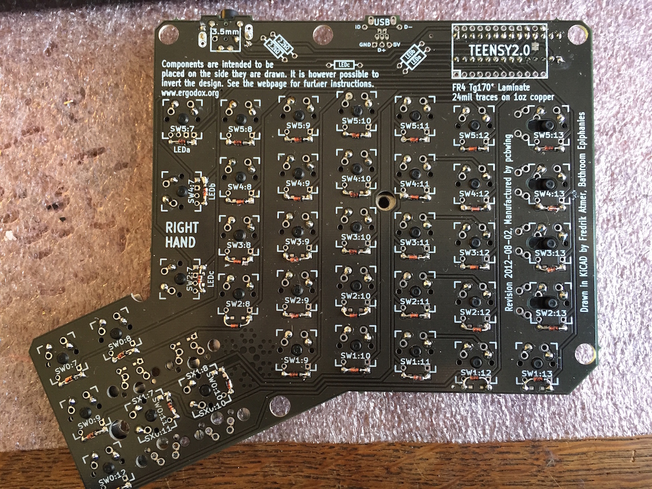

I just build my first ErgoDox (sourced from Falbatech). After soldering everything and uploading the firmware, everything works fine except column 10 and 11.
Basically when I type "2" it registers "23", and when I type "3" it registers "23".
It is the same for the whole column ("w" and "e" both register "we", and so on).
I guess there must be a short somewhere but I can't find it.
I prefer asking before unsoldering everything...
Here is the backside of the PCB :
Photo 11-10-2015 12 36 09.jpg (803.7 KiB) Viewed 1698 times
11 Oct 2015, 13:09
It is hard to see, but is SW1:11 OK?
Is a diode leg long enough to touch the plate?
Do also check the thumb cluster - the columns go there too.

raphaelm
11 Oct 2015, 14:31
Thank you!
It was indeed a short on the I/O controller. There was a small spot of solder shorting two legs of the I/O controller.
