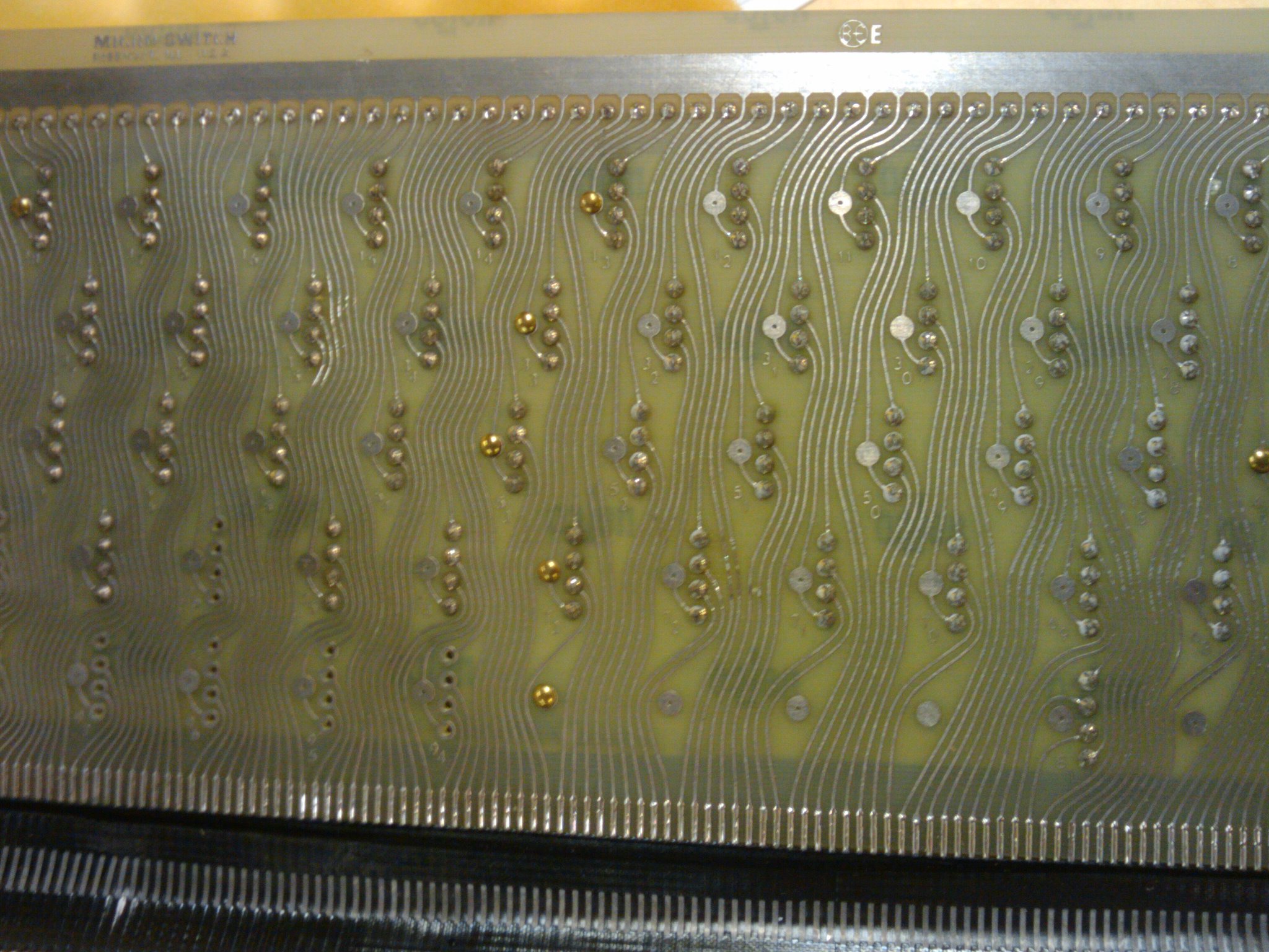

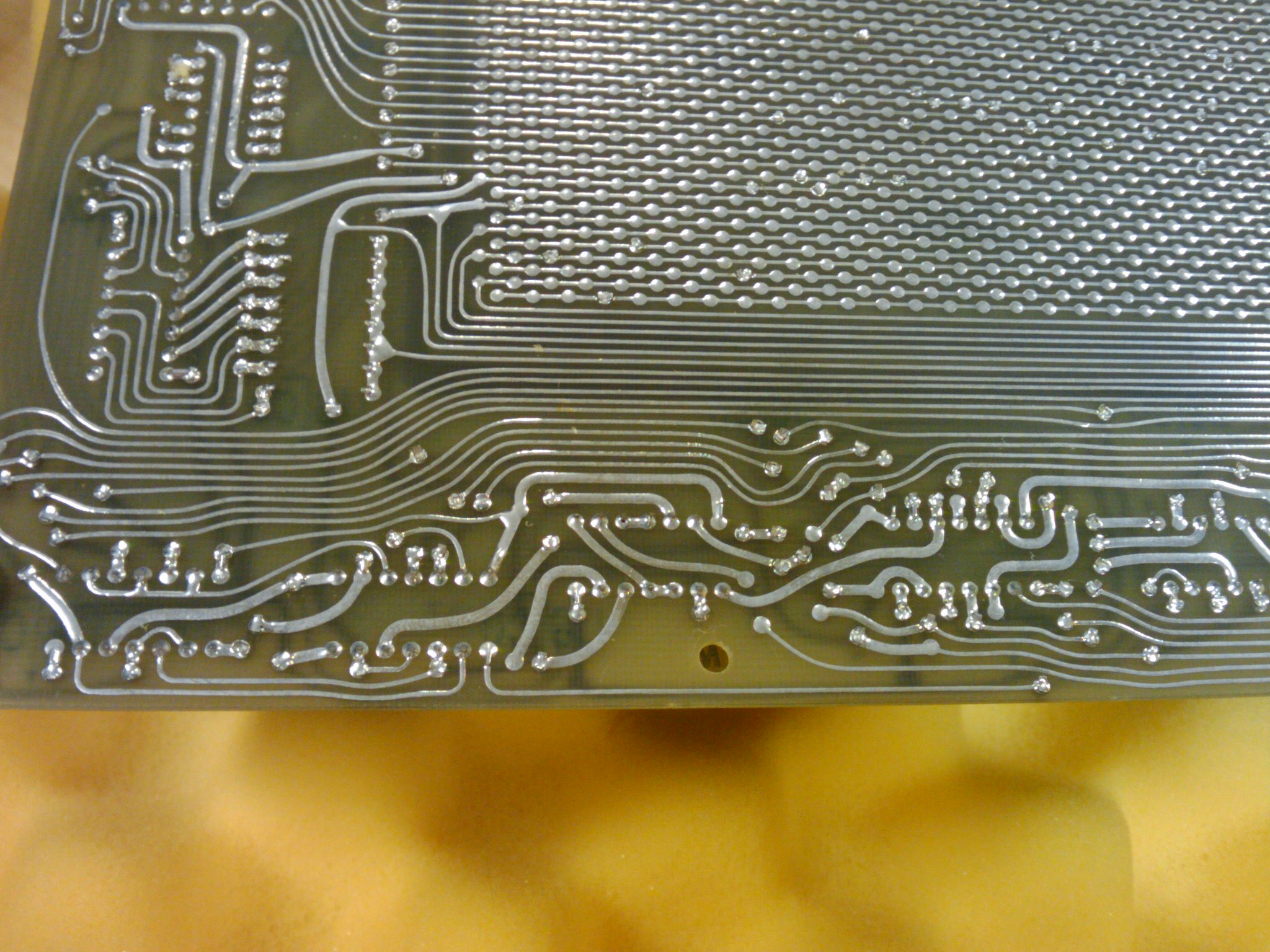

I thought there was already a thread like this here, but I can't find it. Here are some of my photos:
(not sure if they're all hand drawn or not)

Merçi monsiuer mr_a500, et monsieur webwit,
The George Risk is very striking, with the deep cobalt blue background and silver Greek meander motif. It has an optical art style that seems fitting for the 1970's. I have seen the blue substrate on some Burroughs plug-in circuit boards too, on eBay, from the same era.
The Keytronic has traces seemingly leading nowhere. They don't appear to be sufficiently broad enough to have any capacitive effect, or some other electronic voodoo. They do make me think of Flamenco dancers... My imagination is getting the better of me.

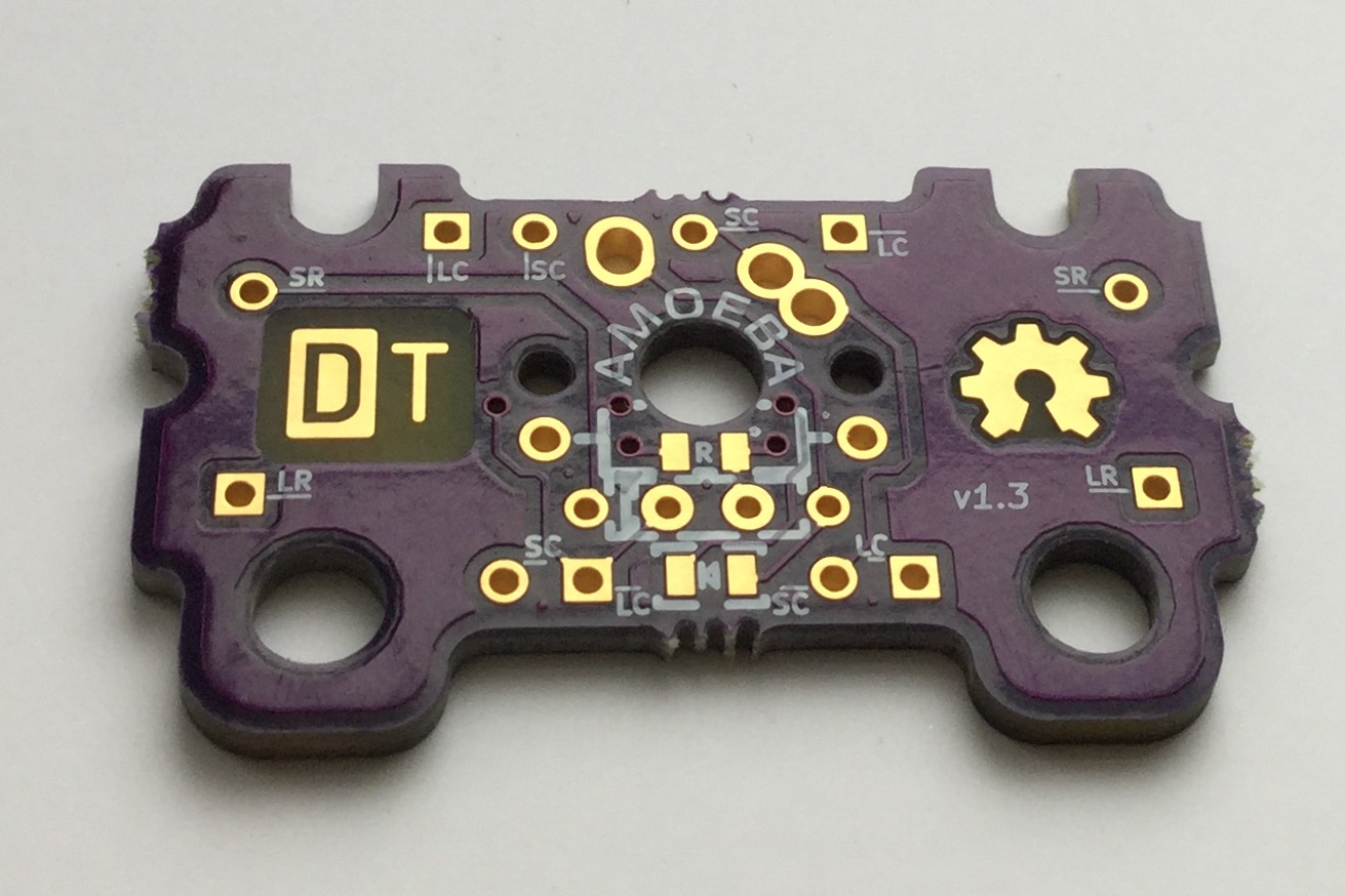

You can get closer to a hand drawn look if you render the traces in SVG using Bézier curves. Then the SVG can be imported into KiCad as a footprint / module by approximating the curves using polygons, which seems to be supported in Gerber and sufficiently high resolution to look perfectly smooth when fabricated. In another thread I posted a tool (svg2mod.py) to help with that. :)
Edit: Here's an example from a recent prototype run.. The DT and OSH logos are based on SVGs with curves converted to polygons. The same technique could be used for traces.
