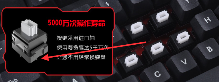

I saw a board on the various rubbish-from-China sites once that apeared to have ALPS-like switches but you could see a PCB, not a plate. It was under the name "MG Flame" and I didn't buy one because I fgured there'd be no way to transplant GOOD switches onto it and retain integrity.

stratokaster
19 Nov 2015, 09:27
Hak Foo wrote: I saw a board on the various rubbish-from-China sites once that apeared to have ALPS-like switches but you could see a PCB, not a plate. It was under the name "MG Flame" and I didn't buy one because I fgured there'd be no way to transplant GOOD switches onto it and retain integrity.
http://www.aliexpress.com/item/High-Qua ... 03086.html for pics
Looks like those switches have mounting pins
Screen Shot 2015-11-19 at 10.26.06.png (270.79 KiB) Viewed 2475 times
