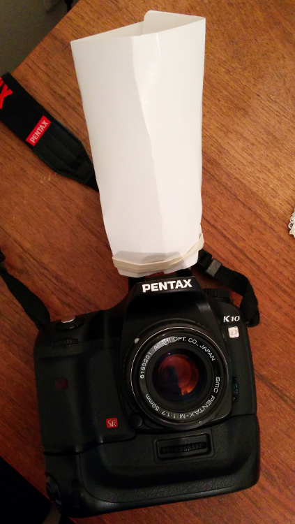

30 Nov 2015, 19:48
I actually don't get around flashing depending on the time of year, to diffuse my flash away from whatever I'm shooting I just use a white piece of thin cardboard or packaging and a rubber band to wrap around my flash as such:

30 Nov 2015, 20:16
That's also a good idea, seebart! I also did this, there are even sophisticated models to buy our there for using the internal flash. Biggest difference will be the power of the flash though...
