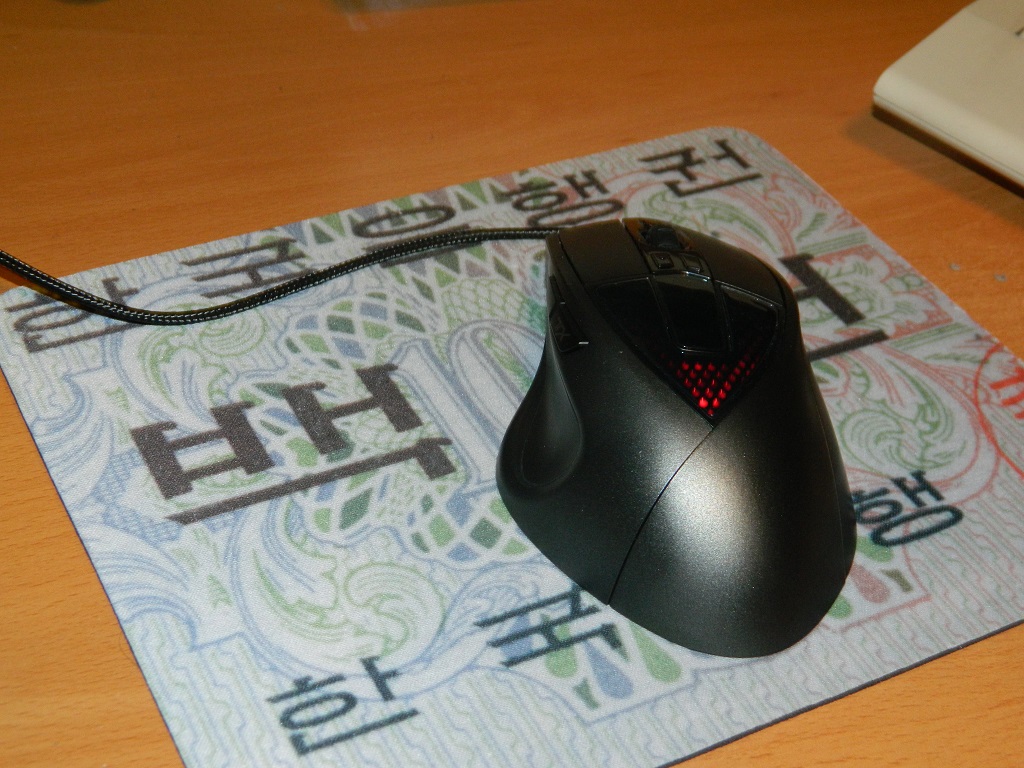

I was immediately fairly comfortable with the shape of the Sentinel III, being fairly reminiscent of the M500. It's contoured enough to fit the hand, without some of the more extreme bends that could be uncomfortable over long periods or unaccomodating to extra large or small hands. The surace is just hard plastics, possibly painted, and there are several seams. I expect over the years to see a bit of dirt collection there, but it won't have the issue of the surface wearing or peeling off the way some premium mice do.
While the main switches are satisfyingly clicky, the side buttons have an softer hollow snap- not quite dropping down to "tactile only" but nowhere near as loud as the main buttons.
The build quality seems solid enough, but at the cost of it looking like the whole thing is permanently snapped/fused together. It does not look like you could trivially disassemble it without damage. It has one of those nice loomed-look cables-- all the trend, but do they collect more dirt than a similar smooth cable exterior?

Now here's where it becomes entertaining. When I took the mouse home, my first attempt to use it was the "naive" approach-- plug it into a socket and drop it on my ordinary Ikea laminate-covered desk. The cursor doesn't budge. Occasionally you get a twitch at the highest DPI setting. But clearly not registering motion in a meaningful way.
So I run my finger over the sensor... some signs of life.
Proceed to an hour of thwapping the mouse, assuming "the sensor lens must have fallen out of alignment during transit", and trying to find a way to crack it open without destroying it. Finally, I try some other surfaces:
Old "Dilbert" comic anthology: Nothing
Final Fantasy XII game case: almost usable tracking at medium and high speeds.
Small copper ingot - perfect tracking. Wait a minute-- isn't shiny metal supposed to be really difficult for optical mice? I'll try some other metal pieces-- an old PC side panel, and a project box case... again, tracks fine... what's going on here?
Borrowed old mouse pad: perfect tracking.
So we can conclude the sensor really just hates a lot of surfaces, most significantly bare desks. This also means I have to get my hands on a mouse-pad. After a week in the post from Hong Kong or somewhere, I finally got one and was able to proceed to review the mouse as a mouse instead of an art object. (Bonus points for people who can figure out the design on the pad-- a nod to one of the few hobbies more expensive than input devices)
