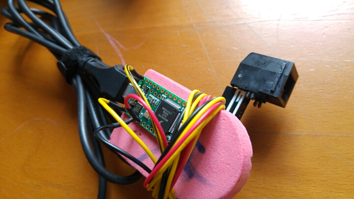

Got an IBM 5155 yesterday and tried this out. Worked great man. Thanks manakin. Just need to put this on a box.
Found out some use for those fan extensions.
