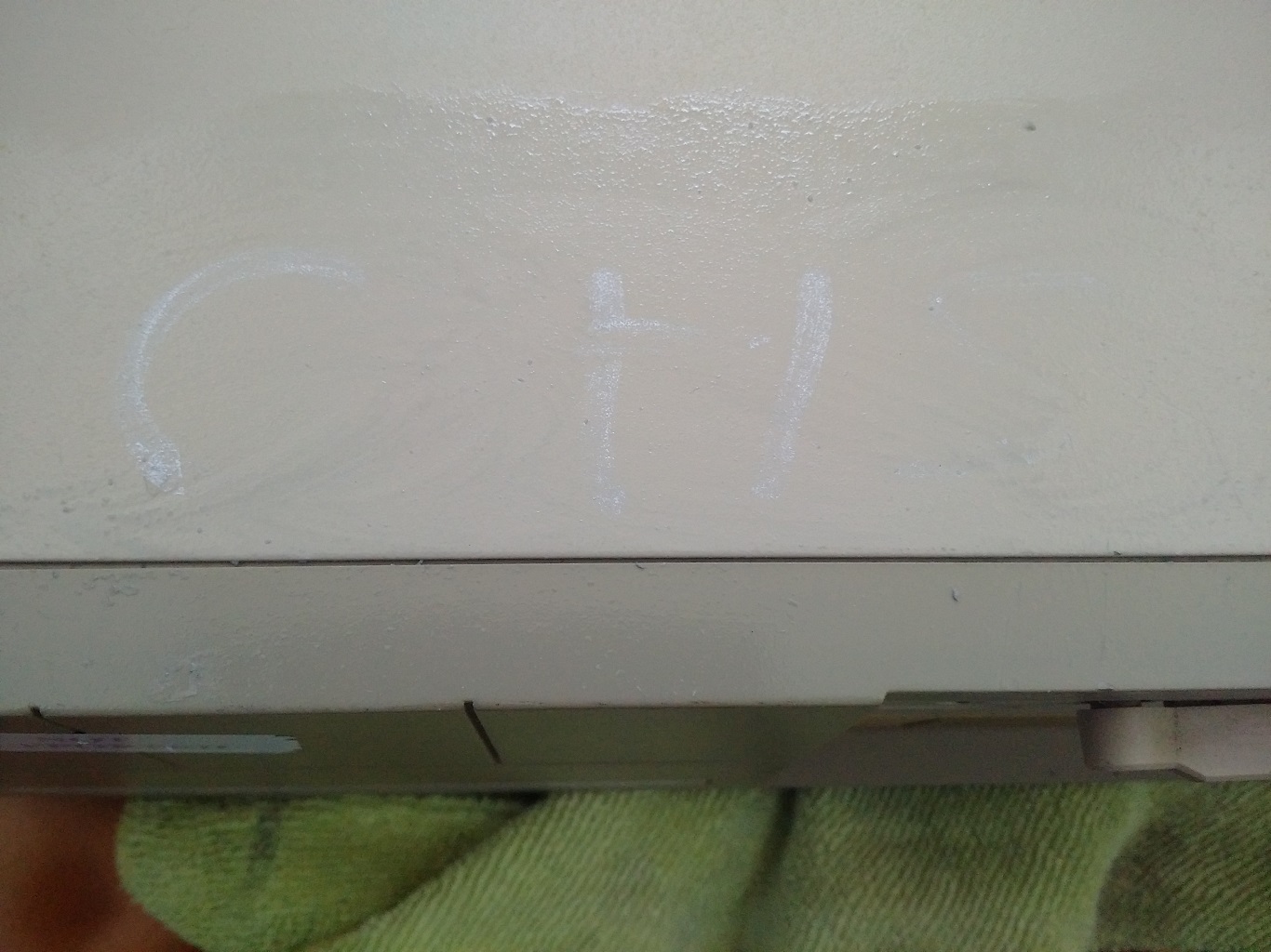

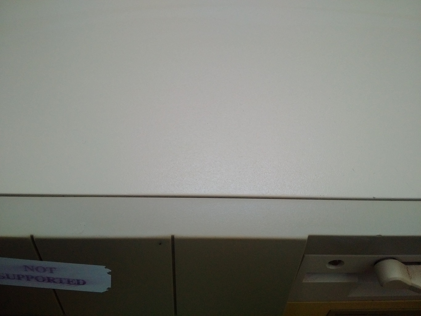

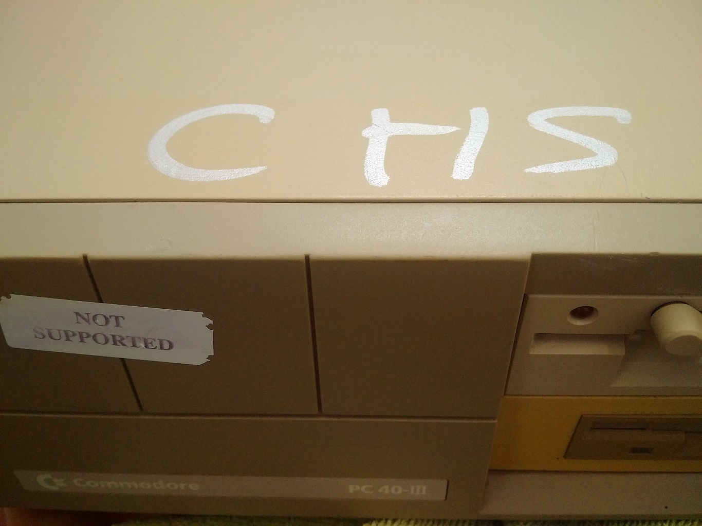

You don't need very long with Dot 3 Brake Fluid. I would say 10 - 30 minutes at the most. Make sure you clean the key caps in soapy water afterwards. I use this all the time to remove marker and spray painted labels. I have actually removed paint off of a painted metal case before too.
NOTE: Your mileage may vary. Try it on one item until you get the timing right. I try to take off the brake fluid as soon as possible just in case.

I have done this with monitors and keyboards but not specifically with keys. Marker almost vanishes. Paint needs to be rubbed off depending on how long you wait. You can do it multiple times (as shown above) to be safer. If I left it sitting for 24 hours, the original case paint would have come off.
