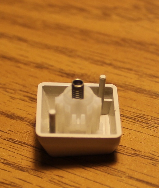

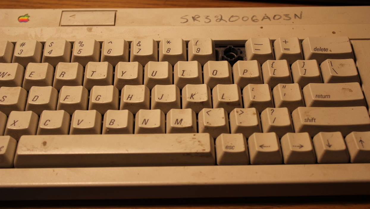

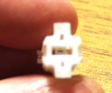

I know this is supposed to have rubber sleeves, according to the wiki, but this one does not. It was manufactured in Taiwan. The insert inside the caps is so difficult to remove that I am afraid any more insistence on my part will break something. Inside is a clear membrane over what appears to be a shiny metal plate. This keyboard weighs about 2.8 pounds, which is rather heavy for this type of Apple keyboard. Suggestions, anyone?
Edit: I am trying to get this listed on my site for sale, but I don't know what this switch is!

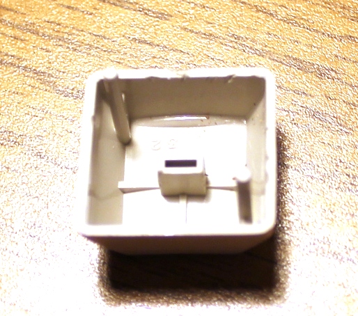

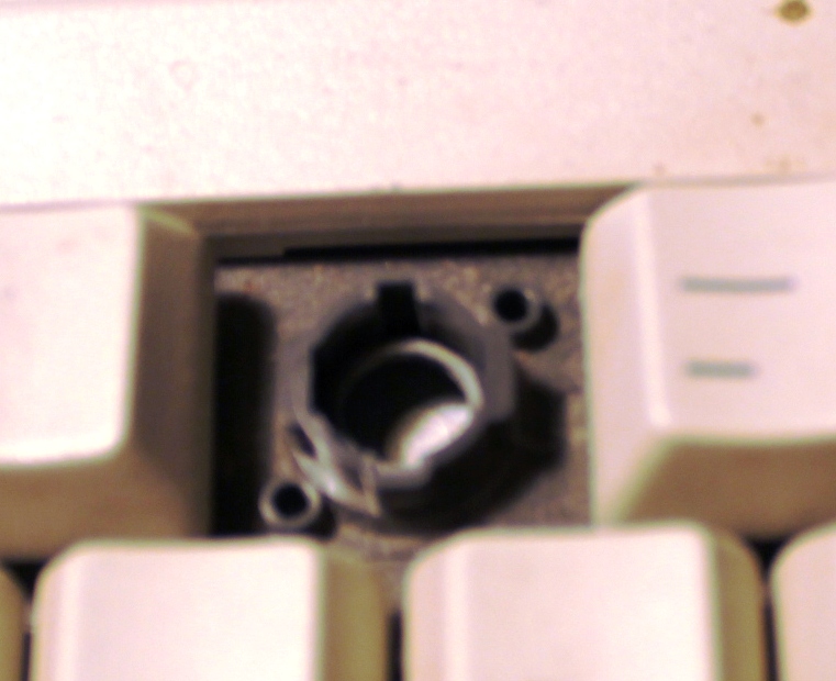

After several minutes of fiddling, I got it to come apart.
Does that give anyone a better idea what this is?

SMK Alps mount spring over membrane?
elecplus
10 Apr 2016, 04:31
Does that make it some sort of buckling spring? It does not "click" but it does have an actuation point before it bottoms out. It is rather quiet to type on, but does not feel like a rubber dome at all.

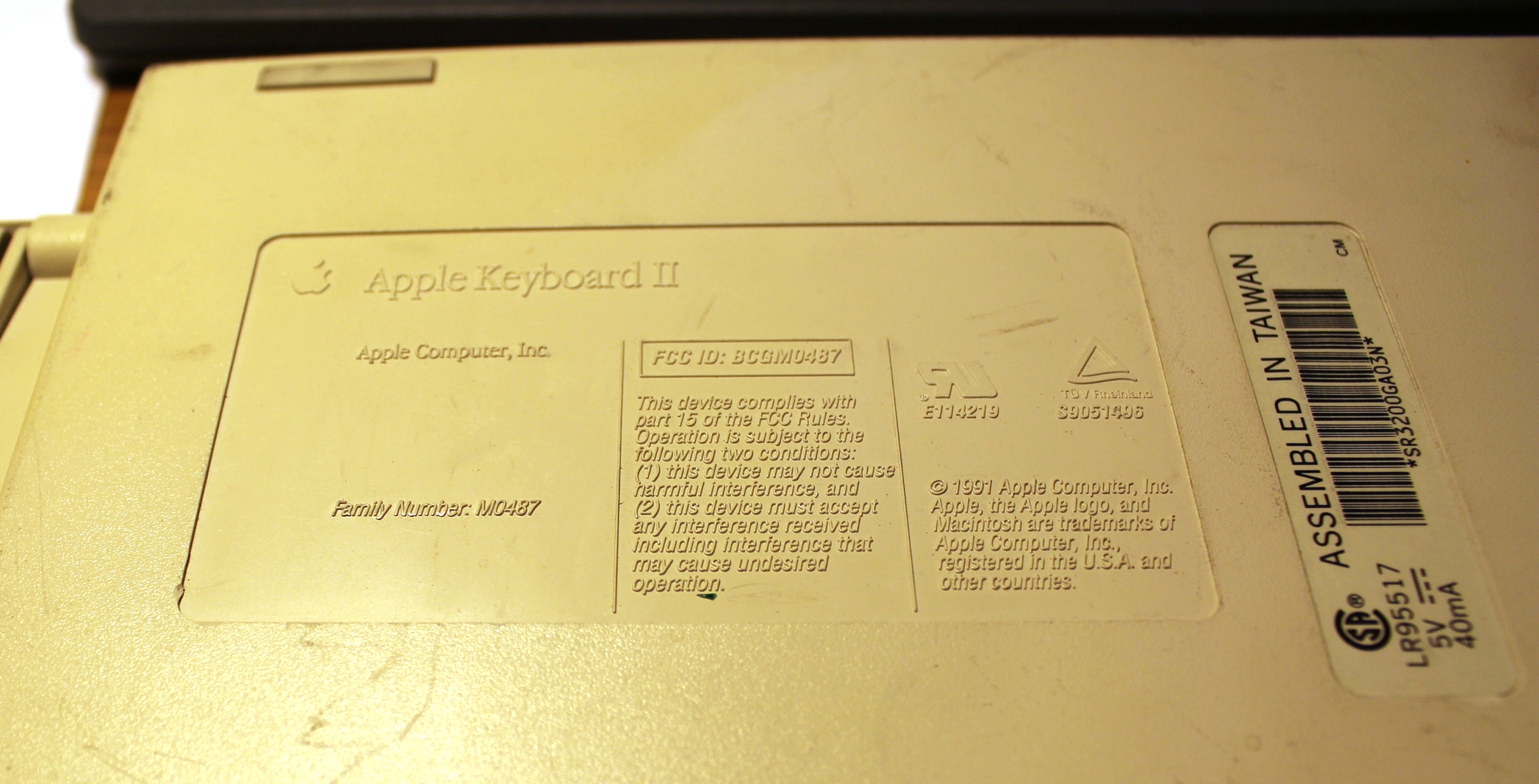

Redmaus
Gotta start somewhere
10 Apr 2016, 06:26
Picture of the back? I had a board just like this with rubber sleeves and it definitely didn't weigh 2.8 pounds.

It might buckle, but I can't say for sure without examining the switch in person.
I'm basing my guess on the wiki entry (which says that some were made by SMK with the aforementioned switch) and the following site.
http://www.applerescueofdenver.com/prod ... -ii-parts/
elecplus
10 Apr 2016, 07:03
It matches Version B on Apple Rescue's site. Thank you, Ohaimark!

elecplus
10 Apr 2016, 07:07
Redmaus wrote: Picture of the back? I had a board just like this with rubber sleeves and it definitely didn't weigh 2.8 pounds.
Here you go, Eric :)

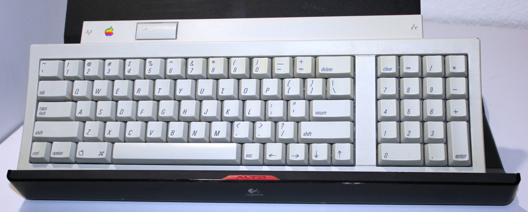

elecplus
24 Jun 2016, 02:19
The same keyboard, cleaned up. I noticed something different about these keyboards while cleaning; the "dots" for finger orientation are on the D and K keys, instead of on the F and J keys!

emdude
Model M Apologist
24 Jun 2016, 03:46
That's pretty standard for Apple keyboards of that period, the Apple Standard and Apple Extended Keyboards are like that too. Yet another thing Apple was trying to do different from its competitors. :lol:
