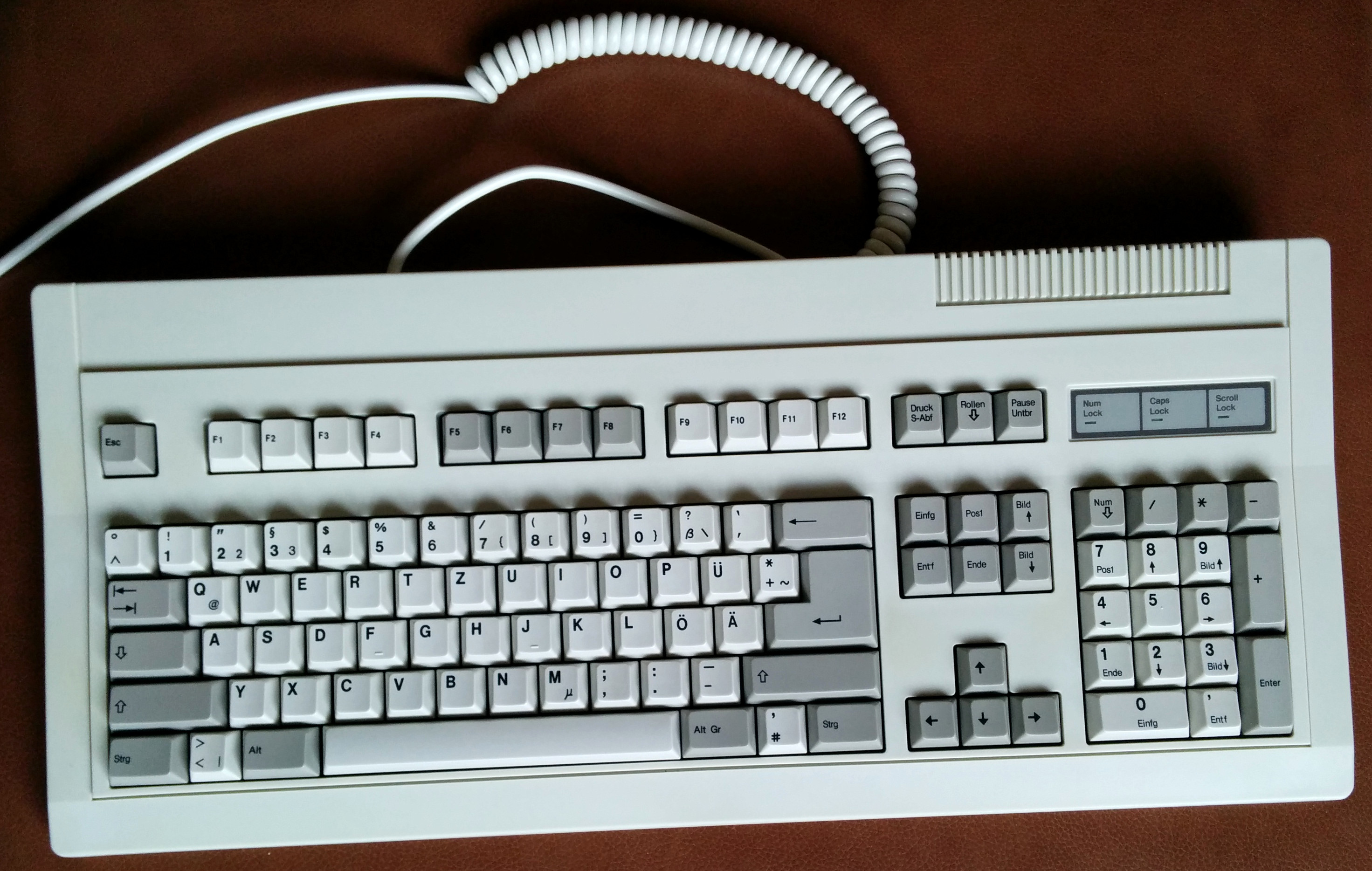

I have this 27 years old alps keyboard (AEK) which was full of dust when i bought it. I took it apart and cleaned it with detergent + warm water. Did the same for all the switches (springs, housing, plunger, metal leaf...) in the end i bathed them in the distilled water. But still, the switches do not feel as smooth as i think they should.
I do not want to lubricate them (because reasons) and i'm looking for a "mechanical" way to make the surfaces more smooth (polishing, "sanding"...?). Is that even possible? Has anyone tried this?
If this is not possible, which lube would be best?
