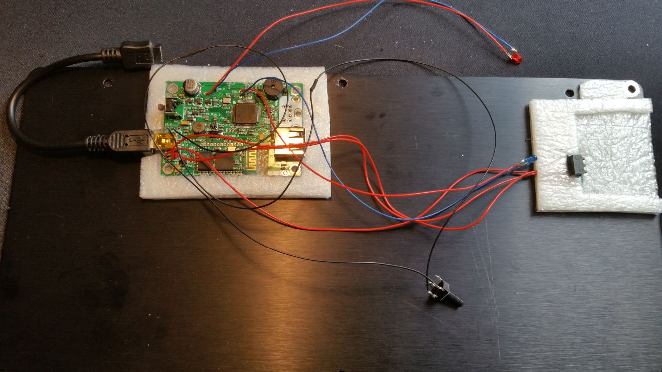

I used the Bluetooth Keyboard Adapter from http://handheldsci.com/kb
This adapter is excellent to mod.

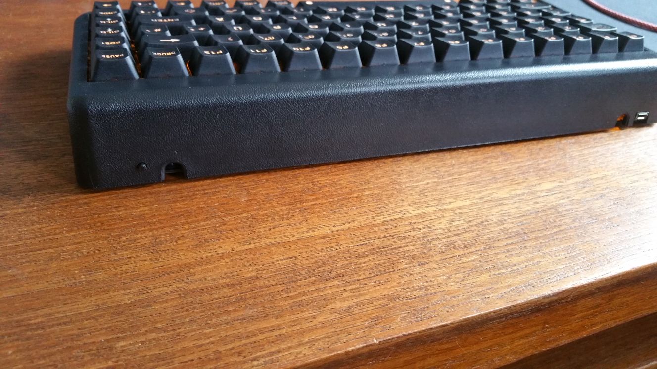

Behind the 2 holes (cable ports) are now the red and blue status LED.
The little stick is the on/off switch. In the back you see the Micro USB port for charging the battery.

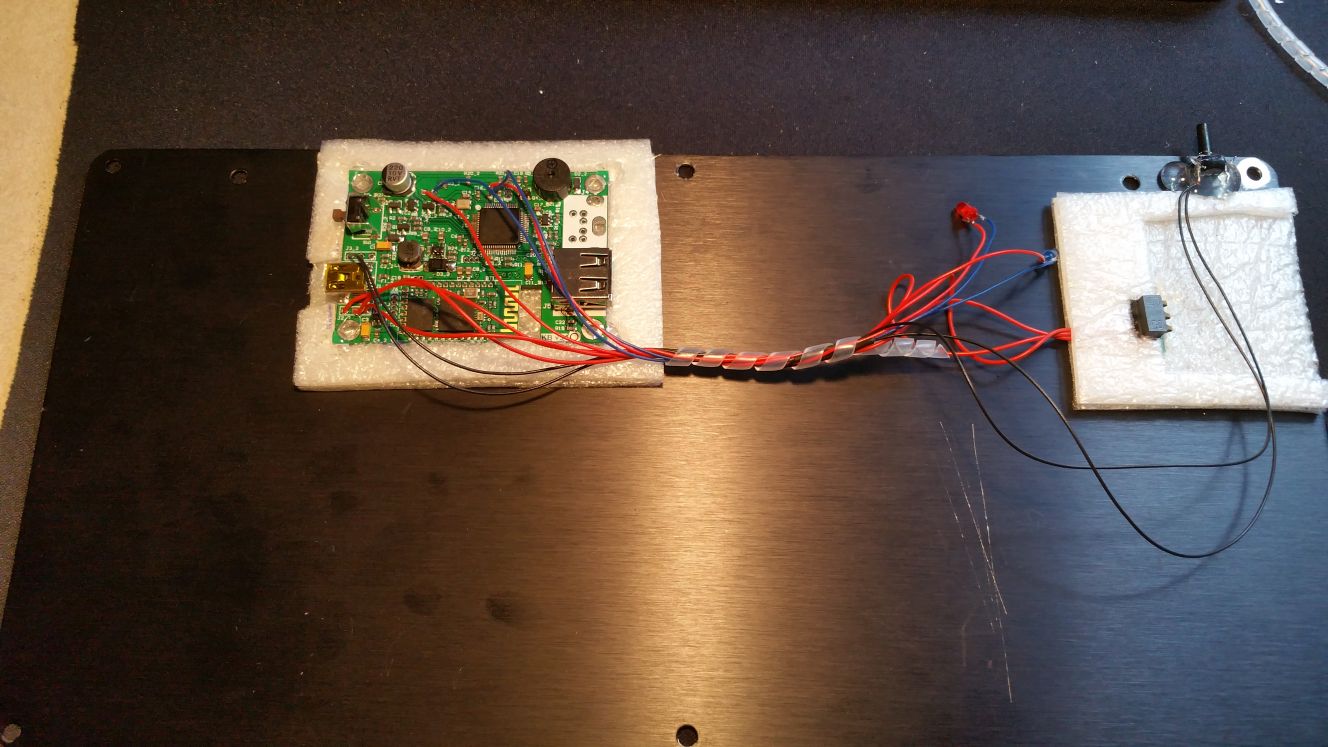

desoldered both led and PS/2 port (to high)

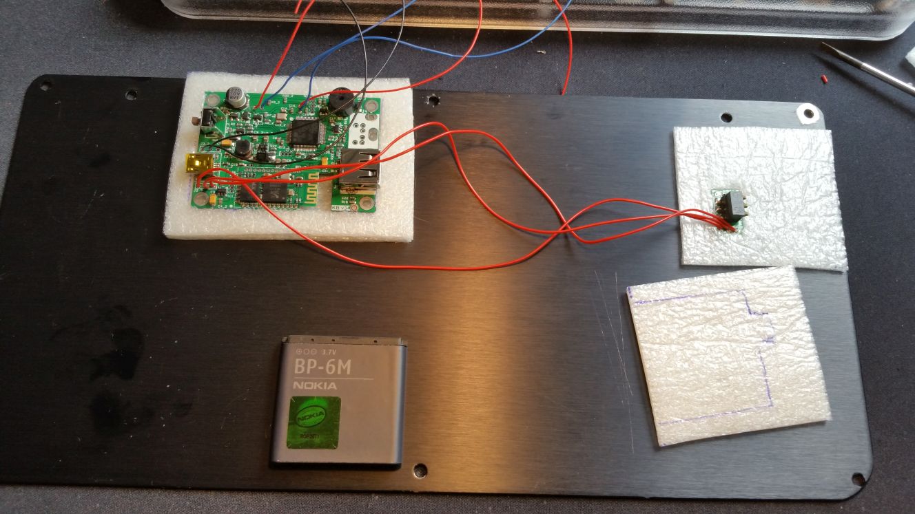

right sight will keep the battary
on/off switch fixed with hot glue only
Not so nice...

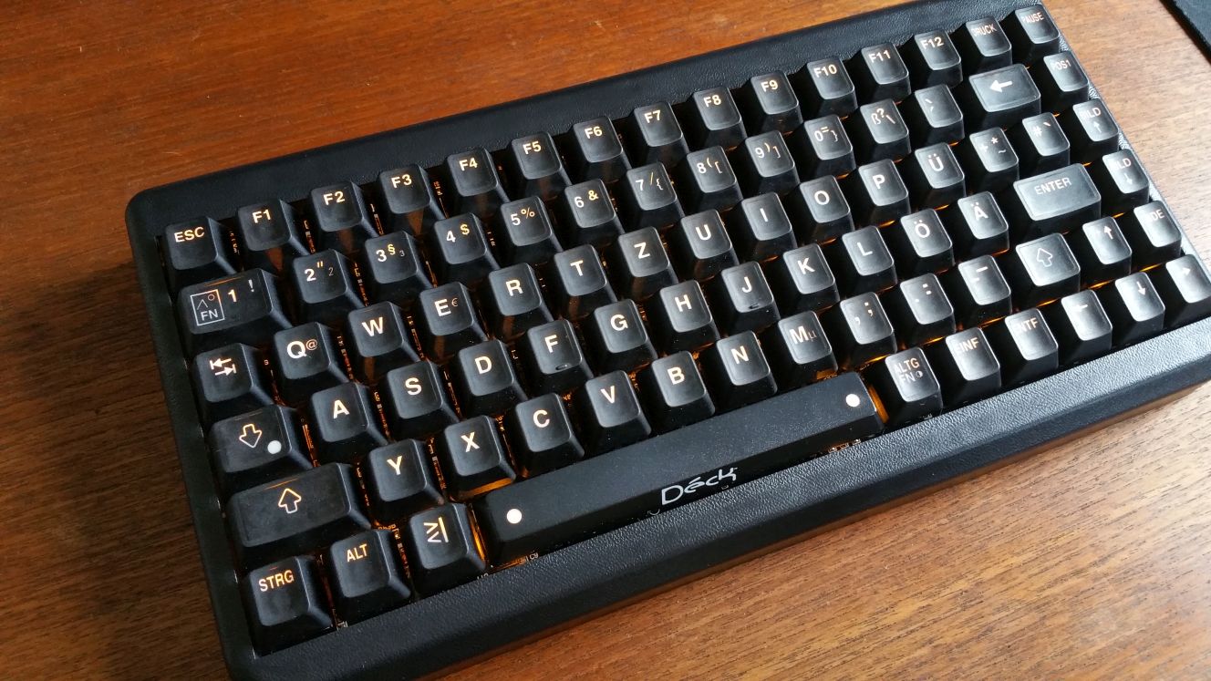

Speaker is loud, beeps for turning on and off. But you could both turn off via configuration. :)
This kind of Deck Keyboards starts always with led on! And it seems, that the ISO variant is not able to FN+0 to turn LED off.
I will ask my friend later how long the battery lasts. Maybe I will put in a bigger one.
