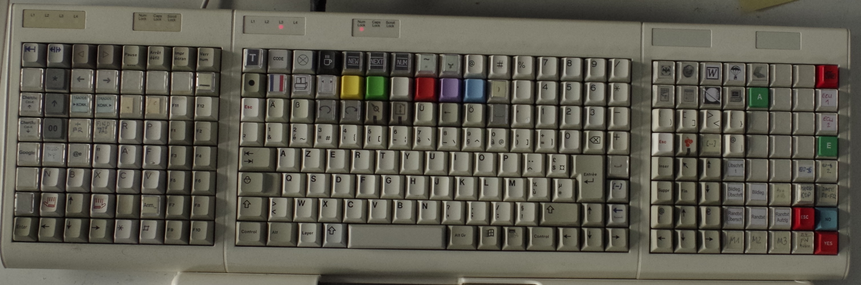

My solution (it has actually been my daily driver for a couple of years now)
is a Tipro point of sale keyboard with additional pads,
which has plate-mounted MX black switches and a metal backplate
and where every single key (even the space key :mrgreen: ) is freely programmable
with virtually any character or macro you like:
my Tipro 15-11-03.jpg (732.1 KiB) Viewed 14215 times

My man! :D Screw this minimalist bullshit everyone's into, just give me a bigger keyboard with more buttons! :D Especially programmable ones are quite useful.
I have a fairly small and cluttered desk at work, but even my fullsize ZKB-2R really doesn't cost me any space I need.
15 Jun 2016, 12:57
Chyros wrote: My man! :D Screw this minimalist bullshit everyone's into, just give me a bigger keyboard with more buttons! :D
:o :P
Morituri, while I'm not quite in need of 150 to 300 keys I like your approach as you can see by my choice of keyboard:

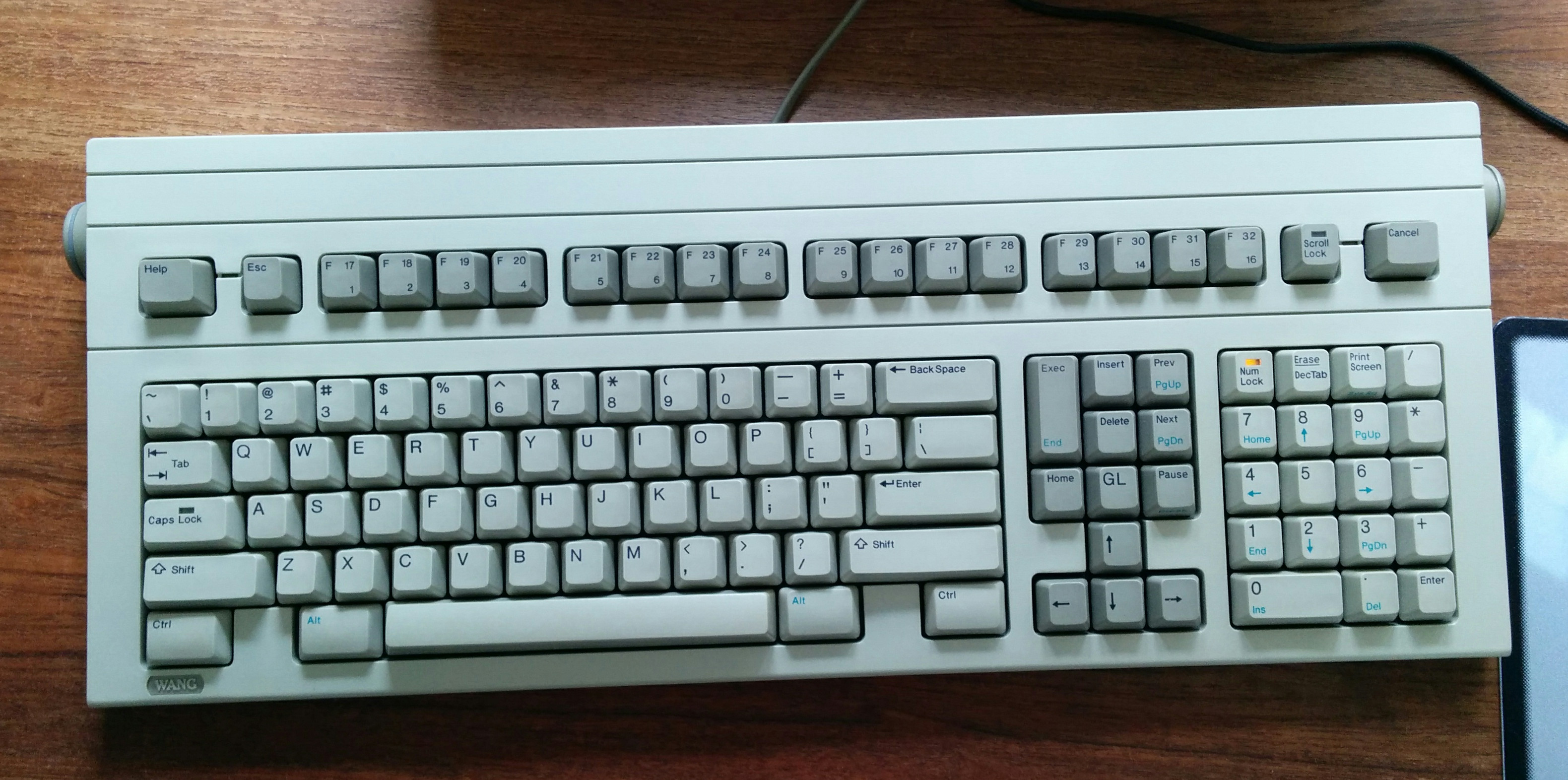

15 Jun 2016, 13:14
A 3771, a fine choice ^^ . Bleached, I presume?
15 Jun 2016, 13:26
Chyros wrote: A 3771, a fine choice ^^ . Bleached, I presume?
Yes but just the top part of the case, and only after various less precious plastics passed my testing. This is what it looked like:
photos-f62/wang-model-724-725-3770-us-t ... ang%203771

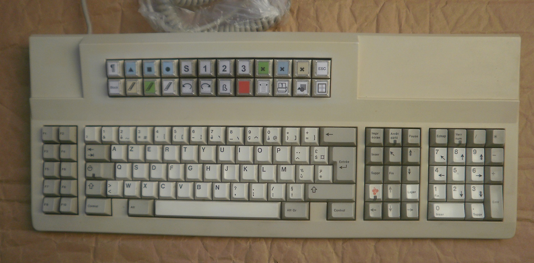

@Morituri
My story is quite similar. I have been using a Cherry G80-2100 for years:
but the software (not needed for programming, but for saving and retrieving programmed configurations of the 24 programmable keys) was discontinued after Windows 95.
After briefly trying the new model replacing the G80-2100 (named G81-8308, with horrible MY switches), I found Tipro keyboards and have been using them ever since.
By the way, did I mention that with Tipro you can save and retrieve as many configurations as you want?
That the software is needed only for programming, the configuration being saved in the keyboard itself (no driver needed)?
That you can have the numpad wherever you like (mine also includes a dot and a comma and a % sign)?
That you can have redundant keys, e.g. an additional left-hand enter or arrow pad or right-hand Esc?
That you can program things like "opening and closing brackets and cursor placed between both signs",
program keys with e.g. "undo" and "redo" or "lock keyboard" or "close application"?
That I rather like my keyboard? :mrgreen:
