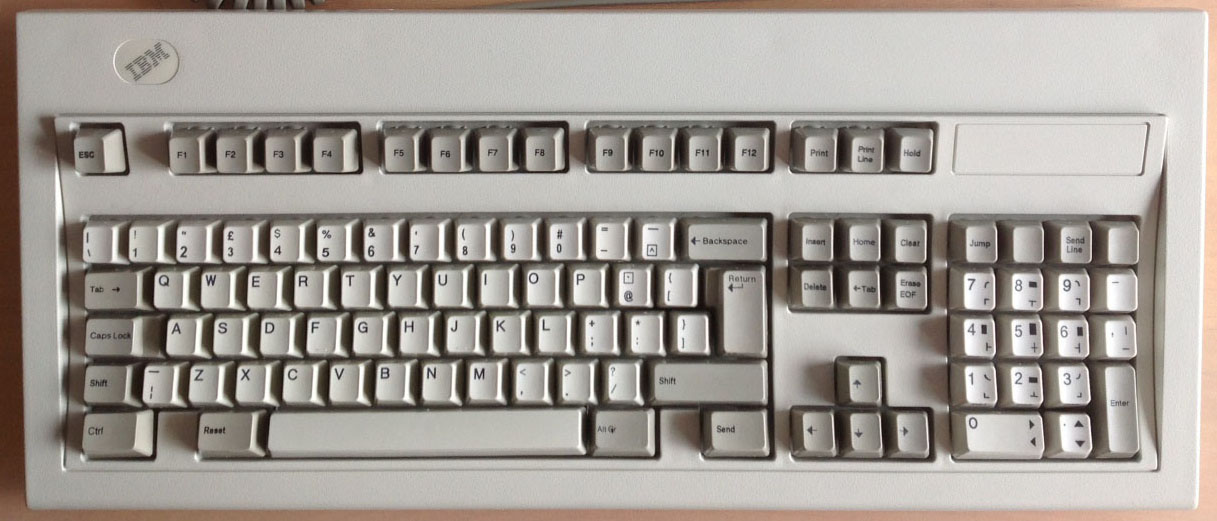

I've run into a bit of a puzzle trying to identify this Model M:Image
It was advertised as a 42H1292, but I thought that model always had the IBM logo in the top left in an oval. Wikipedia says that the only model with a logo under the lock lights is the 1393669, and that has a Yugoslav layout. So I'm pretty puzzled as to what this keyboard really is. It's definitely PS/2 with six pins and the date of manufacture was listed at 02-08-01. I haven't got a picture of the back label, but I've asked for one from the seller.

It is a Unicomp-manufactured Model M keyboard. It is indeed a 42H1292 in essence, as are all other Unicomp Classic keyboards that followed. I believe they still made keyboards for IBM for a brief time after the company's inception. They still use that same case mold too.

So not every 42H1292 has the usual oval logo in the upper left corner?
I just thought this one was peculiar, since I've never seen the IBM logo inside the lock light panel. Usually you'd find the Unicomp logo there in later models.

It is pretty unusual, I've only really seen this particular case on Unicomp keyboards.

emdude is correct. This is a 42H1292 bottom half, with an OEM-prepped top half wearing IBM branding. Remember that IBM, Unicomp, and Maxiswitch did ODMing of the M's for a variety of companies. Note the rectangular cutout top left. That's for the OEM badge.
This keyboard was likely assembled toward the end of a run without enough top covers, or as a replacement part for IBM to make good on a service contract. So it's mechanically and electrically identical (it has to be, per contract) but visually distinct. This is a pretty uncommon find to say the least - I've never seen one with the IBM logo window that also had the Unicomp 'graphic' legends.

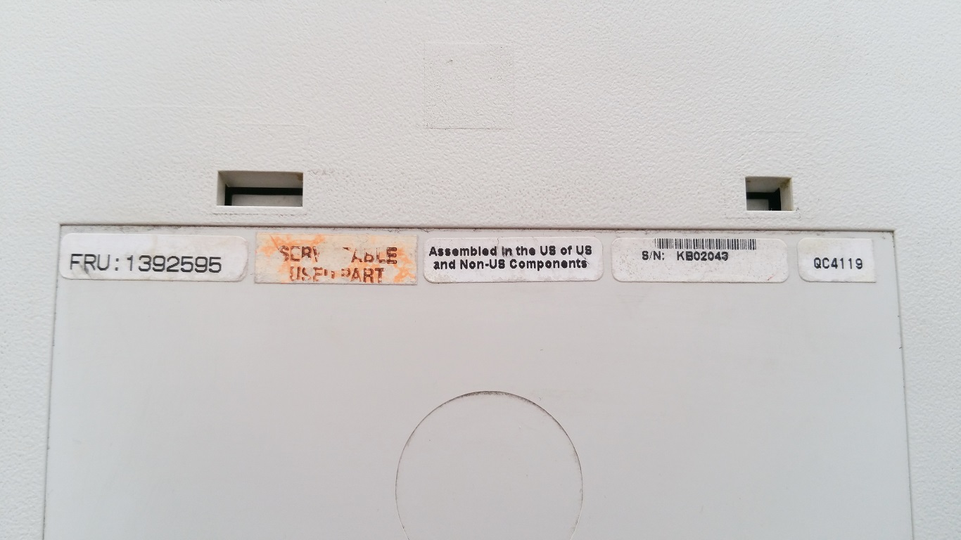

Is the unusual case of this board enough to make it particularly valuable, or is it just an odd duck? I also managed to get a shot of the underside from the seller:

Er, Unicomp made a very large chunk of M's and had the original tooling because for certain contracts, IBM was required to do significant parts of the manufacturing in the US. Almost exclusively GSA stuff. So they couldn't just grab a stack of boards made in the UK or Mexico. It's no different from an IBM "made by Lexmark" since Unicomp was Lexmark.
If you look at the label it specifically declares "Assembled in the US" - which tells me this was absolutely a GSA customer board. It does not tell me if it was a service rebuild (e.g. 1992 internals and a new Unicomp made case) or if it's all new. It definitely was manufactured as a service replacement part for contract obligations. Based on the PN (42H1292) it's a "generic service part." I've seen a variety of windows used on these. For example:
So, ultimately, it's no more or less valuable than any other Model M. Being built by Unicomp really has no bearing on it. It certainly could be worth more to a collector with an eye toward oddities, but that's a question of the individual and the market. It also could be worth more to a user, due to the younger age. If someone's after a birthday board, it could be worth more to them. Values on boards like these are highly subjective.

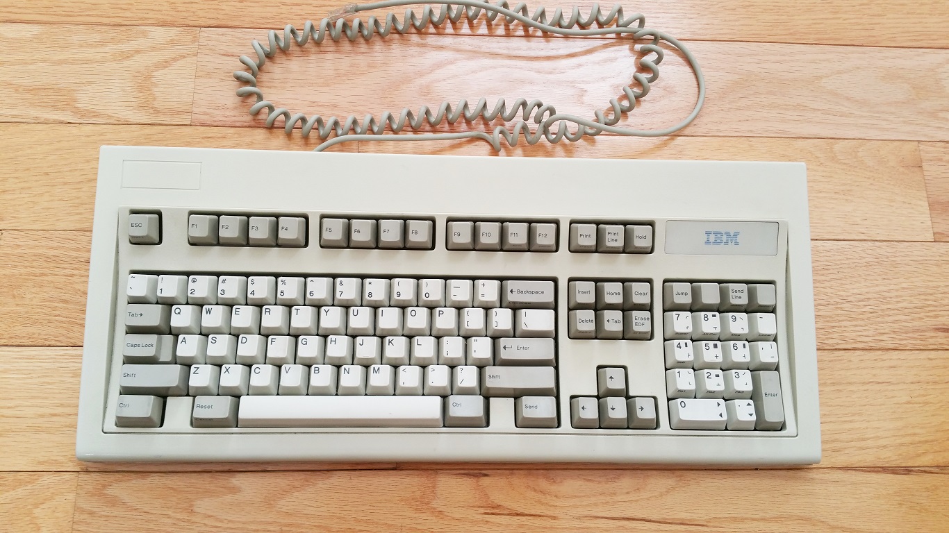

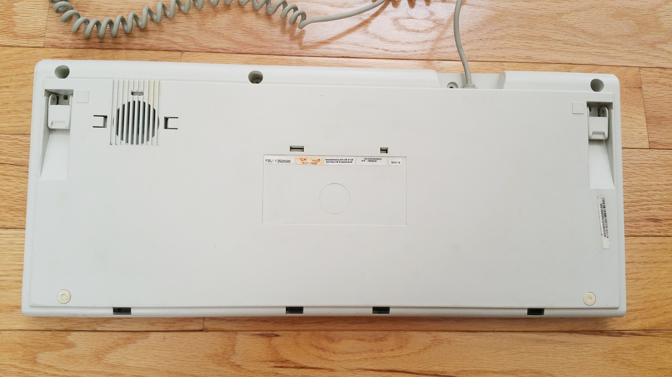

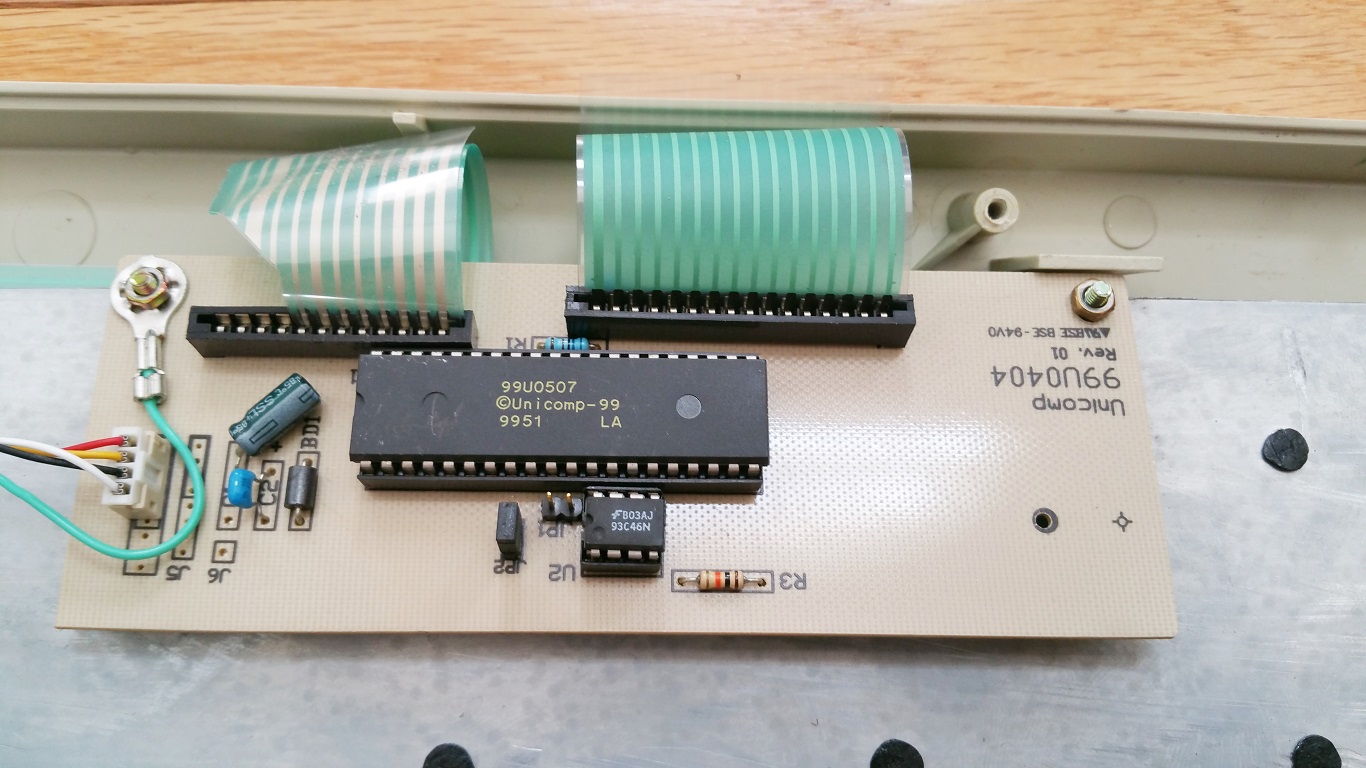

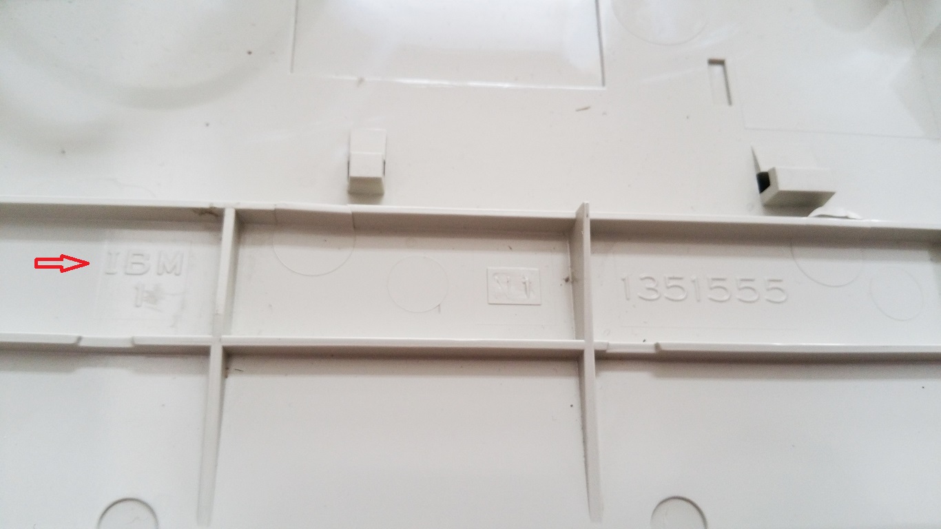

Similar to the OP, I have a terminal board with an IBM model number of 1392595 but it's a later Unicomp terminal keyboard. Pics are below. It has an IBM bottom (as the plastic mold marks indicate) but the top is definitely a Unicomp or Lexmark creation. There are no mold marks that indicate a maker. The keyboard controller, however, is all Unicomp. Nice buckling spring keyboard just the same. The legends are laser sharp on this which I thought was not supposed to be the case?
Aristo, it's still a nice board even though the "Model M purists" will complain ;)

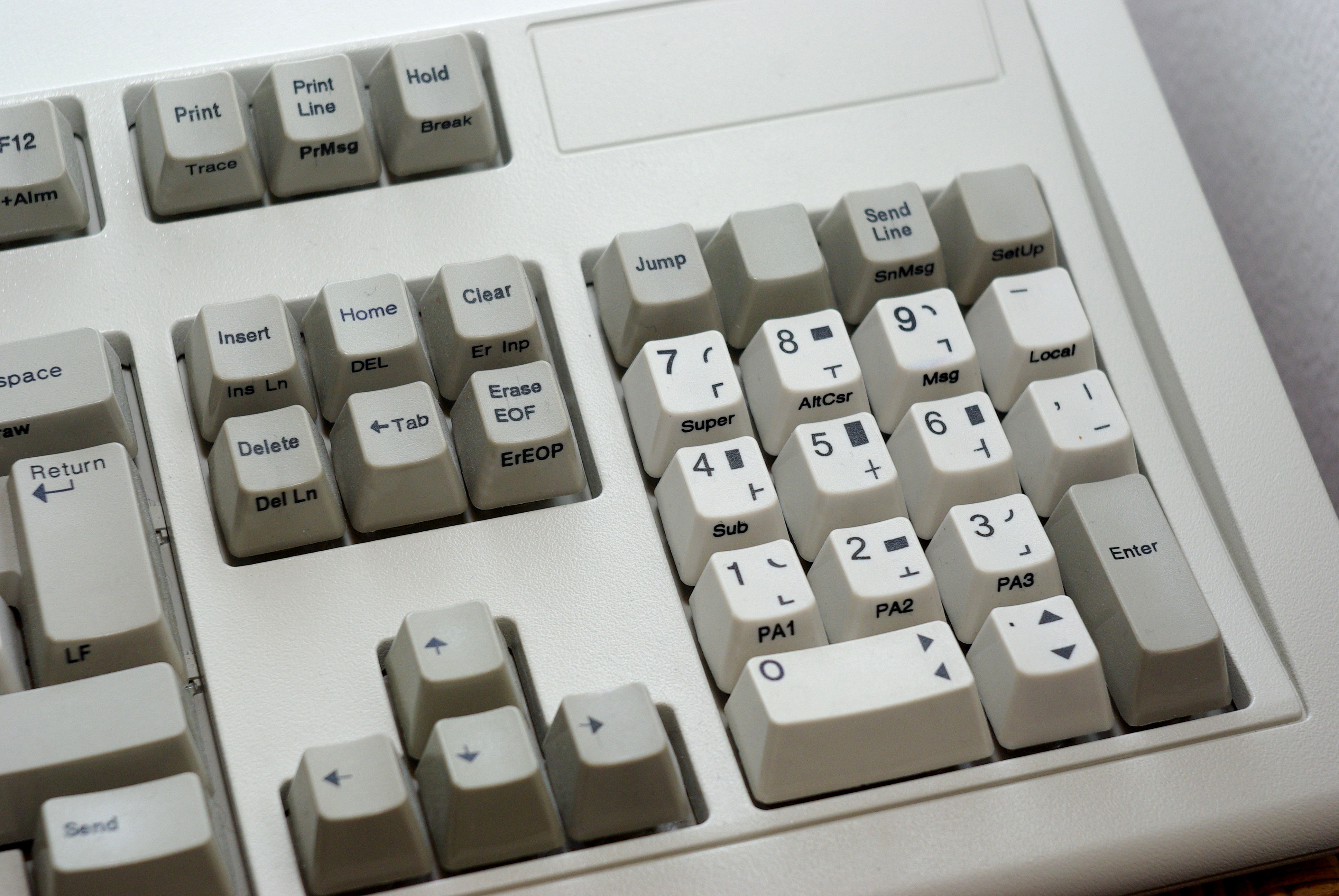

29 Jun 2016, 00:06

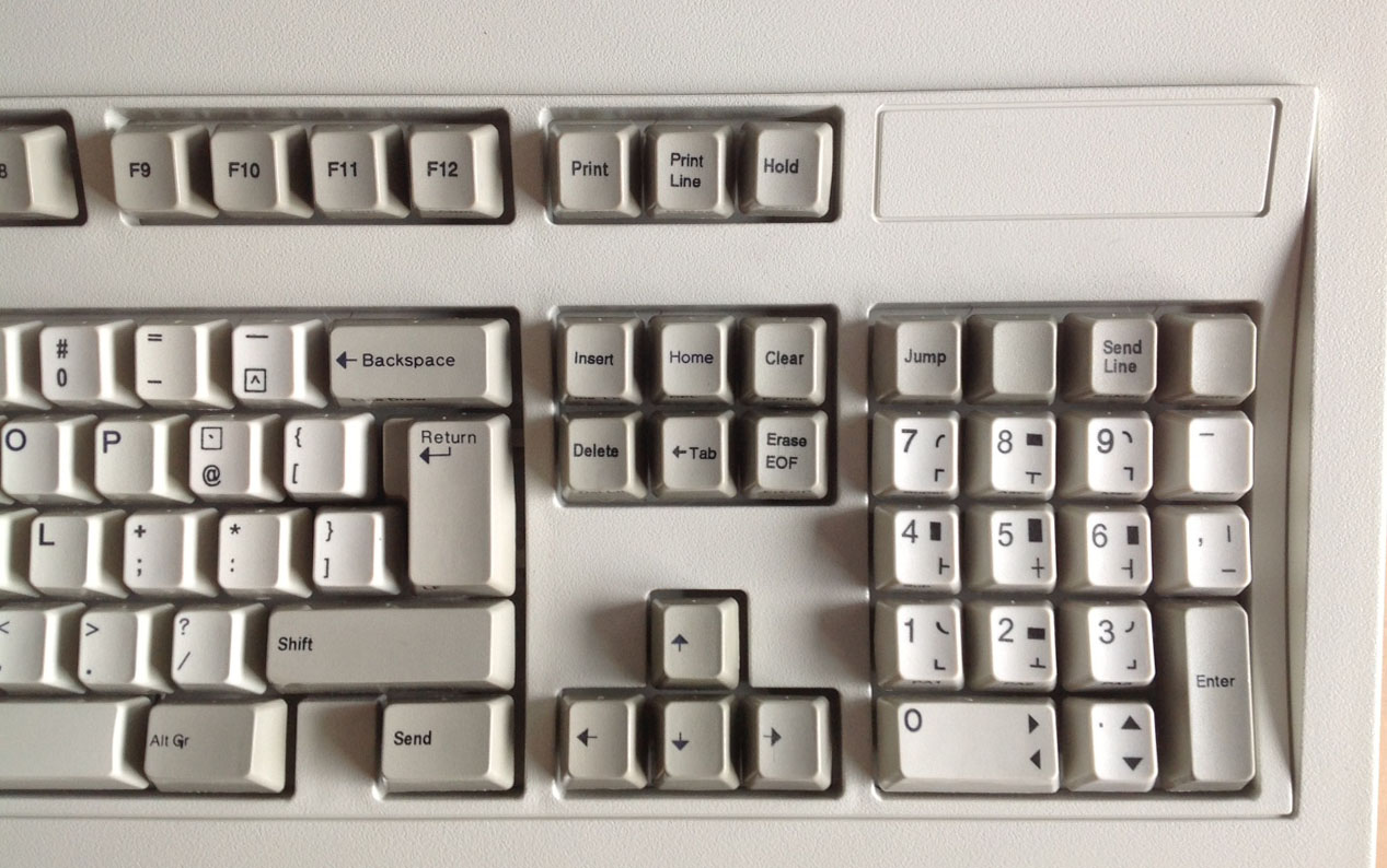

Very interesting that yours has those same graphic legends on the num-pad like this 1395764 of mine, can you tell me anything about those legends snuci?
photo 1-2.JPG (135.86 KiB) Viewed 4046 times
photo 2-1.JPG (208.56 KiB) Viewed 4046 times

snuci wrote: Similar to the OP, I have a terminal board with an IBM model number of 1392595 but it's a later Unicomp terminal keyboard. Pics are below. It has an IBM bottom (as the plastic mold marks indicate) but the top is definitely a Unicomp or Lexmark creation. There are no mold marks that indicate a maker. The keyboard controller, however, is all Unicomp. Nice buckling spring keyboard just the same. The legends are laser sharp on this which I thought was not supposed to be the case?
The mold marks you are referring to, are they on the interior of the case?
I am curious about how you can tell; I never paid much attention myself to the mold marks, but I recall seeing IBM branding on the interiors of the cases of various Model Ms I have worked with. That said, I have only worked with IBM-manufactured Model Ms for the most part.

seebart wrote: Very interesting that yours has those same graphic legends on the num-pad like this 1395764 of mine, can you tell me anything about those legends snuci?
From what I've seen, this is the keyboard from an IBM 3151 serial terminal. Since yours is from Europe, yours may be from an IBM 3152 terminal (these were released in Europe according to the IBM 3101 Wikipedia page. There are a couple of threads on the IBM 1392595 keyboard here as well.
29 Jun 2016, 00:44
Hmm cool thanks. I got it as a christmas gift, it's in very good condition. There are so many different Model M's out there I guess.

emdude wrote: The mold marks you are referring to, are they on the interior of the case?
Yes. I have a picture below of this keyboard. This, of course, could be old stock from Lexmark or they may have decided that there was no need to change the original IBM bottom case mold so they were still using it to create new parts at the time in late 1999.
Unicomp 1392595 - bottom case mold marks
Unicomp 1392595 - bottom case mold marks.jpg (174.44 KiB) Viewed 4012 times
emdude
Model M Apologist
29 Jun 2016, 00:52
Thanks for the photo; that's the branding that I recall.
I wonder if one would be able to find that on a modern Unicomp Classic. If I remember correctly, Unicomp still uses the original tooling for the case molds. I don't know if they use the same molds for the bottom half of the case though.
