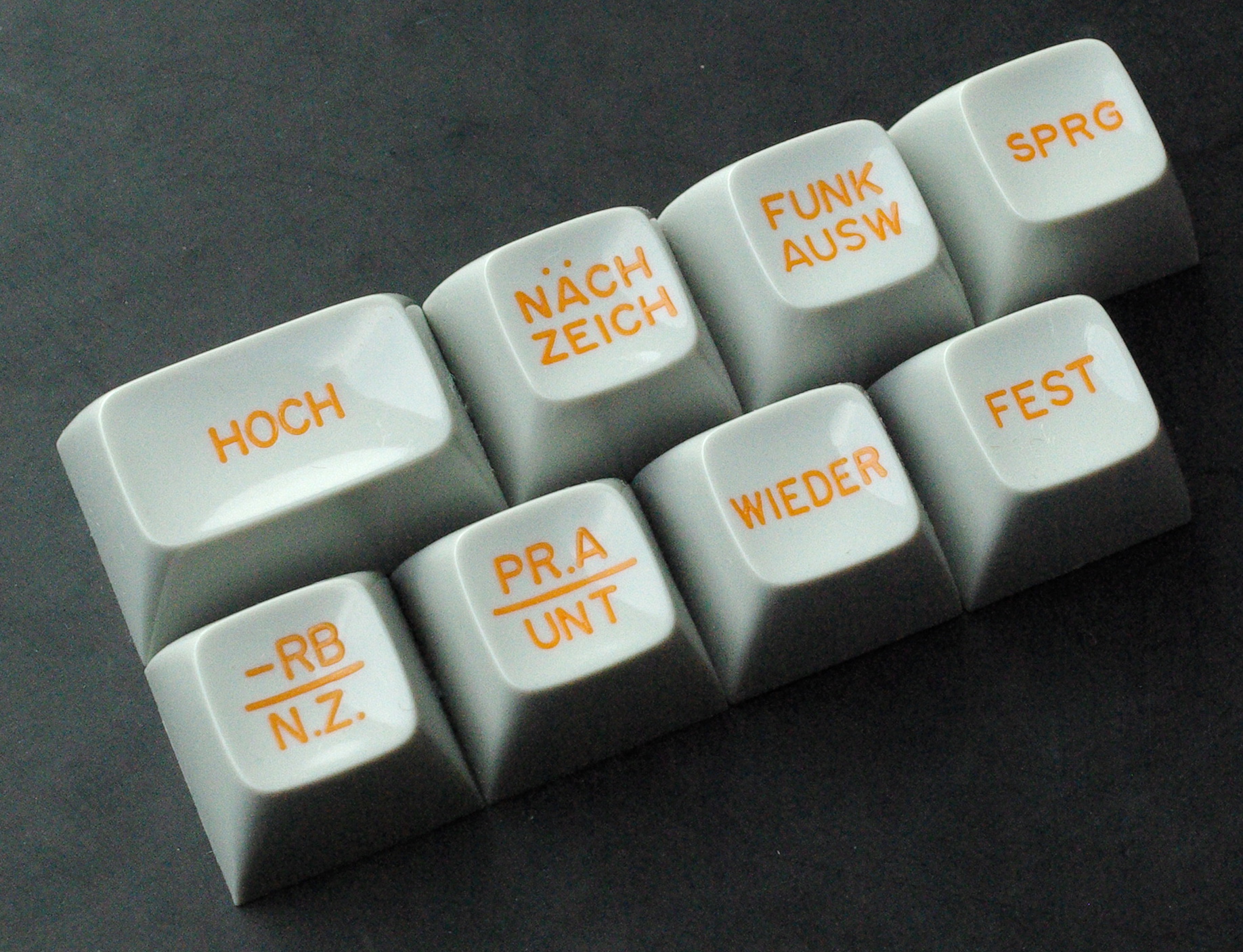

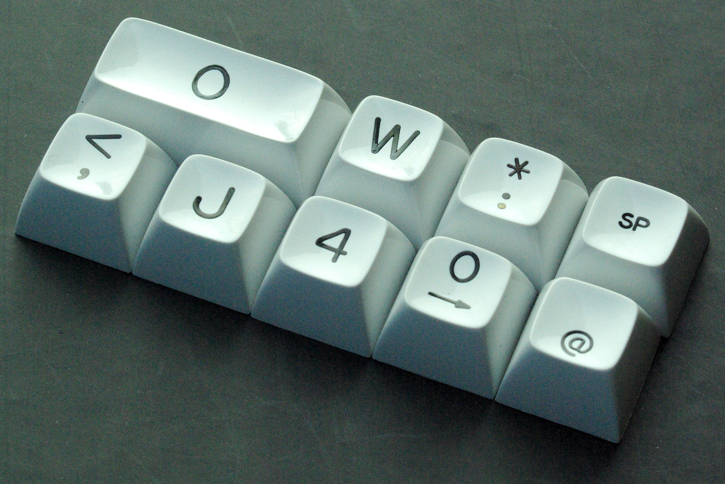

Calling it "shine" is slightly misleading since we also have the shine on keycaps we don't want. I call it gloss. Yes andypeters vintage sphericals often were manufactured that way in the 1970s and 1980s by many companies. We have many examples here, and yes there are modern keycap sets that copy this look. These are Micro Switch (Honeywell) spherical glossy double shots for example:
keyboards-f2/micro-switch-custom-t11720 ... o%20switch

Those are so beautiful they make me weep.
13 Sep 2016, 19:28

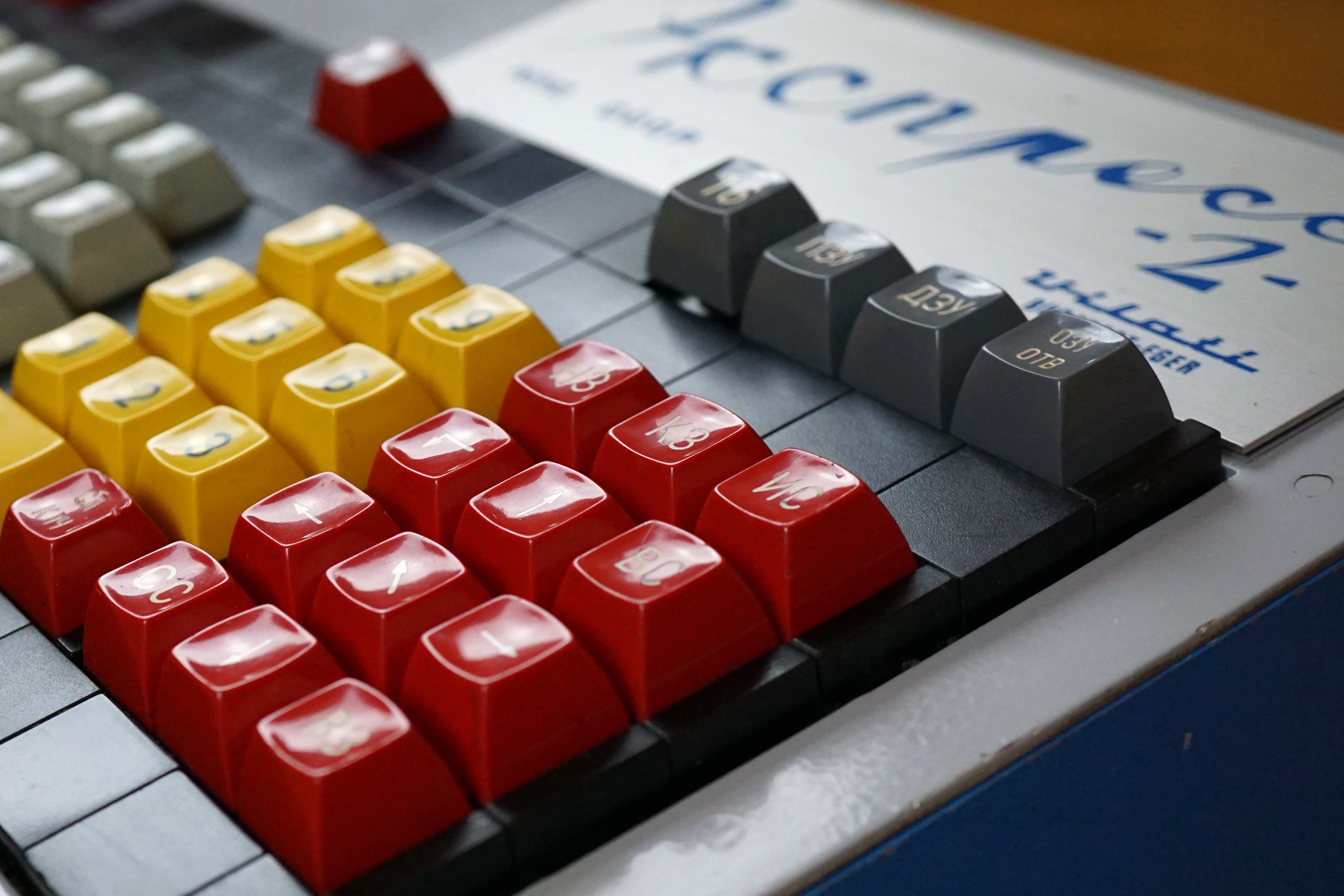

Well they are just about the nicest sphericals I own. And yes IBM never had really beautiful ones like this even on the Beamsprings although those come close but minus the colors with few exceptions. Here is another nice example of gloss on vinatge sphericals woith HaaTa's CCCP Express 2:
https://www.flickr.com/photos/triplehaa ... 0456/page1
