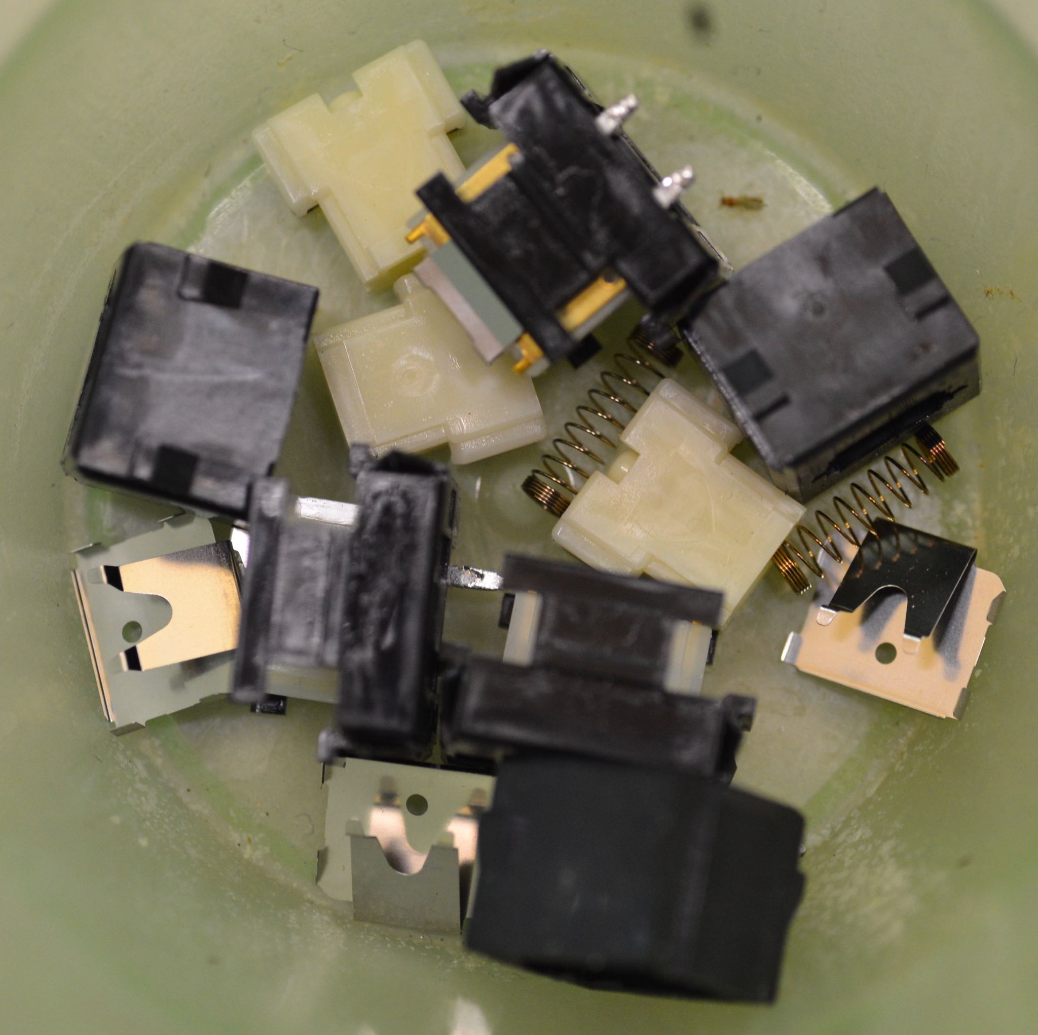

Here is a photo of the disassembled switches:
Switches disassembled. Switch plates remain in lower housing. Upper housing, click leaf, slider, and spring are separate.

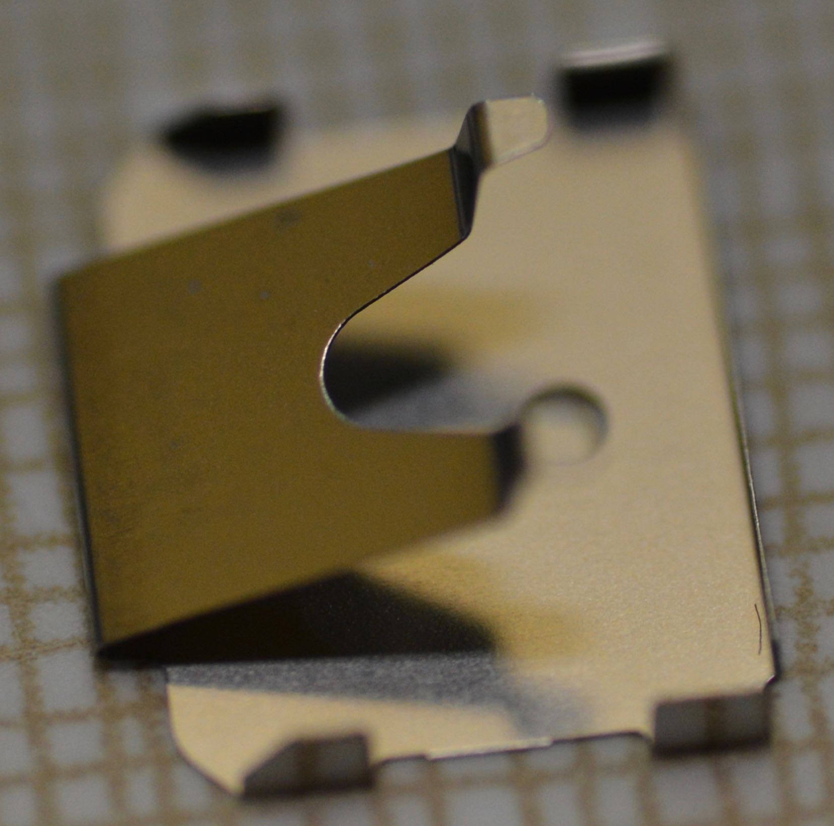

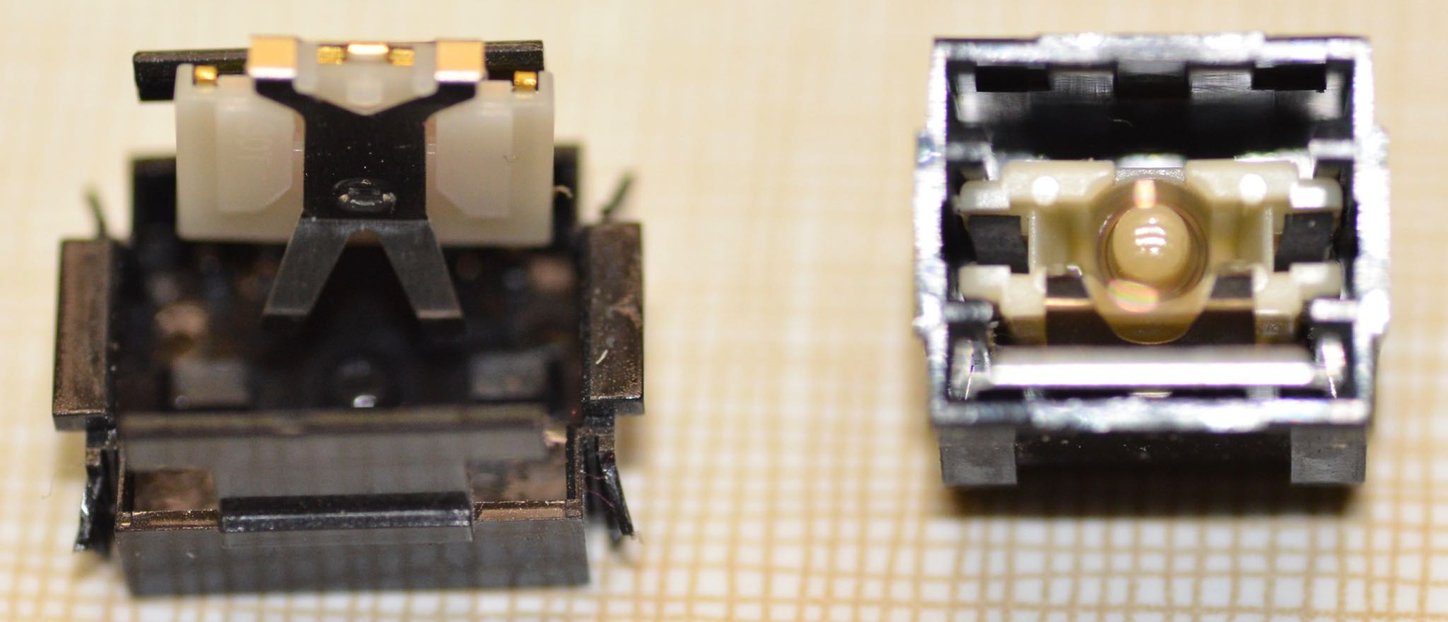

Here are detail photos of the click leaf and the switch plate post cleaning showing no visible damage.
Tactile leaf detail post cleaning.
Switch plate detail post cleaning.

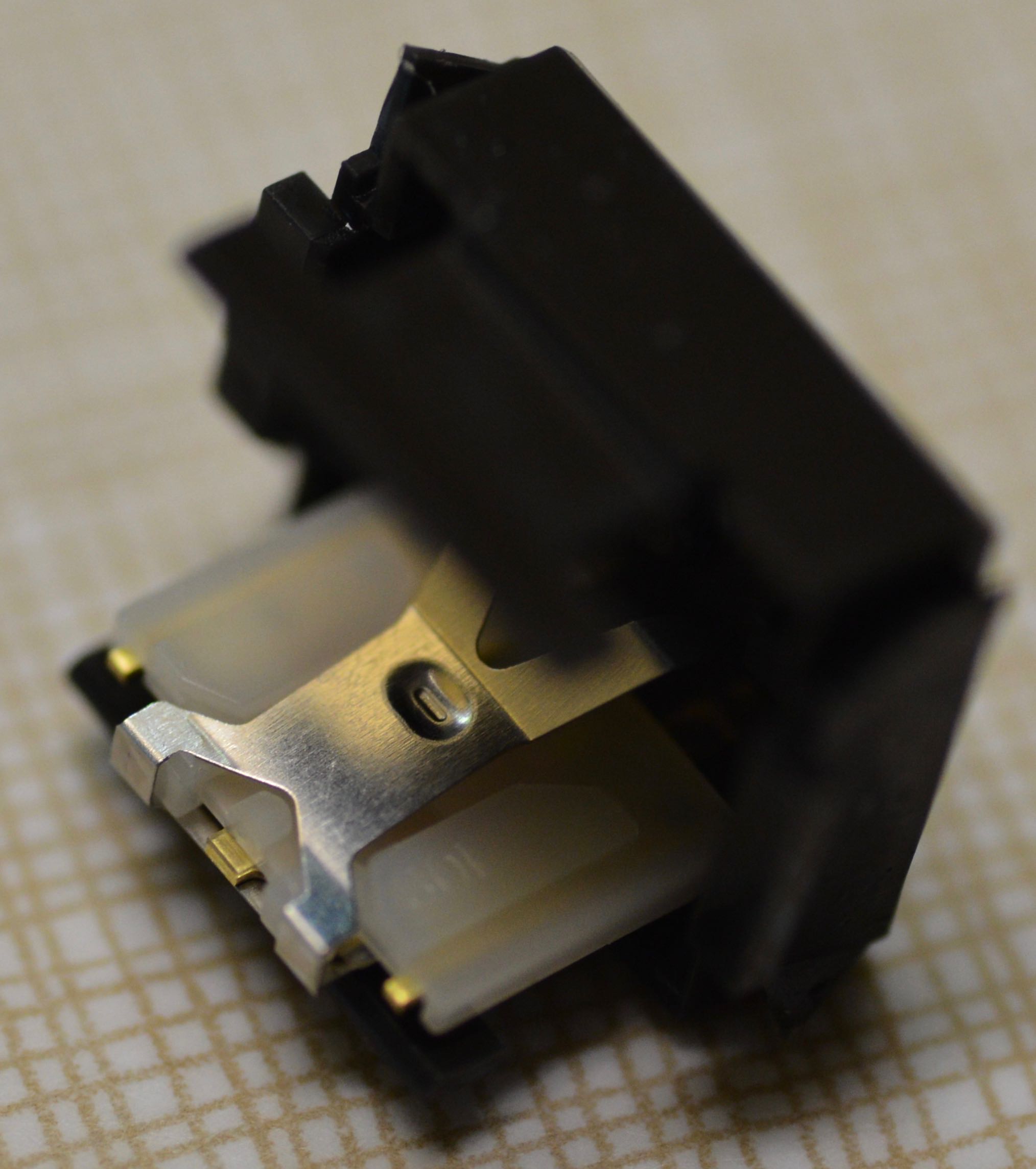

Here is a photo of the switch about to go back together.
Assembly post sonication.
The switch feels brand new. I cannot detect really any grittiness or hesitation. Some switches still hesitate a tiny bit in response to aggressive off center key presses. There is a small chance that enough abrasion over time roughens the plastics themselves.
