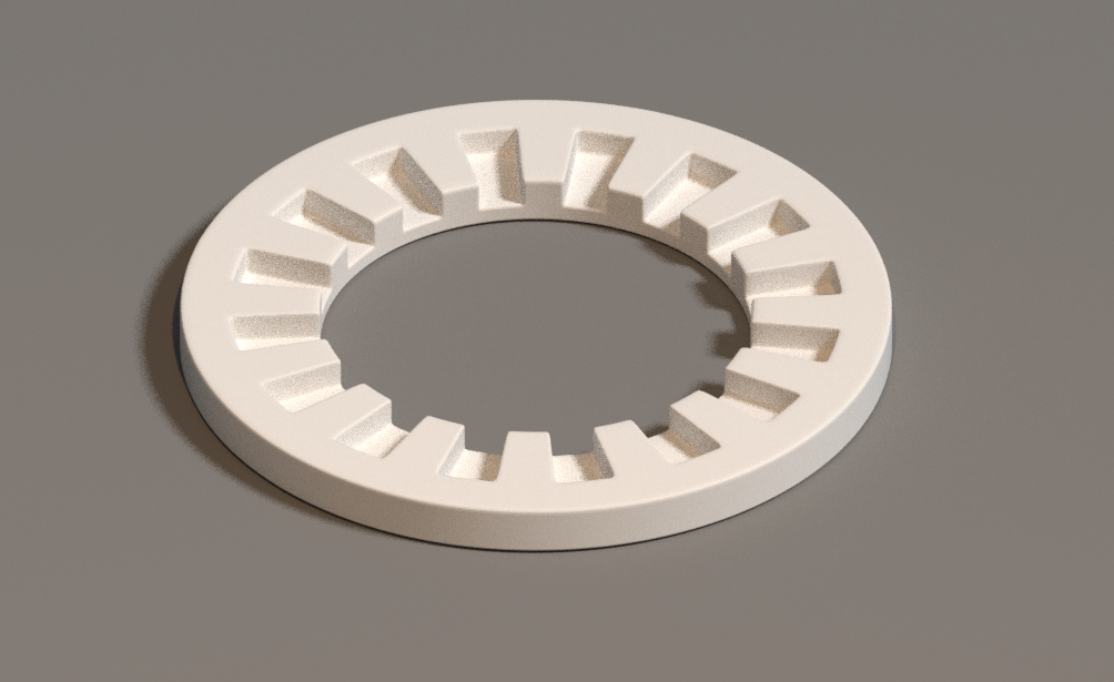

- Try giving it a go with a direct filament drive machine if you can. Ultimaker does pretty good Ninjaflex for a bowden machine, but results from a bowden vs a direct drive are night and day. I was printing a lot of NF with flashforges and old makerbots, they have pretty short distances between the drive and the heater, and the results were much better. Though I have to admit Ultimaker does a great job with NF for a bowden.

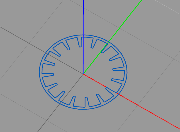

- Giving the washers some sort of structure may damp better. NF is hard, even in the soft variety. My suggestion is as follows (maybe with less incisions...):
You may want to design it so that the radial incisions slice/print like this: (screenshot from the appropriate layer)
They should slice to a continuous line, if Cura prints it at a constant speed, they should come out OK. Takes some fiddling with dimensions to get it right, but it's doable.
You could probably fit that within 0.5mm, with 2x0.1 layer for the bottom plate, and 3x0.1 for the incisions.
NF is damn hard to tear, so it should work out OK. Don't overtension it while pulling it off the bed though, it likes to distort and lose flexibility. It sticks well to ANYTHING, and does so PERMANENTLY, so I was using dissolved PVA or PVA-based glue on the bed. Heating the bed up a bit softens pva, and you can pull off the NF without damaging stuff, then wash away the glue, it should peel off.
- Finally, there are ShoreOO-grade silicones (like Ecoflex 00-10A from Smooth-On), they have similar hardness to sorbothane. You can print a 10x10 mold with ABS or PLA and just pour it, you'll get a better product for a lower price and shorter turnover :) AFAIR these are platinum cured silicones, so get printer material specs - it mustn't contain sulfur.
