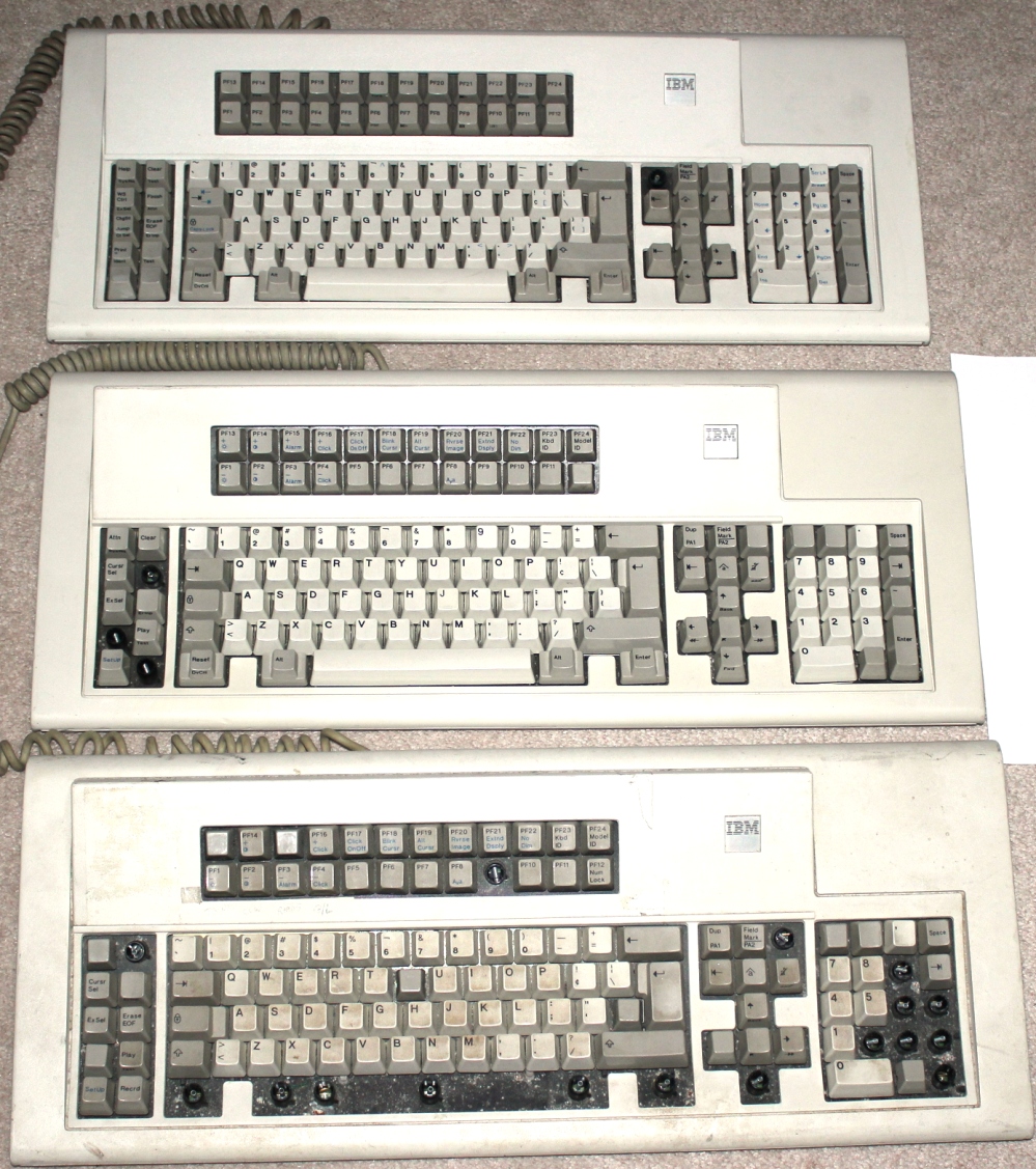

3 Keyboards in progress
elecplus
18 Sep 2016, 16:52
Not finished yet, but we are getting there.
18 Sep 2016, 17:19
OK, I'll bite:
What is "finished" in this project?
elecplus
18 Sep 2016, 17:34
All the correct caps + tested + cleaned :-) I just finished the caps for the top board. And I can complete the 2nd board. The 3rd board will be somewhat problematic, since the blue legends are special. We do take them apart and clean them as much as possible, but I don't go as far as sanding, repainting, etc.
I did some research, and it seems the reason they put the blue legends is they were meant to also be used on a PC. When used on a PC, the controller will do what is printed in blue when that key is pressed, without any special programming.

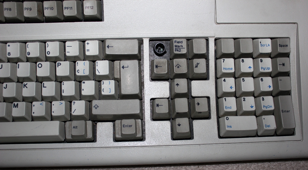

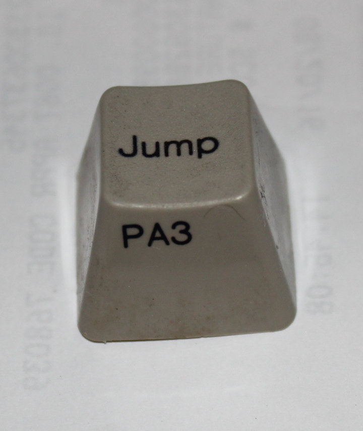

So another list member and I are having a discussion. All of the pics I can find online for the 6110344 and 6110345 do NOT have a PA3 or a NumLock key. Does anyone have pics of original boards so I can see what the caps are supposed to look like? There does exist a Jump cap with PA3 on the front, but I don't think it goes to these boards?
Parak
18 Sep 2016, 19:59
I was not immediately aware of this, but apparently the blue legended 6110344s came in two types, with white numlock/scrolllock/esc and gray ones. Weird. I have the white ones, and I suspect they're from an earlier batch of these boards - mine is one of the first 20k made as per the serial number.

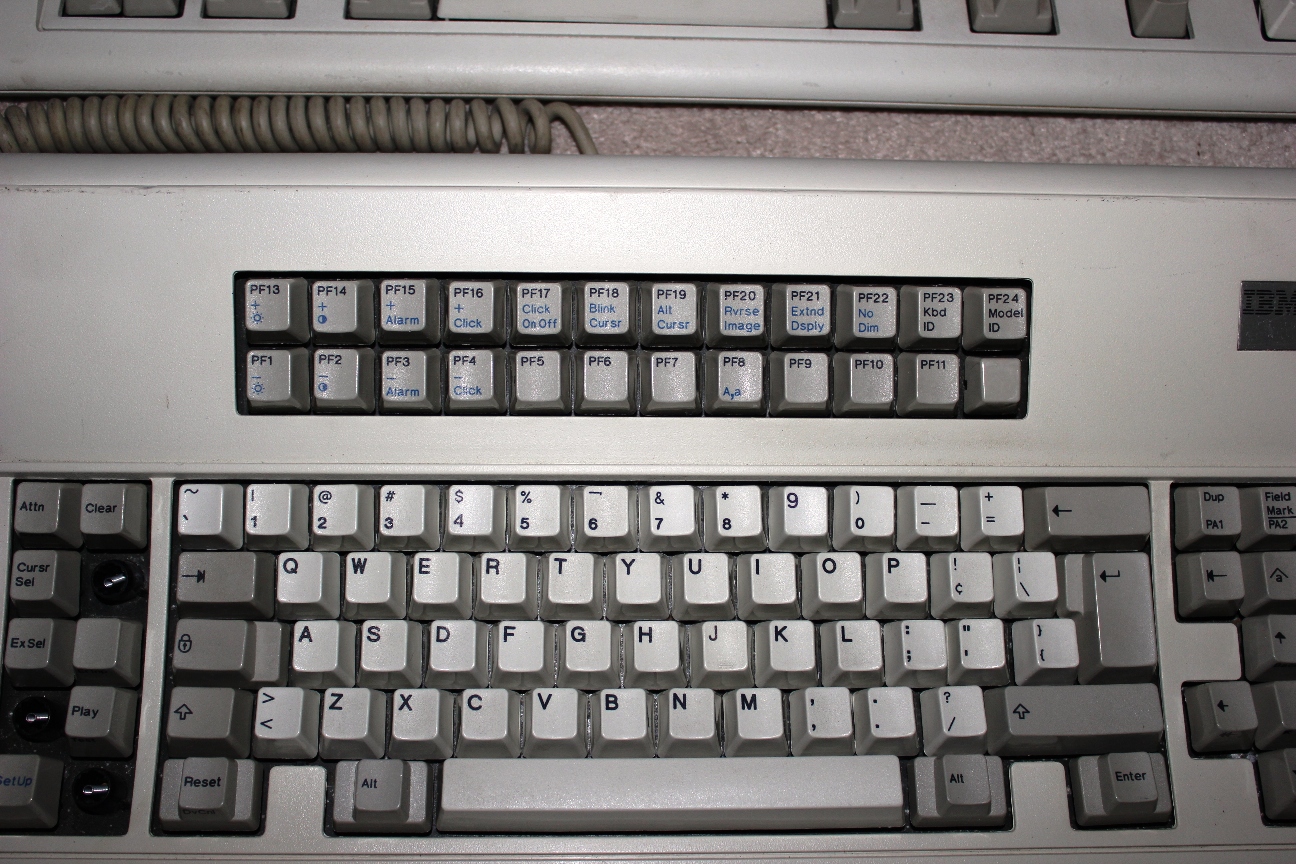

@Cindy, this is the layout of the 6110344 that I received today.
And here's the model sticker.
alh84001
v.001
24 Sep 2016, 10:57
Always nice to see. I just noticed that "Help" and "Clear" keycaps are in wrong positions, you should switch them around :)
And to rain a bit on your parade, the shift keycap is (probably) not OG. It should have no text, and being an ISO layout, it should probably be a short shift, and <> keycap should be in the right barrel. Those shouldn't be hard to source though, unlike some other keys ;)
