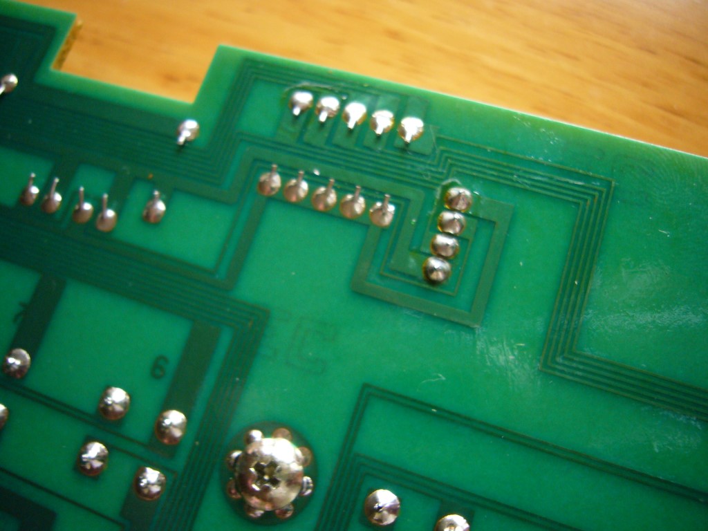

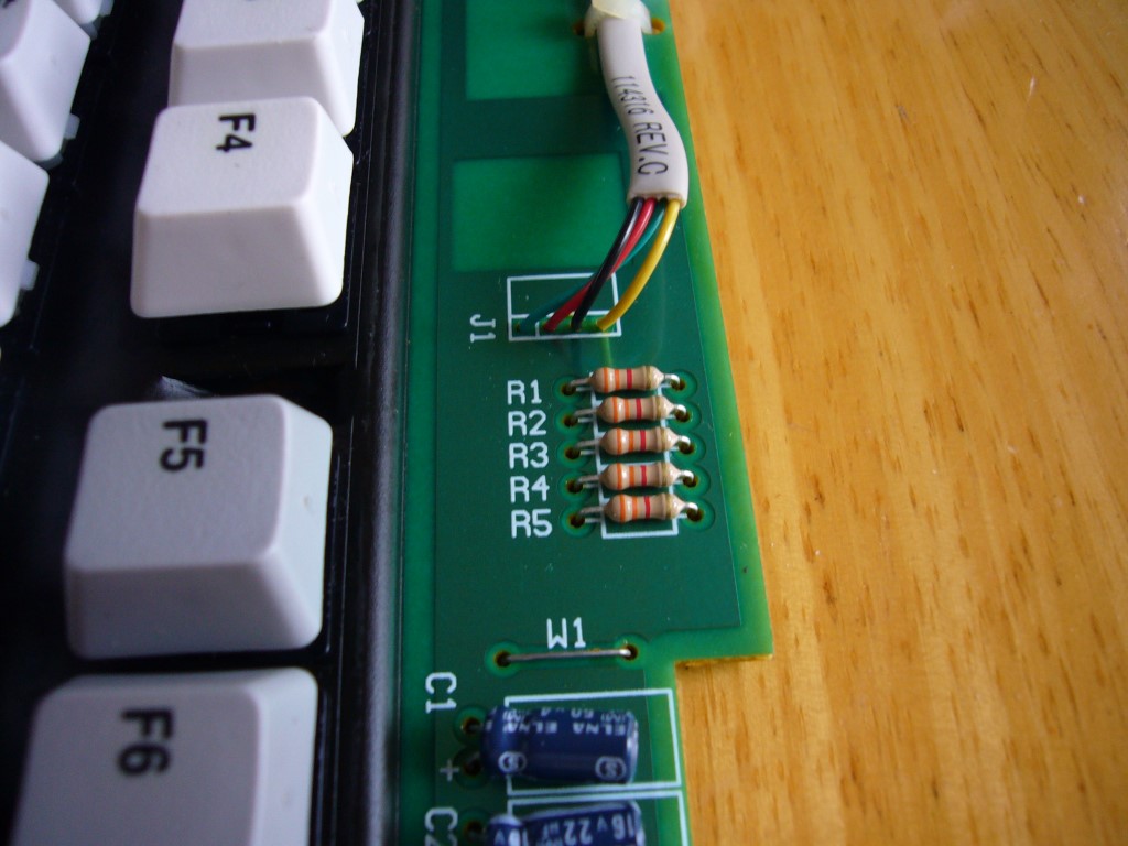

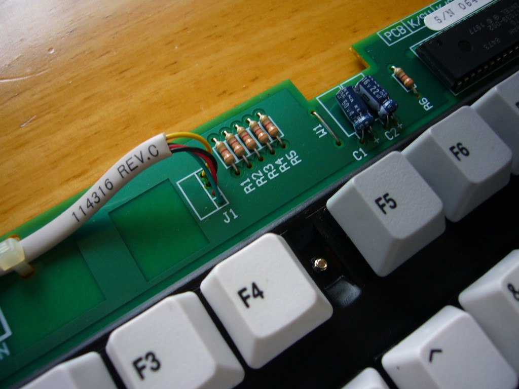

29 Sep 2016, 15:14
Mine was Televideo branded and it did not look like that one, either.
There were a few available NIB and one of the more knowledgeable Geehkhackers on the West Coast (I can't remember who) notified a few of us, including Dorkvader, who is usually pretty good with these things.
But nobody has ever figured out how to get one of these working, as far as I know.
televideo-NMB-inside (1) (Medium).JPG (146.57 KiB) Viewed 2297 times
televideo-NMB-inside (2) (Medium).JPG (140.75 KiB) Viewed 2297 times
televideo-NMB-inside (3) (Medium).JPG (140.25 KiB) Viewed 2297 times
