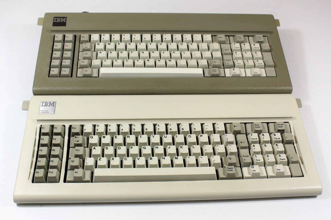

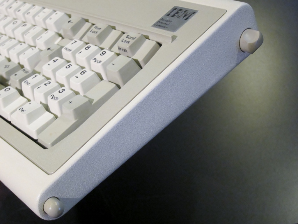

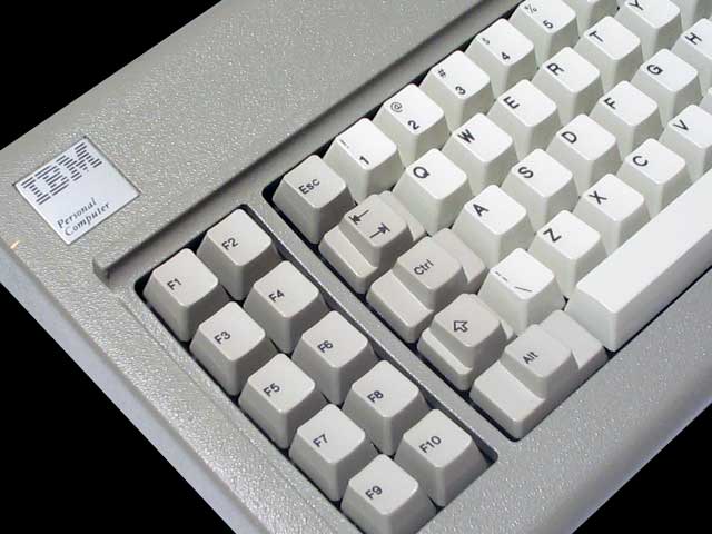

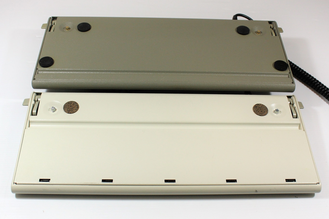

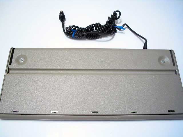

Below are pictures of the comparison and answers the question... Can an XT Model F keyboard mechanism fit in an Industrial XT case?
Industrial XT front (top) Normal XT front (bottom)
XT Normal vs Industrial 1.JPG (341.39 KiB) Viewed 10523 times

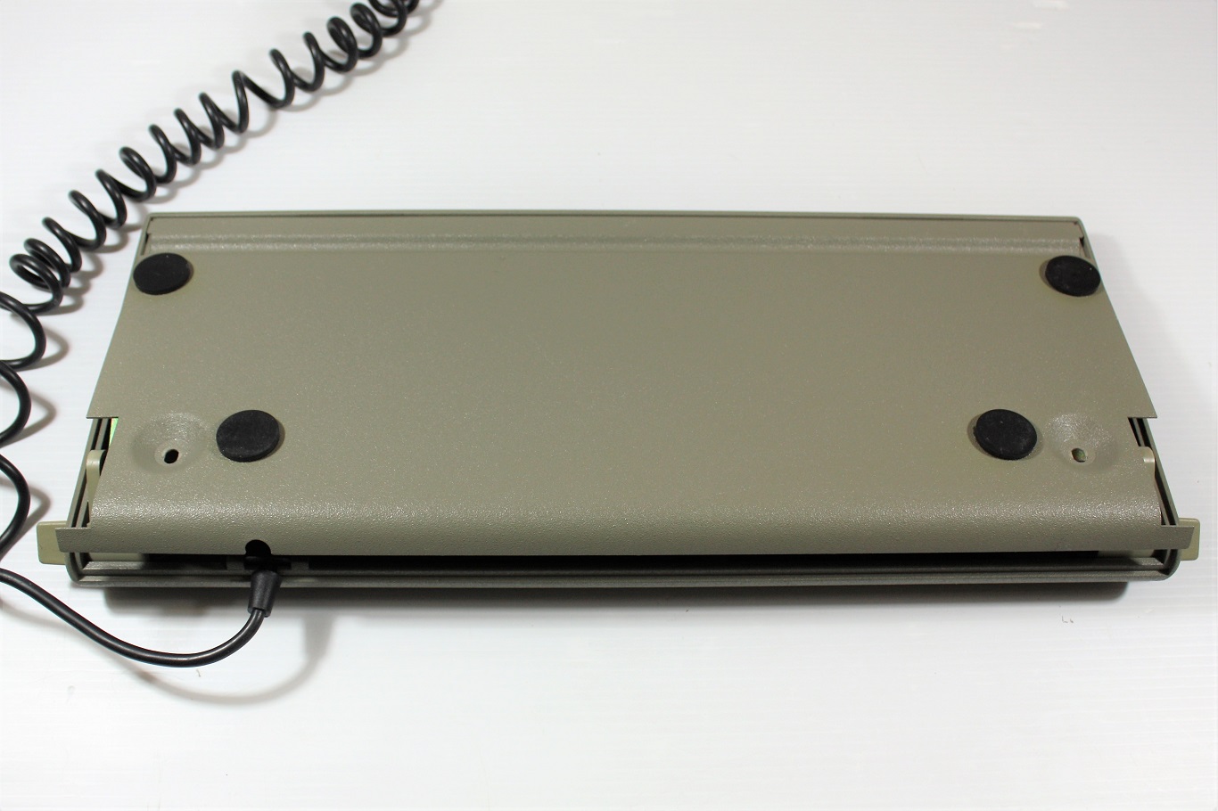

Industrial XT back (top) Normal XT back (bottom)
XT Normal vs Industrial 2.JPG (241.21 KiB) Viewed 10523 times

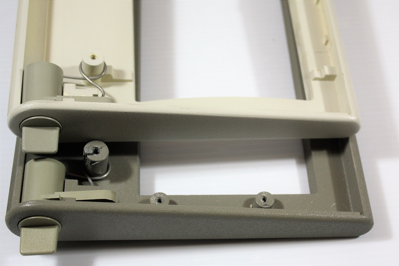

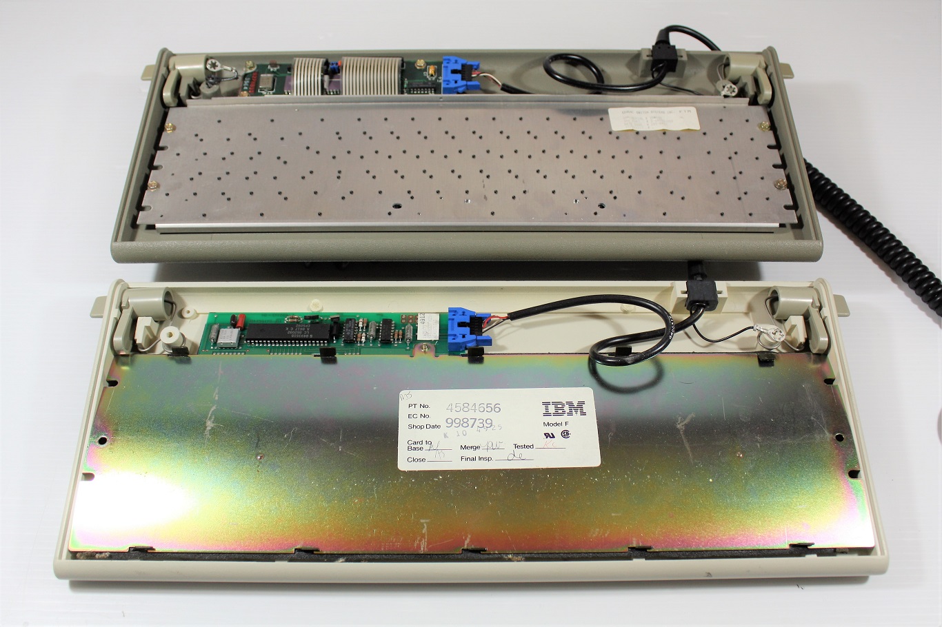

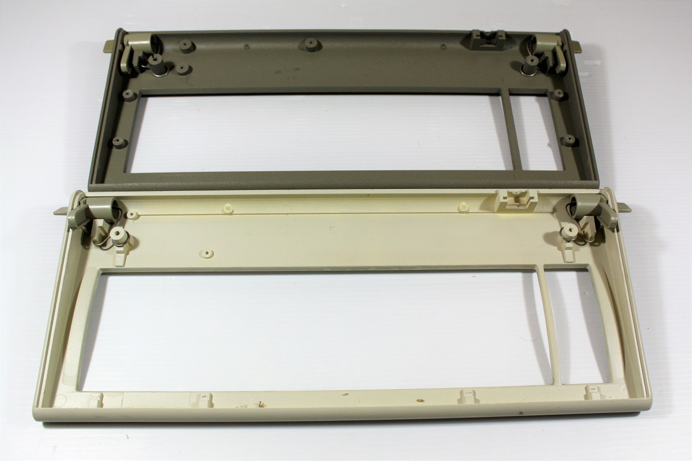

Industrial XT case opened
XT Normal vs Industrial 3.JPG (354.78 KiB) Viewed 10523 times

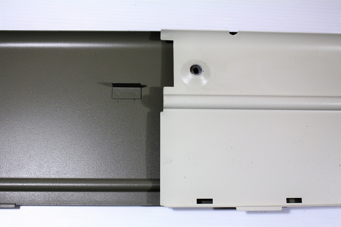

Inside top case.  Let's just say army grey is always the Industrial XT...
XT Normal vs Industrial 4.JPG (256.28 KiB) Viewed 10523 times

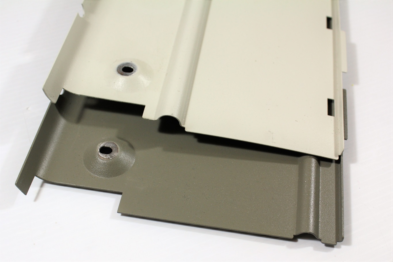

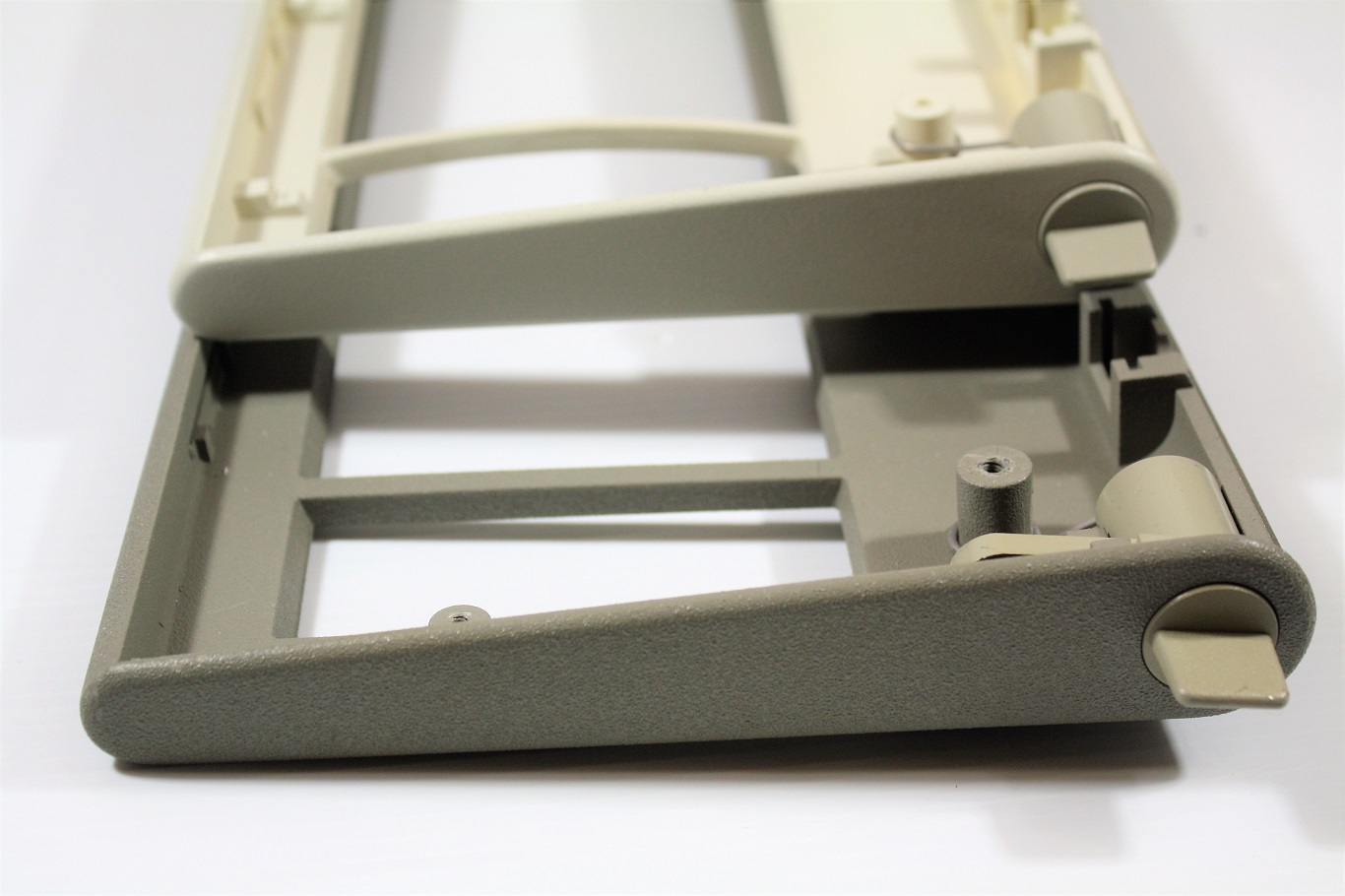

Normal XT case top has curved top brace that matches the curved Model F plate. Industrial case top brace is flat that matches the flat Oak keyboard plate.
XT Normal vs Industrial 5.JPG (238.71 KiB) Viewed 10523 times

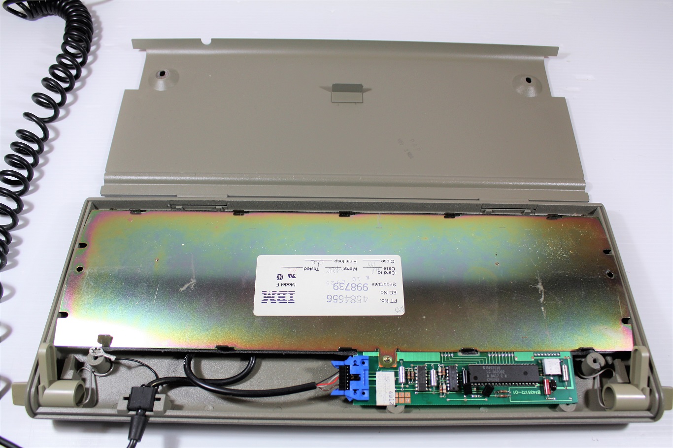

Top case on normal XT has curved sides to match the Model F plate.  Industrial XT is flat and has extra plate screw mounts.
XT Normal vs Industrial 6.JPG (271.12 KiB) Viewed 10523 times
IBM Model F keyboard mechanism in Industrial XT top case.  It fits.
XT Normal vs Industrial 7.JPG (269.35 KiB) Viewed 10523 times
Putting on the Industrial back case doesn't fit.
XT Normal vs Industrial 8.JPG (246.57 KiB) Viewed 10523 times
Industrial bottom case has a curved portion that stabilizes the keyboard mechanism from underside in the wrong place.
XT Normal vs Industrial 9.JPG (344.2 KiB) Viewed 10523 times
Normal XT back plate has the curved stabilizer in the right place so Industrial top and normal bottom work for the Model F keyboard mechanism... sort of.
XT Normal vs Industrial 10.JPG (308.5 KiB) Viewed 10523 times
Bottom plate with the curved portion that stabilizes the keyboard mechanism from the underside.
XT Normal vs Industrial 14.JPG (366.26 KiB) Viewed 10523 times

Looks pretty decent, right?  But... the model F mechanism is curved but the case is flat.  You might be able to live with that but the major problem is that the bottom row is too tight and won't depress and release properly.
XT Normal vs Industrial 11.JPG (336.56 KiB) Viewed 10523 times

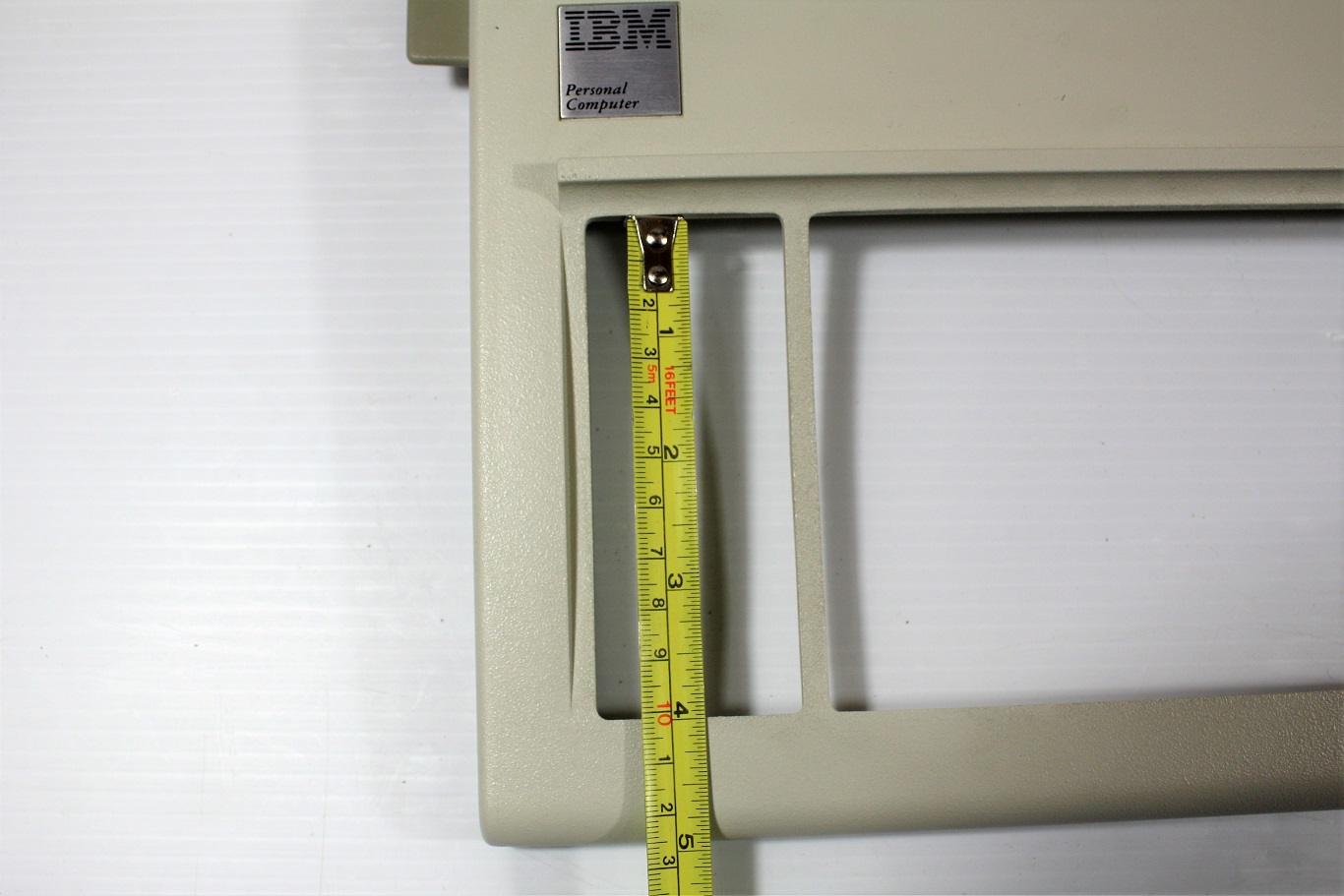

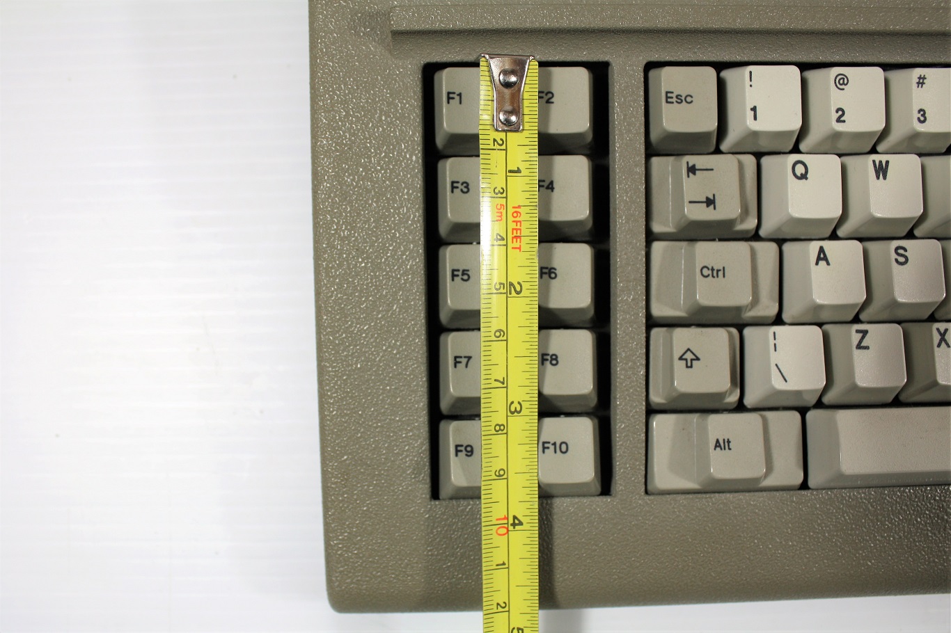

Measurements of the Industrial XT opening is about 3.75 inches or about 9.5 cm and makes the bottom row bind.
XT Normal vs Industrial 12.JPG (339.85 KiB) Viewed 10523 times
Measurements of the normal XT opening is about 4 inches or about 10 cm and allows the Model F keys to move freely.
XT Normal vs Industrial 13.JPG (251.88 KiB) Viewed 10523 times
So, bottom line. It will not fit "out of the box" without modifications and modifying it would not work too well, in my opinion. It was pretty close though.

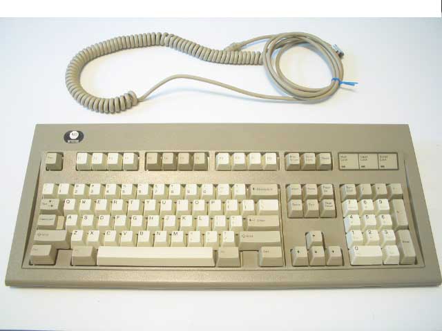

clickykeyboards
30 Nov 2016, 18:20

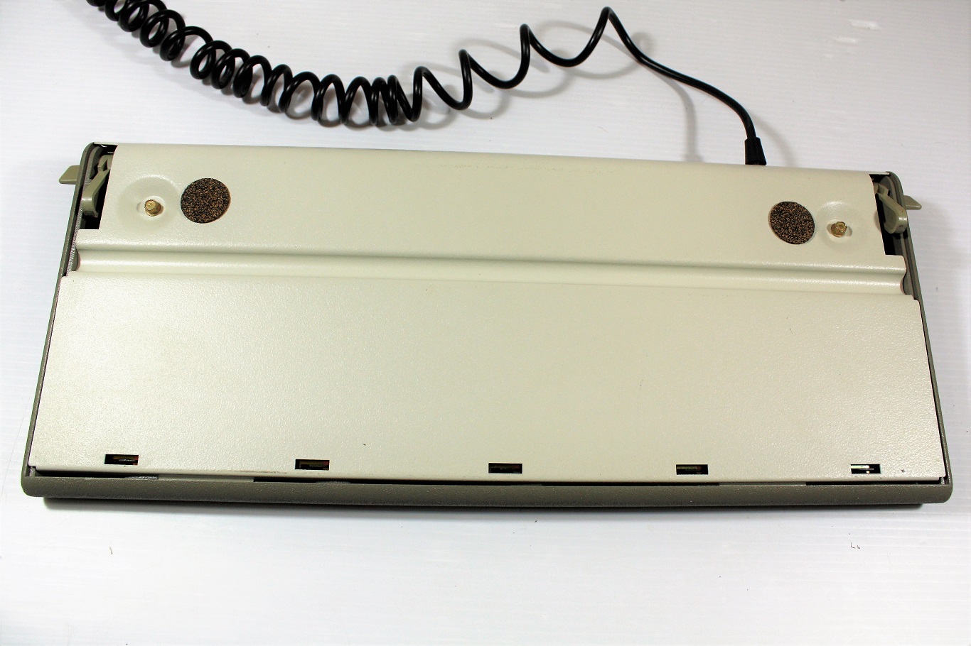

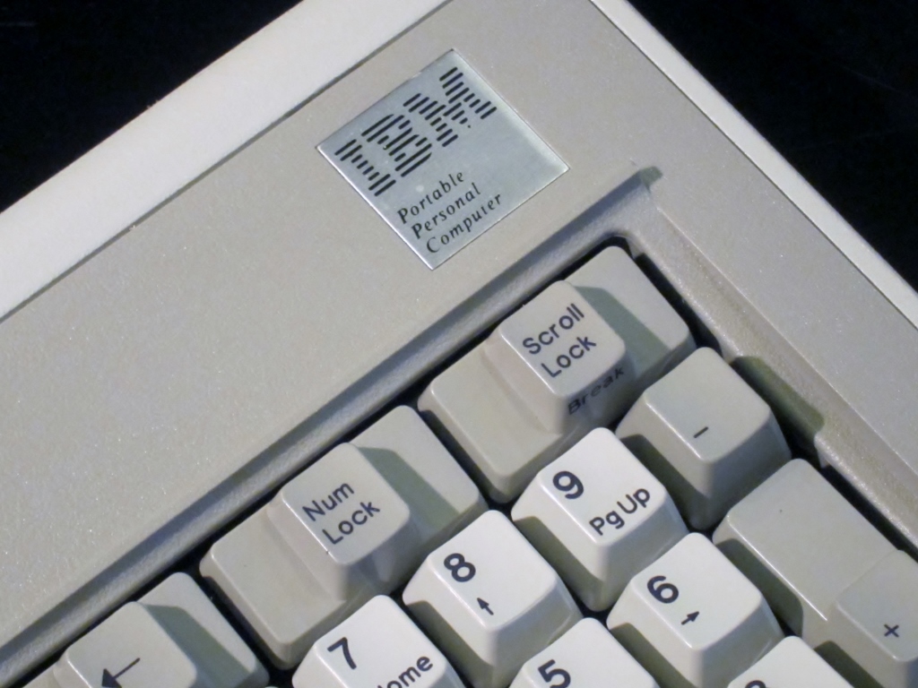

There are also the following
http://clickykeyboards.com/product/ibm- ... 83-key-xt/
http://clickykeyboards.com/product/ibm- ... -portable/
lot_lizard
30 Nov 2016, 18:29
clickykeyboards wrote: There are also the following
Sweet Baby Heysoos... @clicky, the XT is REAL? Not some aftermarket/post production move you think? I had seen this version of the portable (or pics somewhere) but had forgotten.
@Snucci... I hate to say this, but I think we are going to officially hijack your thread as the "IBM Industrial Keyboards" thread. Your first post was excellent, but... just a heads up (feel free to change the title at anytime :lol:)

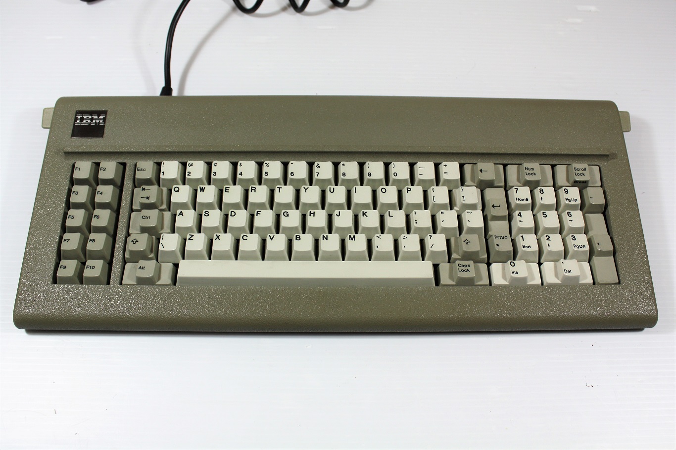

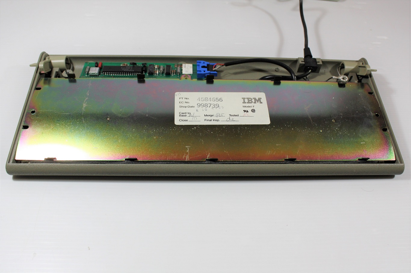

snuci
Vintage computer guy
30 Nov 2016, 18:43

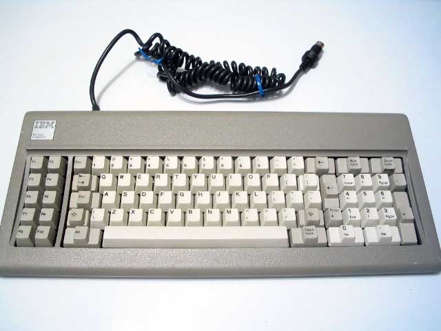

I hate to disagree with clickykeyboards but I don't think the top one is real. You can see a nick on the third picture on the left side and a scratch on the second picture that is lighter than the case colour. That indicates that it's painted and my version is not painted. You can see that from the crack in one of the screw mounts.[/quote]
lot_lizard wrote: @Snucci... I hate to say this, but I think we are going to officially hijack your thread as the "IBM Industrial Keyboards" thread. Your first post was excellent, but... just a heads up (feel free to change the title at anytime :lol:)
I would have but if I didn't have pics of a regular XT Model F here :)
clickykeyboards
30 Nov 2016, 19:30
Looking at the timestamp for the industrial XT, I took the photo 11 years ago (back in 2005)
http://www.clickykeyboard.com/2005/oct2 ... 05-011.jpg
http://www.clickykeyboard.com/2005/oct2 ... 05-012.jpg
http://www.clickykeyboard.com/2005/oct2 ... 05-013.jpg
http://www.clickykeyboard.com/2005/oct2 ... 05-014.jpg
http://www.clickykeyboard.com/2005/oct2 ... 05-015.jpg
I'll need to check my customer sale records to see if I can find the contact info of the original buyer and ask for some additional internal pictures.

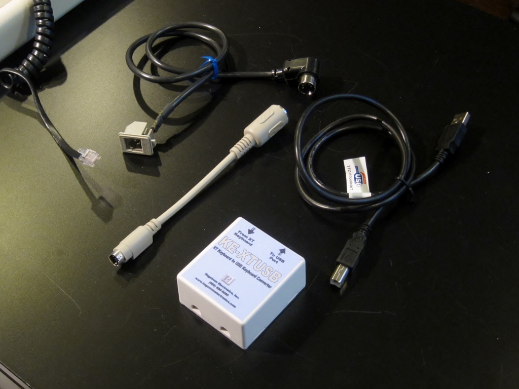

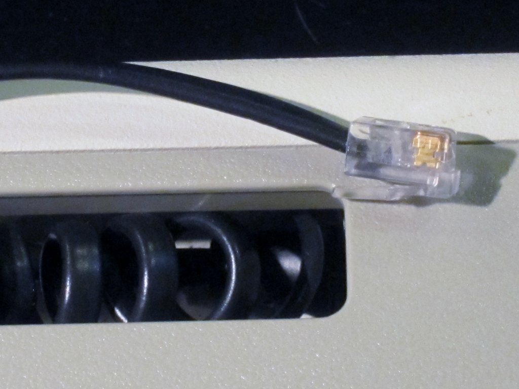

Regarding the 5155 keyboard, it speaks XT and just needs to have the 4-pin RJ-11 and works when attached to XT to ps/2 converter.
01 Dec 2016, 01:08

01 Dec 2016, 02:39
snuci wrote: I hate to disagree with clickykeyboards but I don't think the top one is real. You can see a nick on the third picture on the left side and a scratch on the second picture that is lighter than the case colour. That indicates that it's painted and my version is not painted. You can see that from the crack in one of the screw mounts.
If you nick the case on a regular XT the material underneath is a little lighter than the surface.
01 Dec 2016, 02:44
clickykeyboards wrote: `I'll need to check my customer sale records to see if I can find the contact info of the original buyer
Hmm, this makes me remember. I still need that board, clicky ;)
Ratfink
01 Dec 2016, 02:56
Yes, I agree. The plastic is kinda yellowish, and the original XT is painted beige. That one looks like it was painted an industrial gray instead. Which reminds me, I have an XT case with no paint that I need to paint.
01 Dec 2016, 03:20
lot_lizard wrote: I have never seen a 1390653 with a silver badge though... is that stock?
I'm not sure, I got this from an eBay dealer in the ancient days who got his keyboards much like elecplus, but was caught sometimes frankenboarding his offerings (not out of malice, he just wanted to offer complete boards). Could be possible he replaced the top part of the case. If I remember correctly though, this model was spotted with both black and silver square labels.
snuci
01 Dec 2016, 03:51
Ratfink wrote: The plastic is kinda yellowish, and the original XT is painted beige.
Agreed. You can sort of make that out in the screw holes on Photo #6. You can see the yellow in the screw hole of the normal XT. In the industrial one, it remains grey/green throughout.
E TwentyNine
01 Dec 2016, 13:14
There's no evidence clicky's industrial XT is anything other than an IBM creation.
IBM did one-off stuff all the time.
clickykeyboards
01 Dec 2016, 15:43
The industrial XT 83-key keyboard that I found in 2005 was a unique find. I would have thought with the growth of interest in vintage IBM mechanical keyboards and the intervening 11 years that another relic would have shown up, somewhere.
That said, 30 years+ since the IBM XT computers were originally released.. it is a testament to IBM's industrial design that these keyboards still just work. :)
Another part number of interest to add to the dicussion is 1395240.
These were sold with Allen-Bradley (division of Rockwell International) logos in place of the normal IBM 8-stripe logo and were sold with factory automation equipment. Essentially the same as a 1394946 http://clickykeyboards.com/product/1991 ... -11-05-91/
E TwentyNine
01 Dec 2016, 18:05
Heh. I was actually going to mention the AB boards. IBM had also made an industrial touchscreen device in that same timeframe, never saw market. And a ruggedized thinkpad that also I believe never saw market.
