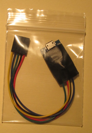

I have a Zenith Z-150 (100-1886) Black Label with SKCL Yellow Alps. It works with an Orihalcon-Soarer converter. I bought an internal converter from Orihalcon -- this one has the 5th wire for the reset. His converters have a micro-USB connector on the mini circuit board.

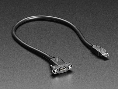

I plug this into a micro-USB cable with a panel-mount micro-USB connector. The connectors I have been using are from DataPro for $9.95:
http://www.datapro.net/products/usb-mic ... e-m-f.html
But recently, Adafruit started carrying a more compact version for only $4.95:
https://www.adafruit.com/product/937
There is plenty of room inside the Zenith Z-150 case for the converter and panel-mount micro-USB cable with connector. You just need to drill three holes in the back of the case for mounting the connector. It works quite nicely.
Adafruit also carries a mini-USB connector, so if you preferred to have a mini-USB connector, you could use a small mini-to-micro adapter for the Orihalcon-Soarer converter. You can find such adapters on Amazon and eBay.
