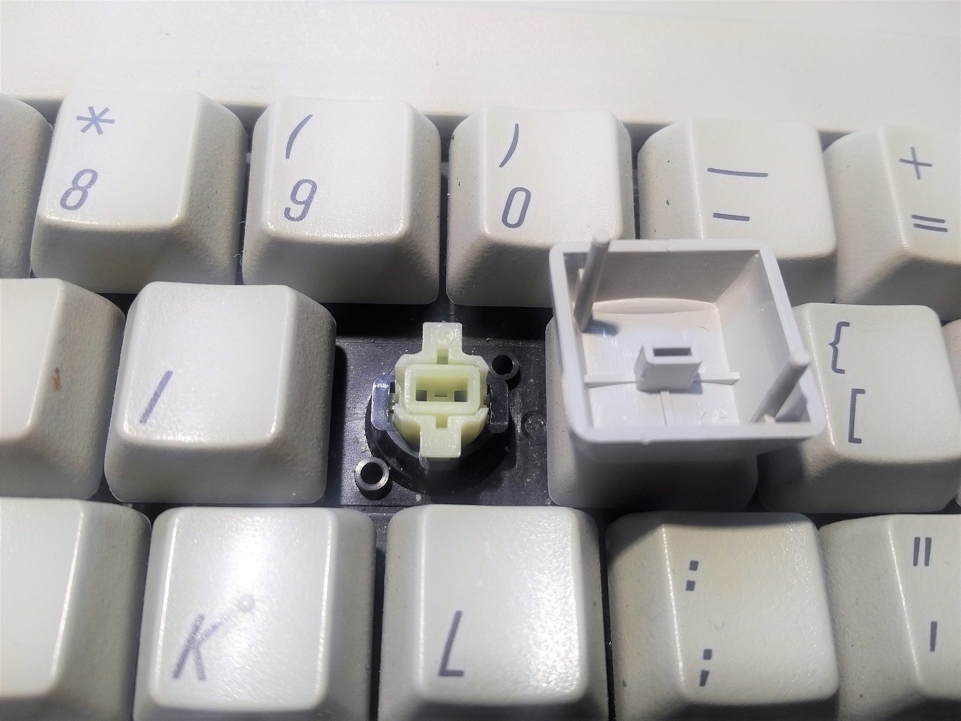

25 Dec 2016, 17:32
Daniel Beardsmore wrote: M0487, yes. Specifically, where the serial number begins "S" for "SMK". (Serials beginning "M" denote Mitsumi; some serials also begin "T" and these seemingly are also SMK, but nobody's reported seeing one.)
These ones? Serial number starts with an "S". I don't think I have a keyboard with a "T".
Apple Keyboard II SMK?
Apple Keyboard II SMK.jpg (339.64 KiB) Viewed 2916 times
If so, I'll have to take some pics in the next couple of days.

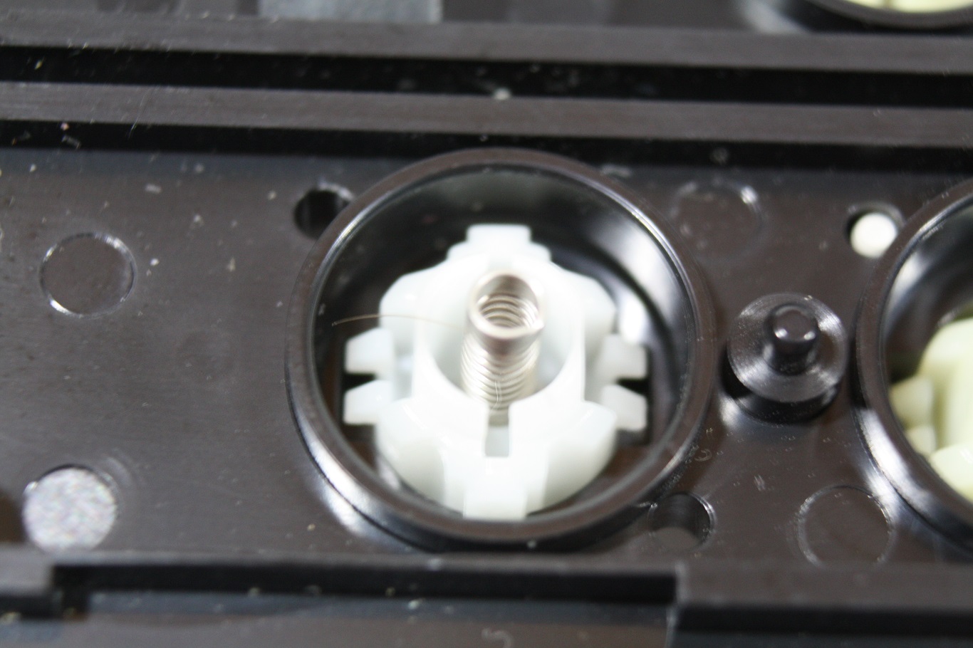

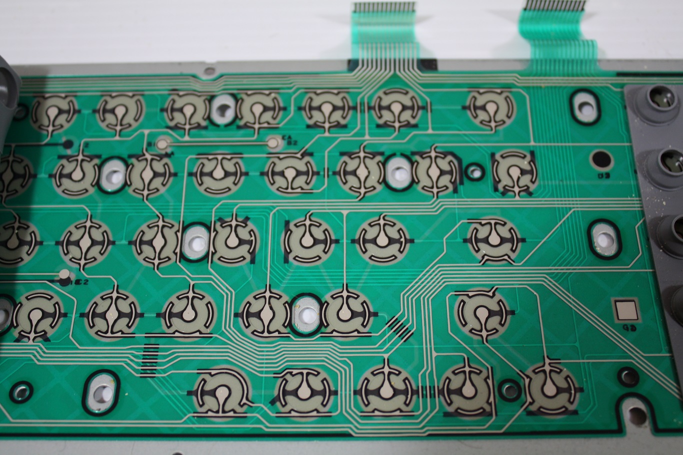

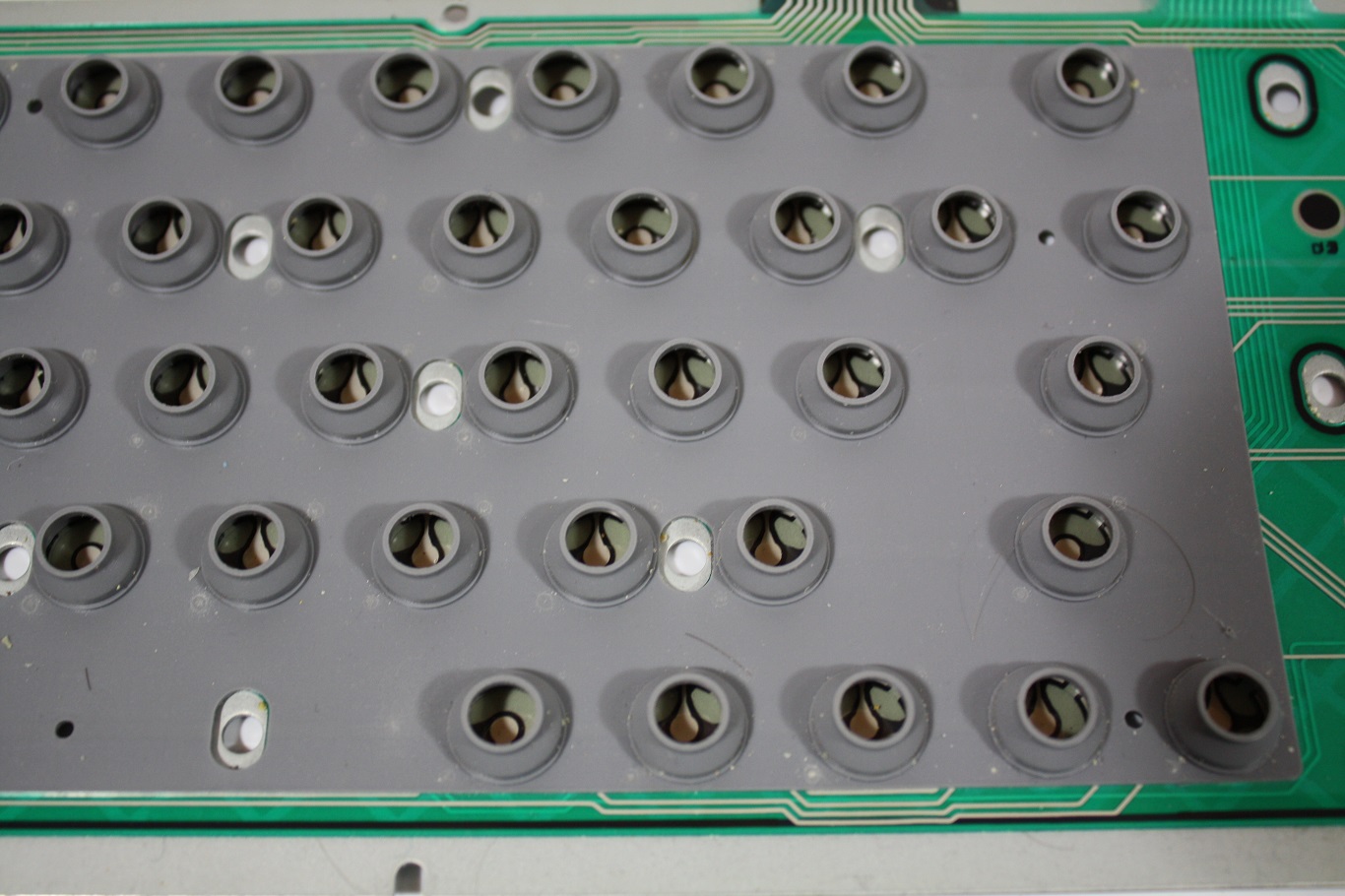

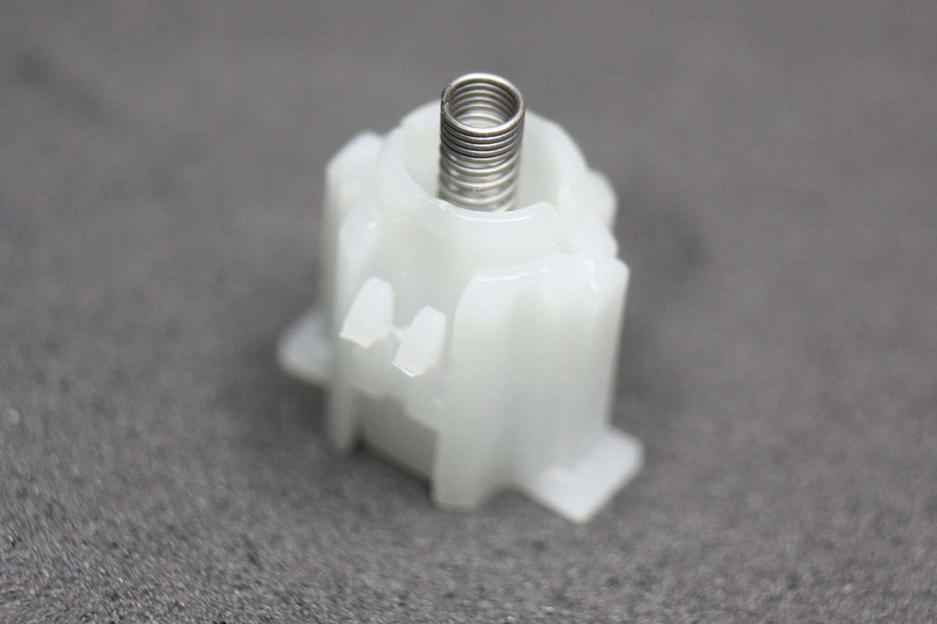

27 Dec 2016, 16:24
Daniel Beardsmore wrote: Yes, that type. Cindy asked me about it — the photo on her site shows it more clearly and it does seem to be what I was thinking, which is (very, very, very approximately):
The attachment SMK dome and spring.png is no longer available
It seems to be a buckling rubber sleeve with separate membrane pressure spring, giving you pretravel. I always figured it was prong over membrane, but when I was writing that up, I noticed that there's no prong, so the grey "lining" to the guide shaft must be responsible for the key return.
I think you got it right. I'm sure you knew this already but just a note that the spring presses the two membrane sheets together to make the contact. It's not clear unless you know there are two membrane sheets (identifiable by the two membrane contact connectors in the membrane pic). More pics for the Wiki later.

27 Dec 2016, 16:57
Yes that is exactly what I thought it was. It's three membranes: top and bottom (conductive pads) and centre (spacer). The centre spring is a give-away that it's a three-layer membrane.
