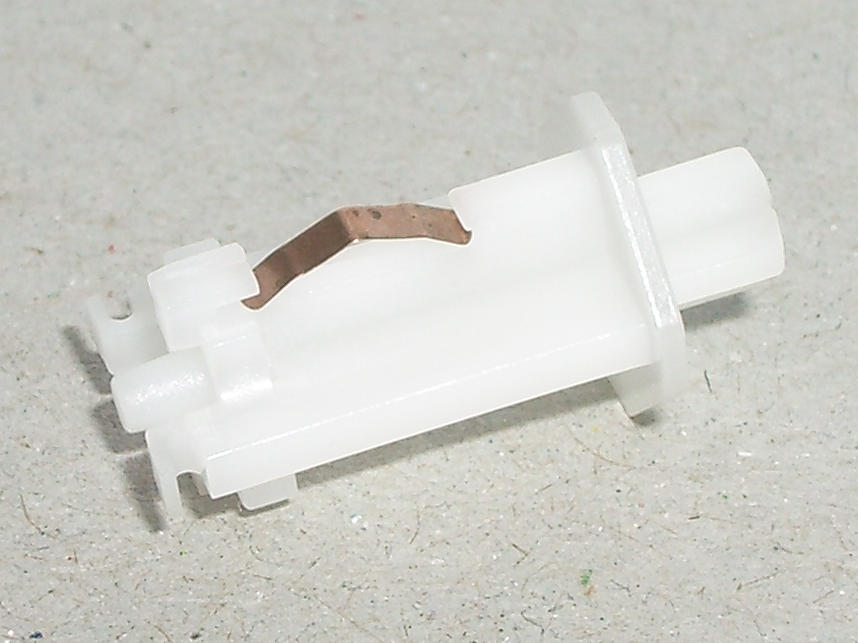

However, the tiny beryllium-copper folded leaf spring in DC-50 is captive but is free to move vertically. This small amount of lost motion that occurs is what gives it hysteresis. The following photos show the operating positions:

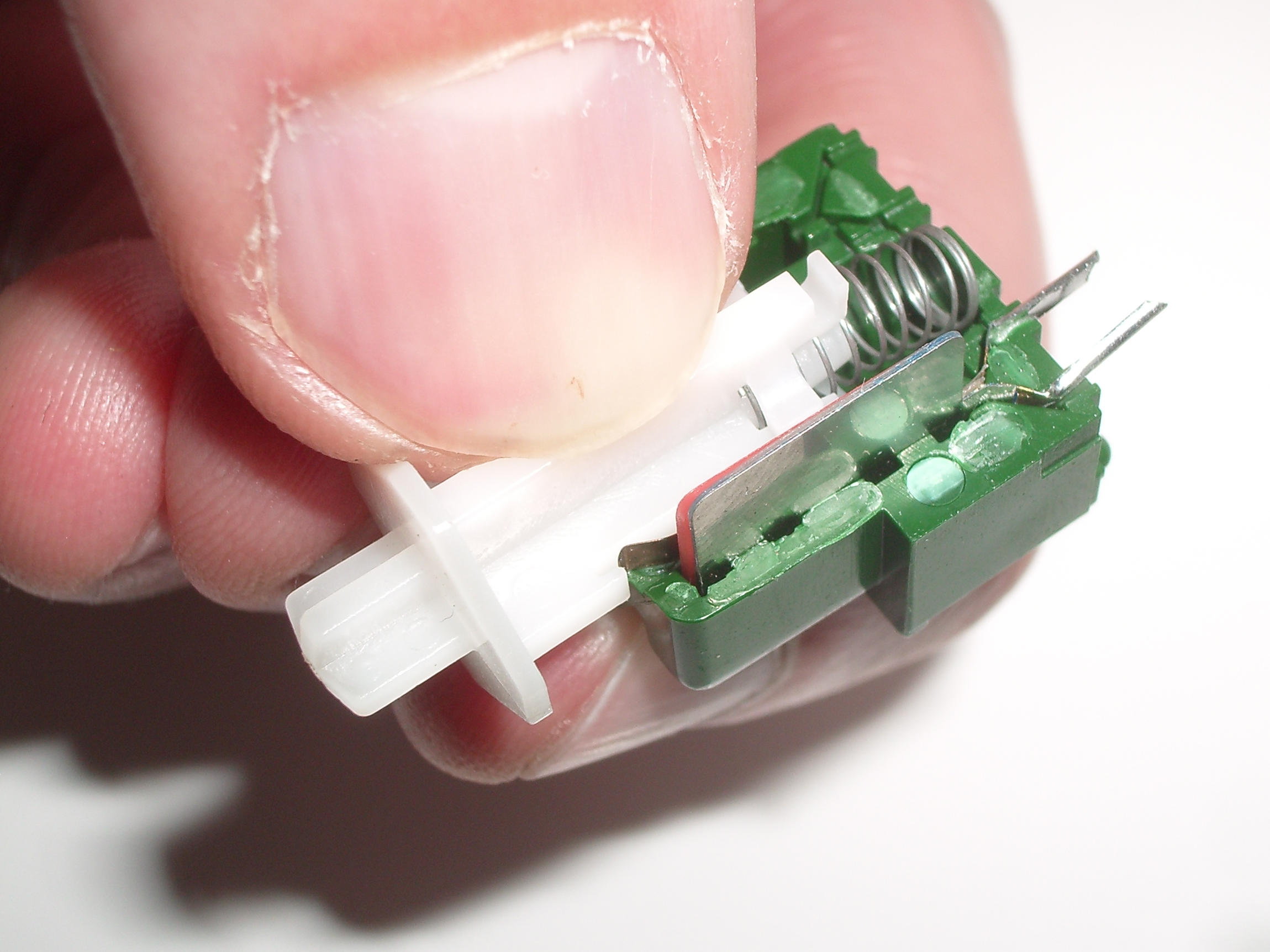

DC-50 operation 1.jpg (150.73 KiB) Viewed 917 times

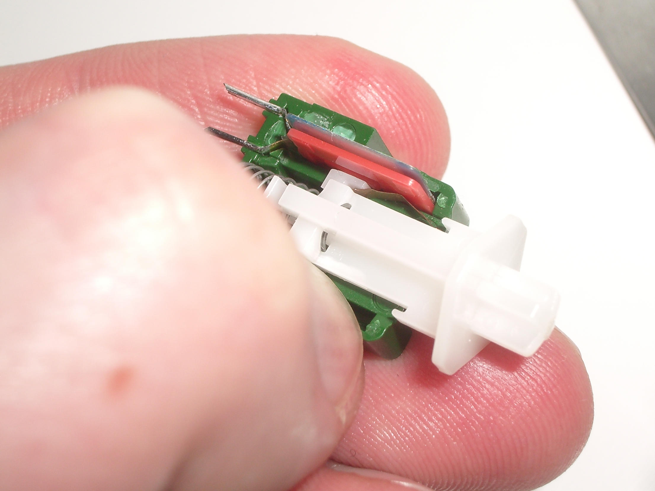

DC-50 operation 2.jpg (146.39 KiB) Viewed 917 times
Basically, the slider pushes this leaf spring downwards, and it presses against the plastic prong that in turn closes the membrane contacts. When you release the slider, there's a delay before the lower end of the leaf spring recess reaches the slider and pushes it back upwards, so the release lags behind the slider, giving you hysteresis. It's hard to explain, but makes perfect sense when you see it working. There's even a tiny click when the leaf spring clears the prong and it springs back up.

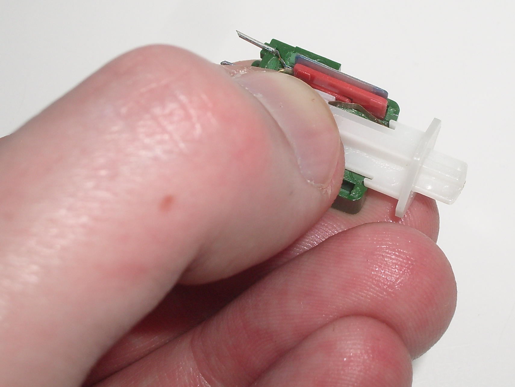

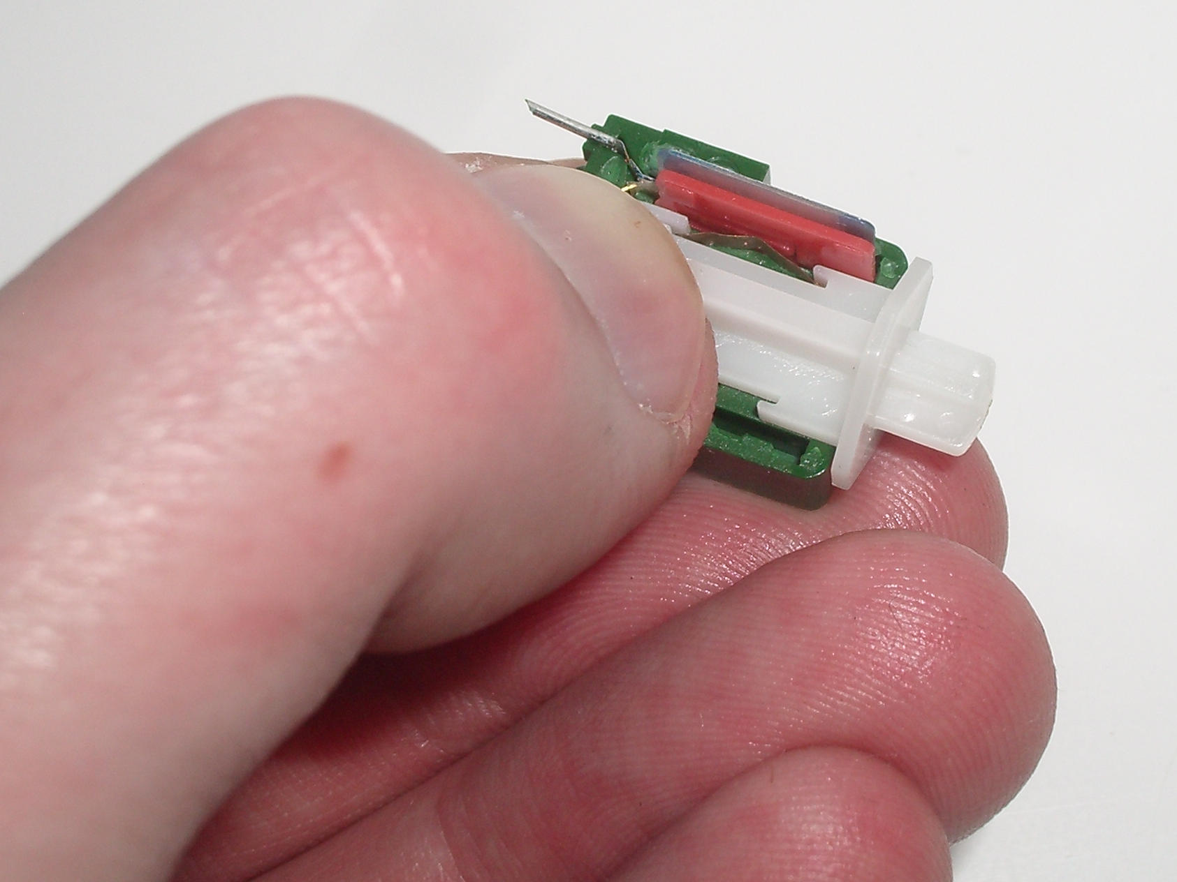

The following photos show the switch more clearly — it's really hard to get a good angle considering that I have to keep my thumb on the slider at all times (otherwise it will catapult out):
DC-50 operation 3.jpg (279.56 KiB) Viewed 917 times
DC-50 operation 4.jpg (220.67 KiB) Viewed 917 times
This is the spring in the slider, in its special recess that is longer than the spring. This isn't even the grey card I bought, but the much darker packing card it came in, and even that is still far too light! (And it looks like there's hair all over it!)

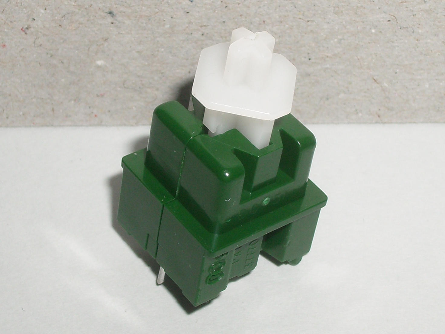

Getting the right shade of card isn't easy: it needs to be dark enough for the slider to stand out, but not so dark that the shell disappears into it, and actually exist for sale! This is switch pressed together:
The actuator leaf is noticeably absent (look at the downwards slot just under the keycap platform), so if I do reshoot this with a less kludgey background I'll reassemble it 100% complete. Getting that leaf spring in without the official Datanetics assembly jig is rather fiddly!
