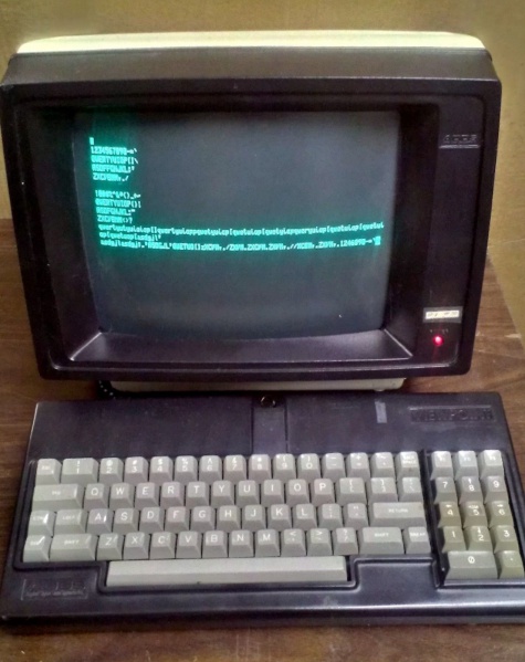

03 Jan 2017, 17:44
This is your keyboard (in cleaner :mrgreen: ) theycallmestino:
http://terminals-wiki.org/wiki/index.php/ADDS_Viewpoint

I love those vintage Ads and picture of vintage computers you posted, I myself collected some as well. Those green letters on screen somehow are fairly fascinating to me.
