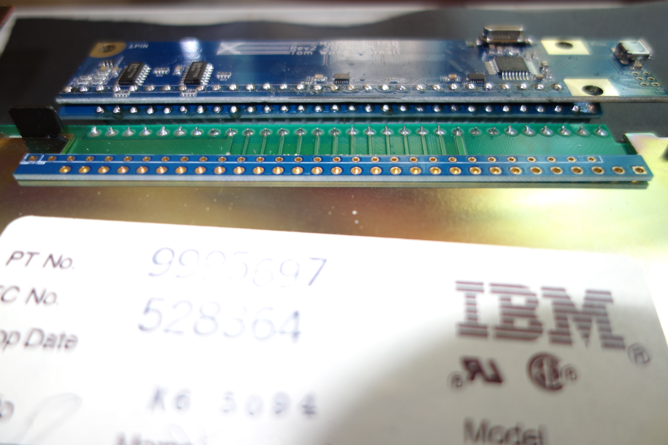

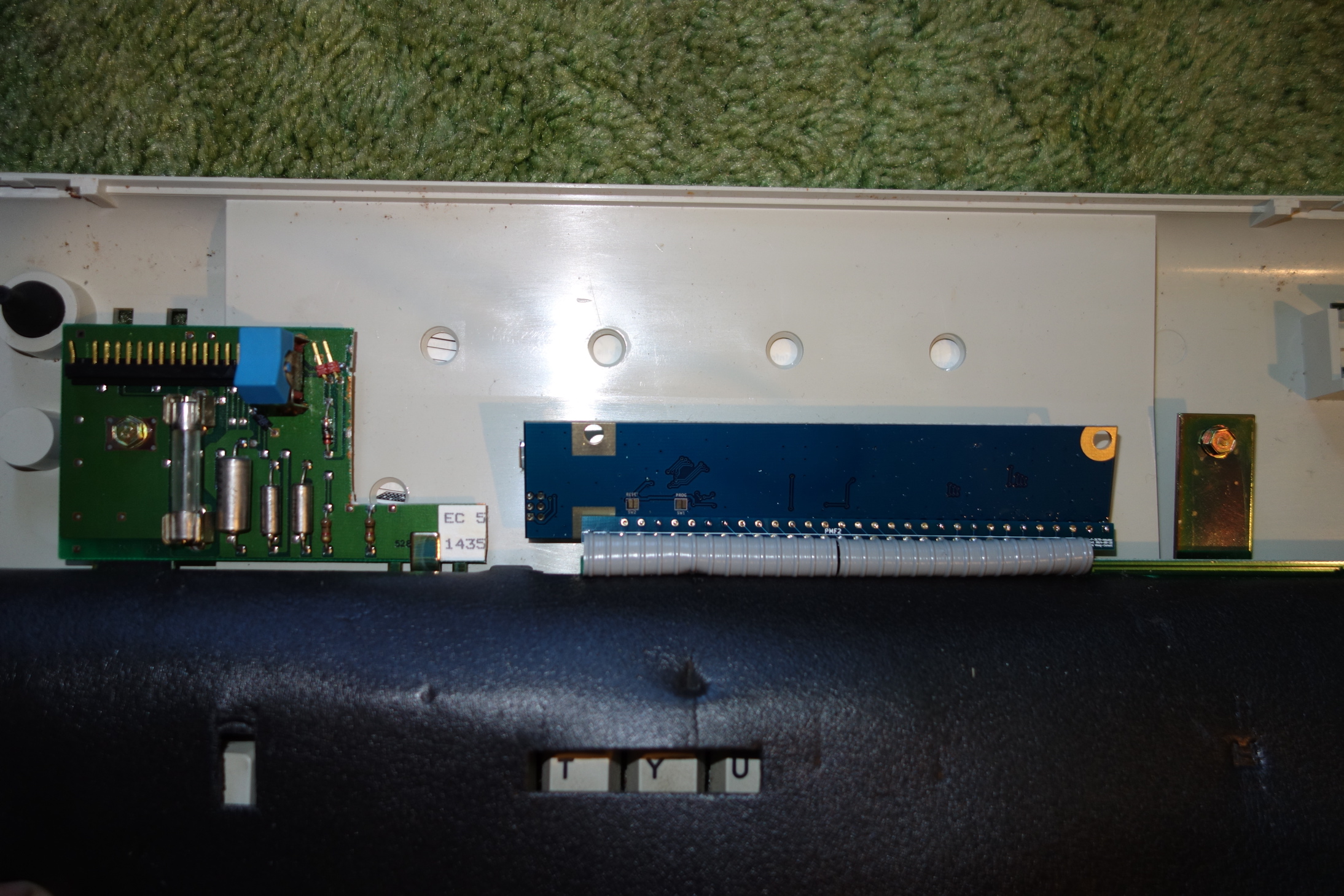

The 3178 requires an Xwhatsit, but also a small pin converter board as the 3178 has a slightly different pinout than a regular Model F. I can add these on to Xwhatsit orders for $5 more. Don't really have them listed anywhere else, so just PM me if interested. Same with Solenoid Drivers as the 3178 has a solenoid too if you want to make it a really unique model F. Those are $25 each.
Pics below of the correct orientation of the "3178 Adapter Board." It actually is mounted up-side-down compared to other Model F's so that the "Xwhatsit" logo is not visible from the top of the keyboard.
