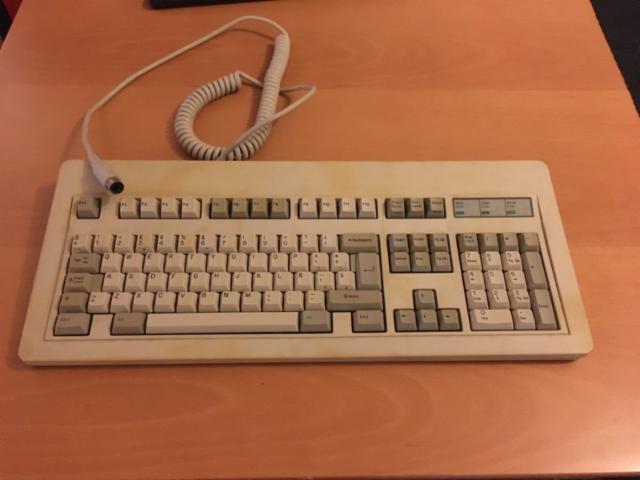

Good afternoon
Im from Spain, im a follower of your pages , and this is my first post.
I would like to know if this keyboard is a clone of model M, with buckinlg spring etc..
Thanks for letting me join.

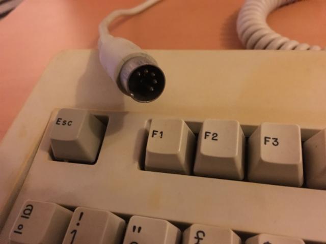

I don't think so. Can you carefully pop off a key cap and post a picture of what's underneath?

It's interesting, but it's definitely not buckling spring.

Shouldn't this have been posted in the IDENTIFY THE KEYBOARD thread instead of creating a new one?
Anyway, it is easy to see that this is not an IBM buckling spring by it not having as curved a case as IBM's. IBMs keyboards also did not yellow. There are a few rebranded IBM Model M but they are a bit rare, but identifiable by the build being the same.
If you saw this on eBay listed as "IBM BUCKLING SPRING" or similar then ... well, don't trust everything people write in descriptions on eBay. It can be incorrect not just for keyword-spamming though, some sellers are just ignorant. Others will write "IBM" because the box carried the text "IBM PC-compatible", which was common for a long time.

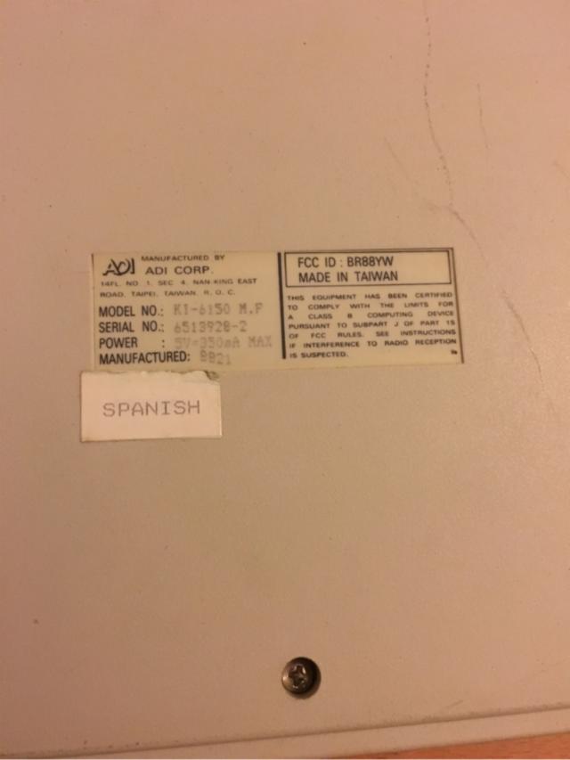

- Daniel Beardsmore
- Main mouse: MS IMO 1.1
That might be the first time one has ever been found with an actual ADI label and model number.
The address on that label does match that of the address of the monitor manufacturer ADI, which is good to get fully confirmed:
http://web.archive.org/web/199704281022 ... anches.htm
