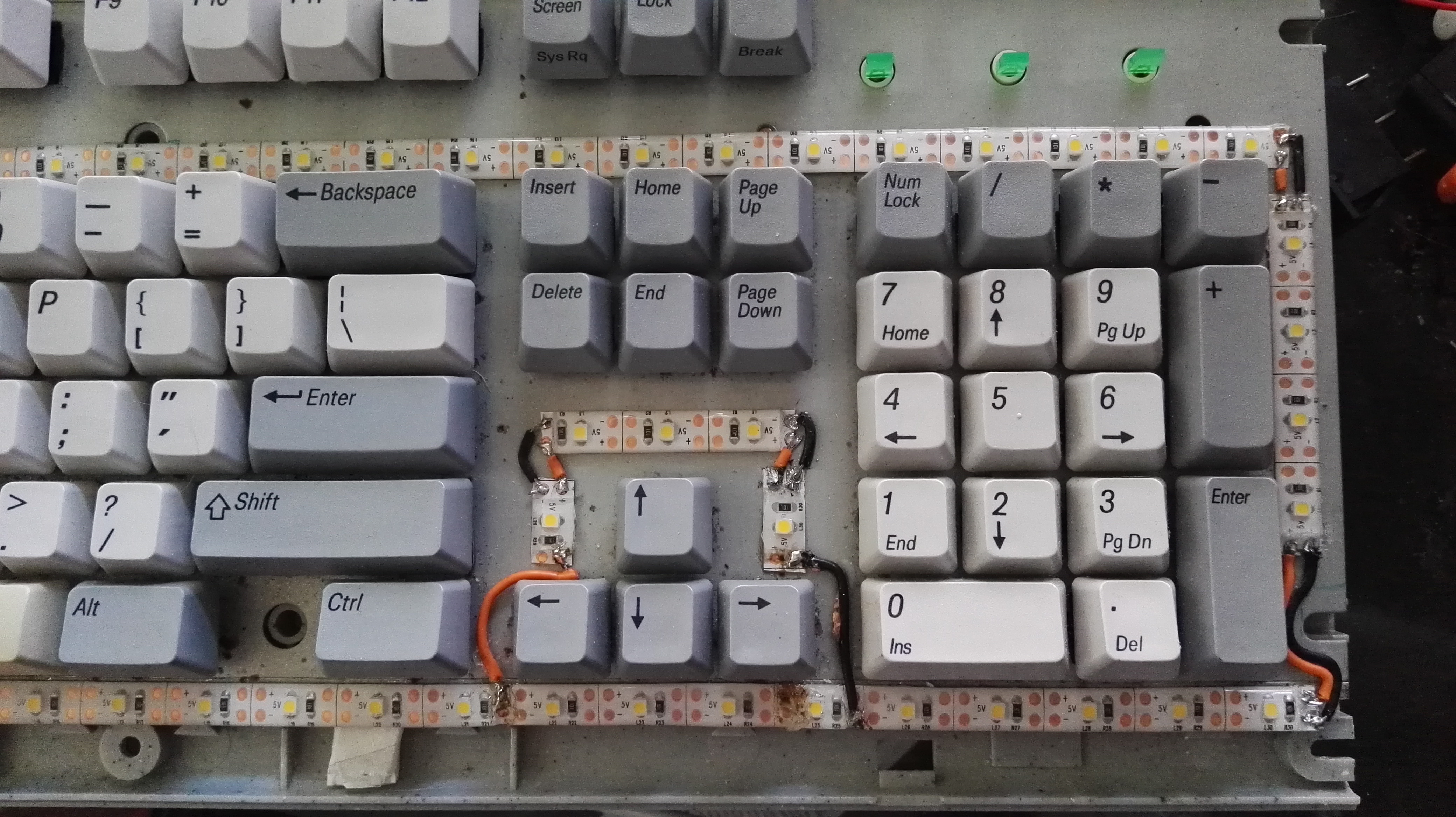

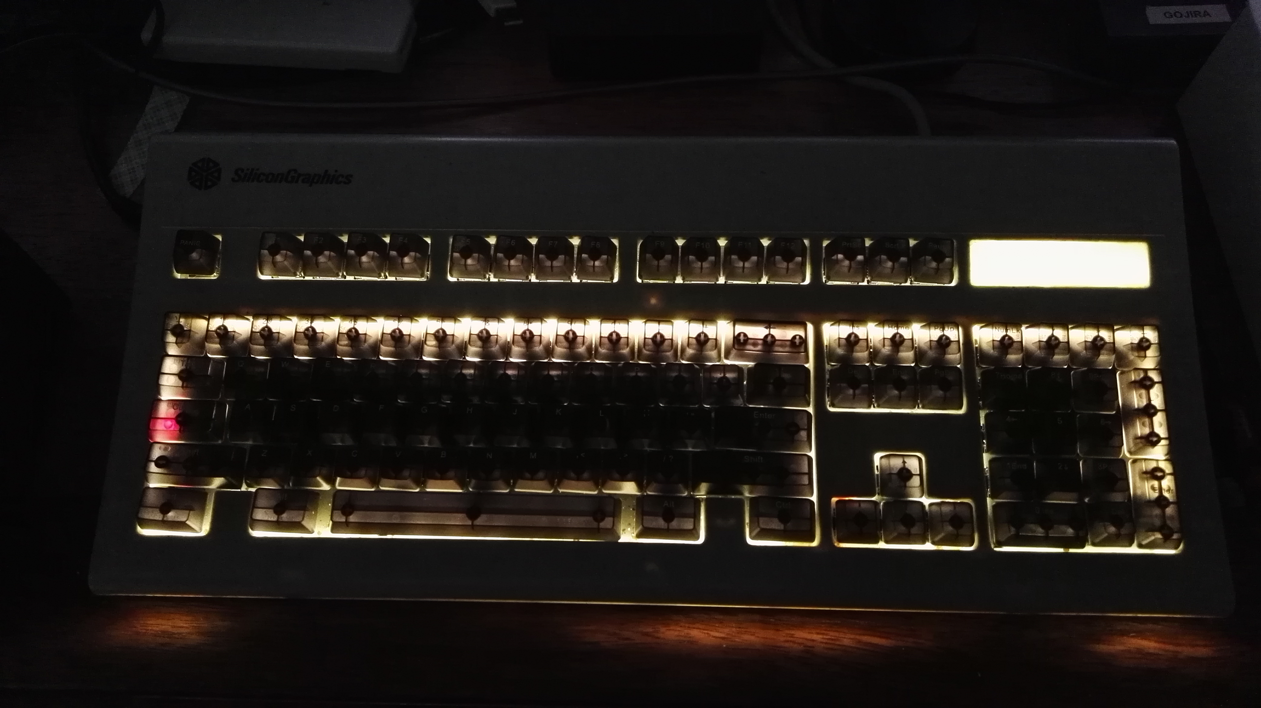

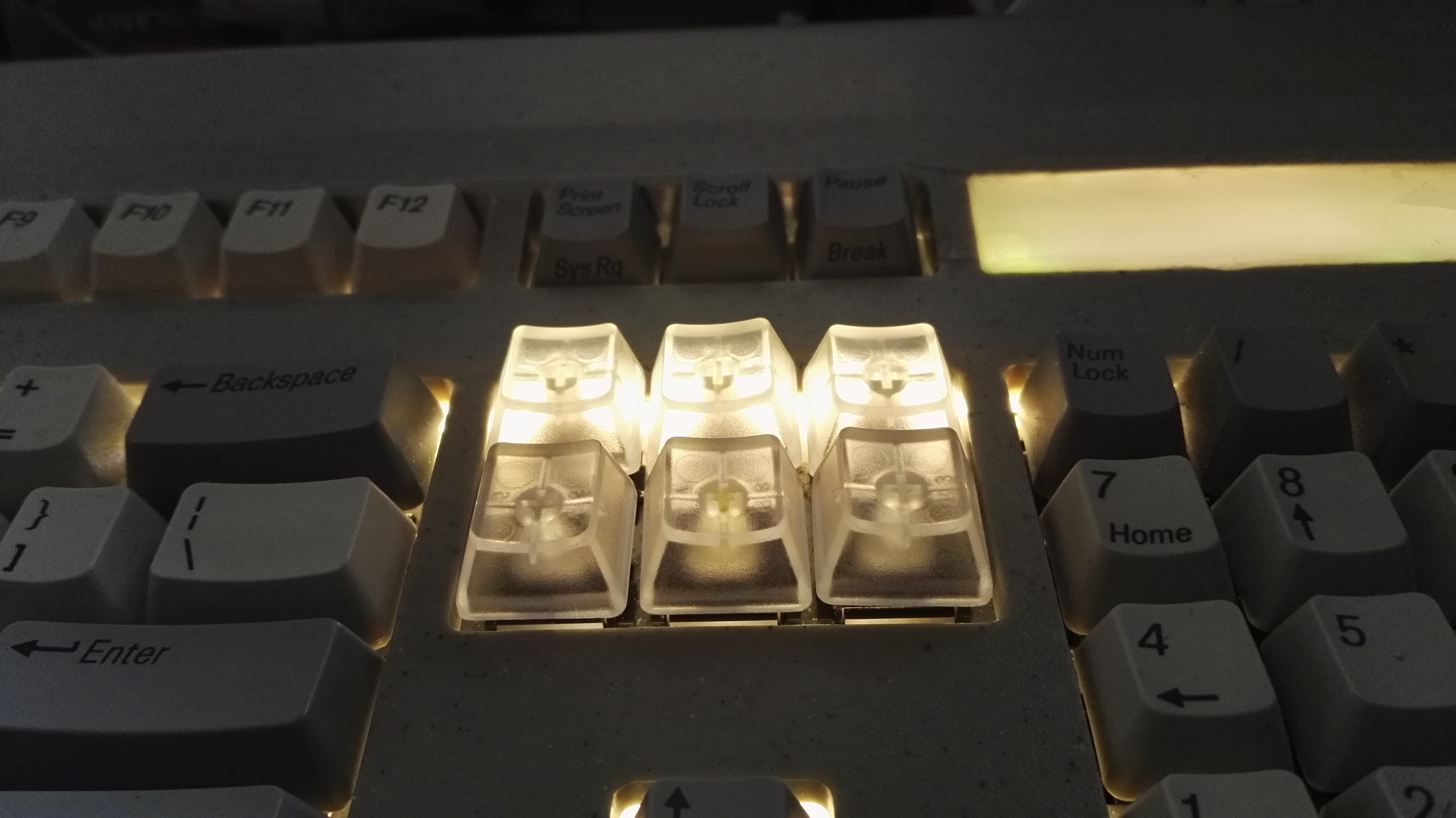

A little project I'm working on to breathe some new life into this keyboard.
Using LED strips to backlight the keys, also down the line I intend to replace all keycaps with transparent ones,
and also possibly add a clear acrylic window to show off the chips and capacitors.
The illuminated window where Caps, Num, Scroll were is temporary, I'm having a sticker of my company logo made to put there. I'm also thinking of ways to illuminate the Silicon Graphics logo but no bright ideas yet.
Input, suggestions, comments and queries all encouraged.
- IMG_20170408_110747.jpg (2.75 MiB) Viewed 9170 times

Nice! I think it's gorgeous!
If you don't mind me asking, what are you using to power the LEDs and how are you wiring them?

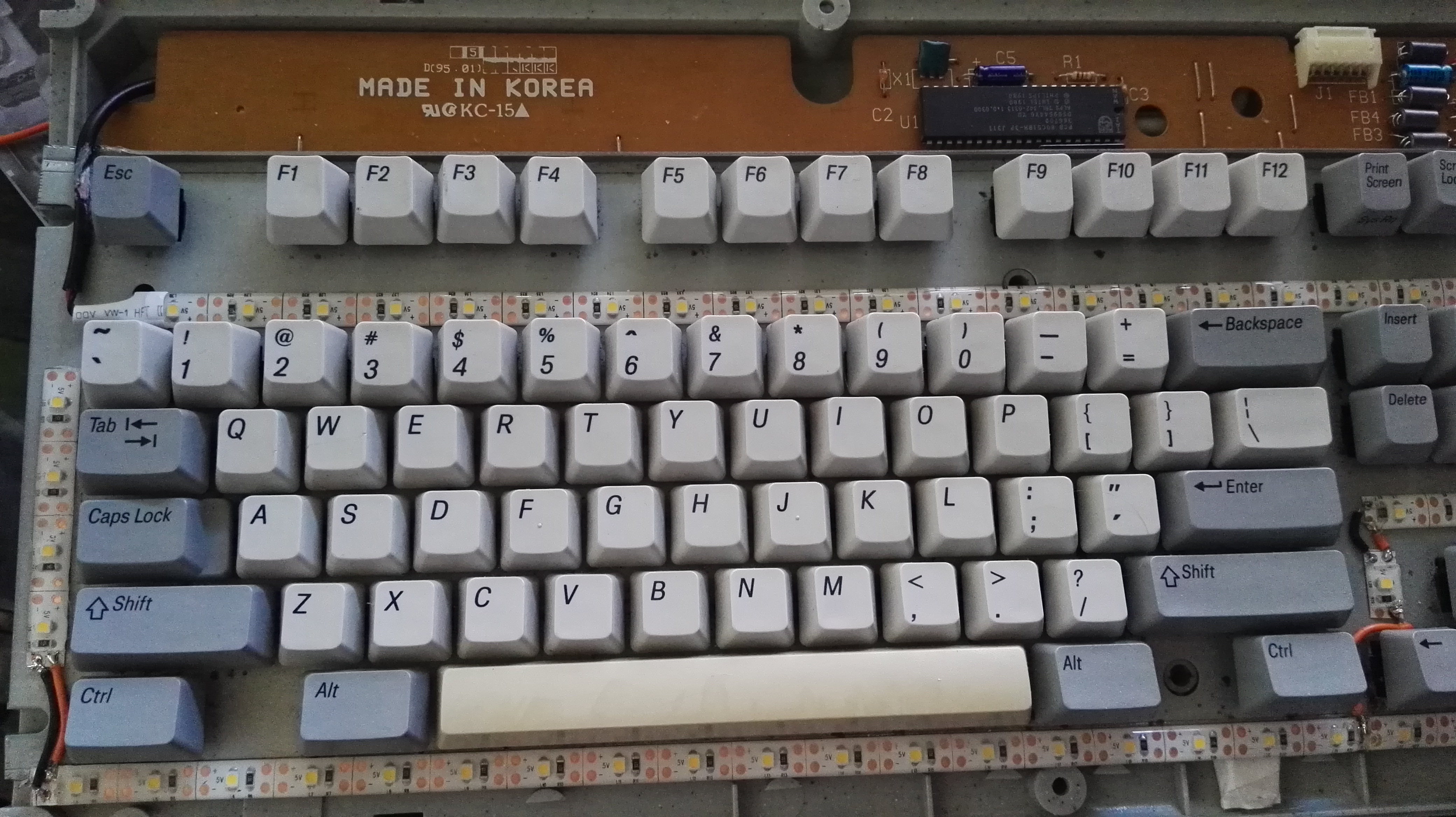

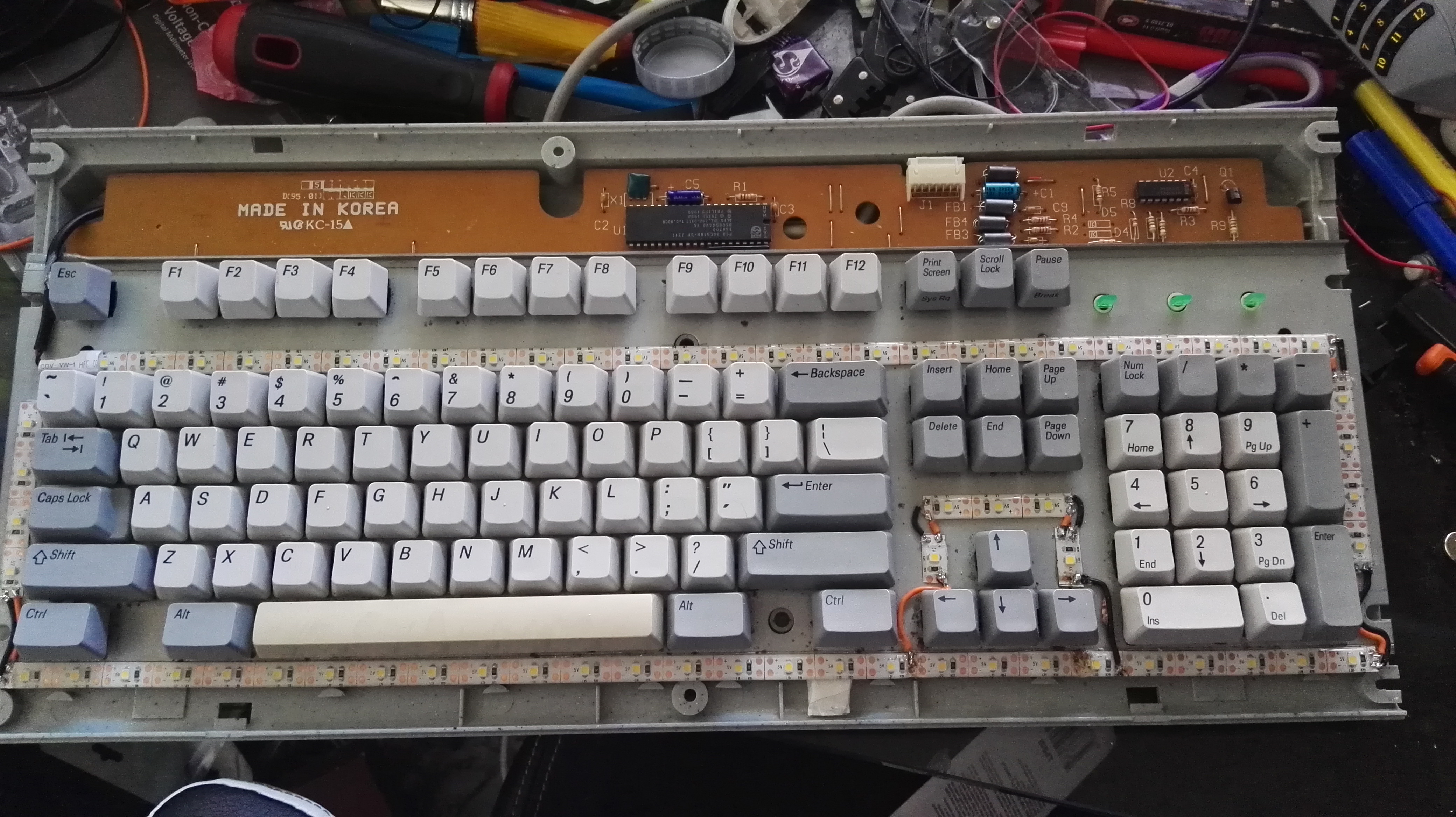

I started with some USB powered 5v led strips, so there was an extra usb cord sticking out the back to power them. But after I installed them I found a 5v line off the board and connected to that, so they run off the same internal power as the board now via ps2.
I do like these caps but I feel like I need something a bit more colourful, and transparent caps will help the light penetrate into the middle rows of keys a bit more. I'd be happy to sell the caps if someone wants to give them a good home.

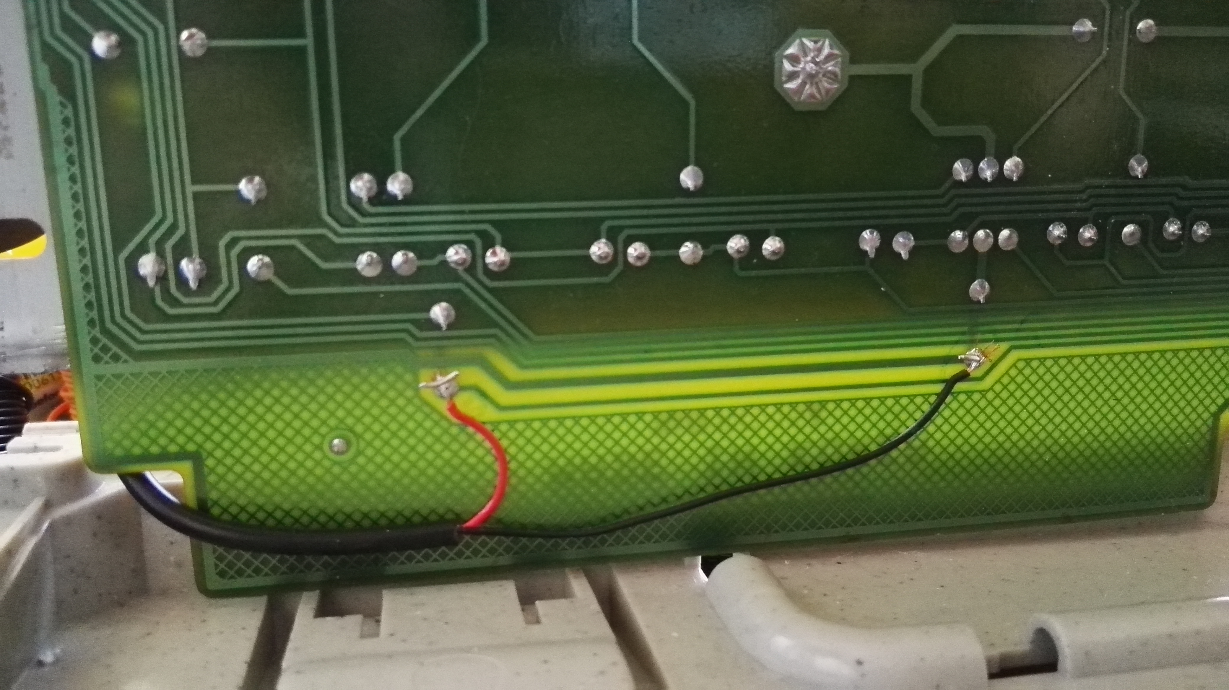

I've wired them up thusly, please forgive my bad soldering as I'm not very good at it, it is not my favourite technology.
66 LEDs all up, and i did have to snip a few plastic tabs off here and there to get the shell to close cleanly. Left Right Power

I'm not a big fan of backlit keyboards in general (I do like backlit legends) but something just looks right with yours. Are those LEDs warm white? Nice work.

Sorry about the late reply. Haven't been able to get back here in the last day or two.
How were you able to "find" the line? I'm trying to learn this stuff (BTW, your soldering looks immaculate compared to mine!); is it just a matter of poking around with a multimeter until you found it?

Yeh basically that's how it works, I never owned a multimeter before this, it's like magic! I looked up the big chip by its serial numbers, and found the schematic for it. This showed me where ground was, in the upper leftmost corner pin. And then just poking around to find a 5 volt line, or 4.97 or whatever, close enough for government work. Then I just followed the traces to find a convenient location to attach the wires.just_add_coffee wrote:Sorry about the late reply. Haven't been able to get back here in the last day or two.
I went with warm white LEDs because cool blue seemed like it clashed with the 90's aesthetic. A lot of things back then were still incandescent bulbs, or at least that's my recollection from whence I was a boy.
I'm looking into the caps situation now, and yeh it seems like it's going to be a pain no matter what solution I go with. I would love to get my hands on a 3D printer and make some myself, but that's a tad beyond my budget. I could also get some cherry switches and modify them, or use adapters. Anyone know a good place for for transluscent keycaps? Even cherry ones? I'm thinking of a mix of Turqoise/Cyan and Yellow/Orange.

I'm waiting on parts at the moment, but my next move is going to be to relocate the Lock Switch LEDs into their respective keys. I've got some clear transparent keys on the way so i'll experiment with adapting them to ALPS and embossing some lettering into them. I've also started thinking about swapping out the White Alps switches for Mattias Quiet-Clicks, i like their feel, and the clear construction will help the light more.

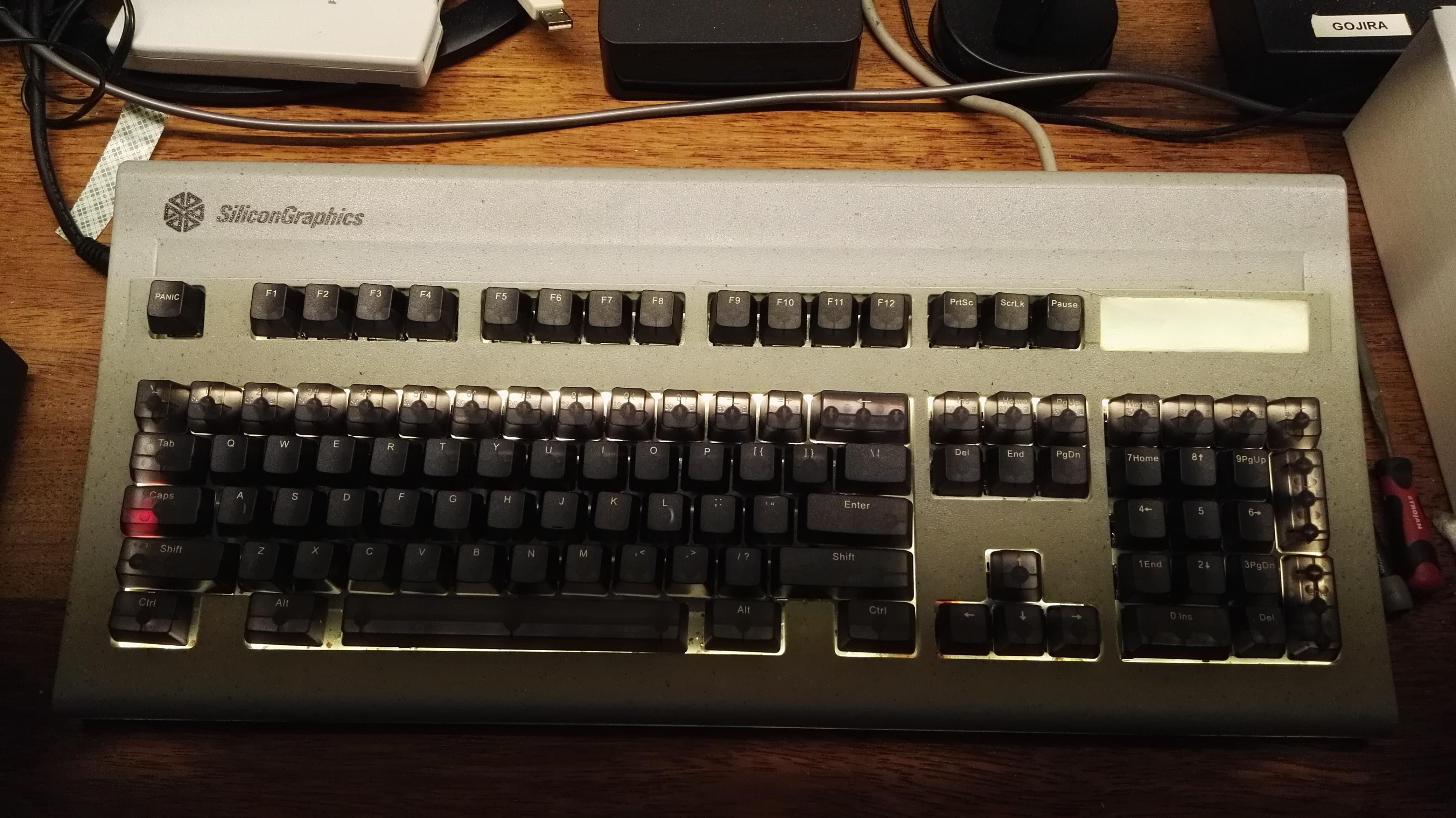

Okay I finally got the caps I ordered to do some tests with, I made some temporary adapters out of plastic so I could stick them on and see how they look. The caps are quite a bit taller now, but showing off the stem is the stylish thing to do these days right? And they look nice and the light penetration is fantastic. I'm starting to think I could get enough colour in the keys just from spray painting the steel backplate and letting the light bounce off it. I did this cluster as a test.

I have officially entered the Gimmick Zone.
[img]IMG_20170731_133547.jpg[/img]
- IMG_20170731_133547.jpg (2.74 MiB) Viewed 8773 times

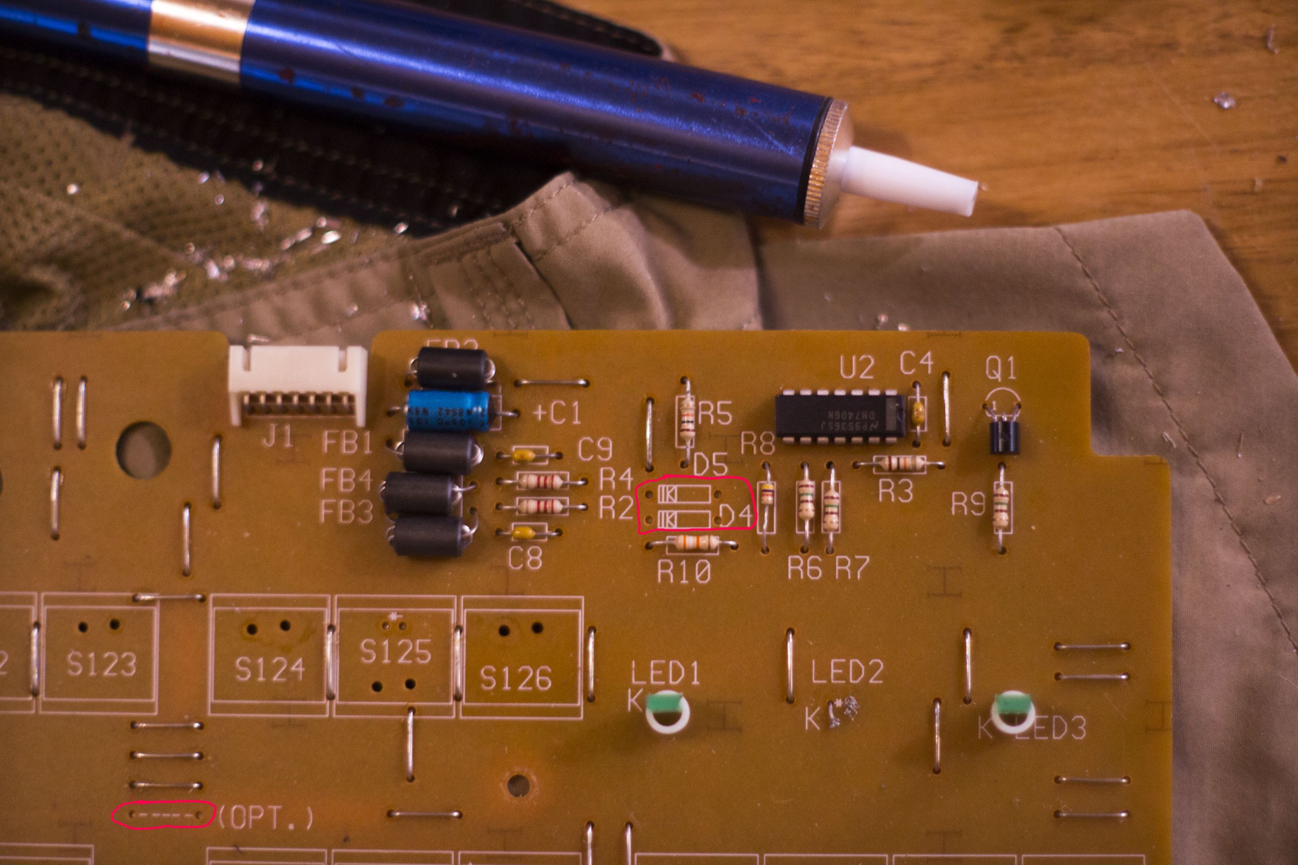

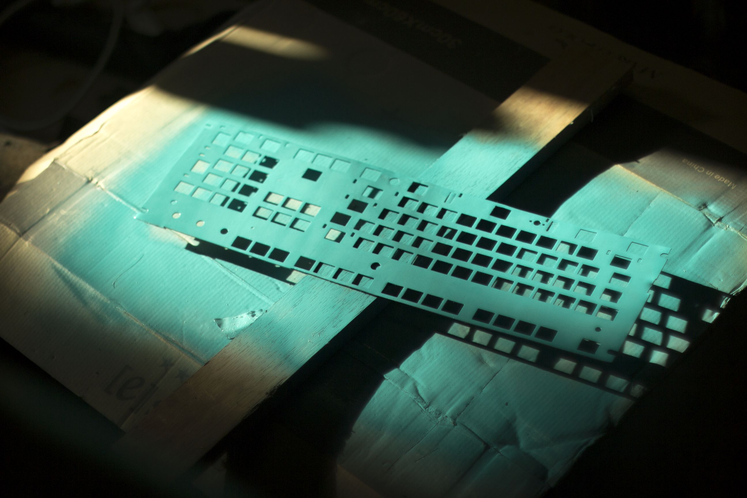

I'm now in the process of painting the backplate, and re-engineering a cleverer way to mount the LEDS.

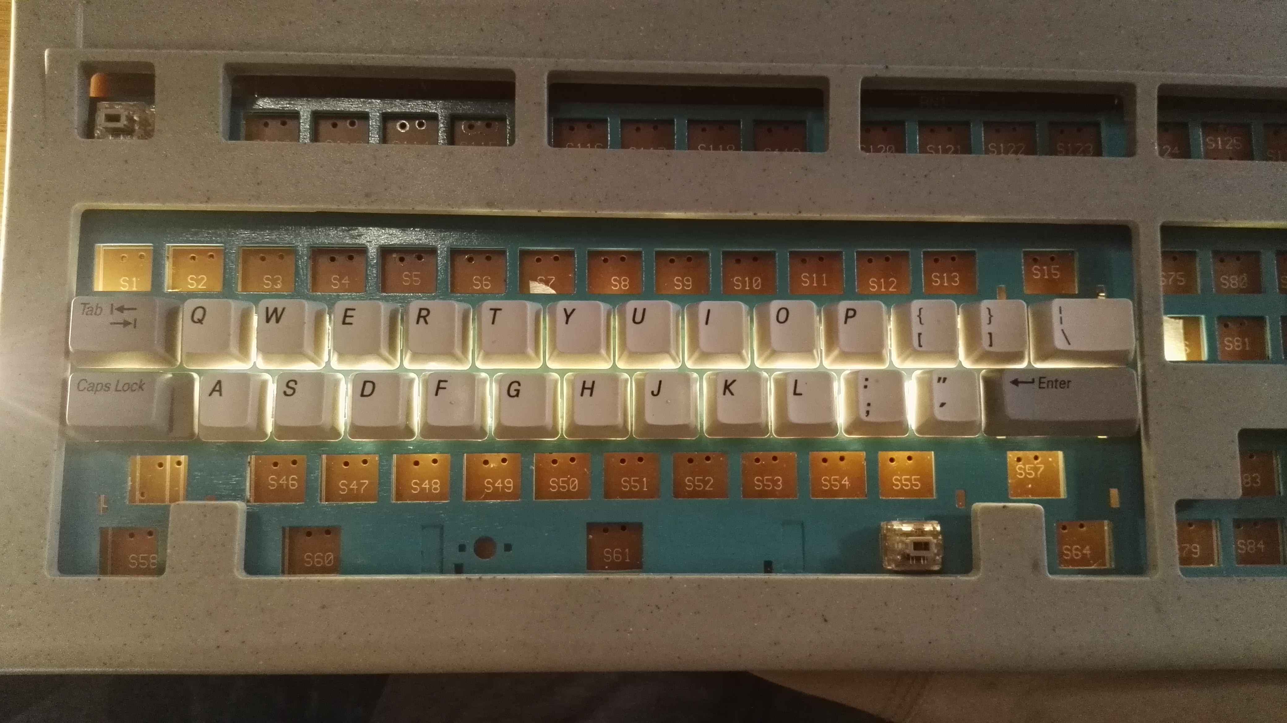

I've gone with an Aqua/Teal for the plate. Before I put it all together though, does anyone know what the deal is with these missing components on the board?
I looked on the wiki but couldn't find anything about it.
There are two empty slots for Diodes marked D4 and D5, the traces seem to run between the two control chips.
And a missing post marked OPT which seems to connect to ground.
If anyone knows of any explody reason why I shouldn't add these components, I'm all ears, otherwise I think I will add them just to see what they do.

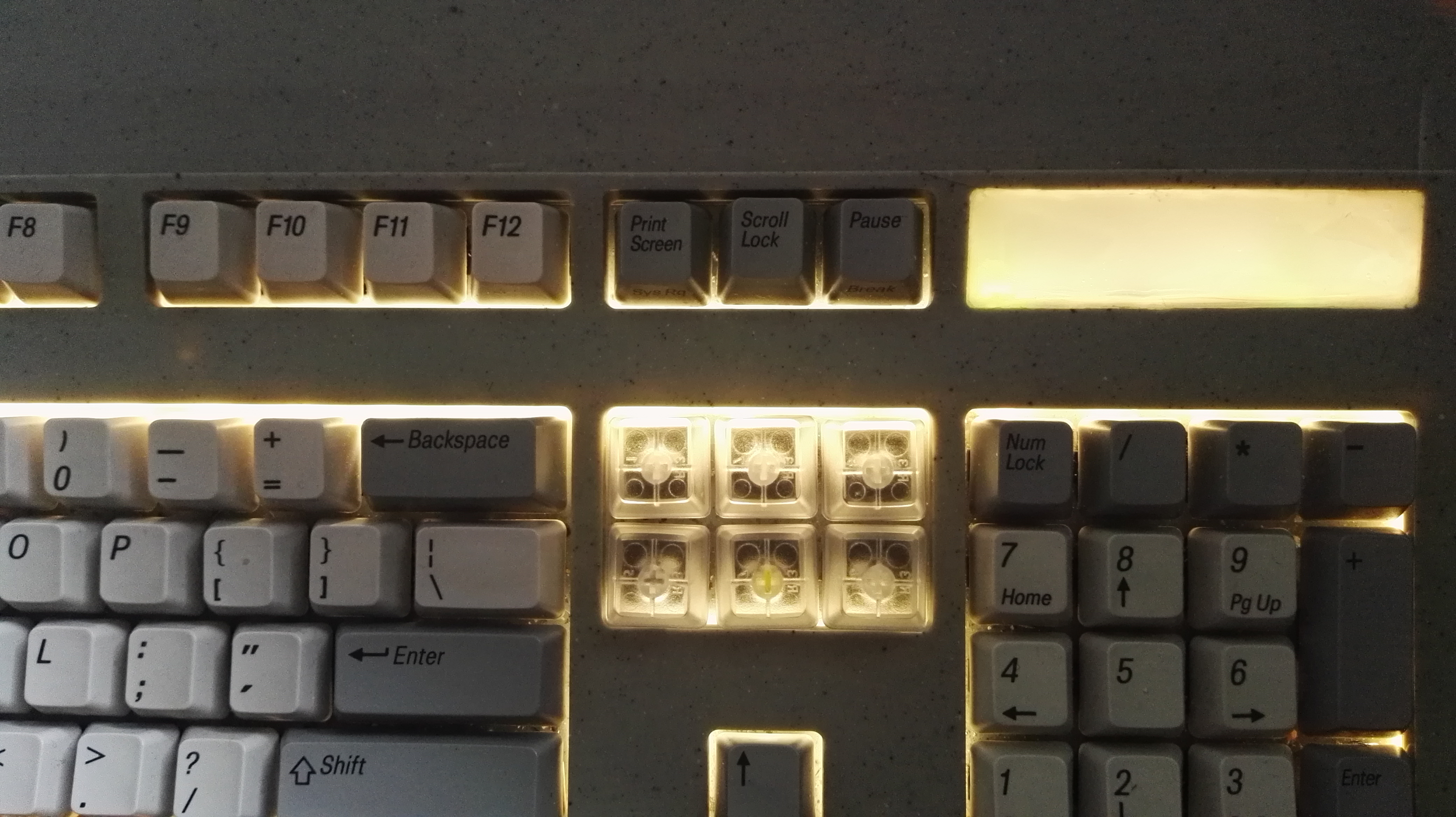

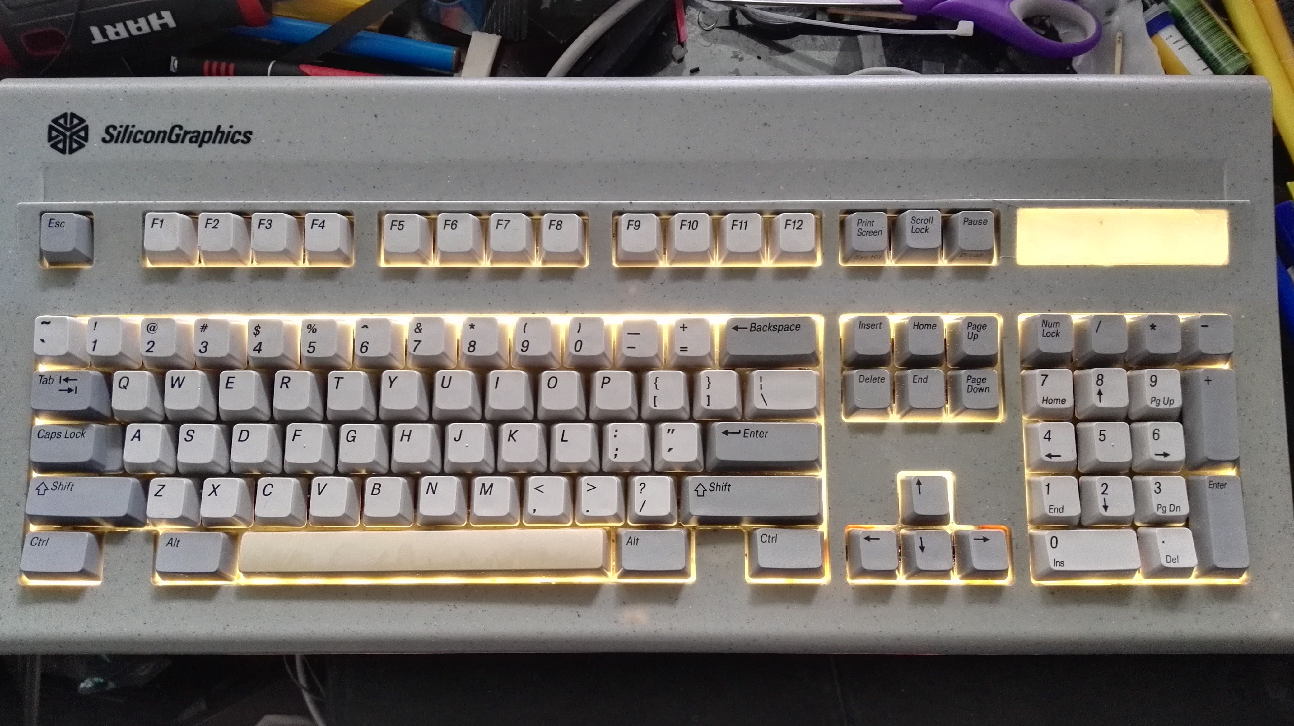

This is an experiment with mounting the LEDs under the backplate, as you can see it gives a much more subtle glow through the clear Matias switch housing s which I like a lot.
- pixelheresy
- Location: Åland
- Main keyboard: Pok3r Vortex (work); IBM Model M (home)
- Main mouse: Rollermouse Pro
- Favorite switch: IBM Buckling Spring; Alps SKCM Orange
I like it! The effect is very nice. The caps are much too pretty to forgo.
It would be something if you replaced some cheap lasered caps from a Dell AT101, but the SGI ones are super sweet. I agree, the clear caps are cool with the lighting effect, but yeah, I'd repurpose those to a less cool board and do backlightling there as well. Again, get Dell AT101 or 101W and then you don't need to feel guilty.
