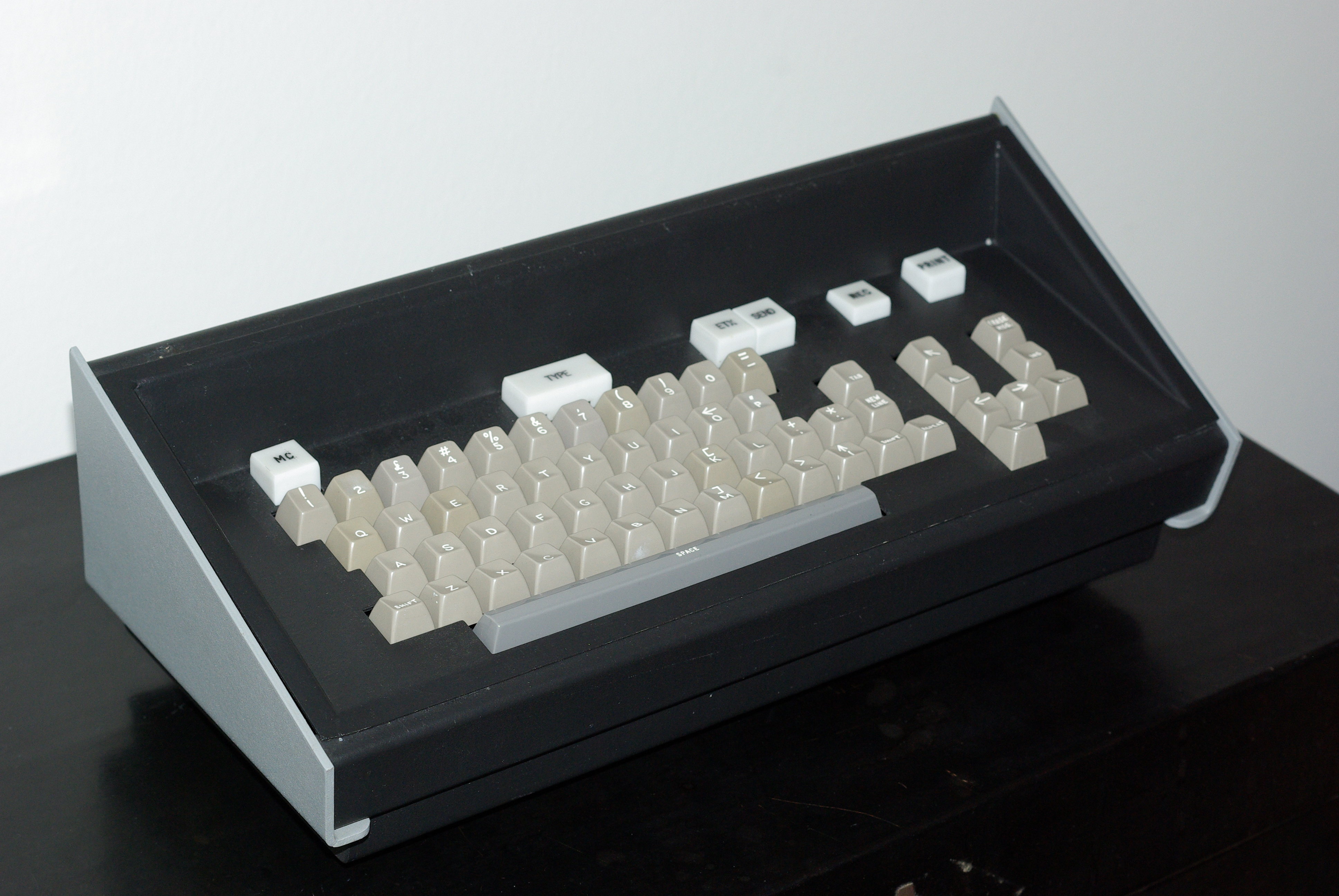

Microswitch/Honeywell definitely had keyboard switches (reed), by 1966.
ImageDSC02714
https://www.flickr.com/photos/triplehaa ... 400411814/
I believe, this keyboard was made for/by Mohawk Data Systems, but I don't actually have any proof of that (hint from the ebay listing).
Pretty sure this is the oldest true "keyboard" in my collection. I have older things such as teletypes, typewriters, calculators, as well as a solenoid linotype->typewriter converter and teletype interface (I really need to clean this up and take some pics, as it's super cool: http://www.ebay.com/itm/C-N-Brewer-Tele ... 2509947166).
