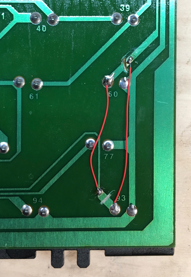

Just a followup - swapping the switches and rewiring the traces worked great. I now have my Control key in the 'right' place and the latching caps is relegated to the left Control key which I never use. I also discovered that as of the laster Mac OS X release, the latching caps doesn't work at all anyway. Which is fine... it's IMO a pointless keyboard feature anyway
I used ultra fine wire-wrap wire for the wiring, just so it wouldn't take up any space (wasn't sure how tight the fit would be). Photo attached.

- swapped Caps Lock and Control on AEKII
- IMG_7219.jpg (252.33 KiB) Viewed 5506 times

As I thought it would be! Yeah, these are single sided boards, forgot to mention that.
If you really really hate Caps Lock you could just cut traces, replace the switch, and make Caps Lock another Ctrl, so you have two of them. The possibilities are endless with reworks like this.
If I had the time I'd make one of these boards NKRO by cutting and sanding a bunch of traces and soldering in SMT diodes, and replacing the controller. But at that point it's almost easier to just make a new PCB.
But this is a quick and dirty hack that at least makes the AEK and AEK II usable for folks who love their remap. I'll need to try this myself!

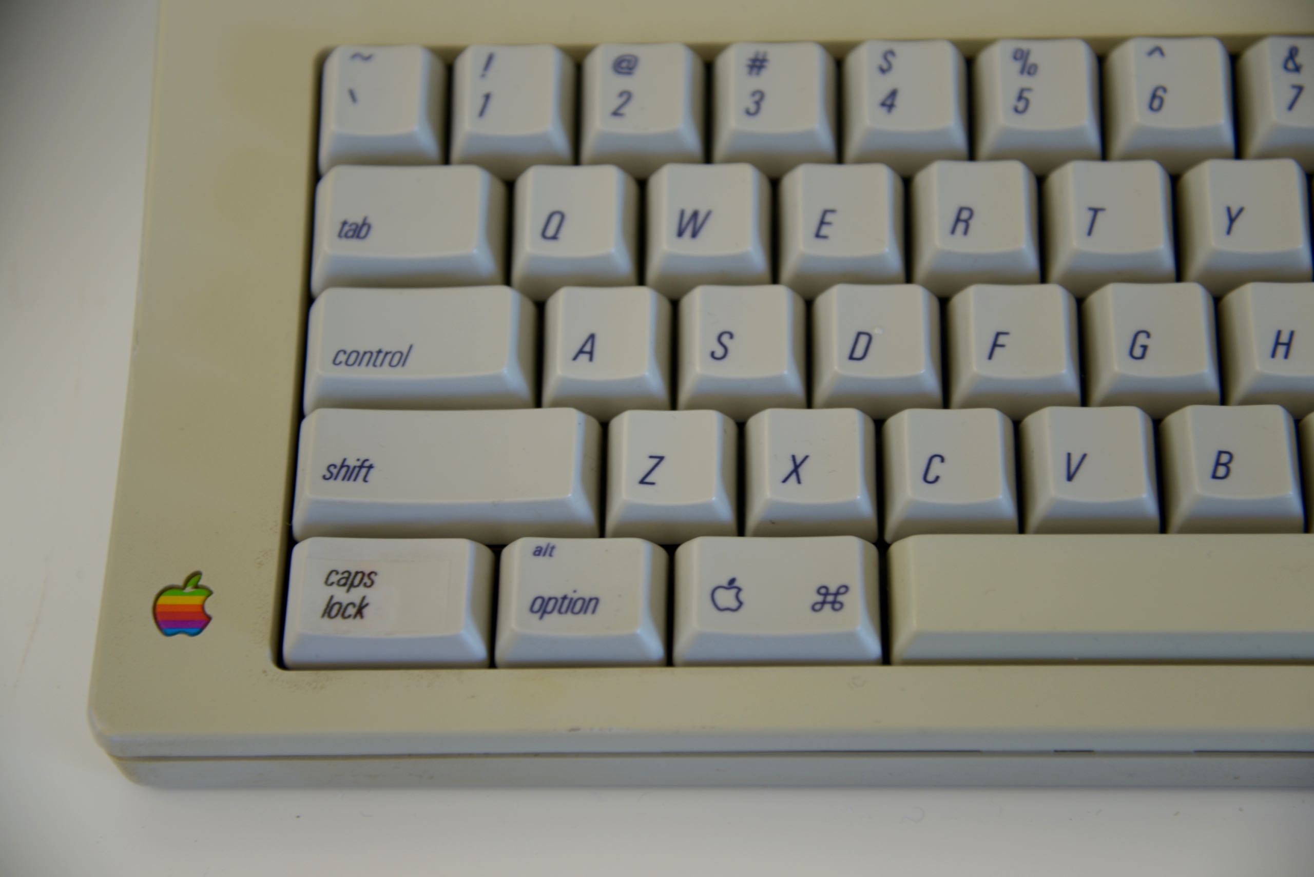

So I've been thinking more and more about this mod. It's a good intermediary between being unable to use the otherwise delightful AEK at all, and needing to spin a whole new PCB for it.
The one thing that bugs me is that, this board is so nearly perfect, but there is no 1.5u bottom row "caps lock" key available for Apple boards. So, I made one! The R3 "Control" key is readily available as a donor key from an Apple Keyboard I, or you could in theory make one as well.
First, I used a dremel tool with a tiny barrel (cylindrical) sander to remove something like 0.2mm of PBT from the top of the key. This is just deep enough to pull off all of the factory dye sub, leaving a completely blank cap.
Then, I made a legend with black-on-clear P Touch label maker tape. At first I used the Univers 57 Condensed Oblique font, from a TTF file online. But, I found that the kerning and letter height, shapes, and thicknesses were just a bit off.
So, instead, I took a high quality macro shot of a real "caps lock" key, cropped it, and leveled it. Sure, the edges are rough, but the resolution of the camera is so much higher than the resolution of the label maker that I didn't bother doing any manual smoothing. Something in the print path will do the smoothing for me!
I then printed the label. This took a few tries to get something close to the original scaling but I eventually got it.
Almost there! What's next?
1. I need to actually do the rework. These are just the keys, the switches are not swapped.
2. More precise measurement and placement. This was a quick and dirty, proof of concept type mod.
3. If it works this well I'm going to talk to wokechill to see if he can actually dyesub the cap for me so that it's not just tape.
4. Stabilize the control key. The donor key has stabilizer inserts, and the AEK I PCB has stabilizer holes. If you have some extra wire and clips handy - perhaps donated from a junky Apple Keyboard I - you can stabilize control nicely.
