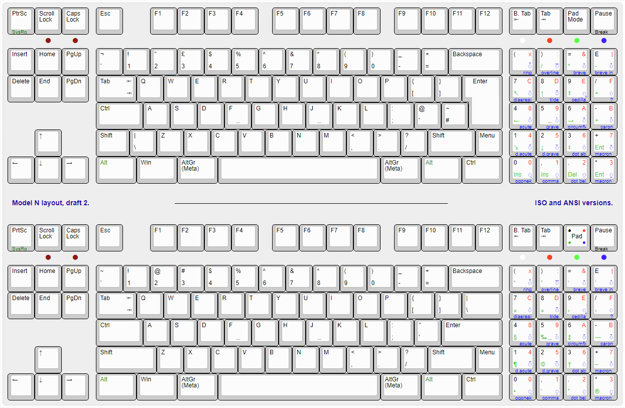

With all this in mind, I got to work on the Keyboard Layout Editor, and this is what I've come up with:
Note the diferences in both multipads — the one in the ISO version still has the nav commands on the green layer, while in the ANSI one it contains typographical symbols. Also note how the "Pad Mode" key has different designs (one Spartan, the other one, not so much).

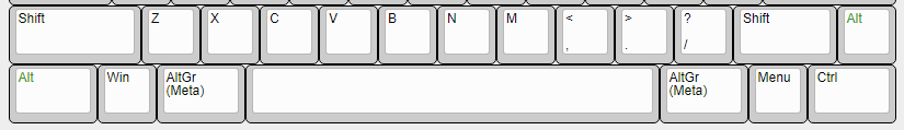

I'm still not entirely happy with the way I've set up the modifiers. Perhaps I could shuffle them about a bit, reduce the Win/Menu keys to 1U and set them up like this:
The proper-sized space bar has enough room to split it and add a Backspace there, as Zobeid Zuma mentioned on keyboards-f2/the-heresy-t17299.html#p384587
What do you guys think? Your opinions will be welcome. :-)

I genuinely don't understand why people think Ctrl is better in the Caps Lock position than in the bottom-right position. Do you guys never use undo, cut, copy and paste or something? Oo
06 Sep 2017, 13:43
Chyros wrote: I genuinely don't understand why people think Ctrl is better in the Caps Lock position than in the bottom-right position. Do you guys never use undo, cut, copy and paste or something? Oo
I use 'em all the time (plus Ctrl-A, "Select All"), but I use the Ctrl key on the right side of the keyboard to that effect.

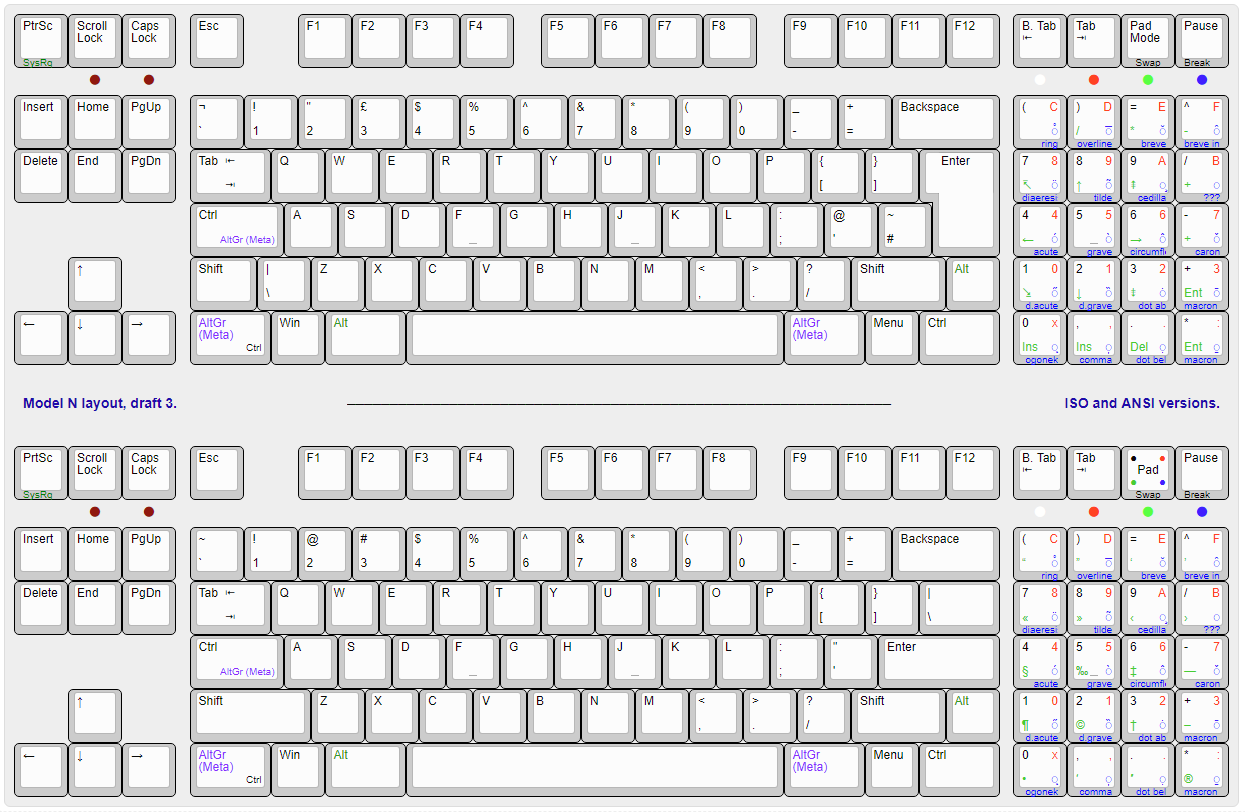

I've kept thinking about the modifiers' placement. How to a) manage to have two on each side of the keyboard; b) make both sides of the Control Argument happy (see Thomas' comment); c) change as little as possible the extant modifiers (something that I did do nicely on draft 1, but lost a bit in draft two)? AND keep the whole thing symmetrical? I realized (thanks in part to /r/DownvoteOrFeed 's comment on reddit) that symmetry is actually less important than I first thought.
With that in mind, I got to work again, and this is how the layout's draft stands now:
  • Extant Caps Lock becomes Left Ctrl; extant left Ctrl becomes AltGr/Meta.
  • Pressing Ctrl-AltGr-PadMode swaps them, so extant left Ctrl remains left Ctrl and extant Caps Lock becomes AltGr/Meta; the same keystroke (ok, ok, AltGr-Ctrl-PadMode) swaps them back.
  • Left Shift, left Win, left Alt, right AltGr/Meta, Menu and right Ctrl are unaffected.
  • As in draft 2, right Shift is split to create a 1U right Alt.
No, no right Win key whatsoever. No Fn key, either (do we need it, really?).
With this new arrangement, the space bar remains 7U (which keeps feasible the idea of splitting it into a 3U Backspace and a 4U space bar).

08 Sep 2017, 04:27
While I always prefer the 1.5-1-1.5-7-1.5-1-1.5 bottom row myself, if you really want to split the spacebar on an M /F, you'll need a Code key and matching wheelwriter spacebar.
This means losing the left Alt.
08 Sep 2017, 04:41
0100010 wrote: While I always prefer the 1.5-1-1.5-7-1.5-1-1.5 bottom row myself, if you really want to split the spacebar on an M /F, you'll need a Code key and matching wheelwriter spacebar.
No split space bar, then! Thanks for the input.

08 Sep 2017, 13:17
I love the split Code/Long Spacebar from the IBM Actionwriter/Wheelwriter machines and have one on my [home] daily driver.
[BTW the the other Actionwriter caps are hot as well... check Thomas' Review https://youtu.be/907sWRVJ_xM]
Here is a potato picture of mine:
It does take up the space for *both* 1.5 Alt on a Winkeyless layout, so yeah. Not a problem for me, per se, since I have a custom mapping (and have ordered RGB keycaps to support it):
Caps = Ctl
Alts are in Ctl positions
Code is GUI key [which is useful for me, since this is hooked up to my Mac]
The extra ISO key near left-shift is a Fn key [I have basically the F-key row programmed with additional functions, but will continue with more]
Tapping both Left and Right shift triggers Caps Lock
In software, a tapping the Ctrl key (in Caps position) issues ESC, so it is much more comfortable with VIM.
The Code key is sweet since it makes the same glorious *clang* that the space does, more or less, which is the fun of the M/F. Also, since I am *heavily* biased [by typing style alone] to hit meta keys on left and hit space on left, it requires no really adjusting to for me and since MacOS uses that a lot for hotkeys, is very comfortable. Requires some remapping on things for playing FPS games on the Mac to be comfortable, but doable.

08 Sep 2017, 14:05
