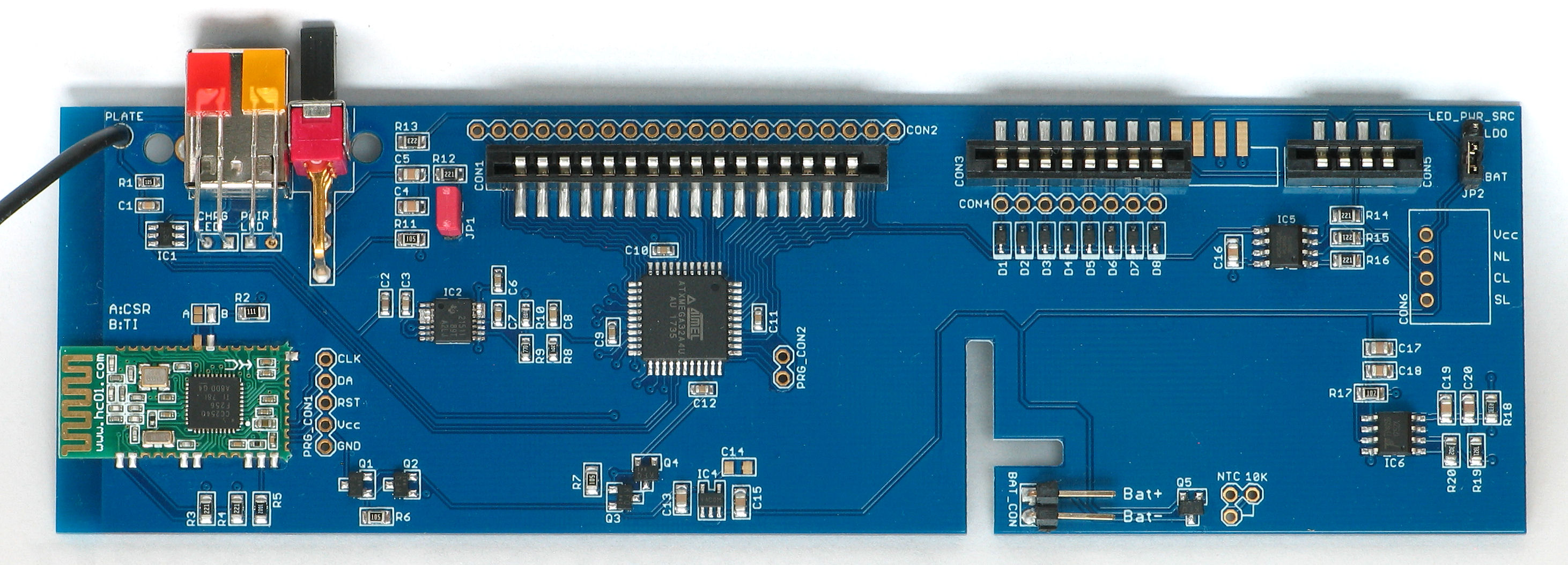

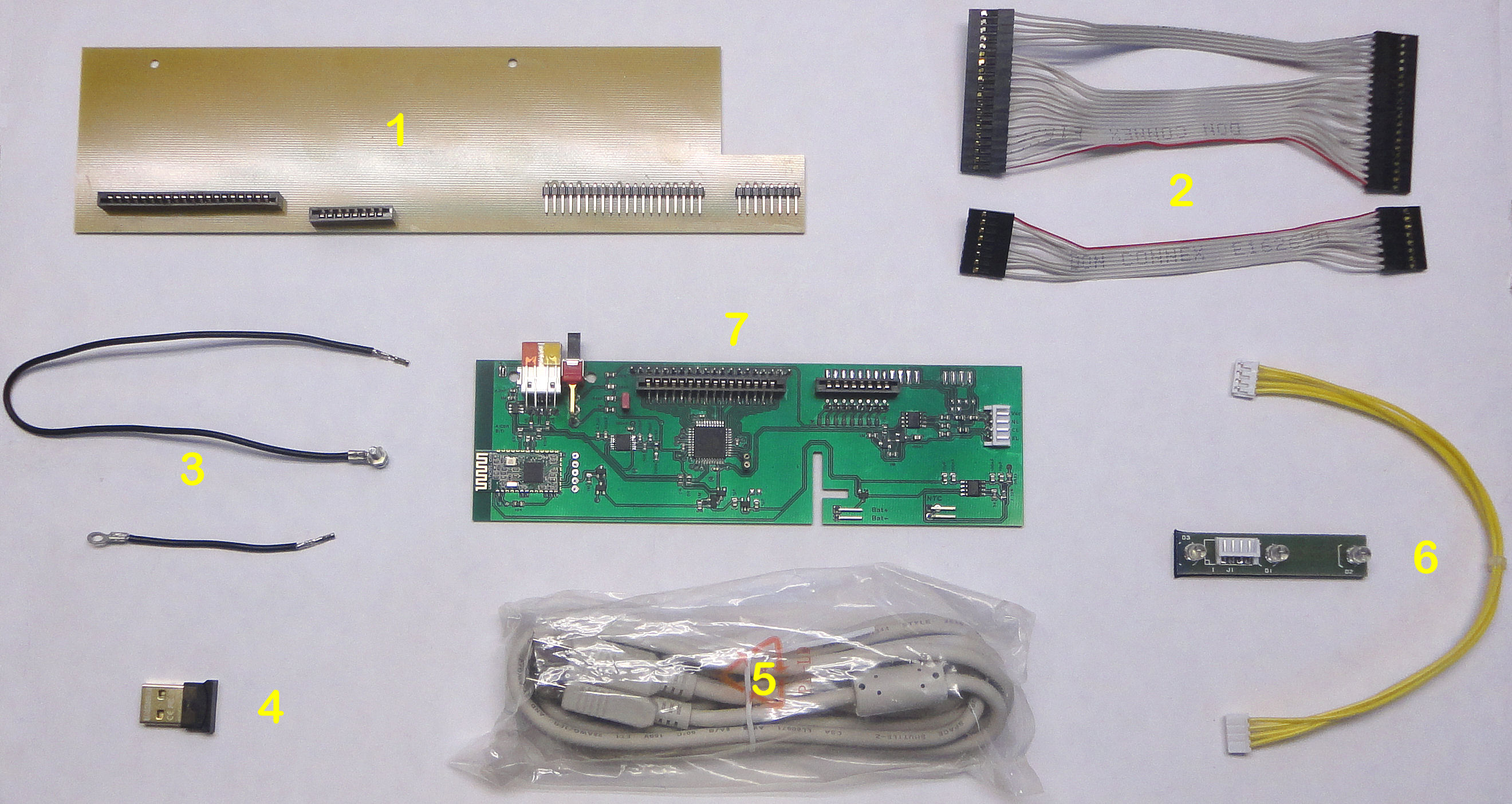

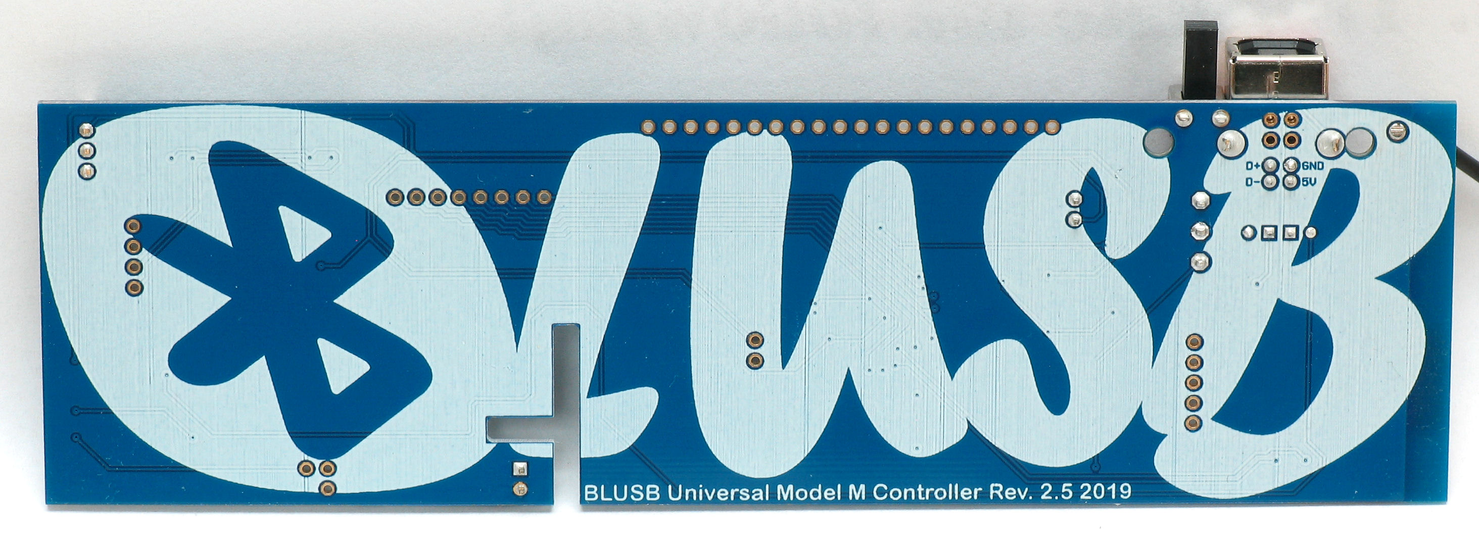

(1) M122 daughterboard, (2) jumper cables to connect daughterboard and main controller board, (3) shield ground wires long and short, (4) HID proxy dongle, (5) USB-B-›USB-A cable, 1.8m, (6) LED daughterboard (JST EH header) and JST EH connector wire 210 mm, (7) controller board
Bluetooth-USB-Hybrid controller for the Model M keyboard (75€, controller board only)
All common variants of the Model M keyboard are supported.
Variants not supported yet:
- Unicomp PC/122 (controller board attached to steel plate above the numeric keypad, different versions)
Upon placing an order, please let me know the number of FFC sockets you need: three (16+8+4 pins) or two (16+12 pins).
— supported operating systems: Windows, Linux, Android, iOS, Mac OS X
— convenient, no hassle drop-in replacement
— controller supports USB or Bluetooth 4.0/BLE connection (flip switch to select)
— use any 3.7V Li-Po/Li-Ion battery you like
— internal battery charger will recharge battery when USB cable is connected
— maximum battery life during normal operation: ca. 7 days (500 mAh battery, not included)
— driverless configuration (i.e. no filter driver is necessary to be able to change settings by software)
— fully programmable, custom key mappings, easy keymap configuration, up to 8 layers are possible
— up to 24 macro keys (6 keys + 8 modifiers each) suppported, configurable by software or by dedicated special function keys
— standard USB/Bluetooth HID 6-key rollover
— LED lock lights brightness adjustable separately for BT and USB mode (either by dedicated special function keys or by software)
— adjustable debounce period (1-255 ms, configurable by software)
— USB HID bootloader for no hassle firmware updates
Thanks to the indefatigable and generous efforts of fellow DT member 'arakula', configuration and modification of various controller settings can be carried out fast, easily and very conveniently on a cross-platform graphical user interface, yay!
If you prefer using simple tools for carrying out simple tasks, there are command line interfaces for Windows, Linux (ported by 'marcvk') and Mac OS (ported by 'quintus') as well. Show these guys that you appreciate their work, if you use it, it's free! =^p

Mandatory accessories M122:
— M122 daughterboard 10€
— jumper cables 20P + 8P 10€
Mandatory accessories Lexmark/Unicomp Model M
— daughterboard to connect matrix (LEDs included) 10€
— jumper cables 16P + 8P 10€
Optionally available:
— Li-Po/Li-Ion battery 3.7V, 500 mAh (+10€) / 2000 mAh (+20€)
— USB-B-›USB-A cable, beige, 1.8m, with ferrite bead sheath current filter included (+5€)
— LED daugherboard with low current low voltage status LEDs, green/amber/younameit (+10€)
— JST-EH connector four wire cable to connect LED daughterboard (+5€)
— cruciform Philips replacement case screws made from stainless steel for easy maintenance (free)
— BT-USB-bridge/BT-USB HID Proxy dongle (+20€)

0100010
22 Sep 2017, 23:52
LiPo battery replaceable / upgradeable?
mind_prepared
23 Sep 2017, 11:05

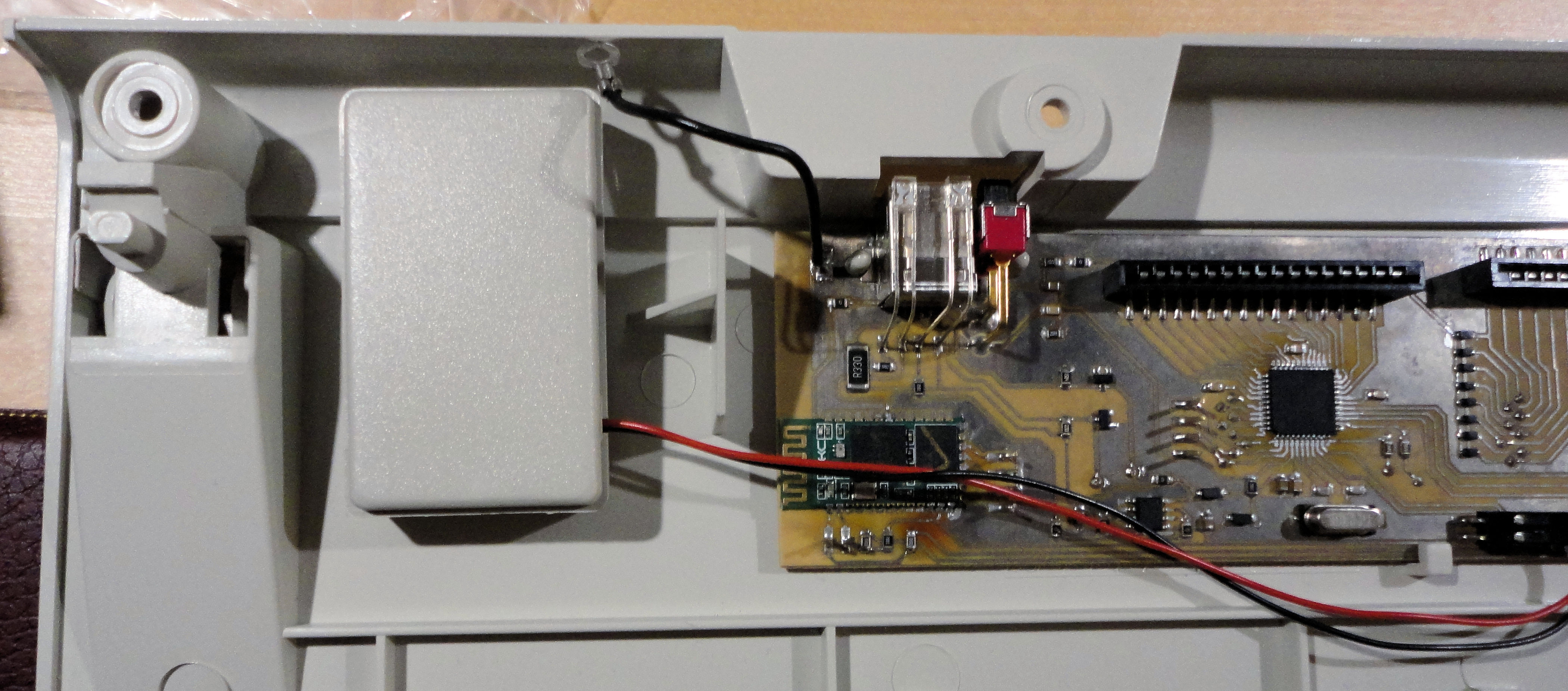

The battery in the picture is held atop the surface of the PCB by a strip of Velcro tape and can be removed easily. All you would have to do is peel off the adhesive tape that holds the NTC in place.
You can use any Li-Po or Li-Ion battery, as long as its output voltage is rated at 3.7V and its charge end voltage at 4.2V (which is critical), and as long as it will fit inside your Model M case.
If you're gonna use a different battery, you can either replace the NTC with a 10K resistor (chip or leaded) (if you can do without over-temp protection) or solder on wires an place the NTC near the new battery, whereever that may be. Some batteries already have an internal 10K NTC that connects to GND, such as the 2000mAh battery in the picture below, which would only require one wire going from the battery's NTC pad to the corresponding pad on the controller PCB. Either which way will work.

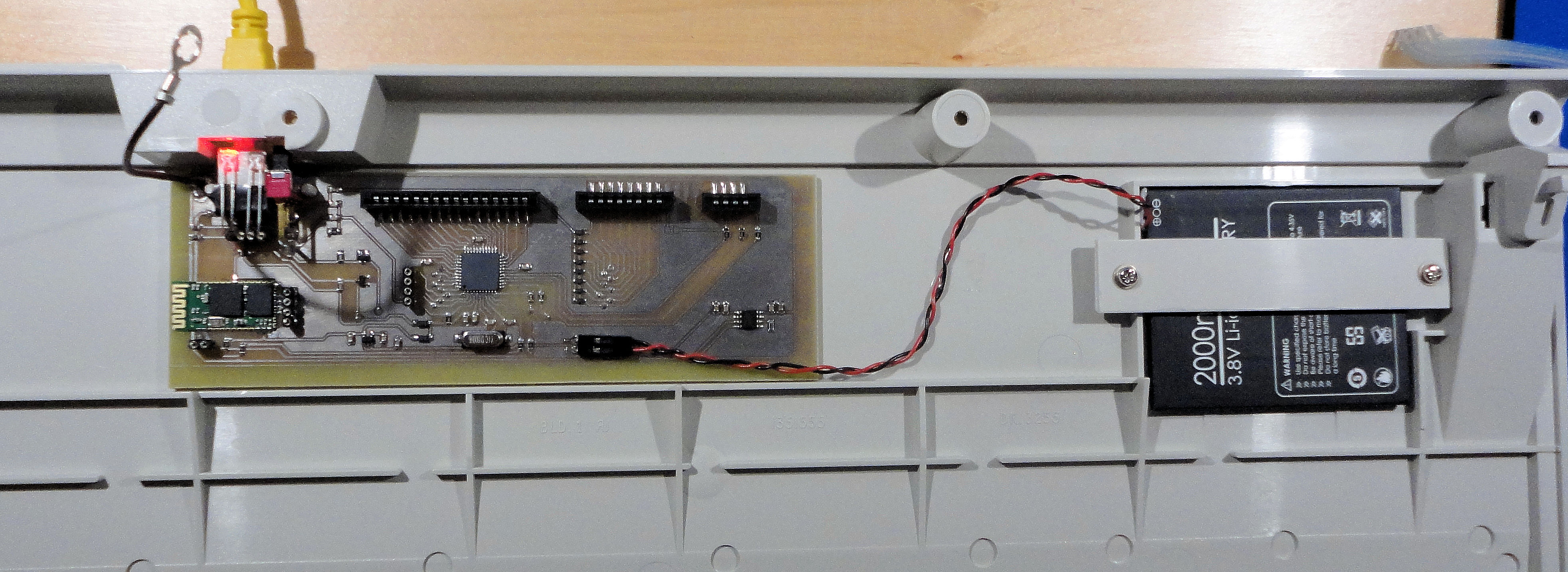

Here's two suggestions for installing bigger batteries (1000mAh and 2000mAh. Note: the PCBs in the pictures are based on an older design):

Installation was a breeze, apart from the bigger battery that required a bit of additional work to fix it securely in the shell, and apart from the fact that the mounting pins of the shell are a bit wider than the holes on the controller board, so I had to widen the holes a tiny bit (about 2-3 file strokes). Well, I was prepared for that (except for the fact that it took 10 minutes to find that little file, hee hee), and fixing it took less than a minute, so it was no problem.

mind_prepared
28 Sep 2017, 18:31
@pcaro
Up to 6 layers can be configured with a CLI. The next thing on the to do list would be a GUI for the programmer tool, something like the AIKON GUI, and I'm looking into that (actually Arakula, who posted feedback above, is looking into that right now). The firmware is pretty mature, but if demand justifies it, new features can be added. Pretty much anything you want. It's not meant to compete with the big guys though, s.a. TMK.
I already asked RaleghDirat to send me a picture of the original SSK controller, but haven't heard from him yet. Can you send me a picture of the bottom shell of your SSK and the original controller? That should be enough to tell whether it will work as is. Adjustments could be made to accomodate the SSK if necessary though, no problem.
Basically, all you need is an SDL connector bay, sufficient space to mount a 170x50 mm PCB, and of course the ribbon cables need to be in the right place so that they will reach the FFC connectors. If the SSK is basically identical to a full-size Model M, just without the number pad, it will work.

mind_prepared
29 Sep 2017, 13:42
@pcaro
I've checked out PhosphorGlow's 'Universal Model M Controller' and it is the same size as a regular 170x50mm PCB, from the looks of it. Apparently it's compatible with the SSK, so, yes, in all likelihood, the controller I made will be compatible, too.

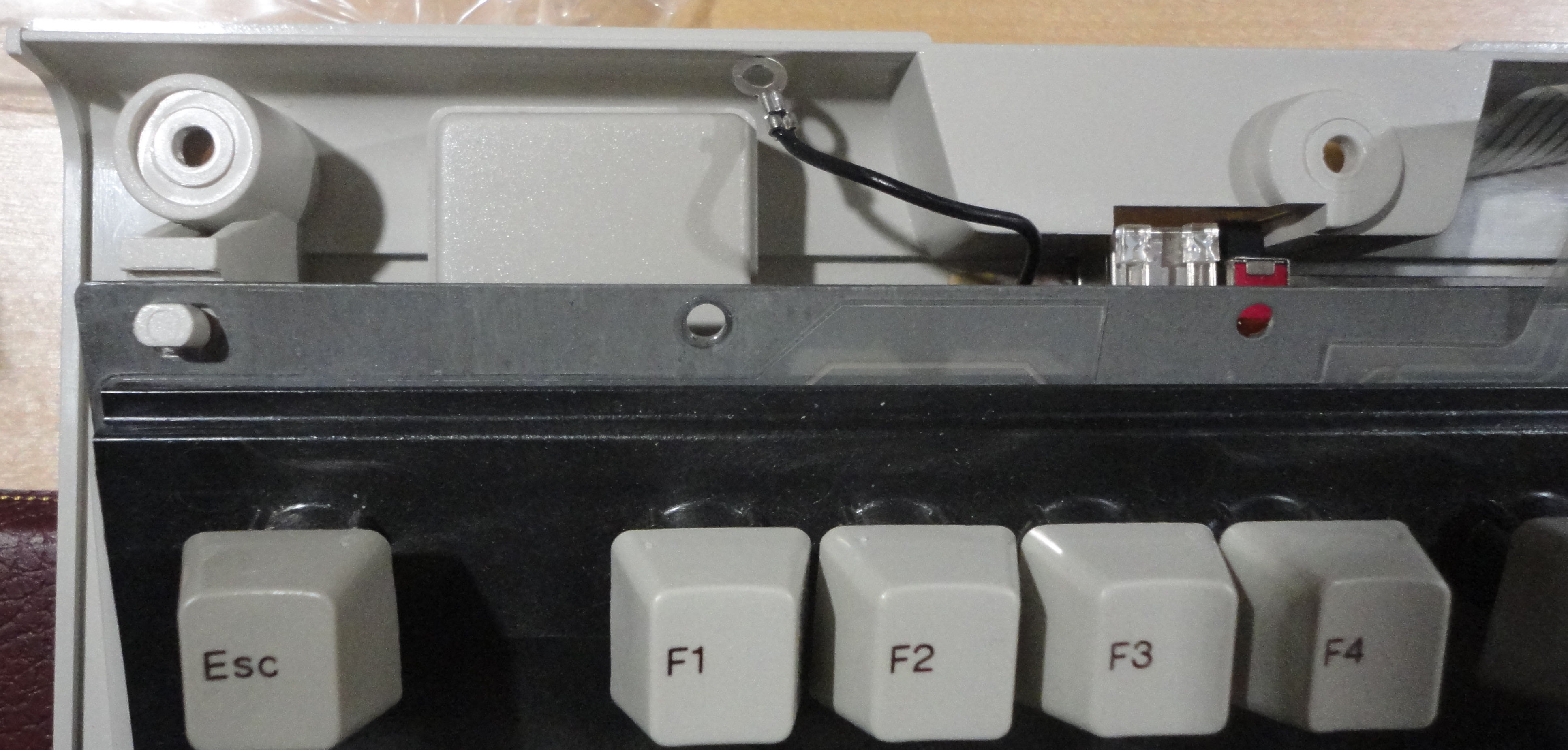

A pen can open a Ssk [WINKING FACE]ImageImageImageImage
Enviado desde mi XT1635-02 mediante Tapatalk
pcaro
29 Sep 2017, 19:32
I am wondering if are there enough space is for the battery
