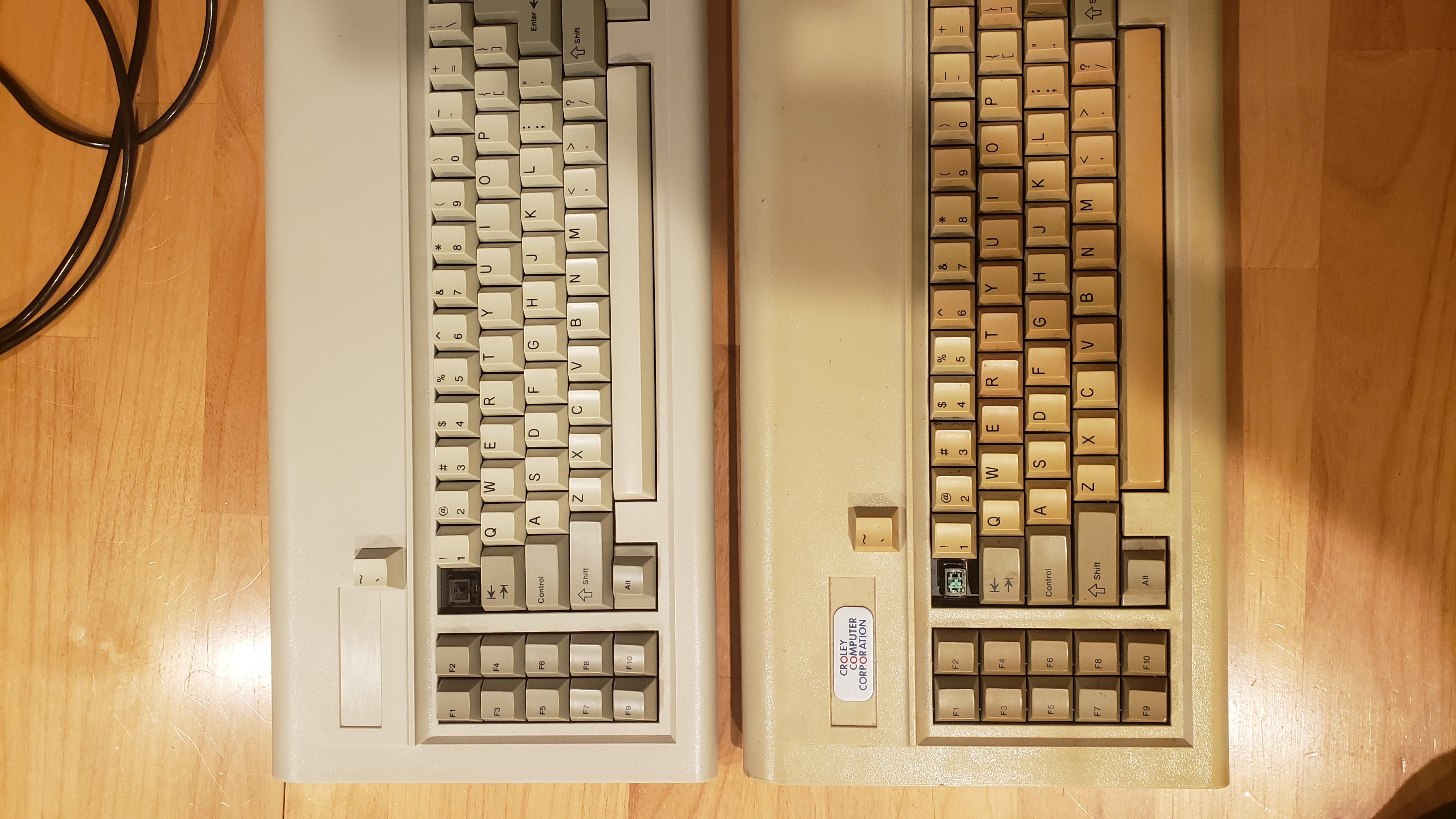

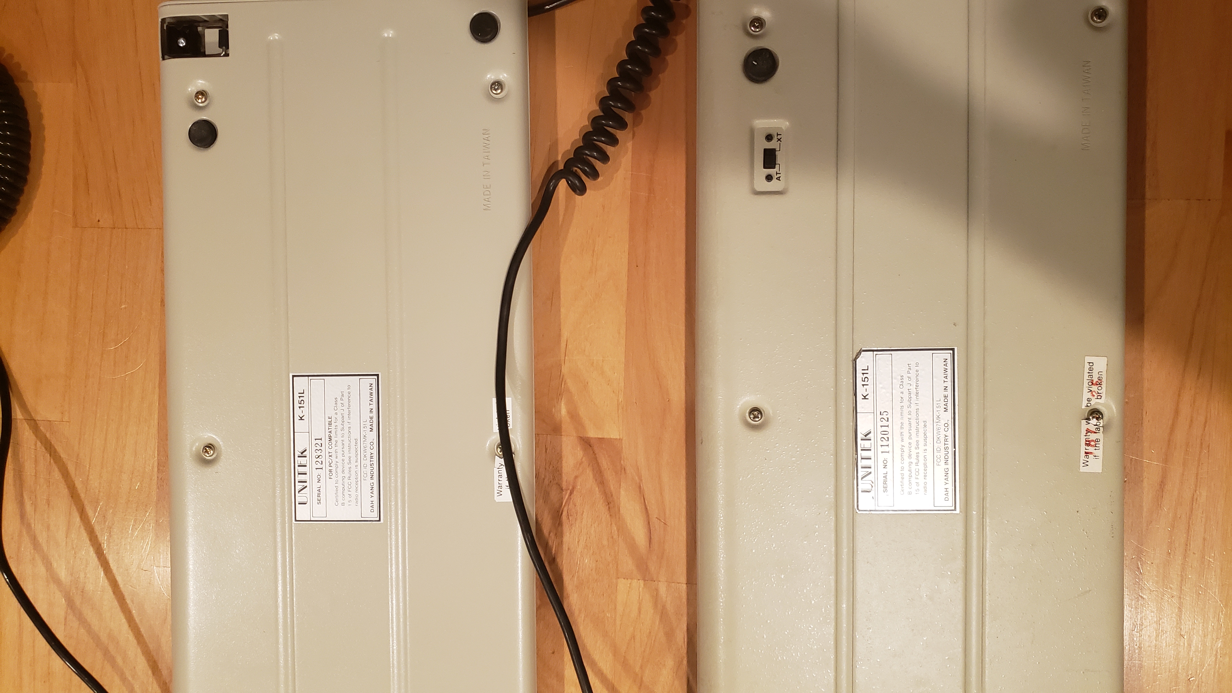

Not entirely sure where to post this but thought this was fairly close for adding to wiki possibly?
Some pics:
It's a Unitek K151L.
